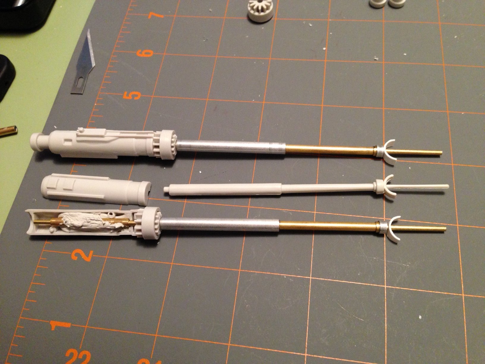

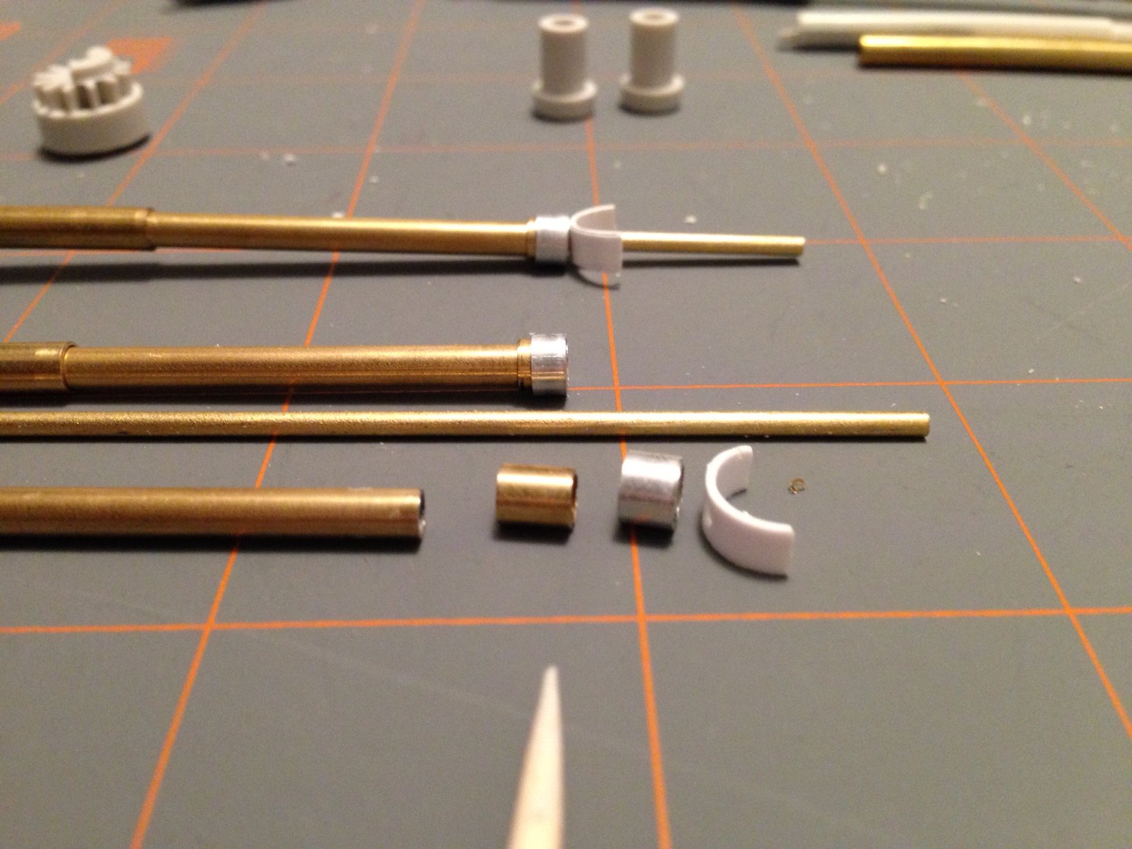

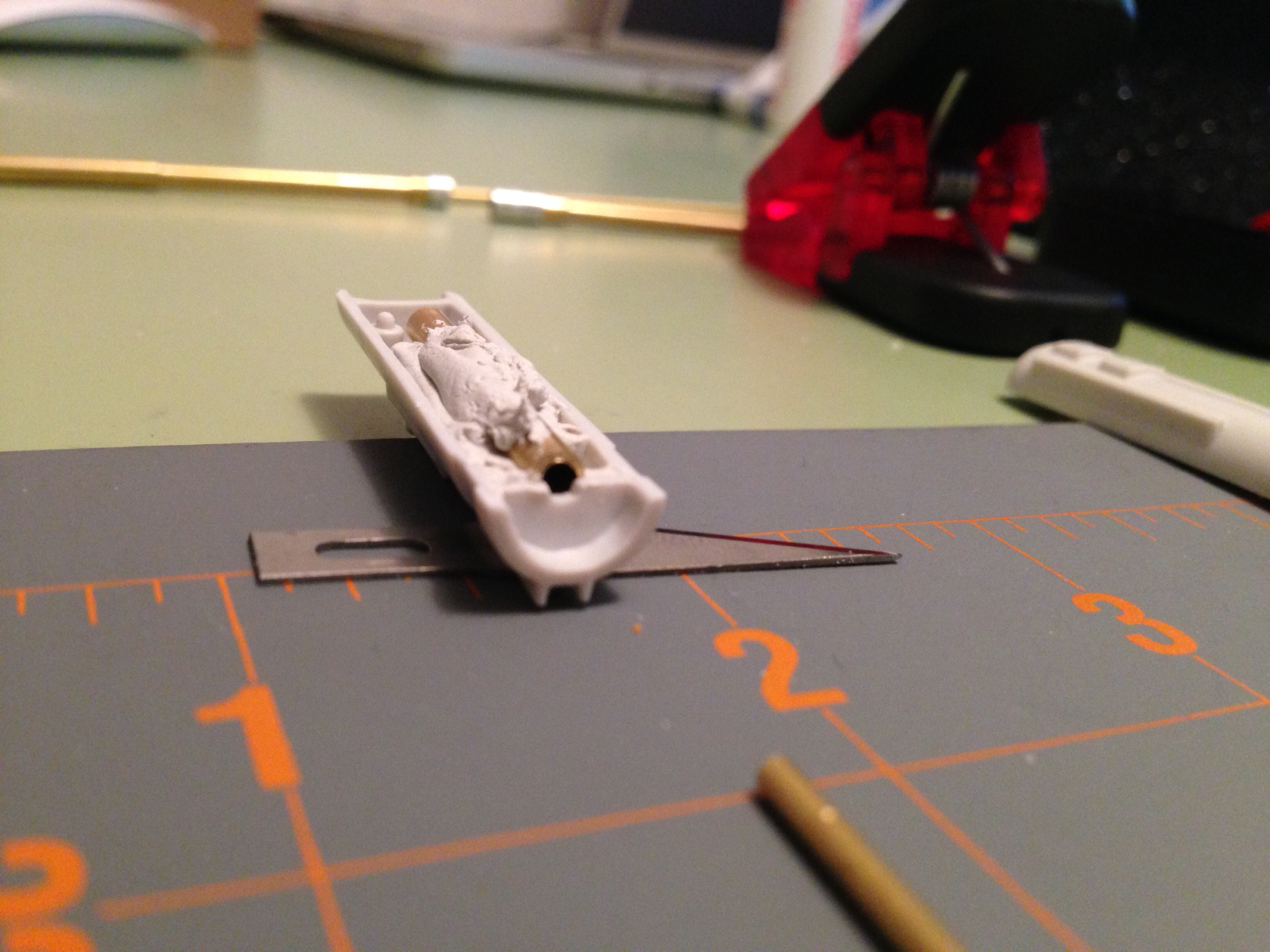

Rebuilding the guns in brass.
I mounted a brass tube inside of the part that attaches to the wing with squadron white putty.
newmagrathea

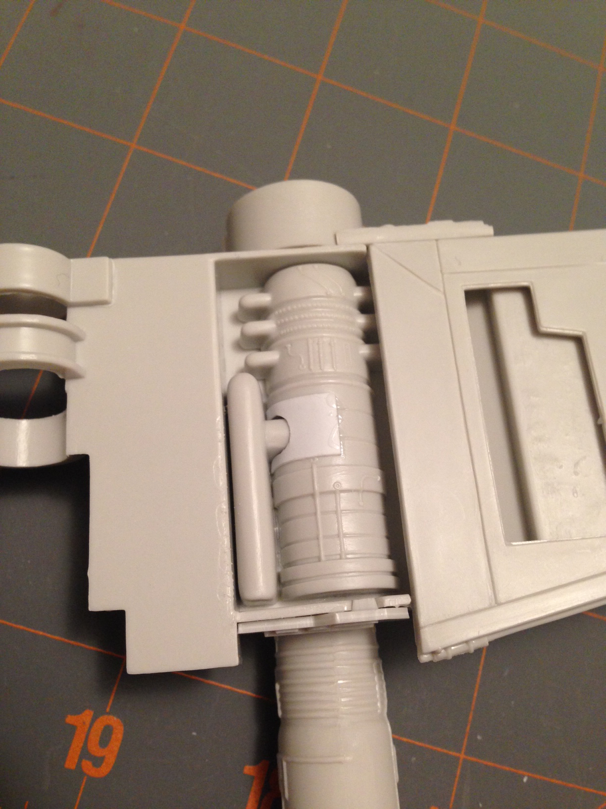

Because I used squadron putty it melted the plastic on the outside of the housing, so I had to build it back up with more putty and Mr. Surfacer. It was a pain the rear but I think it came out ok. I wish I would have taken a picture of it melted.

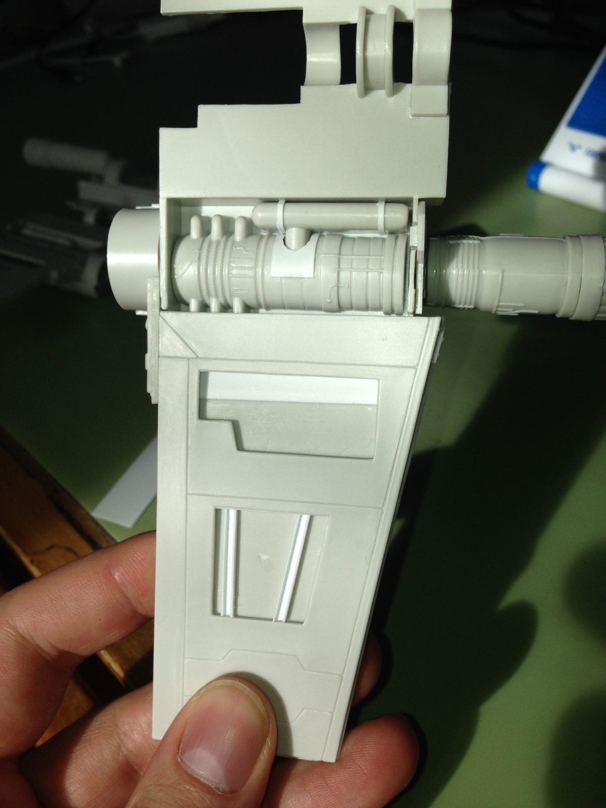

Next I moved on to the wings. This is where I was having a lot of trouble finding good reference photos. I eventually found some that were pretty blurry but good enough to discern what I did. I really hated the way the engines looked in the wings. So I added a small panel around the tube to make it look a little better. Also notice the gap in the wing to the right were the is nothing, I built that up too.
I plan to add some hoses to the engine areas to give it a bit more realism.
This was difficult to build inside of the already glued together wing, but I did it.

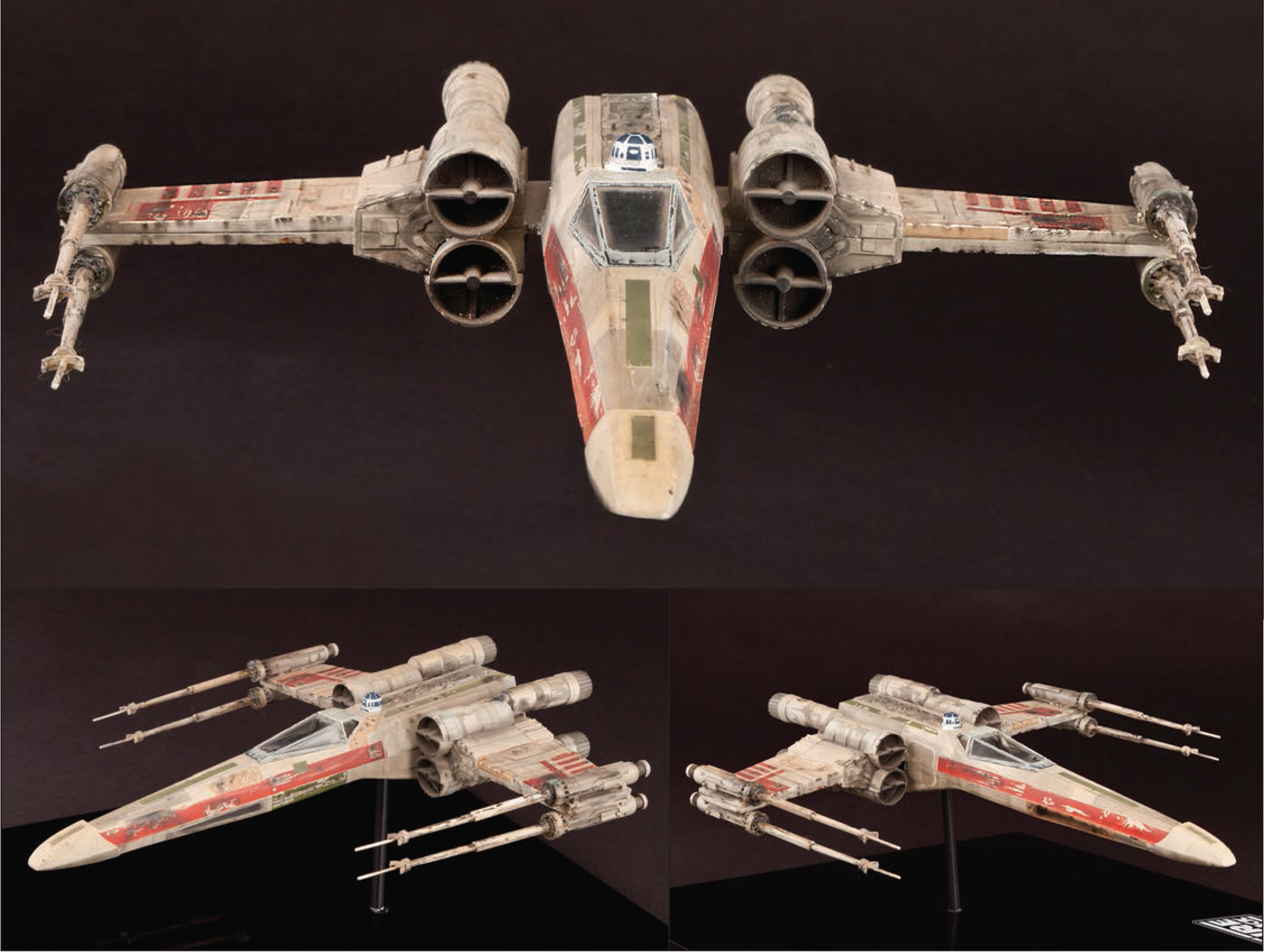

More on the guns. Earlier I shaved off the two ridges and sanded the gun housings smooth and so now I added some very thin brass rod to replicate what I've seen in a reference photo I came across, I'm not sure if it's from a prop or not.
My reference photo.
And my mod

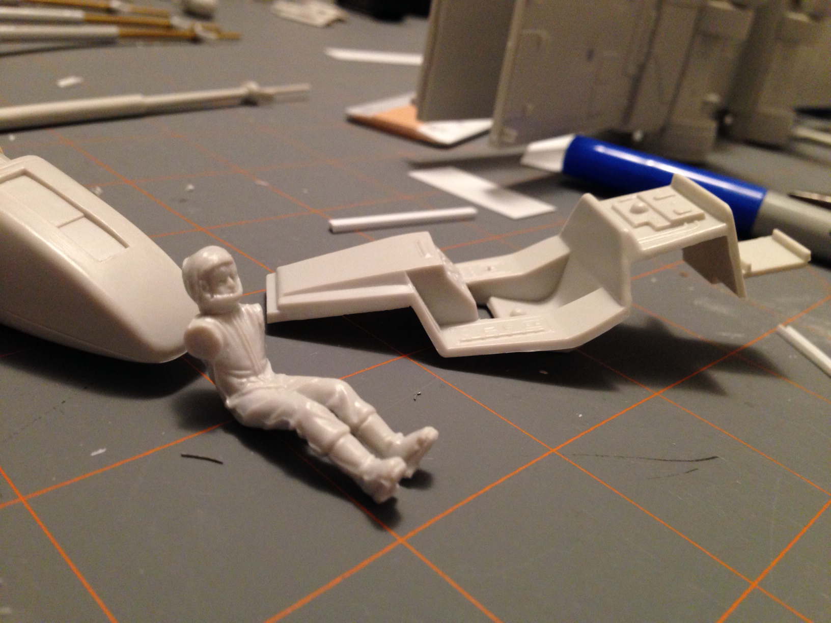

My next projects for this build are fixing the cockpit tub and figuring out how I'm going to mount this. The cockpit is pretty bad, I'm tempted to start from scratch, but I'll probably use most of it as the skeleton and build on top of it. The figure is pretty bad too but I'm not as concerned with that at the moment. Does anyone have any mounting suggestions? I was thinking a single rod through the bottom attached somehow, haven't figured how yet. And then bolted down to some wood painted black.
