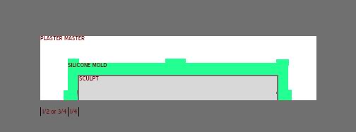

It looks like I'll need more mold max than what I can get from the trial kit. Suggested mold size is 1/2 inch thickness around the sculpt. That comes to 1.5lbs of the 2lbs kit and for only one half of the two part mold. Now, can I avoid using so much mold max by makin a master as well? Say, a 1/4th inch mold around the sculpt. Then a 1/2 inch plaster master?

You have to make a master, regardless. Mold max will not keep its shape on its own; that is the point of the rigid master. Sacrificing on mold max will increase the chances of tearing of the silicone. The best way I have read to minimize silicone, is to figure out a way to make a Cavity Pour Mold. You will probably be better off just purchasing the gallon kit.

It's a detailed piece about the size of a paperback book. I was going to use the method in the video but it uses a lot of silicone. Taking that into account I'd still use the plexiglass boxing but make a rubber mold 1/4th of an inch or so thick and then a much thicker master over it to save on material. Something like this . . .
I dunno. Is that doable?
ptgreek
wow ..its not really a huge piece to mold ...just make a box mold ...cut foam core into a box with a couple of inches around the sculpt( you can use hot glue to hold the box together) and about an inch or so higher then the sculpt. once the box is made secure the sculpt in the box ...mix up your silicone ( id probably buy a gallon kit ..if ya have some left over, you can mold up other stuff later) power mix the silicone ..then pour it into the box mold at a very high height ( breaking any air bubbles) ..let the silicone set ( oh ..and do all this on a very level surface) when you demold, you will have a perfectly flat backed mold, In this case, I dont even think you will need a mother mold ( big difference between the wording "master" and mother mold BTW) in fact unless you get the mother perfectly flat as well, it would be harder to cast the finished piece
