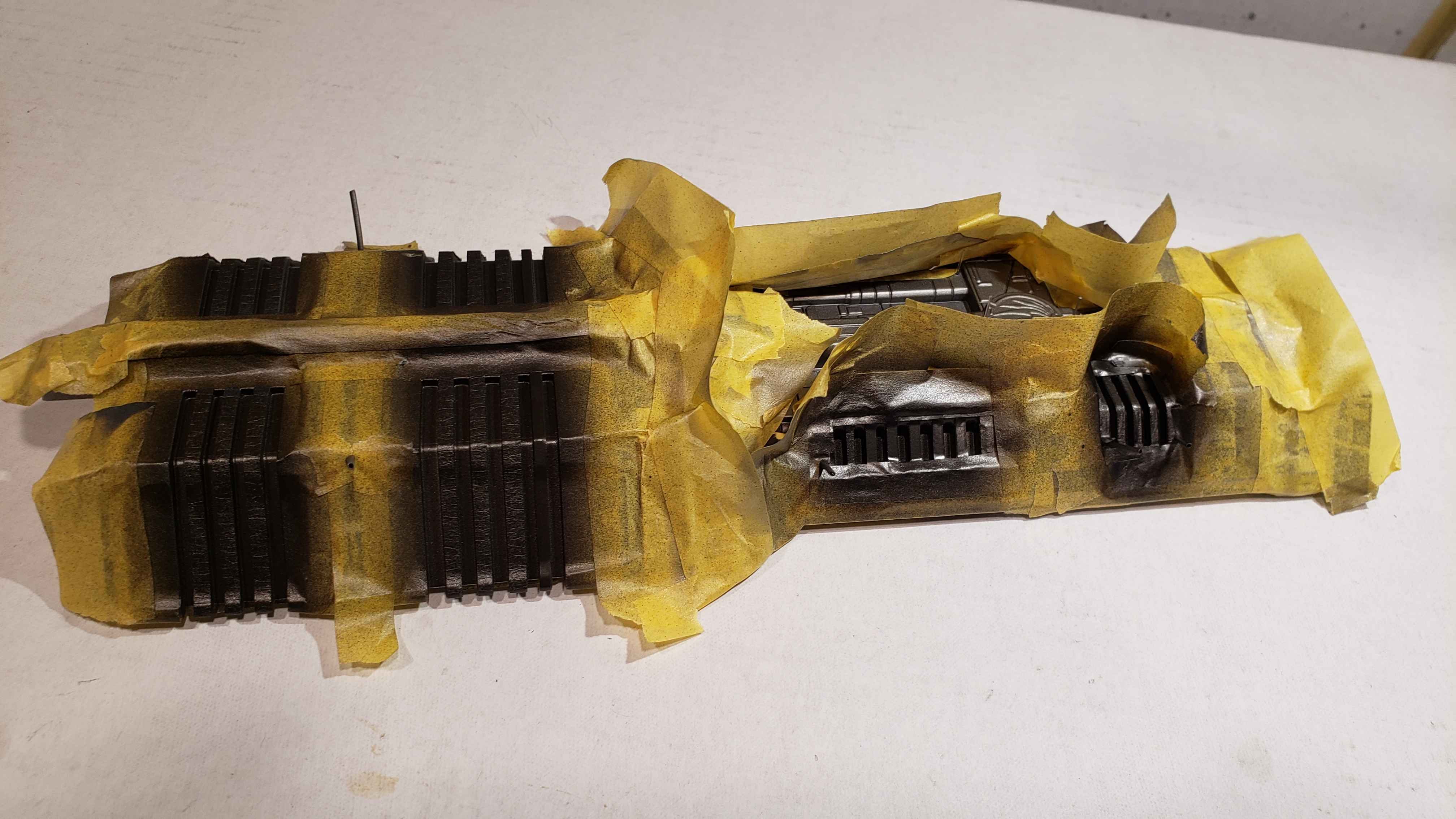

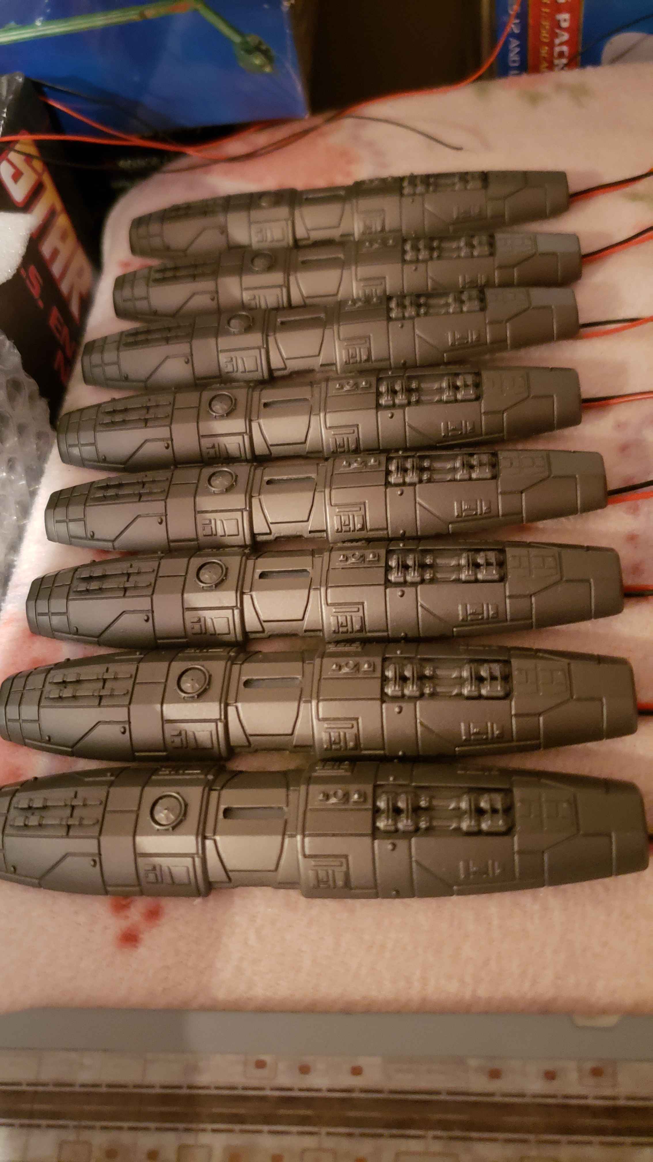

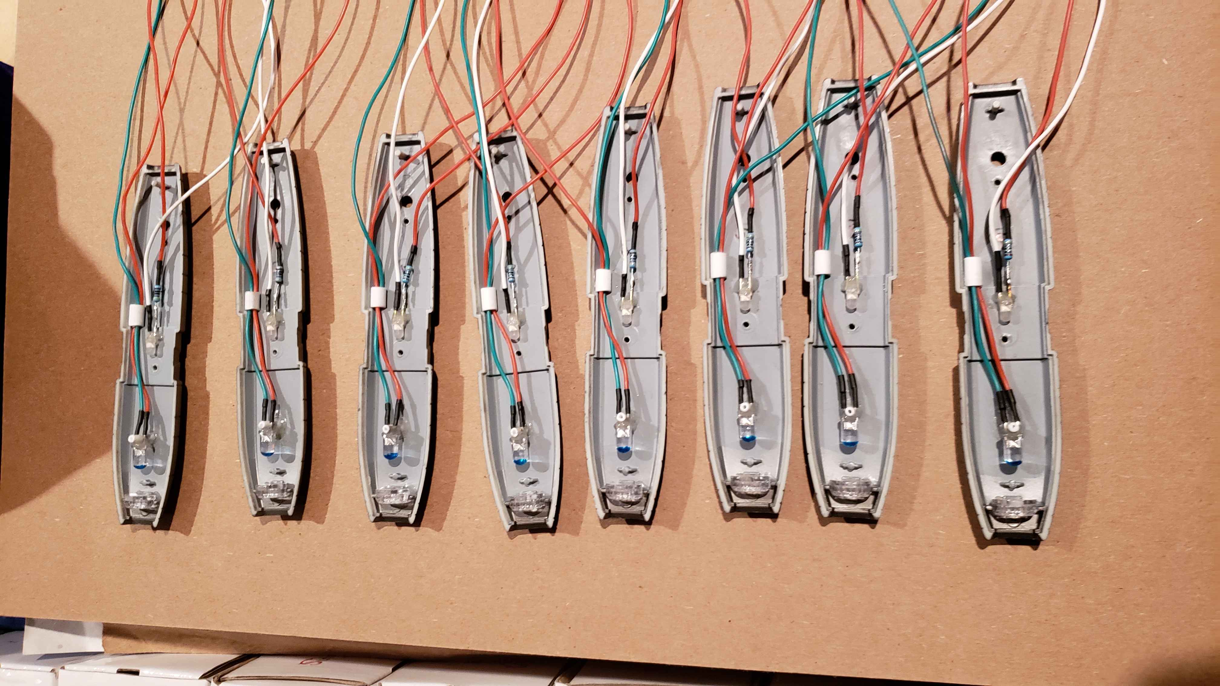

Started the 8 engines for the Pegasus build. All light blocked inside the engines. Mounted the engine LEDs which will be blue. I will be using a special power-up and pulsing effect board from TenaControls. There are 7 drilled holes for fiber optics in each engine which will be cool white. Hard to see those holes. Cutout a center slot which will show a mix of white and blue. Still have to cover the back of the slot with a diffusing plastic sheet. Will do that after outside of the engines is primed. Going to do as much painting as possible before I install the FO.

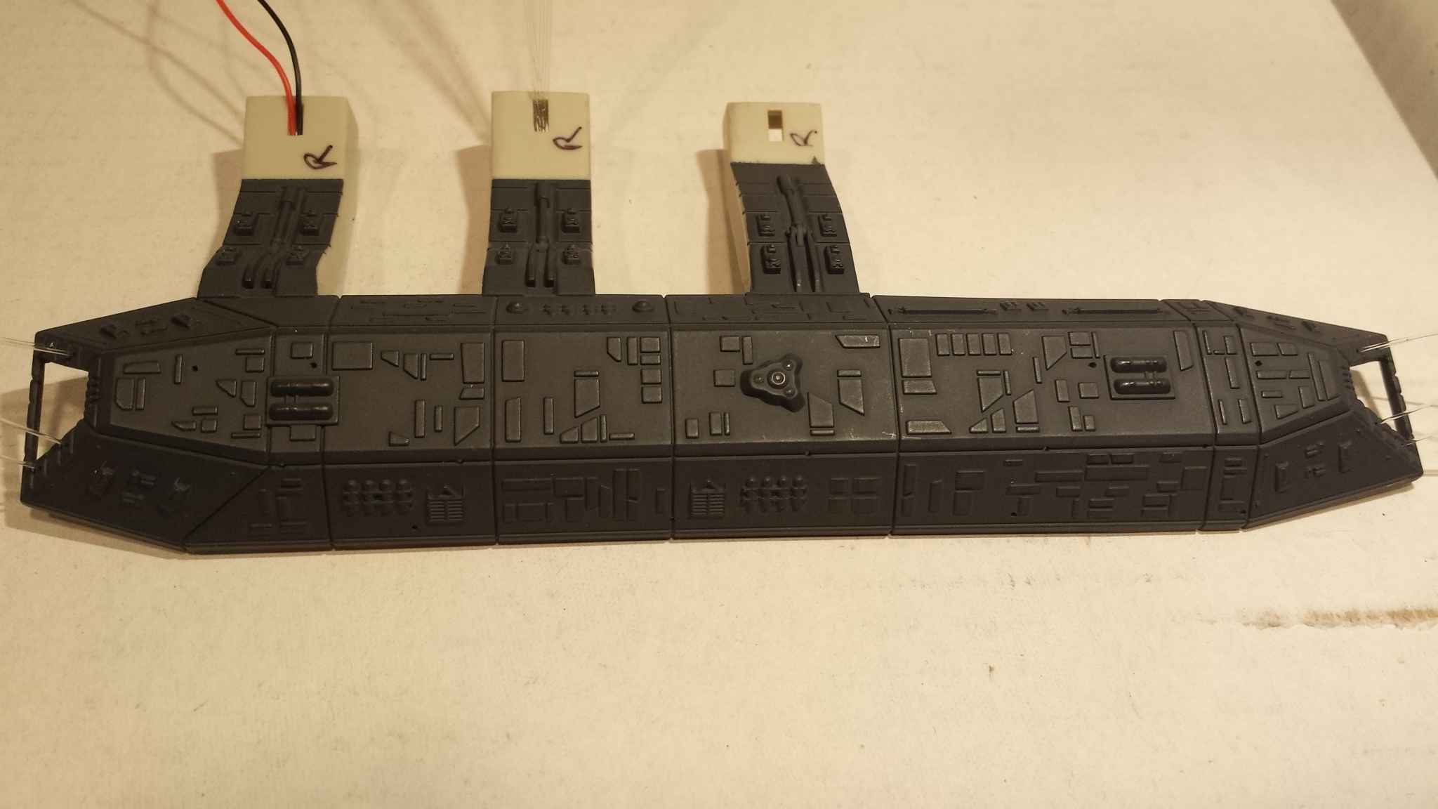

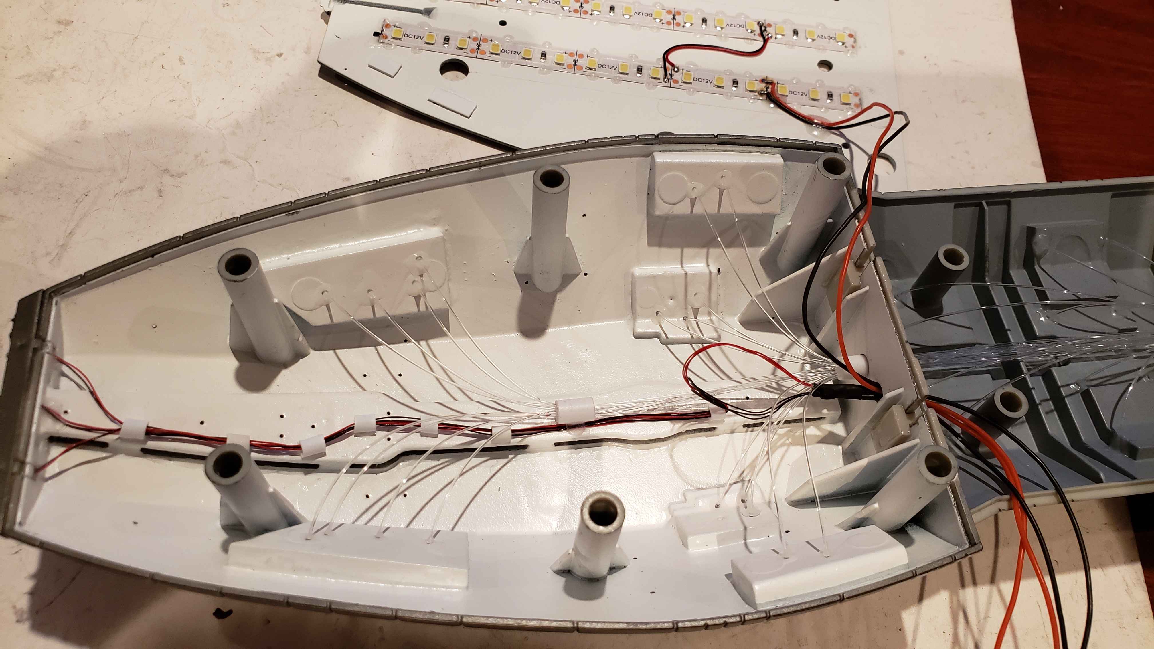

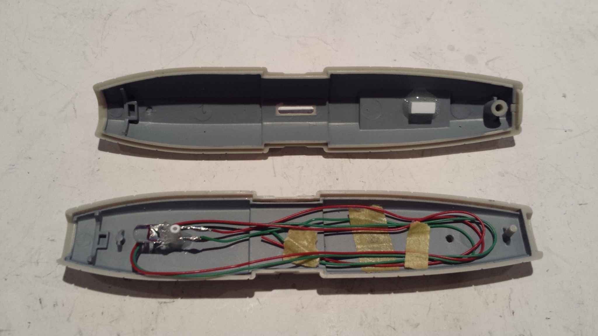

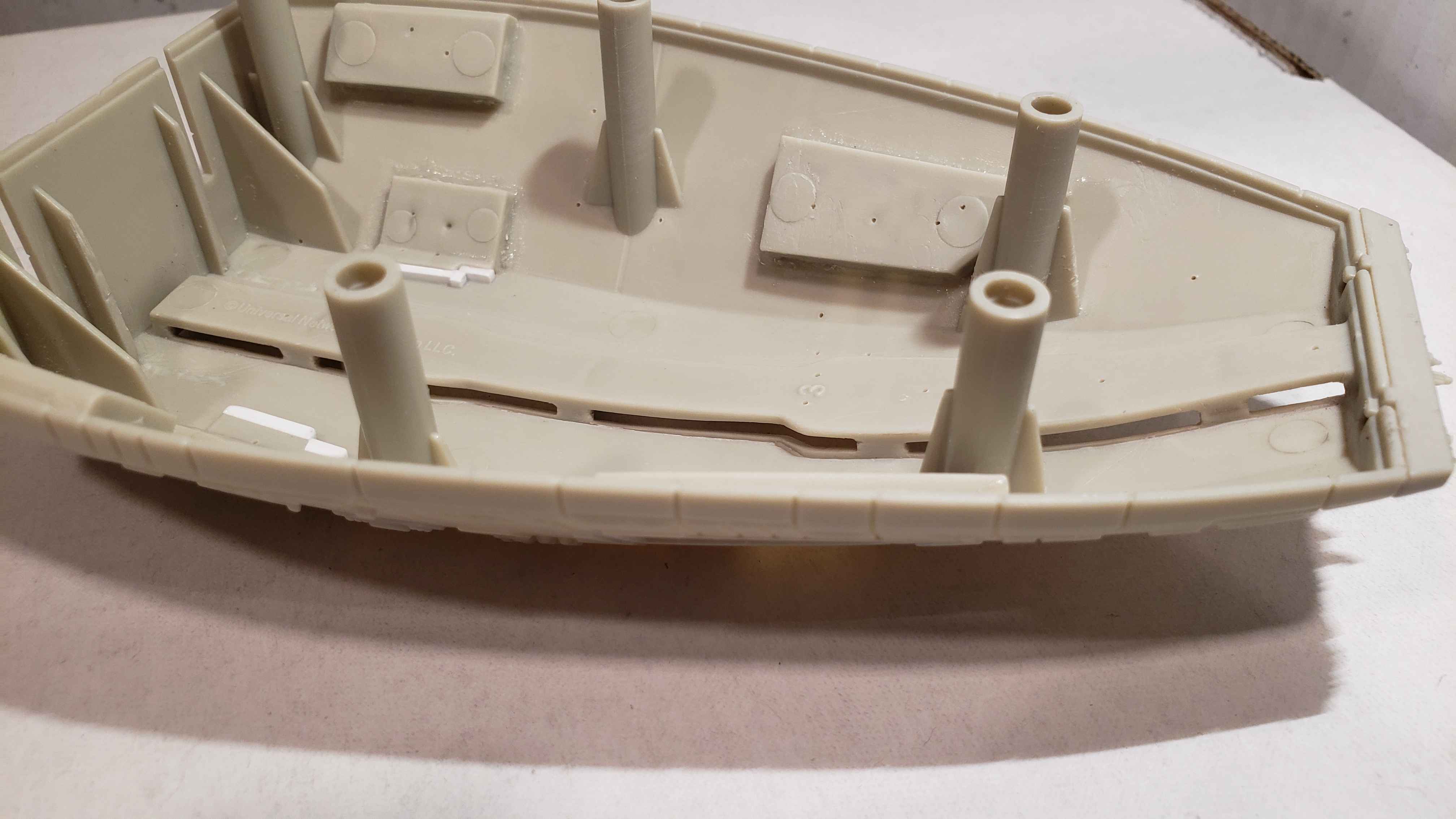

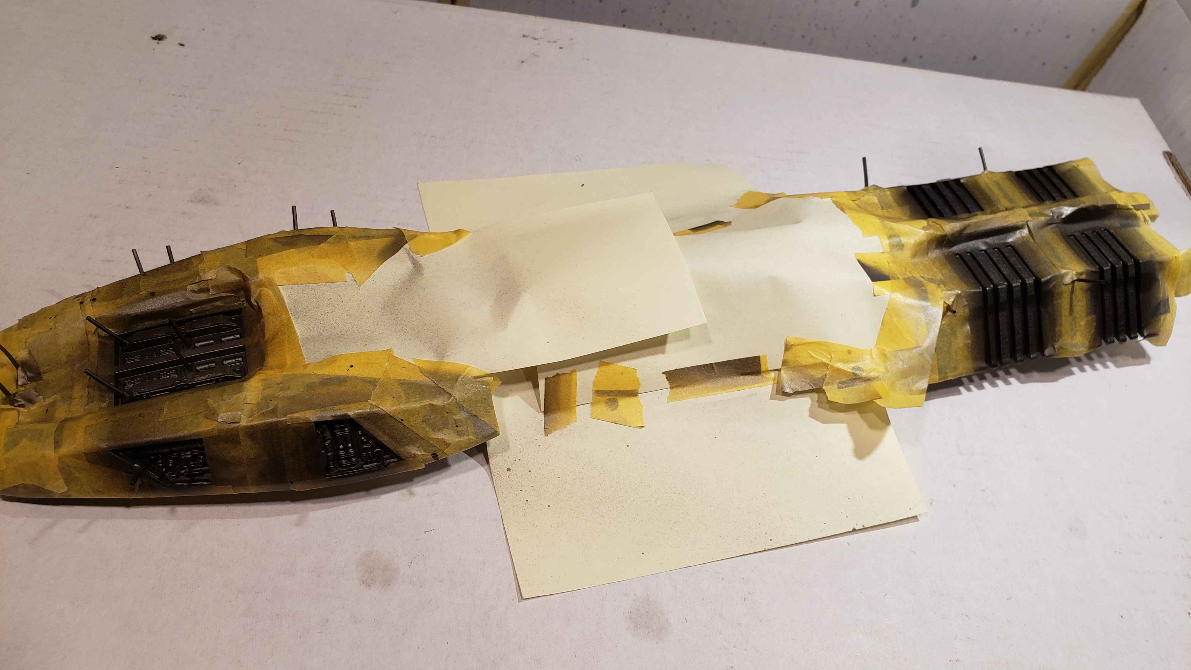

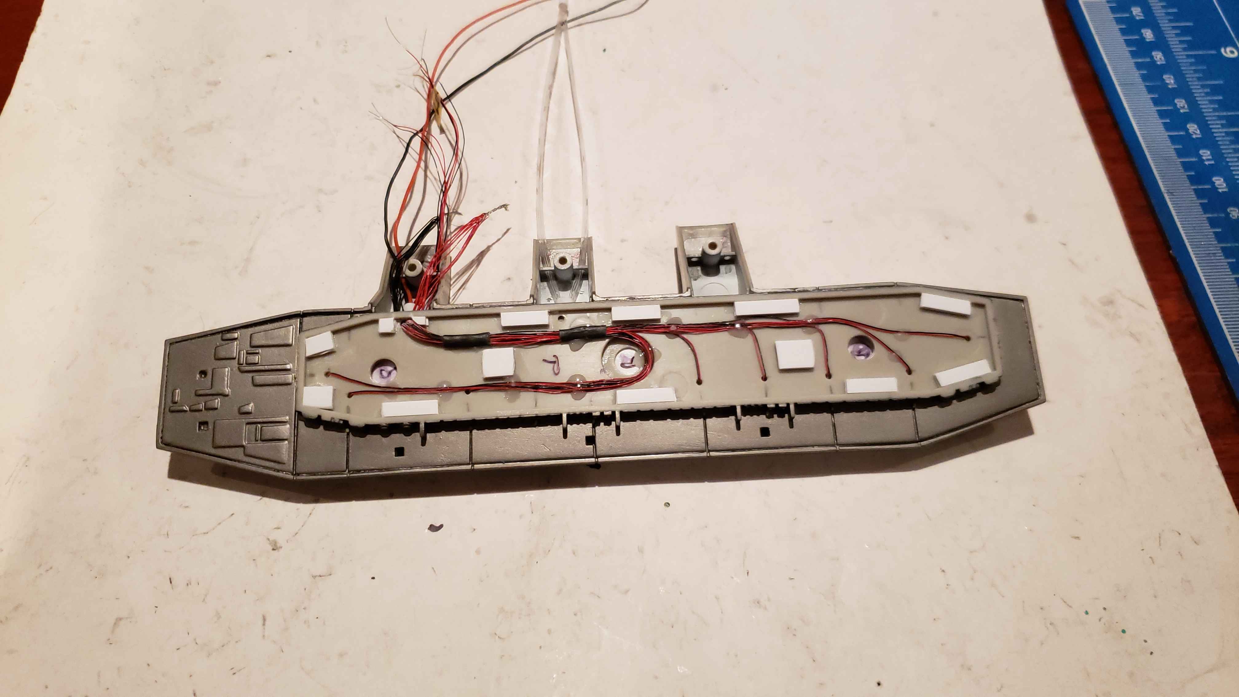

Light blocking middle section and wiring the engines:
20190209_161007smaller.jpg 20190209_162330smaller.jpg 20190210_151536smaller.jpg 20190210_151604smaller.jpg 20190210_151629smaller.jpg 20190210_151749smaller.jpg 20190210_151934smaller.jpg

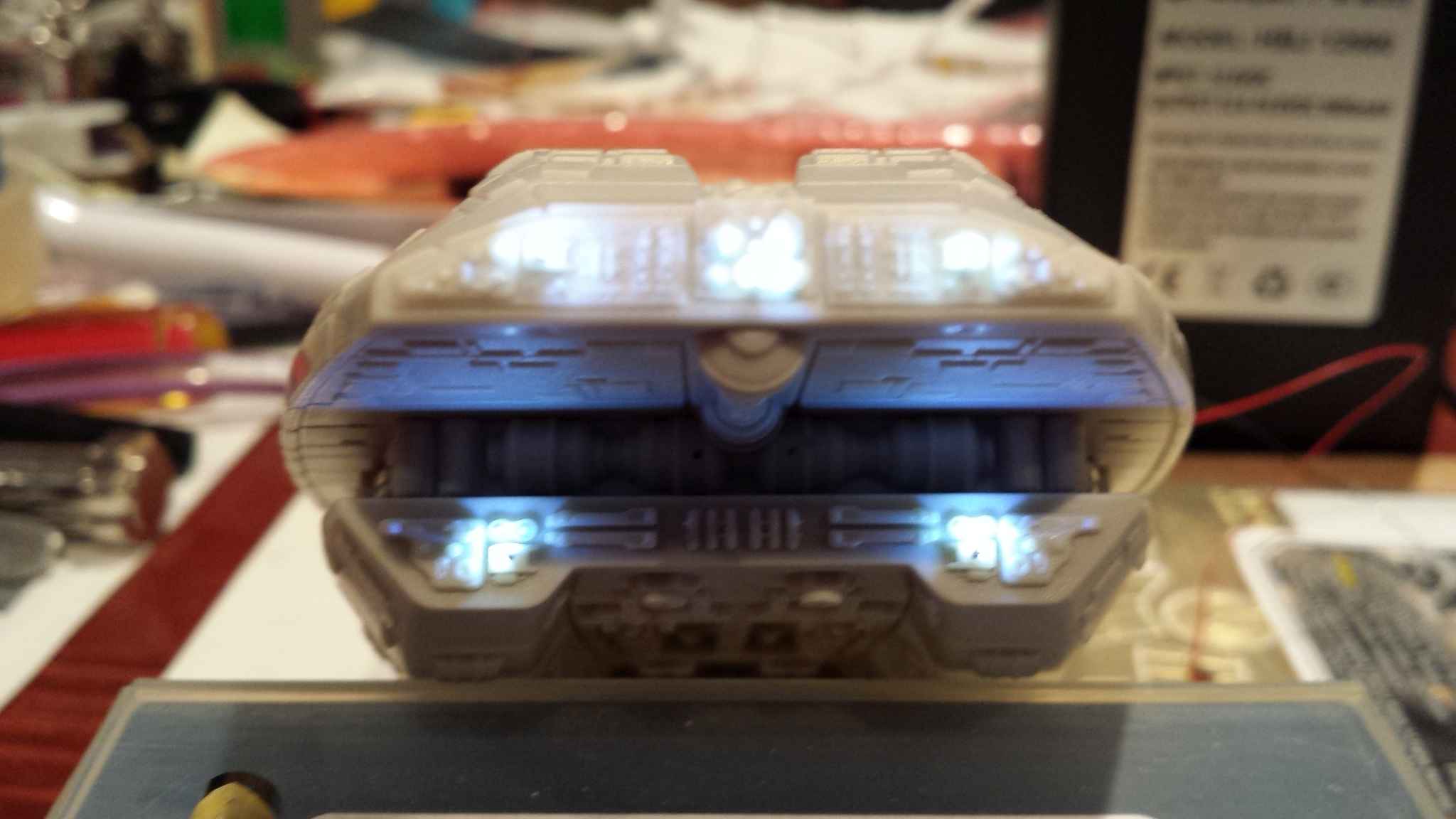

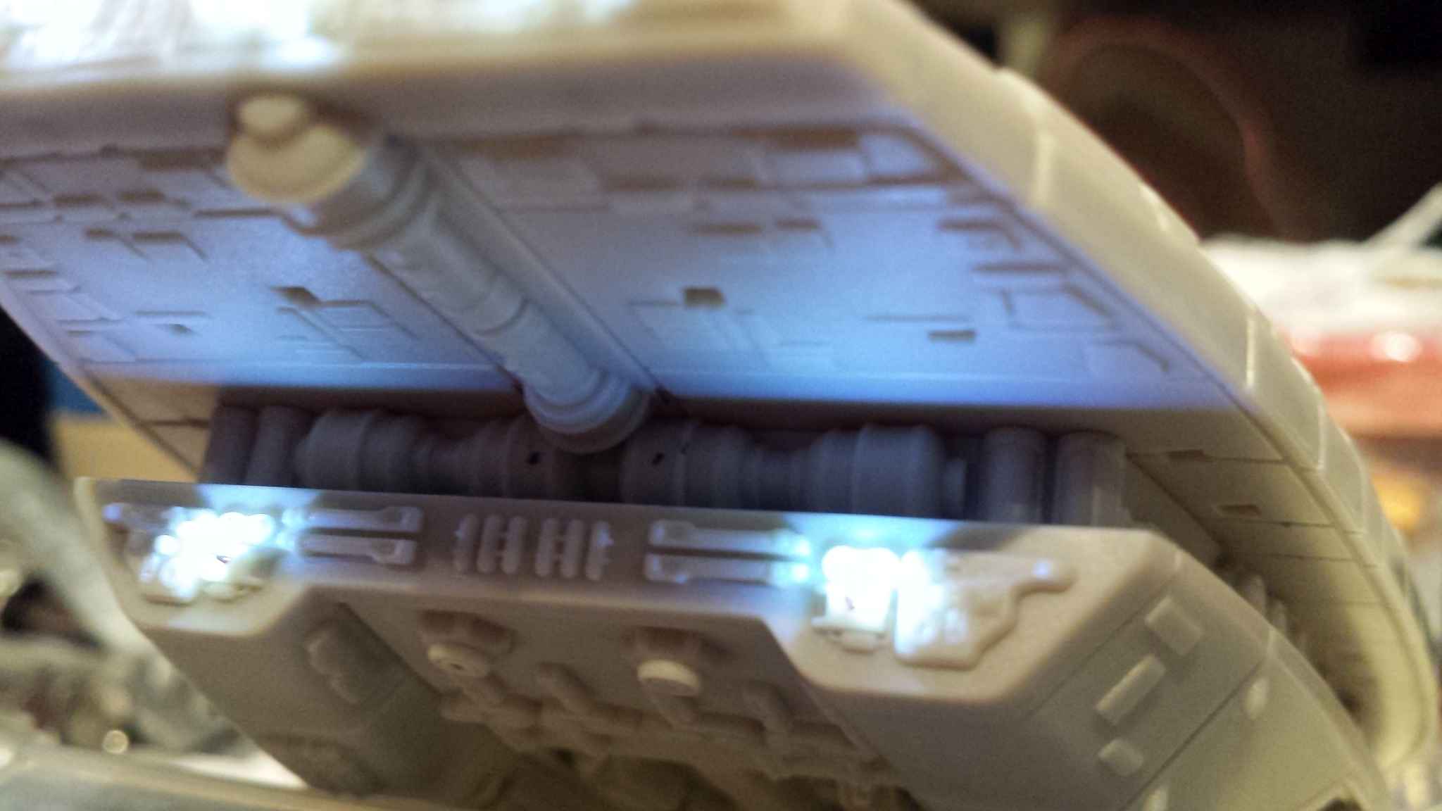

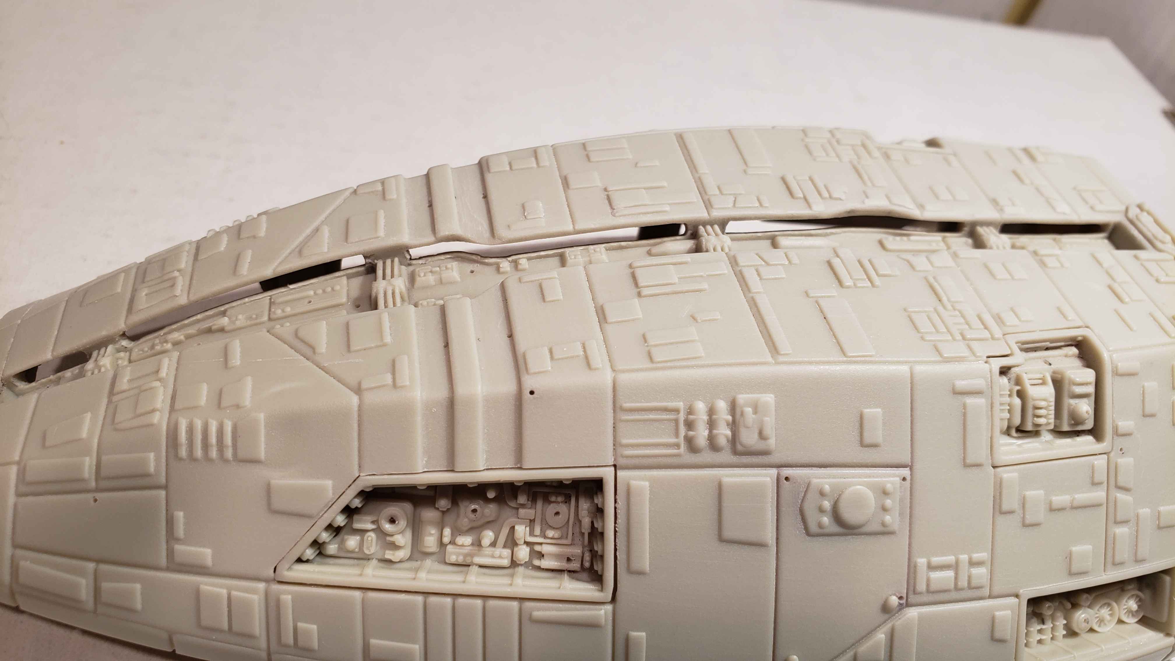

Test lighting on the sides of hanger bay, head, front & Logo with super small 0402 SMD. The camera overexposed the pictures of the lights. They are much dimmer and look very close to the way it show in the series. Nothing is light block or painted so it should look real good when that is all done. Lighting on this ship is going to be a tribrid mix of ambient lighting, Fiber optics and at least 50 super small 0402 SMDs. Currently I only have (6) 0402 SMD to work with for these tests. 100 are on order.
20190228_204815smaller.jpg 20190228_205427smaller.jpg 20190302_213148smaller.jpg 20190302_213209smaller.jpg 20190302_213219smaller.jpg 20190302_213250smaller.jpg 20190303_190243smaller.jpg 20190303_190304smaller.jpg 20190303_211943smaller.jpg 20190303_211957smaller.jpg

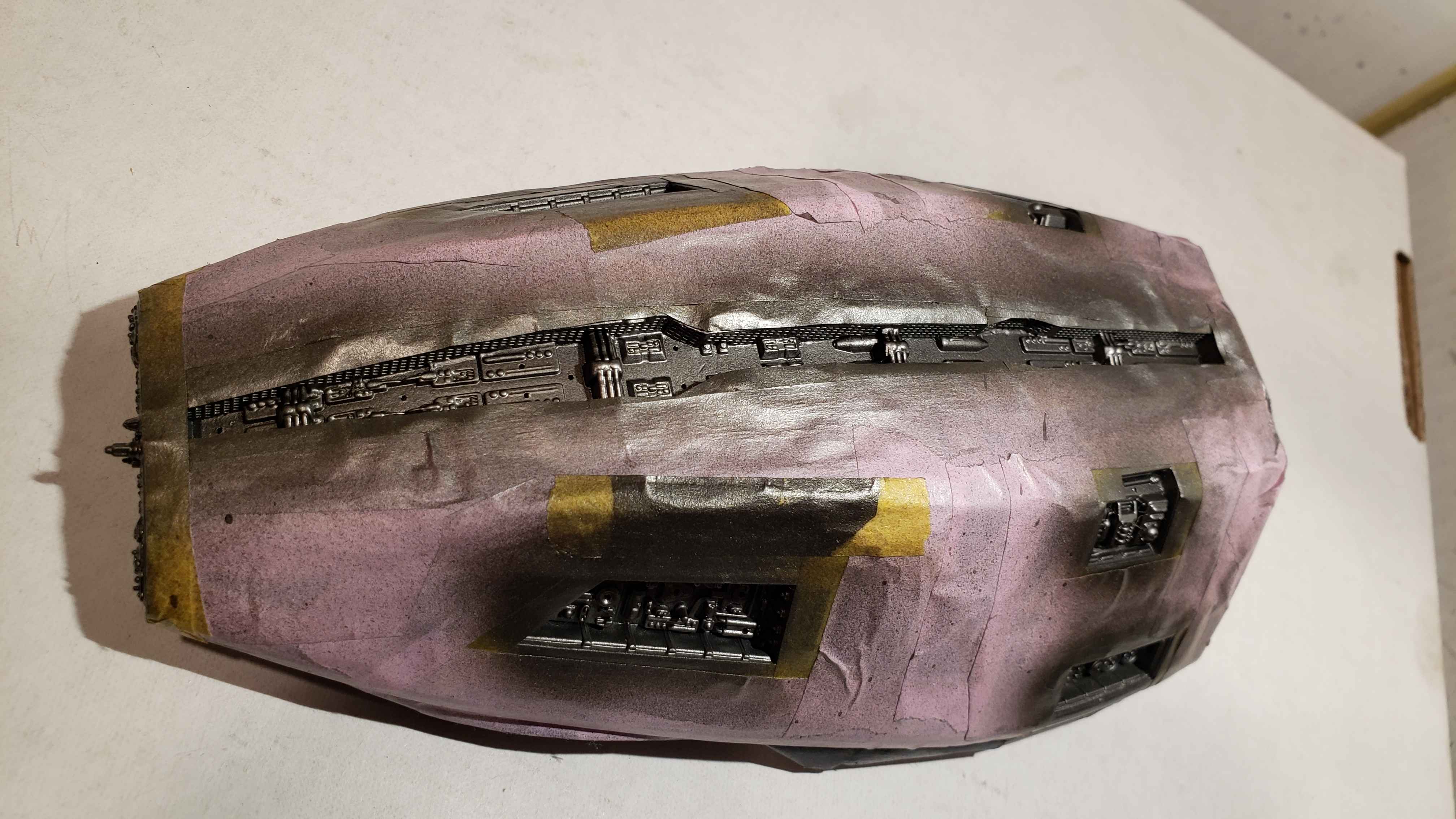

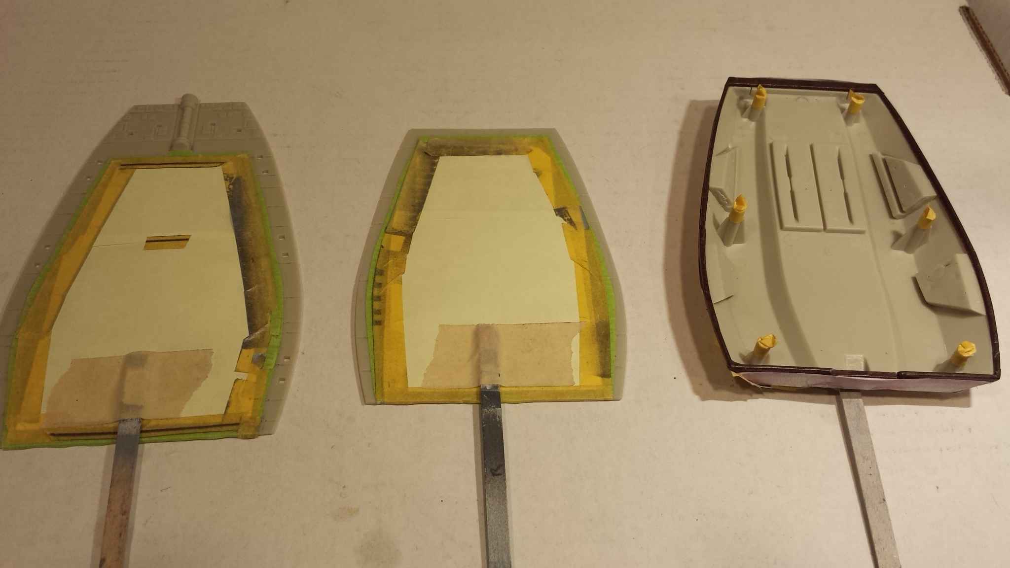

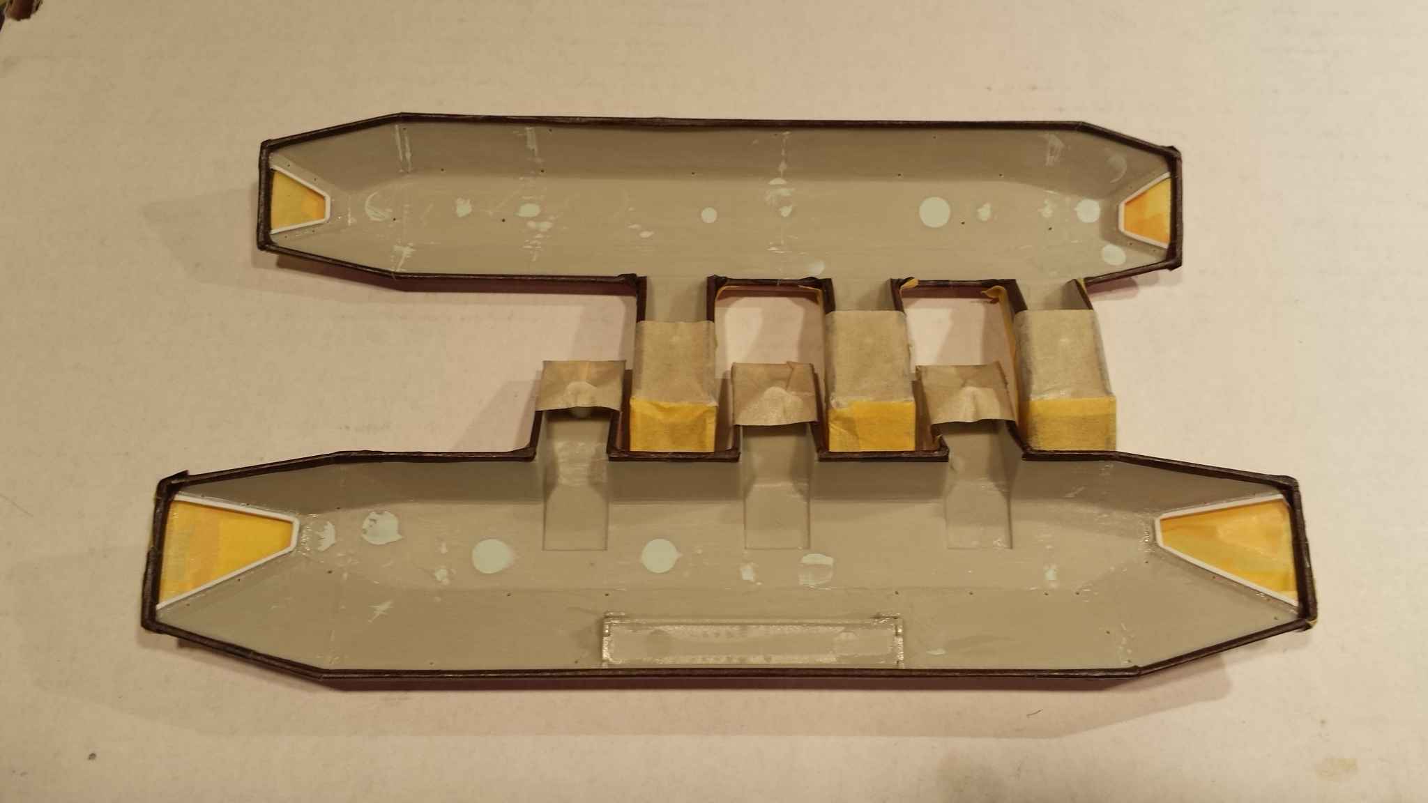

More light blocking:
20190302_125647smaller.jpg 20190302_125658smaller.jpg 20190302_125706smaller.jpg 20190302_125722smaller.jpg 20190302_133031smaller.jpg 20190302_133049smaller.jpg 20190302_162507smaller.jpg 20190302_165455smaller.jpg 20190303_131146smaller.jpg 20190303_131155smaller.jpg 20190303_200756smaller.jpg 20190303_200820smaller.jpg

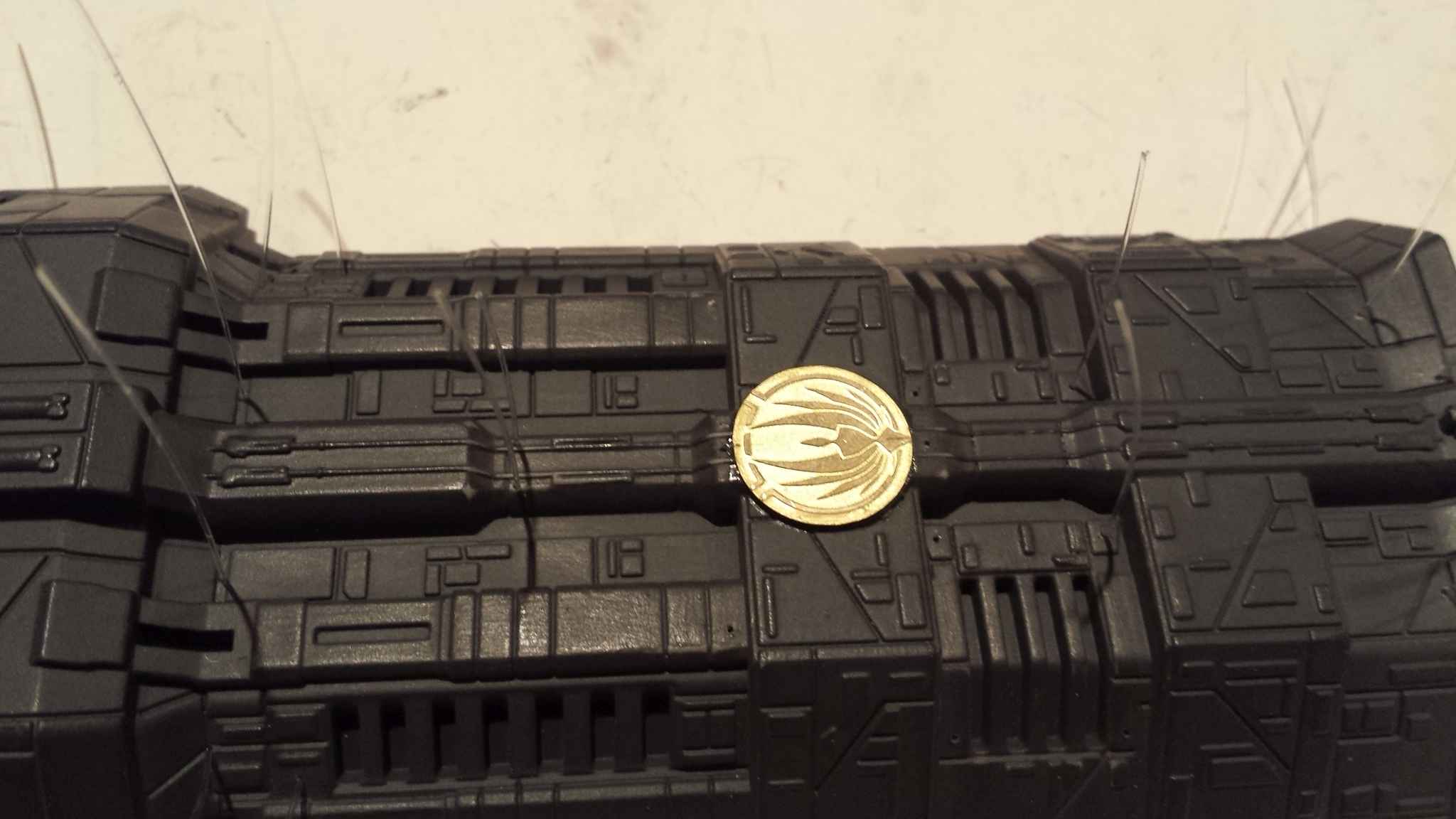

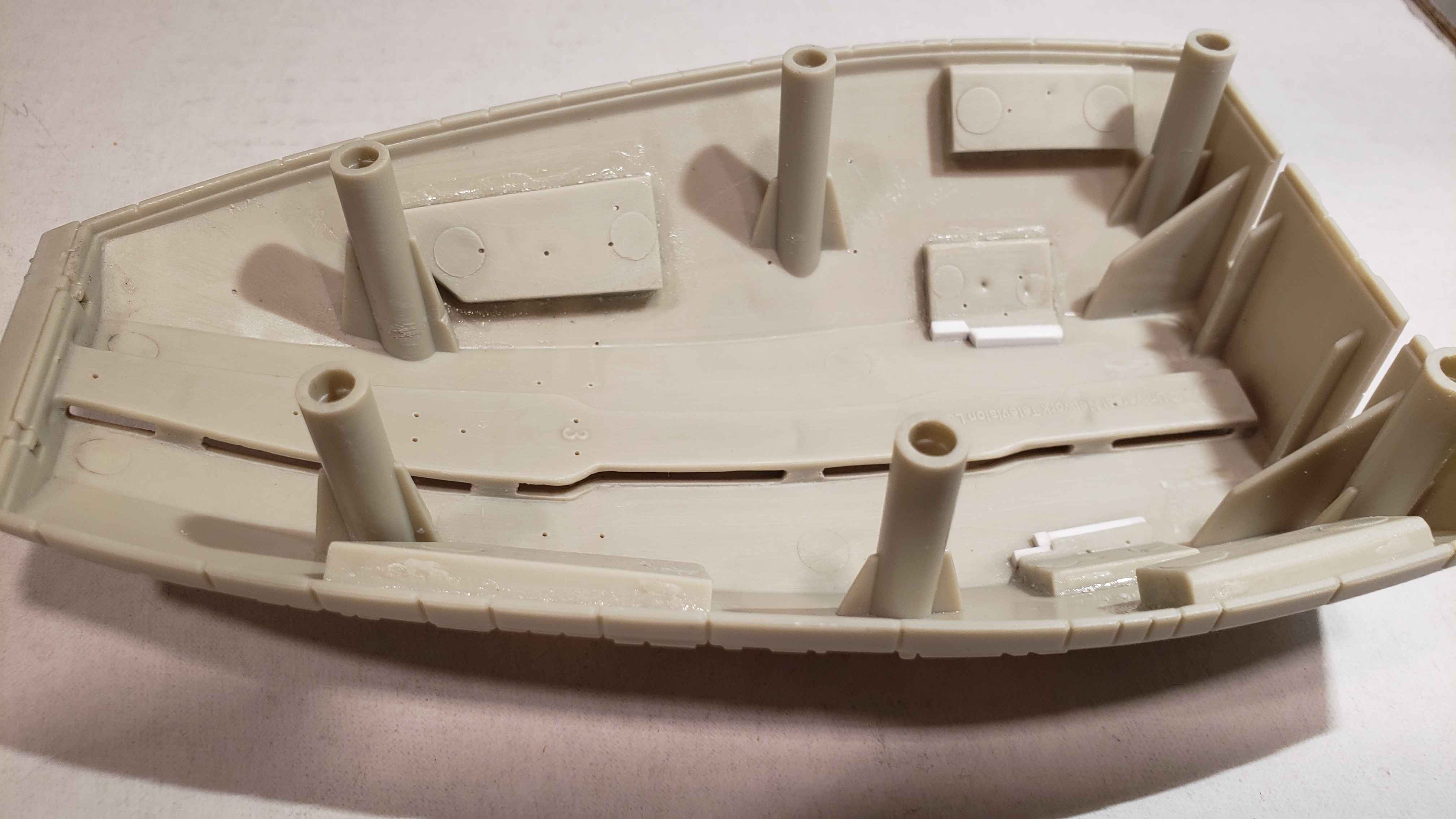

Wired and primed the landing bays. Glued on the photetched emblem and other odds and ends. Going to be laying the decals for the landing bays and then closing them up.

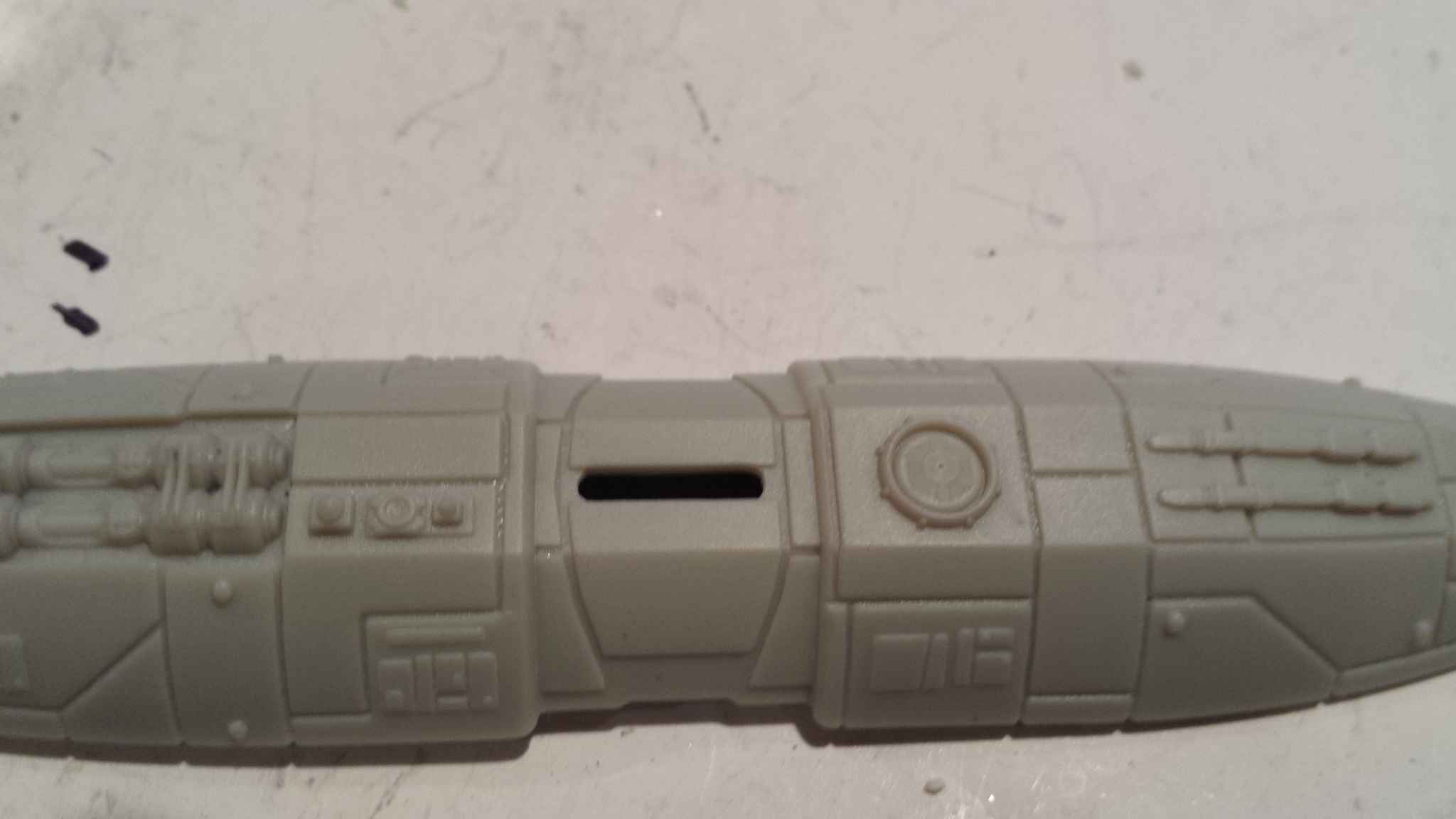

Cutout the slots on both sides of the trench for the photo-etch and finished up clear coating the landing bays. Going to be installing the rest of the fiber optics, 0402 SMDs and then start to close up sections starting with the landing bays.

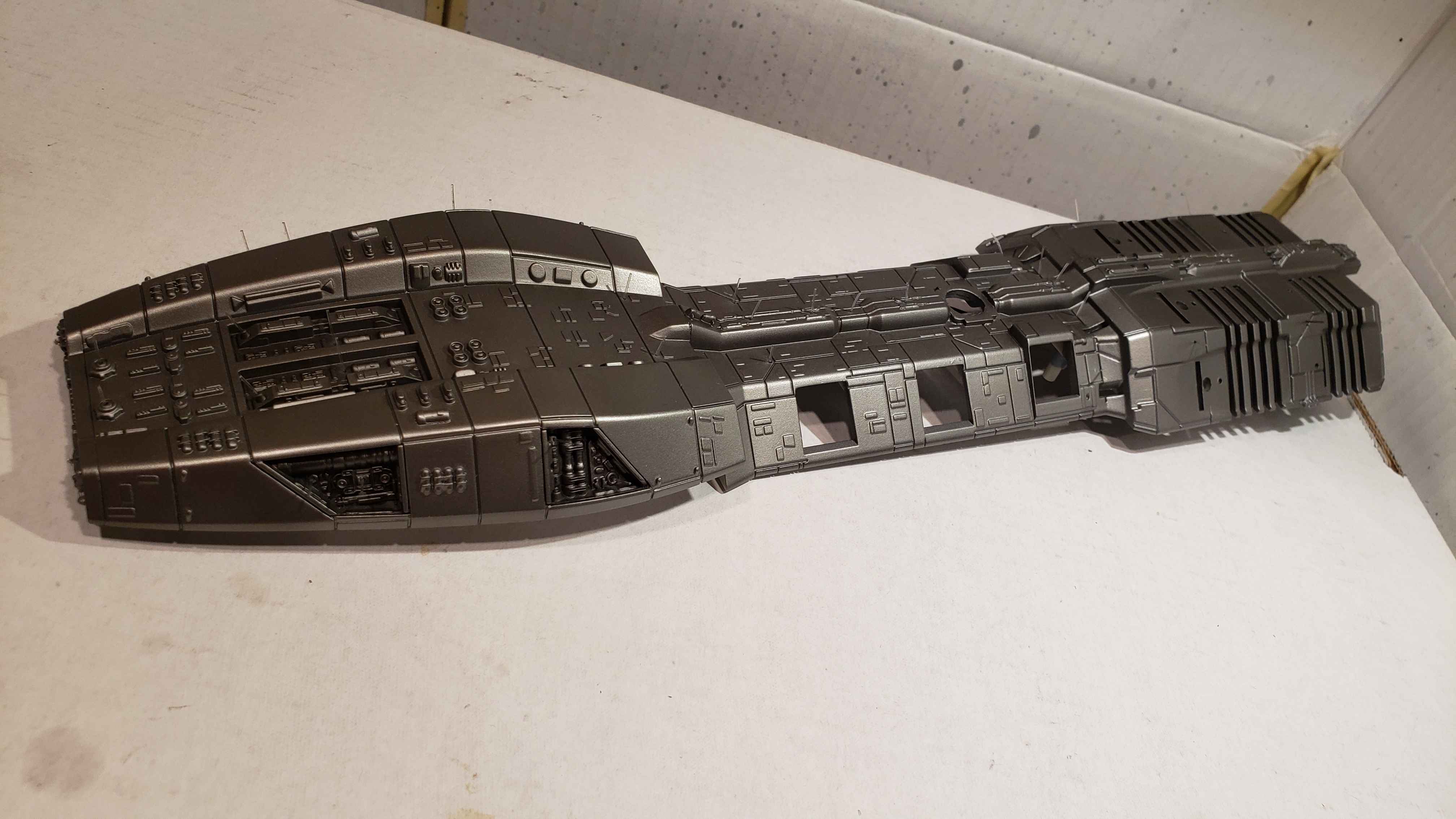

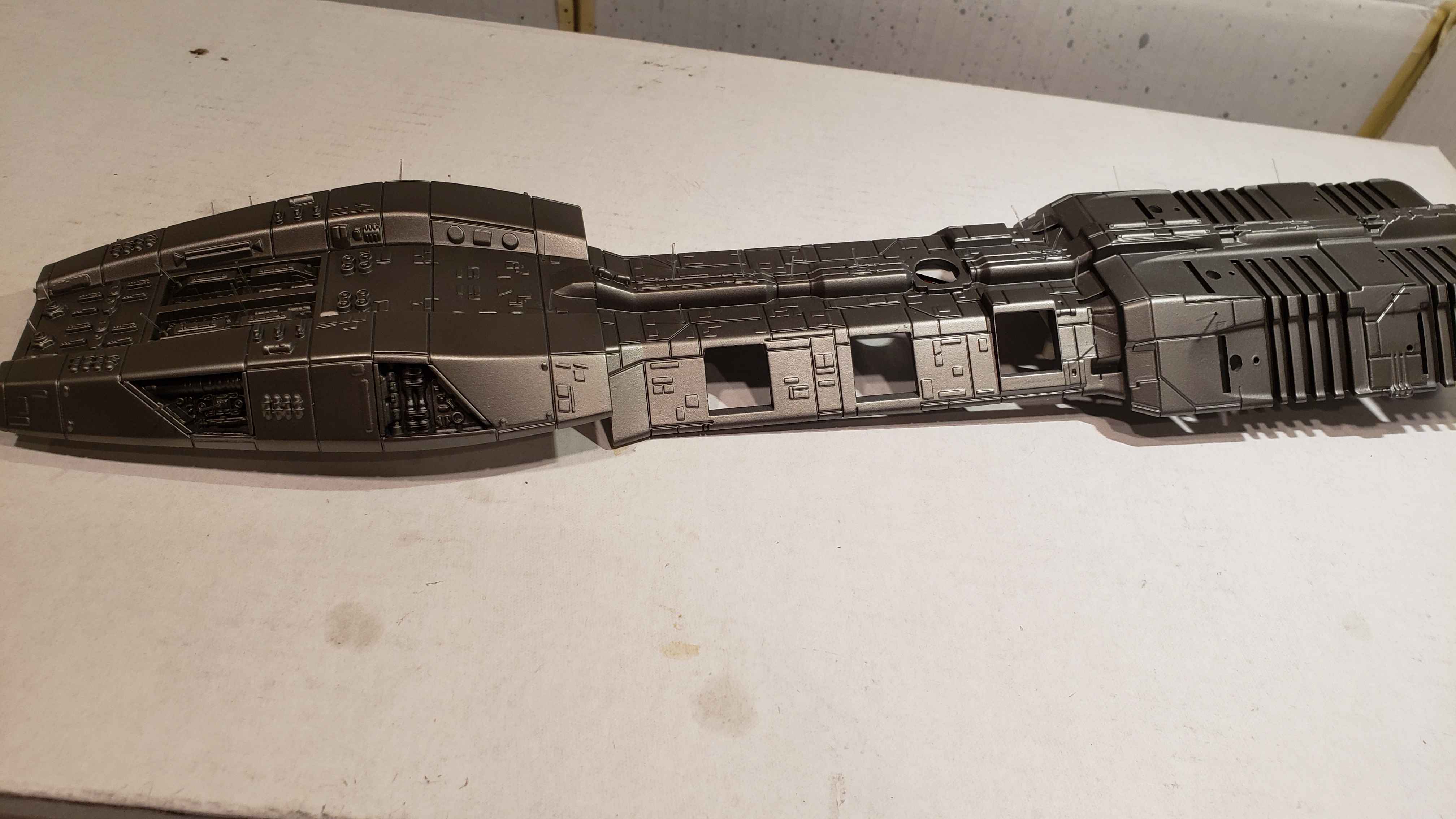

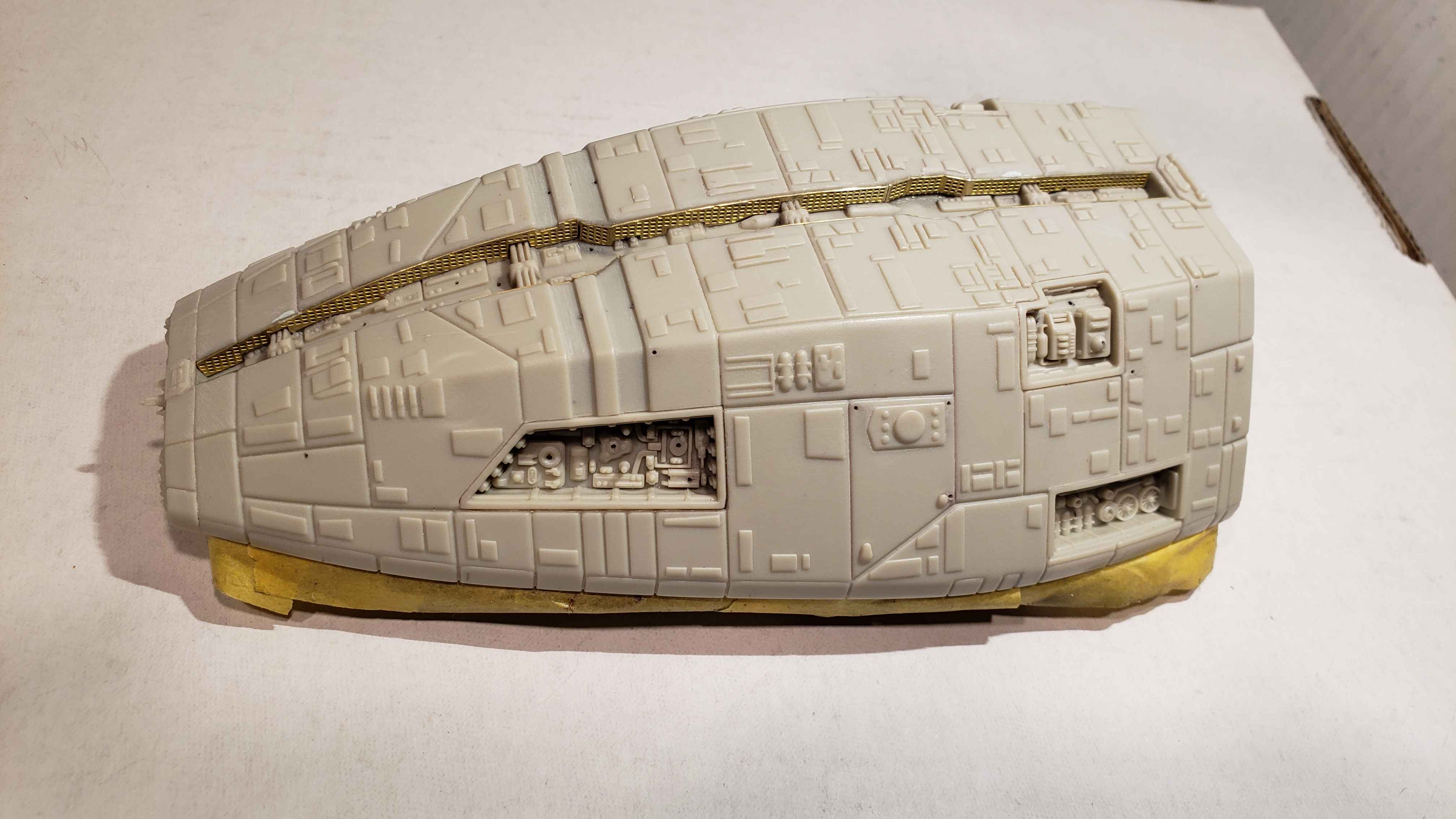

What a nice color choice. Alclad?
Yes...spot on!!
I first sprayed Alclad Duraluminum over the dark gray primer and I thought it was too light and silvery. So I took Alclad Magnesium and thinned it 50/50 and lightly sprayed it over the dark aluminum and got this darker shade.
Inside the ribbed areas and the recesses on the head is Alclad Steel

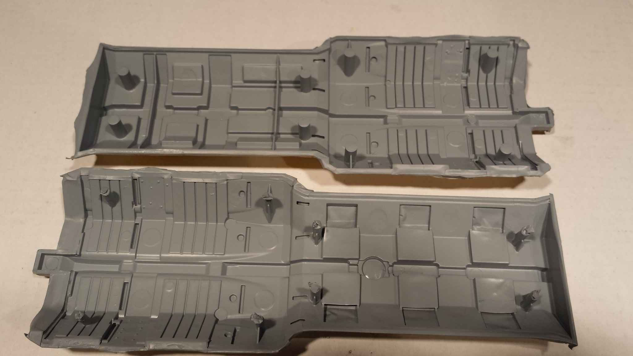

Closing up ship....Assembled the bays to the lower hull
Engines will go on tonight. I will start connecting all the lines and hopefully by the weekend will join the top with the bottom.

Connect all the wiring,
