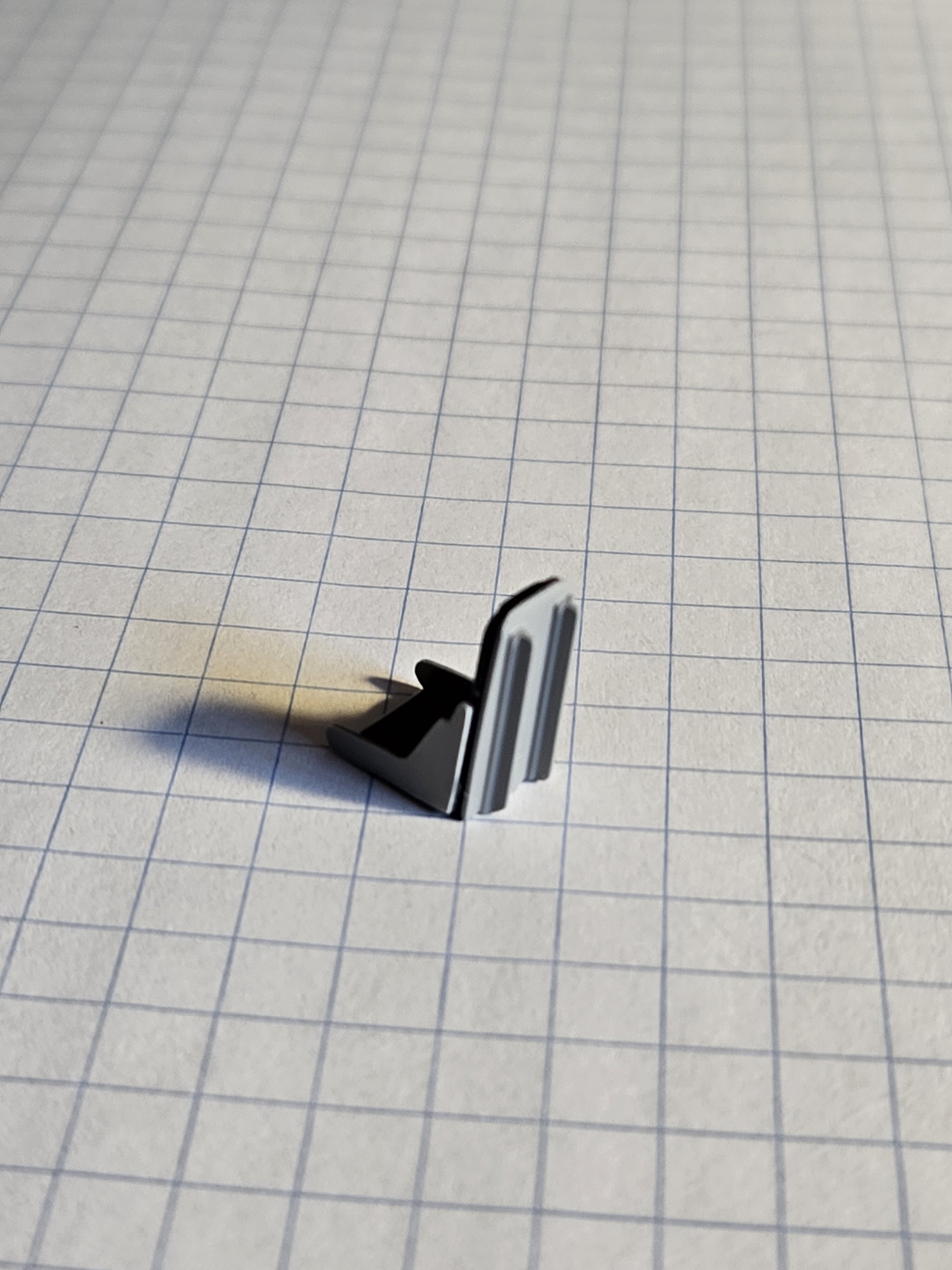

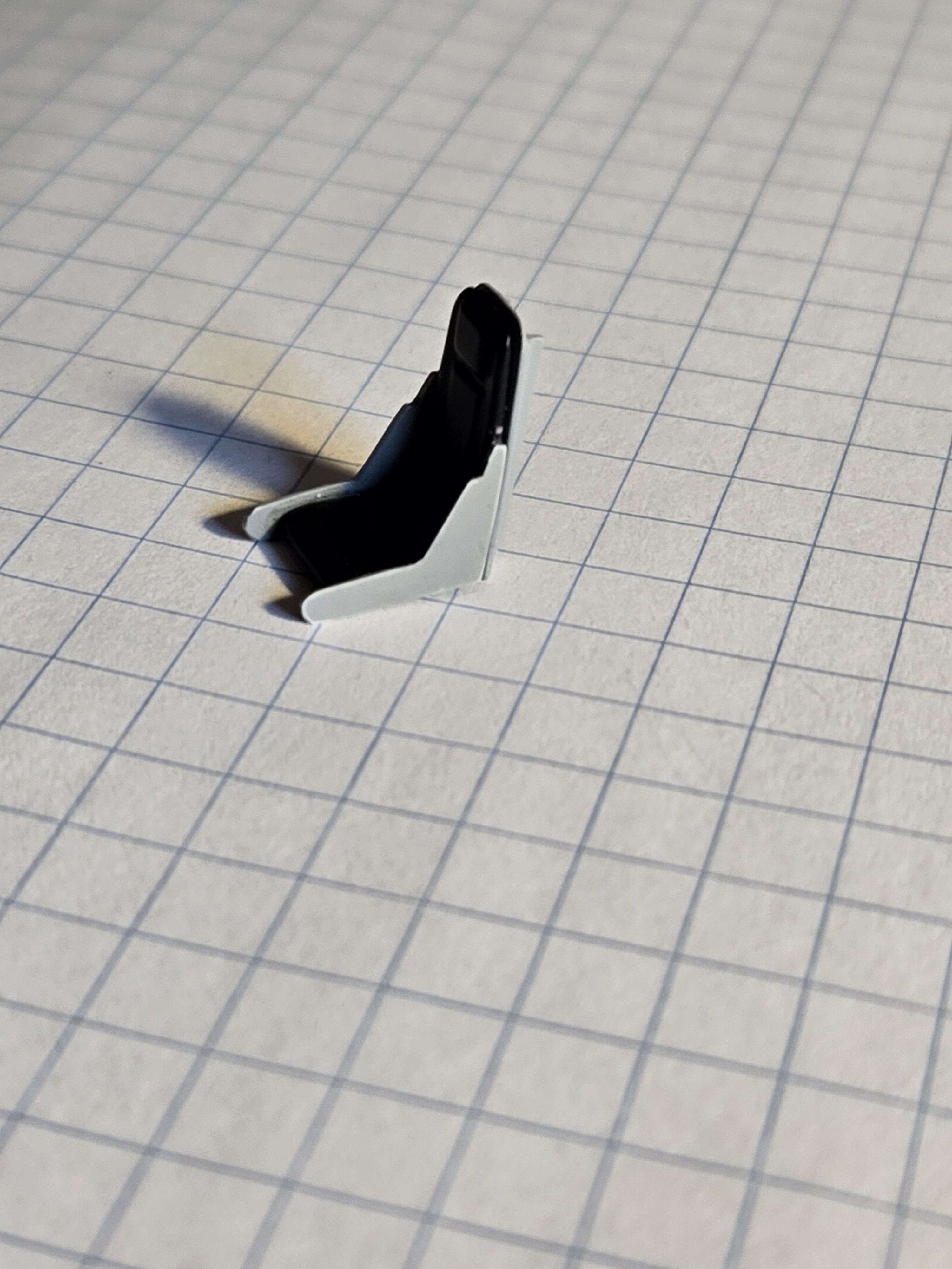

Here are previous pics of the cockpit pit .

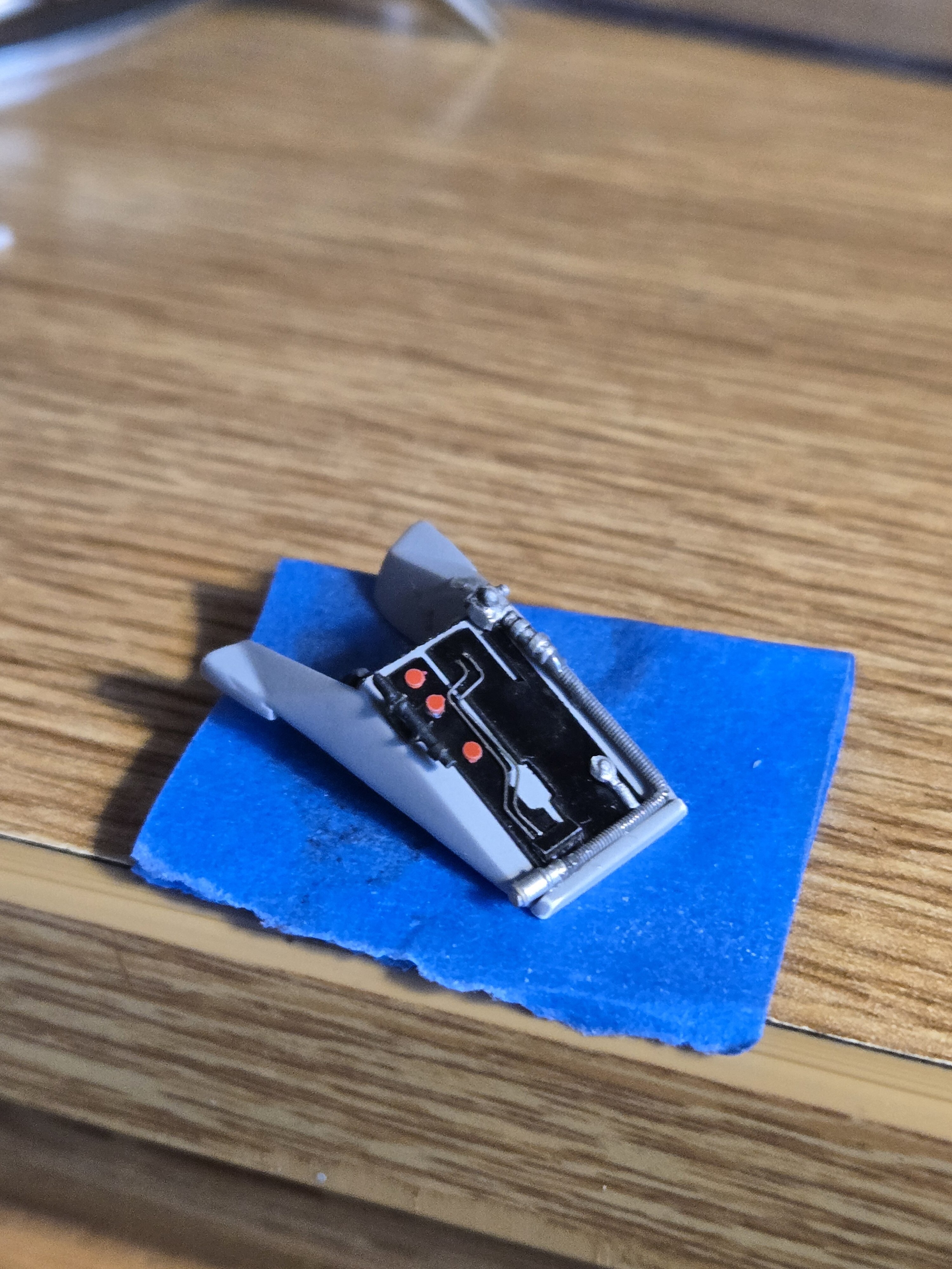

This is the front cockpit dash , which is scratch built using a photo etched center console ment for the bandi X-wing .Which has more accurate dimensions than the one intend for the Finemold/ Revell X-Wing , which is what I use for (Gift to a friend X-Wing). And I do have a Bandi X-Wing to build
This pic , has the front dash painted and next to it are 2 black panels that go on top of the dash . I used styrene strips instead of just painting the panels on, as I did to the previous build. It was very hard to mask to and represent the notches in the panels. With the strips , I filed the notches and sanded the strips to where they are very thin.
There is a throttle lever that is painted German Grey, it will be mounted next to the pilots right leg . Then the silver piece goes onto top of the dash , then there is the scope that I used from 1/35 weapon set, and used photo etched for the mount.
So on the dash/ console there will more little panels and knobs ect, that will be added , even thoughits as been already painted. This is the advantage of using (JB.weld) there is plenty of time before it sets up and any unwanted mess is easy to clean up.
