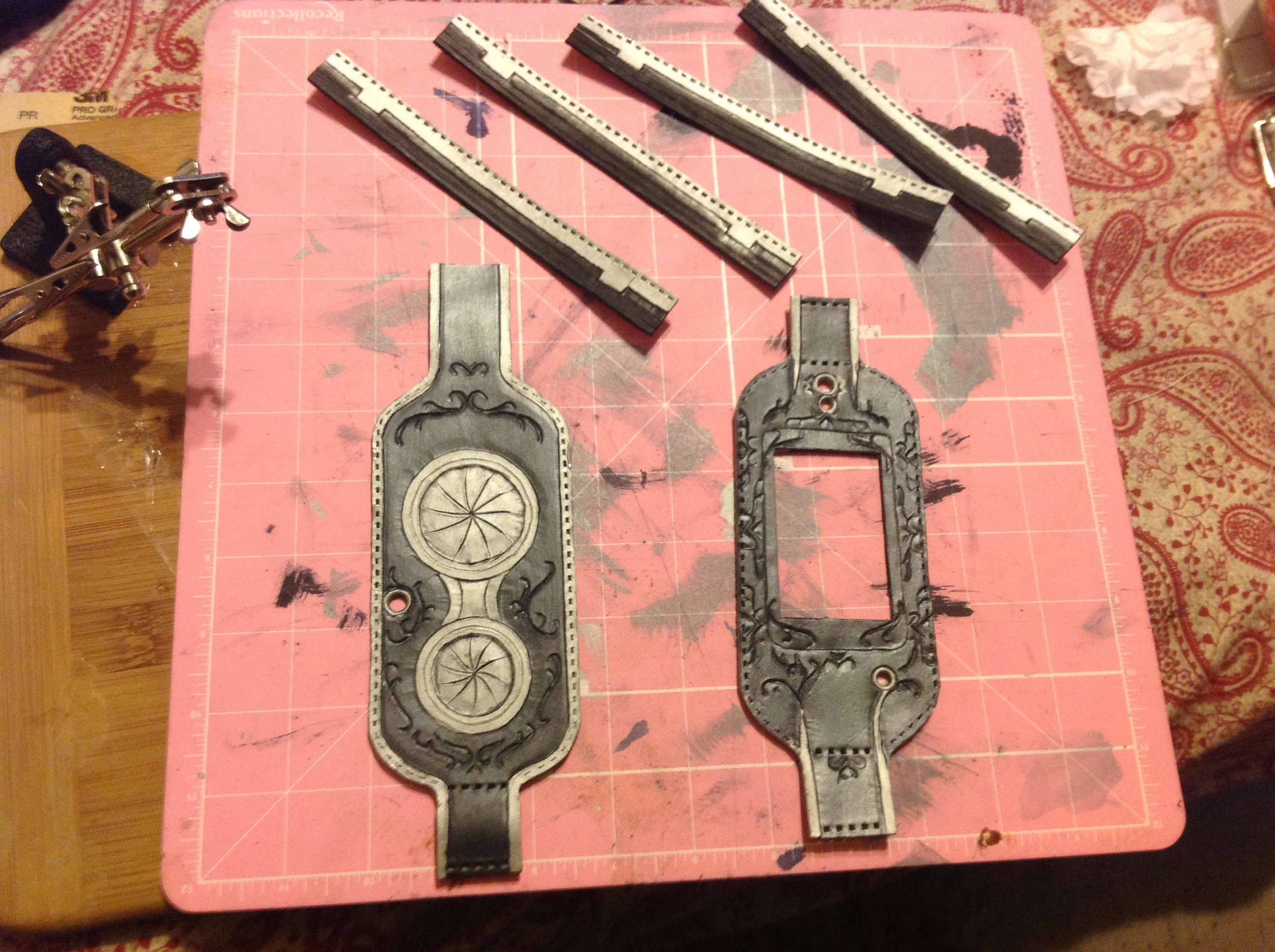

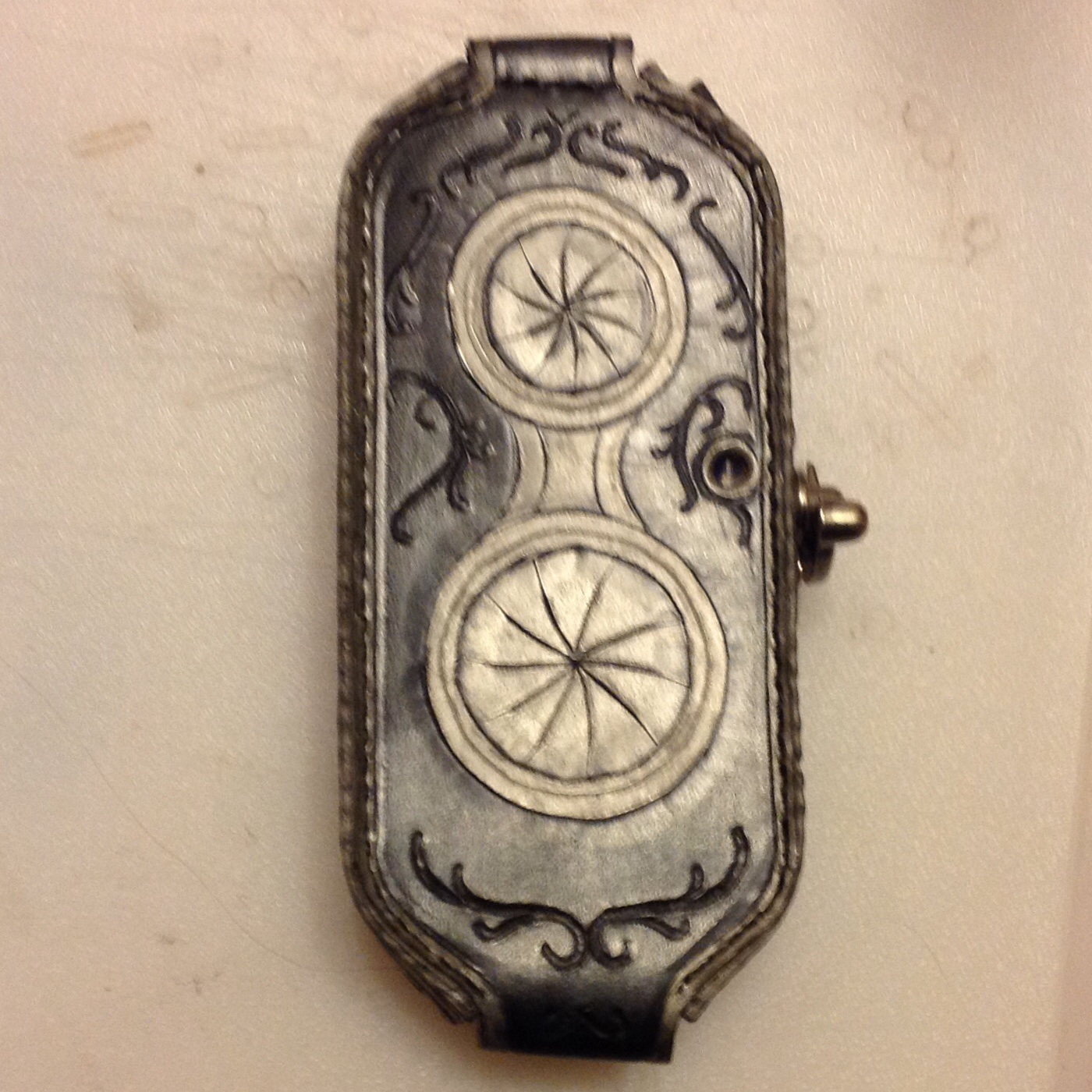

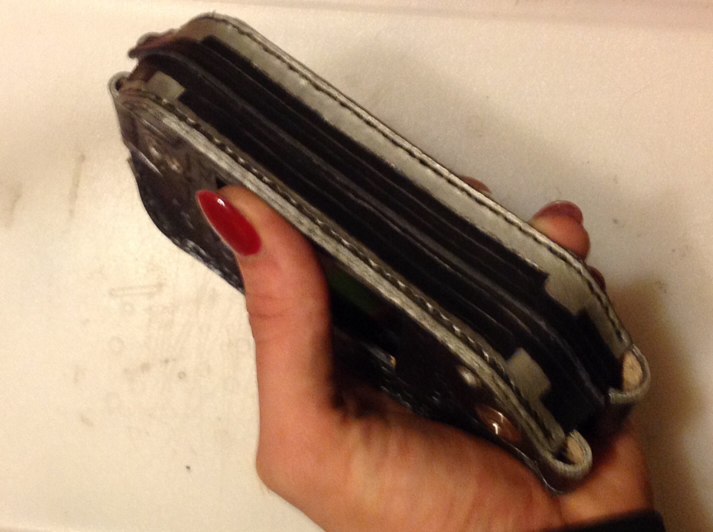

Threw this together the night before Gallifrey One for my Missy costume.

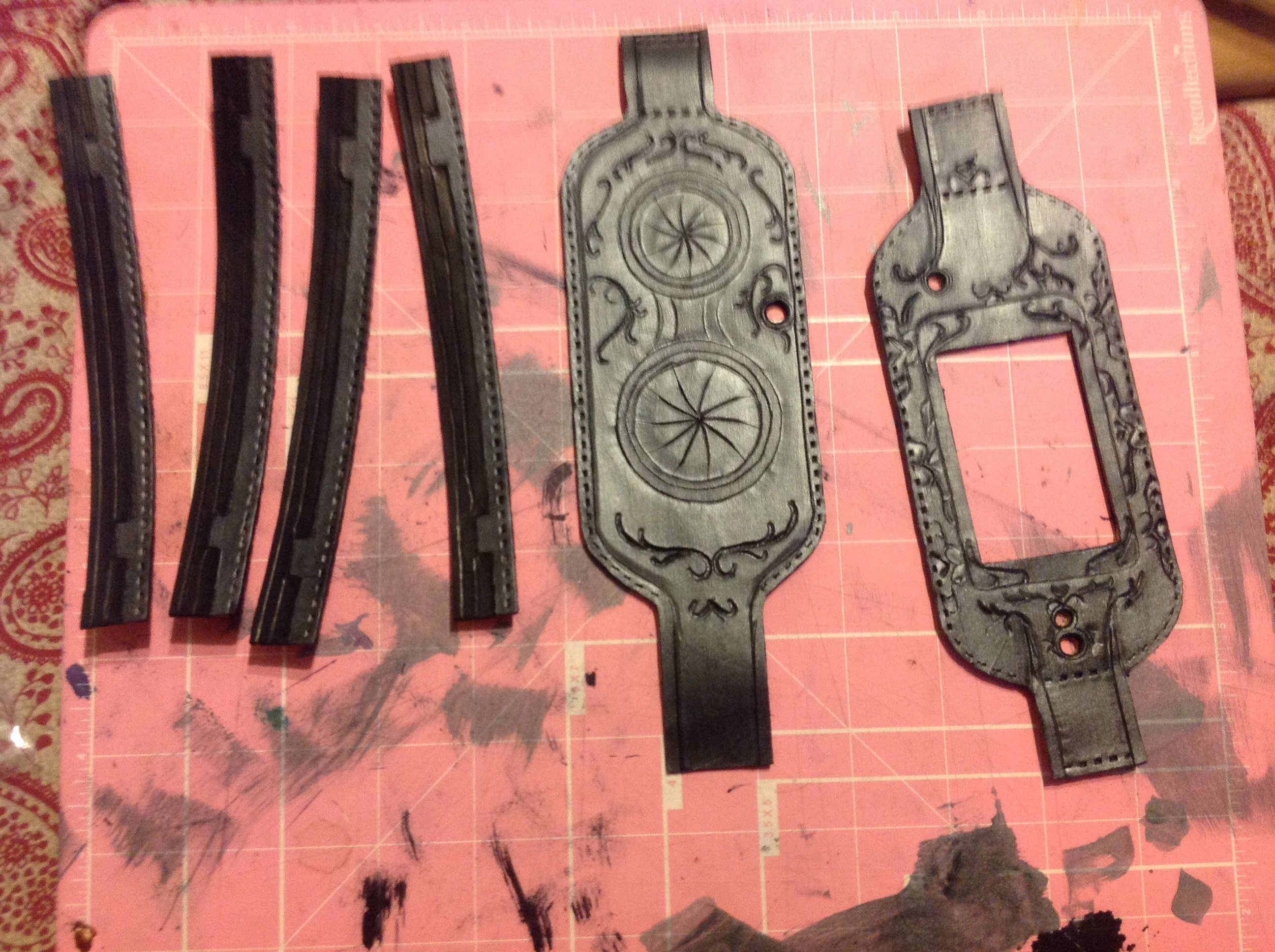

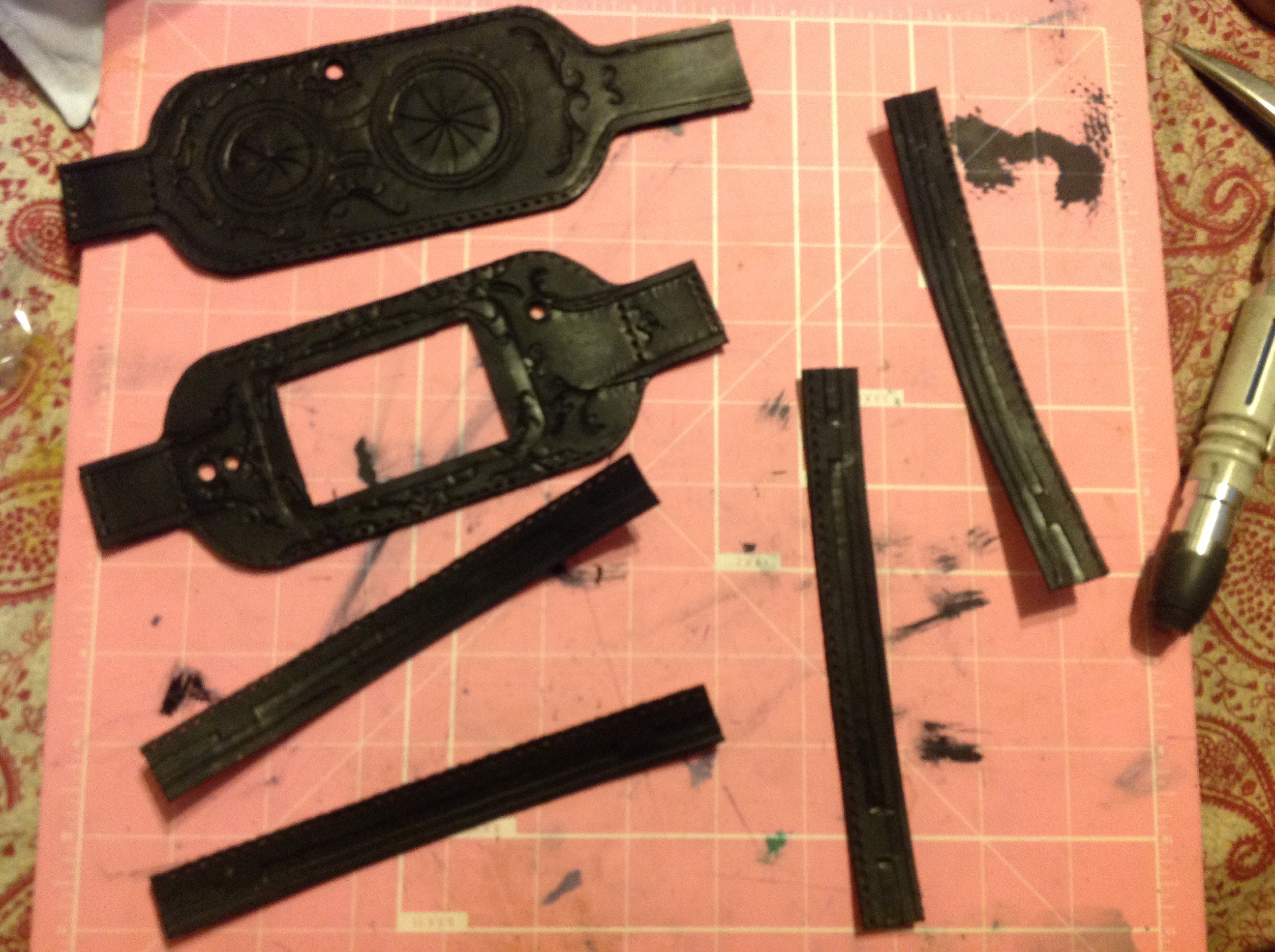

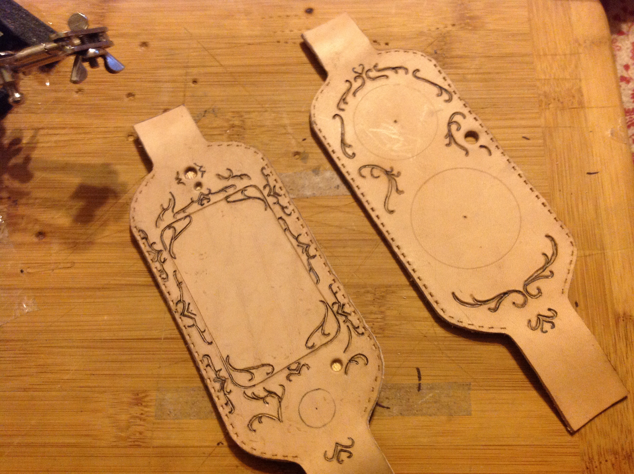

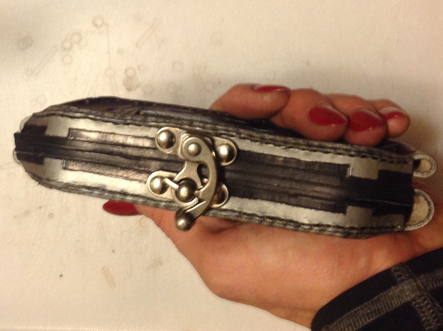

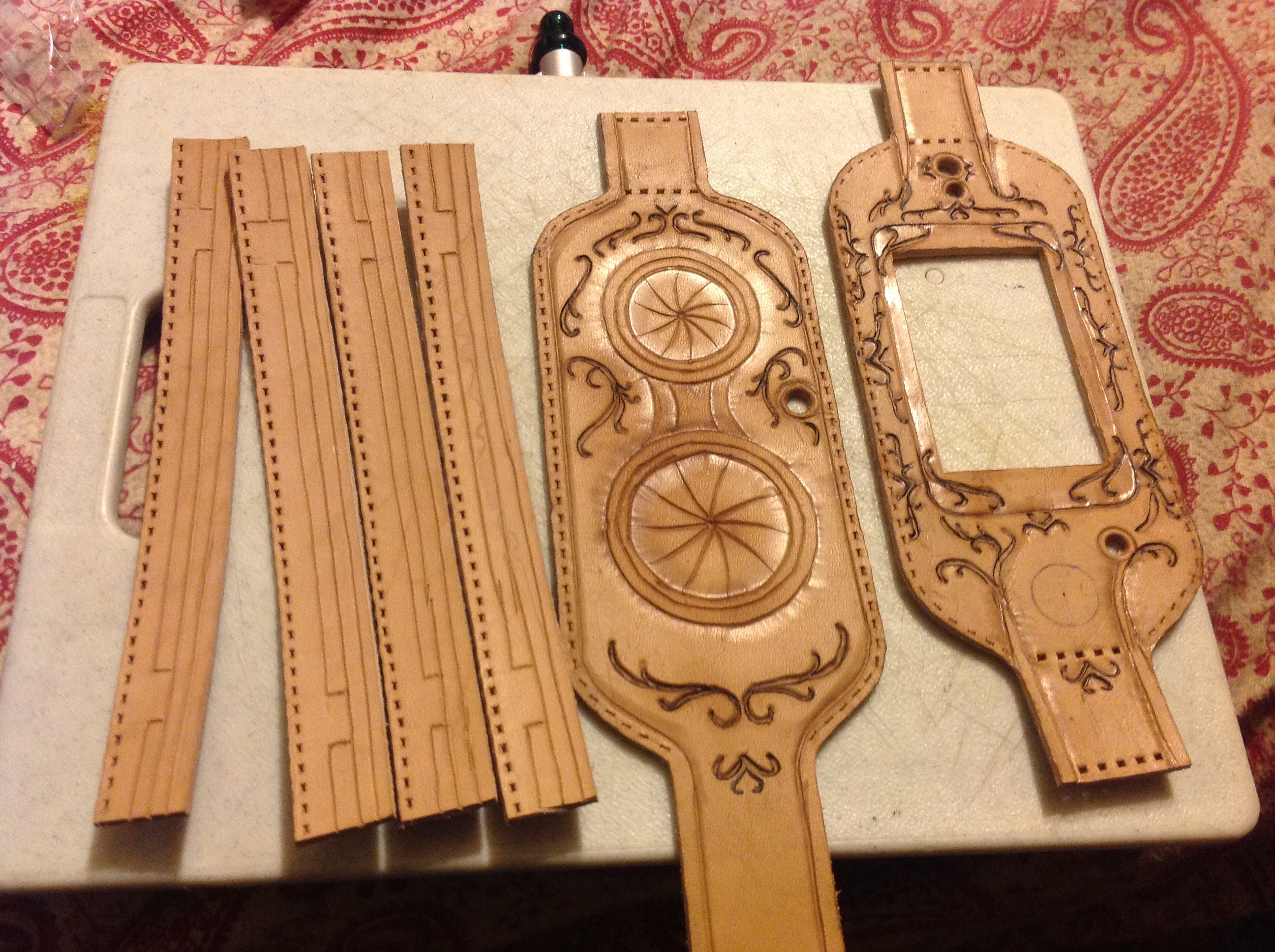

I used 4-5oz vegetable tanned leather which I then tooled it with the correct embellishments before dying and painting. I was in such a rush that I had to sew it on the plane (and forgot rivets for the latch which required a trip to an LA crafts store that I didn't want to leave because it was so awesome) but on the second day it was ready.

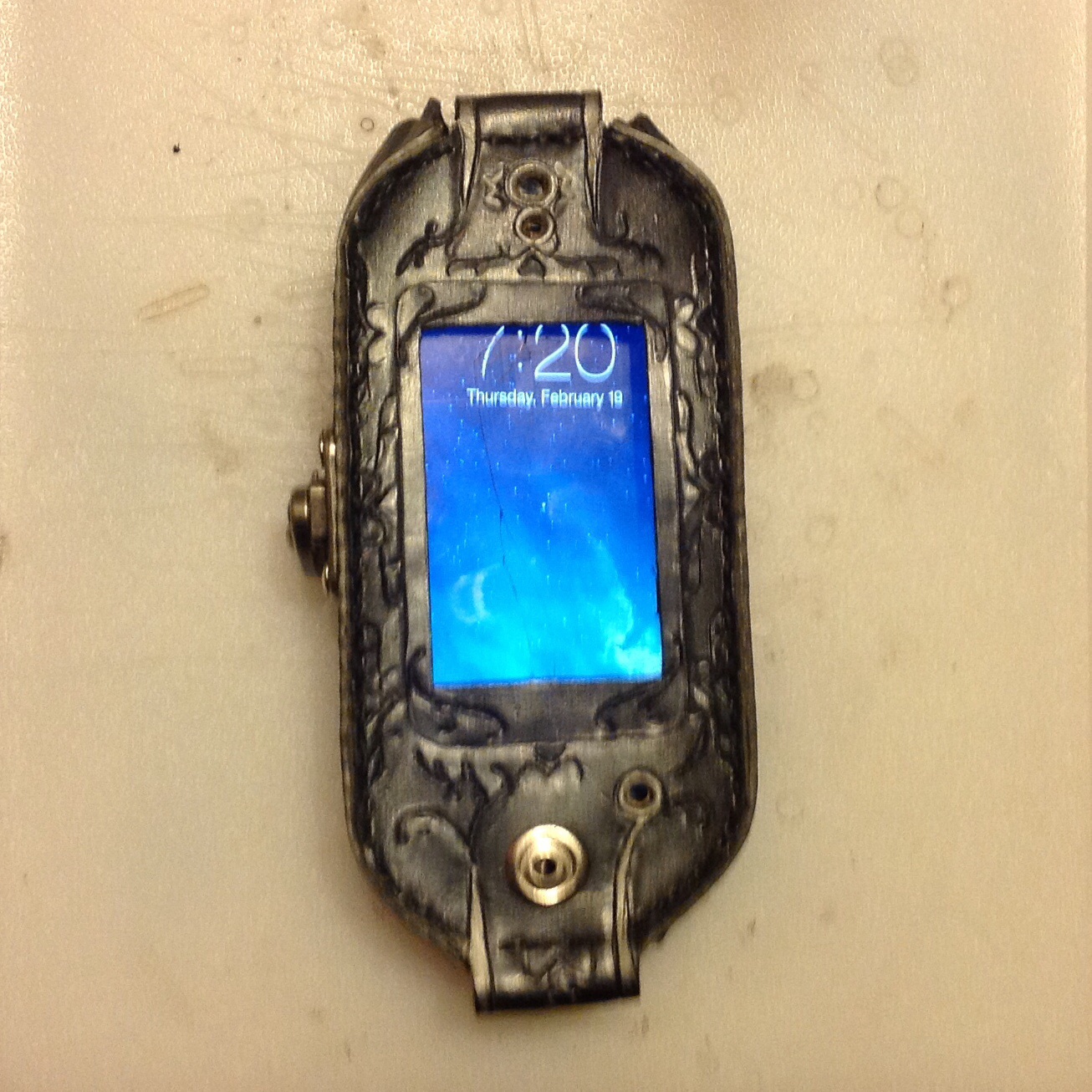

I think for version 2 I'll be cutting the window bigger and adding a clear plastique window for the screen, and inside pockets for the phone to slip into and to hold money, credit cards etc. I'm also toying with the idea of adding some LEDs as well. So far it seems to fit all iPhones up to 5s and while the screen-side camera aligns, I have to line up holes for the rear-facing camera, and side buttons.
