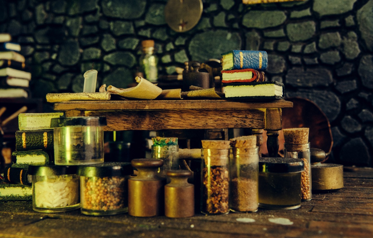

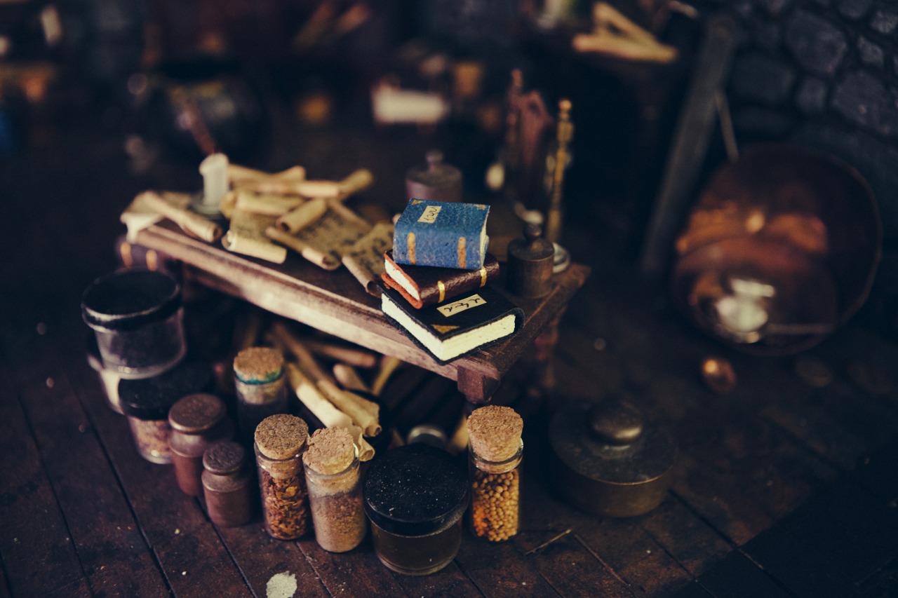

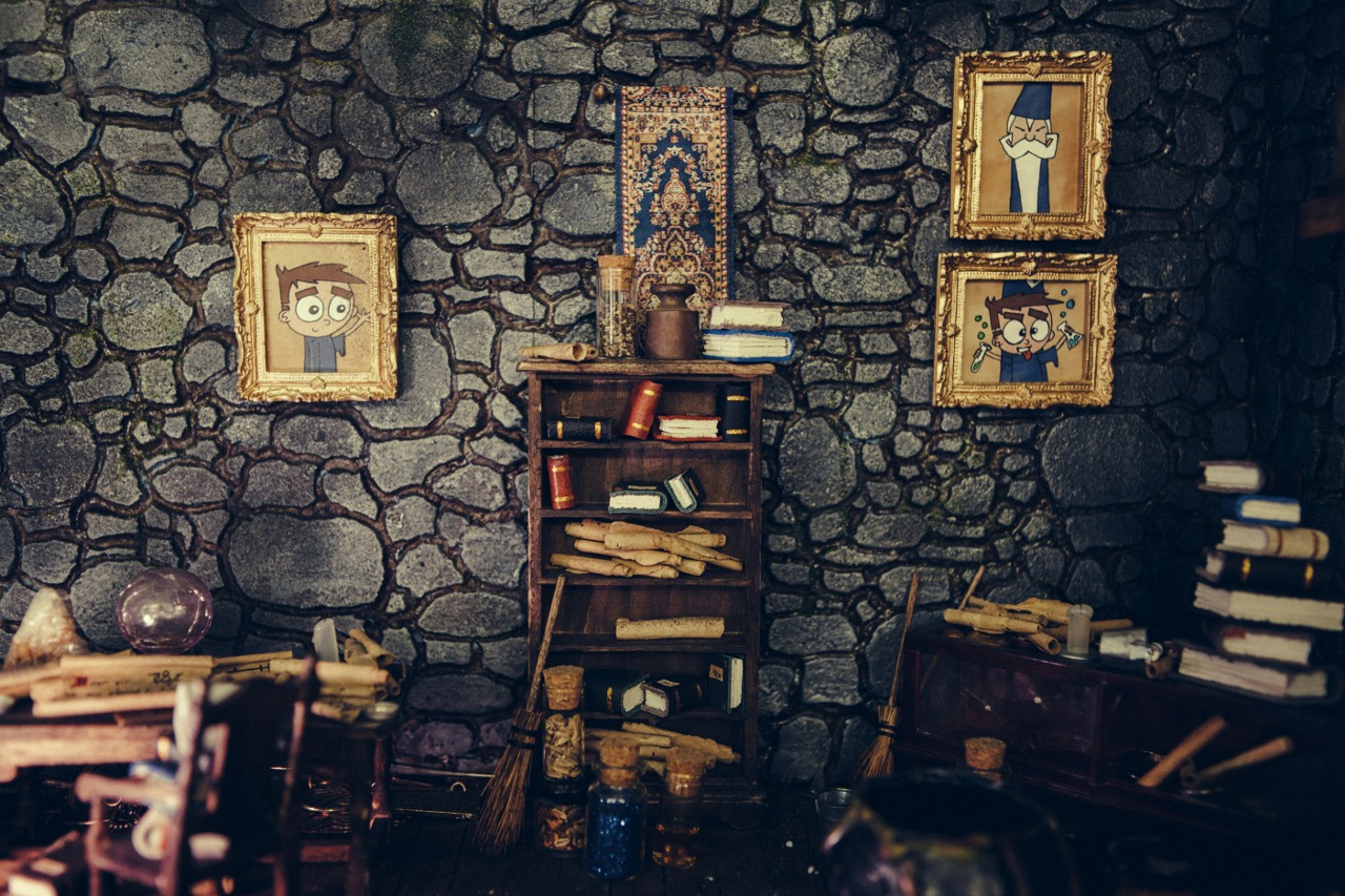

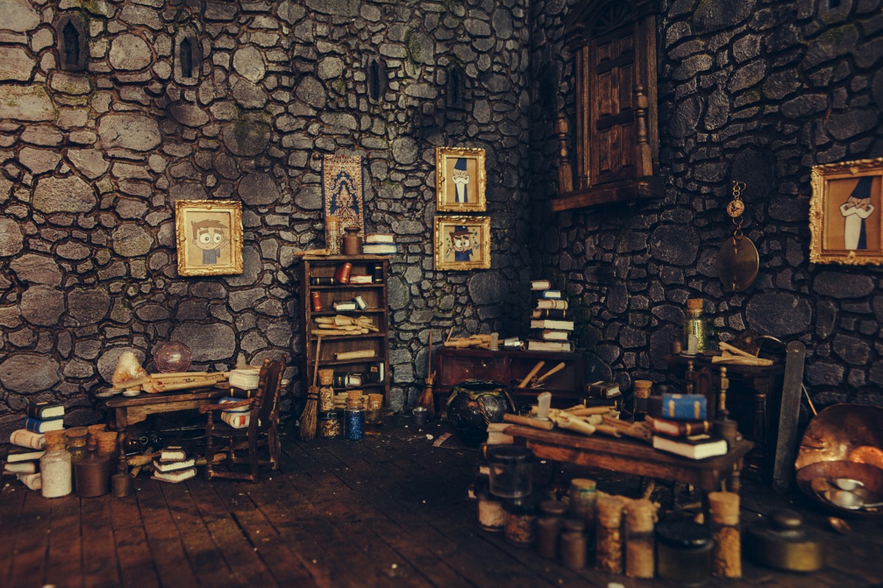

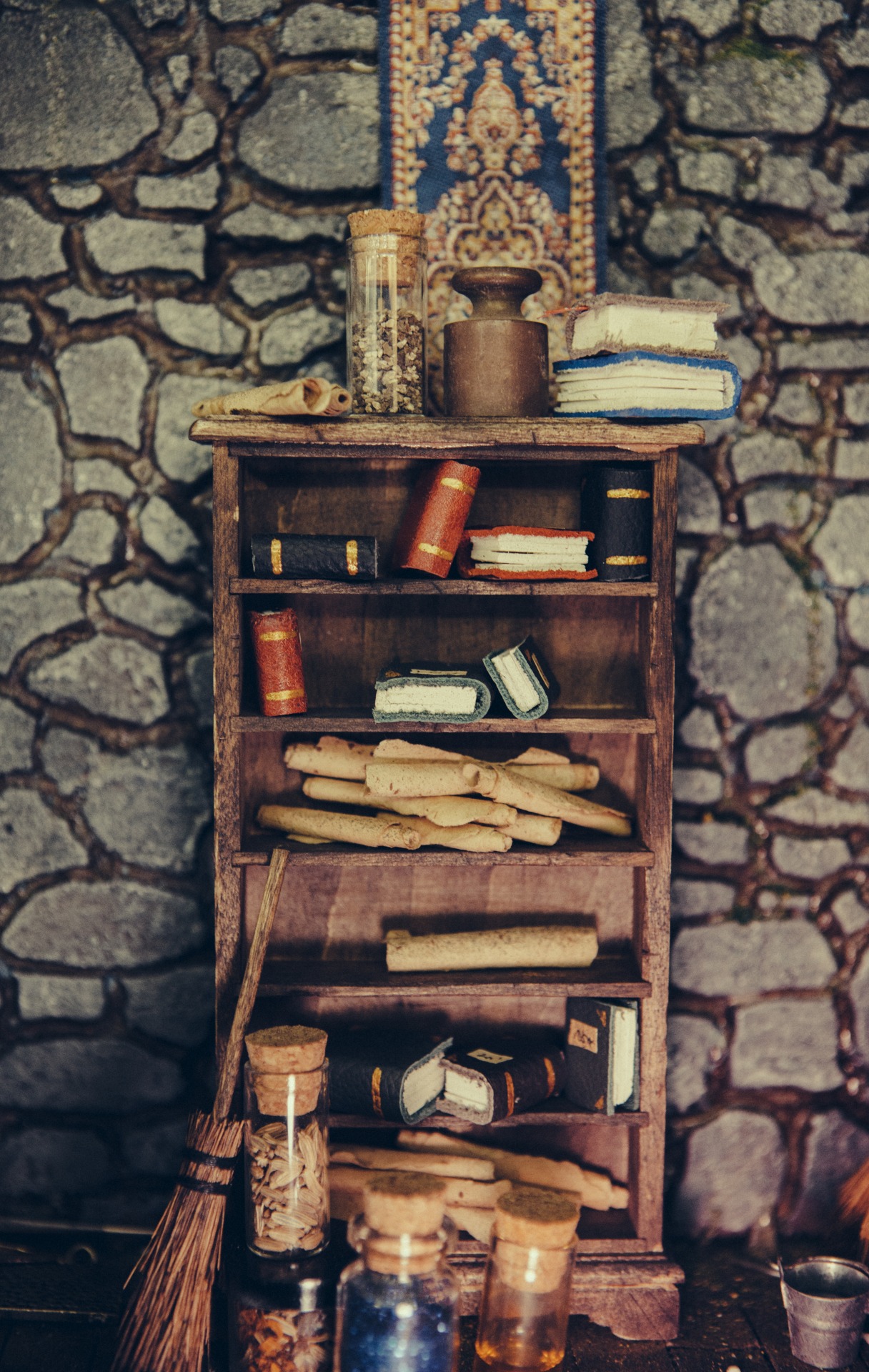

Below is my final piece that was a scale wizard set 1/12 scale.

I would love to know what everyone thinks as I am not too sure about myself as I am self taught and want to know the next steps to take in order to let me carry on doing what I love as well as improve my model making skills as a whole. If there is anyone anyone knows who even could give me advice in any way, shape or form can either comment here or email me: mattsmithdesigns@gmail.com (I had this email as part of my course)
I would love to hear what you guys think :)

Wow. I don't know anyone to refer you to, other than just show and tell here on the RPF.
I think your work is quite good. The furniture and scrolls especially look wonderful.
If I would have any nits to pick, they would be fairly minor. First of all the stonework on the walls. It looks like you took some sort of pointy object and basically just drew the fieldstones.... the mortar width is too uniform and the faces of the stone are too flat and even. Had you scribed it as brickwork, it would look fine, but the fieldstone pattern really begs for a more varied surface. As a technique suggestion... it seems like you used some sort of dense insulation foam for the stonework? I've done some pretty nice looking stonework using the same technique as here, except, after scribing the mortar lines, take a big chunk of lava rock and just beat the hell out of the smooth surface. This will dent and pit up the individual "rocks" making the whole surface seem more natural. Then you can paint and drybrush just like you did have will have a rougher, more realistic surface.

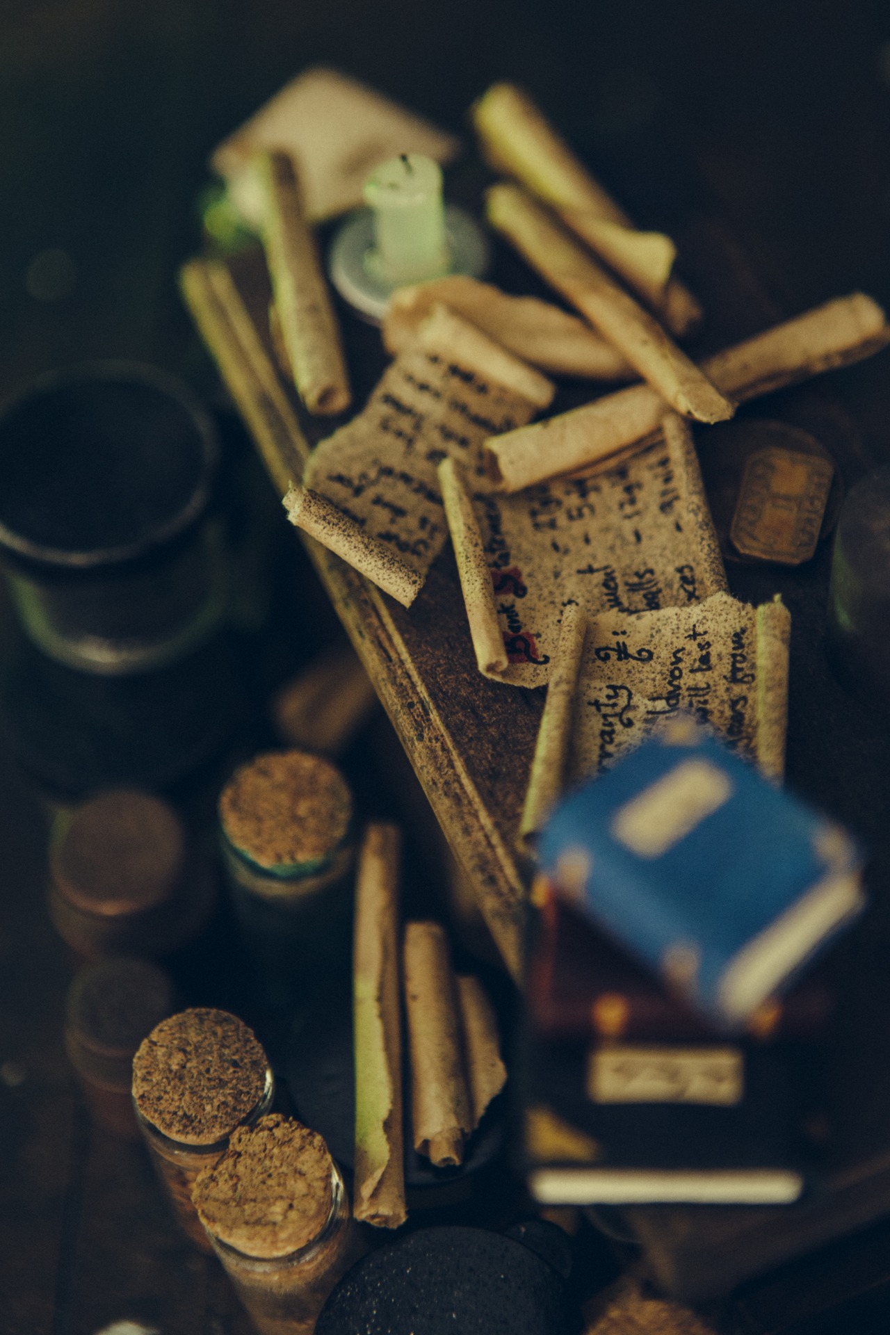

Second would be the corked vials. The cork itself breaks the illusion of scale as do some of the contents (seeds, rice, et al). I might have tried to make some other sort of in-scale lids rather than just cork stoppers.
Third are the books. They look good in the thumbnails, but don't really stand up to close scrutiny. The biggest tell is the lack of detail where the spine meets the covers, there should be a fine crease there, especially on large leather-bound tomes such as these.
Now, like I said, the over all effect is outstanding, and I wouldn't have even mentioned the nits except that it seems like you want constructive criticism. For me, it's the little details that really sell a scale.
I would love to see more of your work. You have a lot of talent.
Welcome to the RPF!
--Alex

No I'm wanting criticism I welcome it it will make me look at things better. The wall I originally wanted to do a brickwork pattern and is melted out of polystyrene using a soldering iron but my tutor and many classmates told be not too and it was one of the things that I wished I hadn't took on board whilst building it. The other things you brought up all suffered due to time constraints sadly. I would have loved to have made the books out of paper so they had individual pages but making 50 of them would have taken too long for this project :/ The cork vials is a good point to bring up and one I didn't really notice till after you pointed it out and I see it as a good point especially in the scale aspect.
Thank you for the advice saying that it's the details that sell scale as no one told me nothing whilst building/learning at uni so thank you :)
