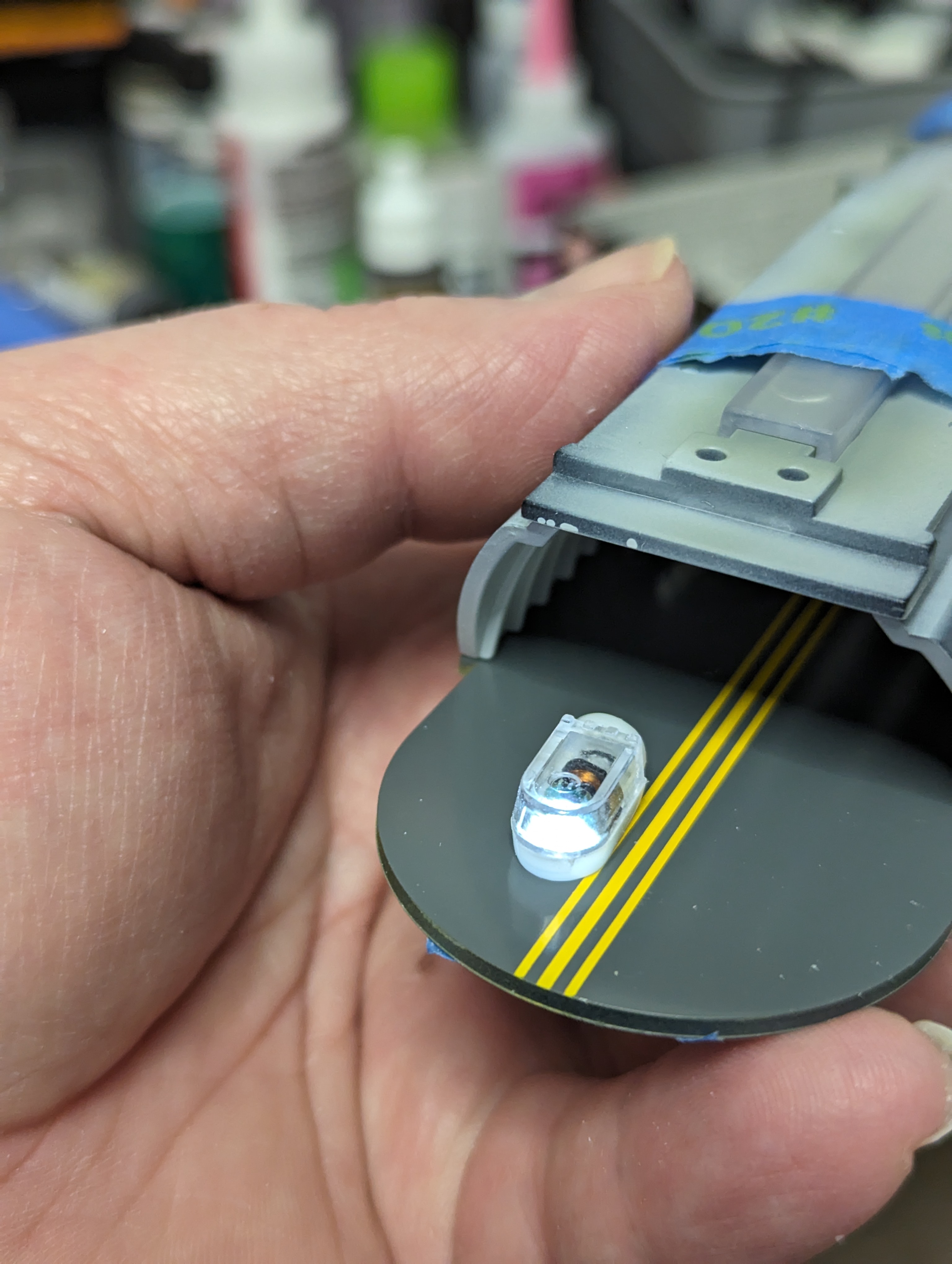

They do have some pretty big limitations, but they're a good for some specific things. For instance, I'm going to put the induction coil under the shuttle bay deck on my Refit Enterprise and put the LEDs inside clear shuttle prints. That way I can light the shuttles while still being able to move them around. It also works OK for builds that are low to the ground, especially if you can use a bigger, more powerful induction coil.
This was a very quick and dirty test with the kit travel pod which has a clear top half.

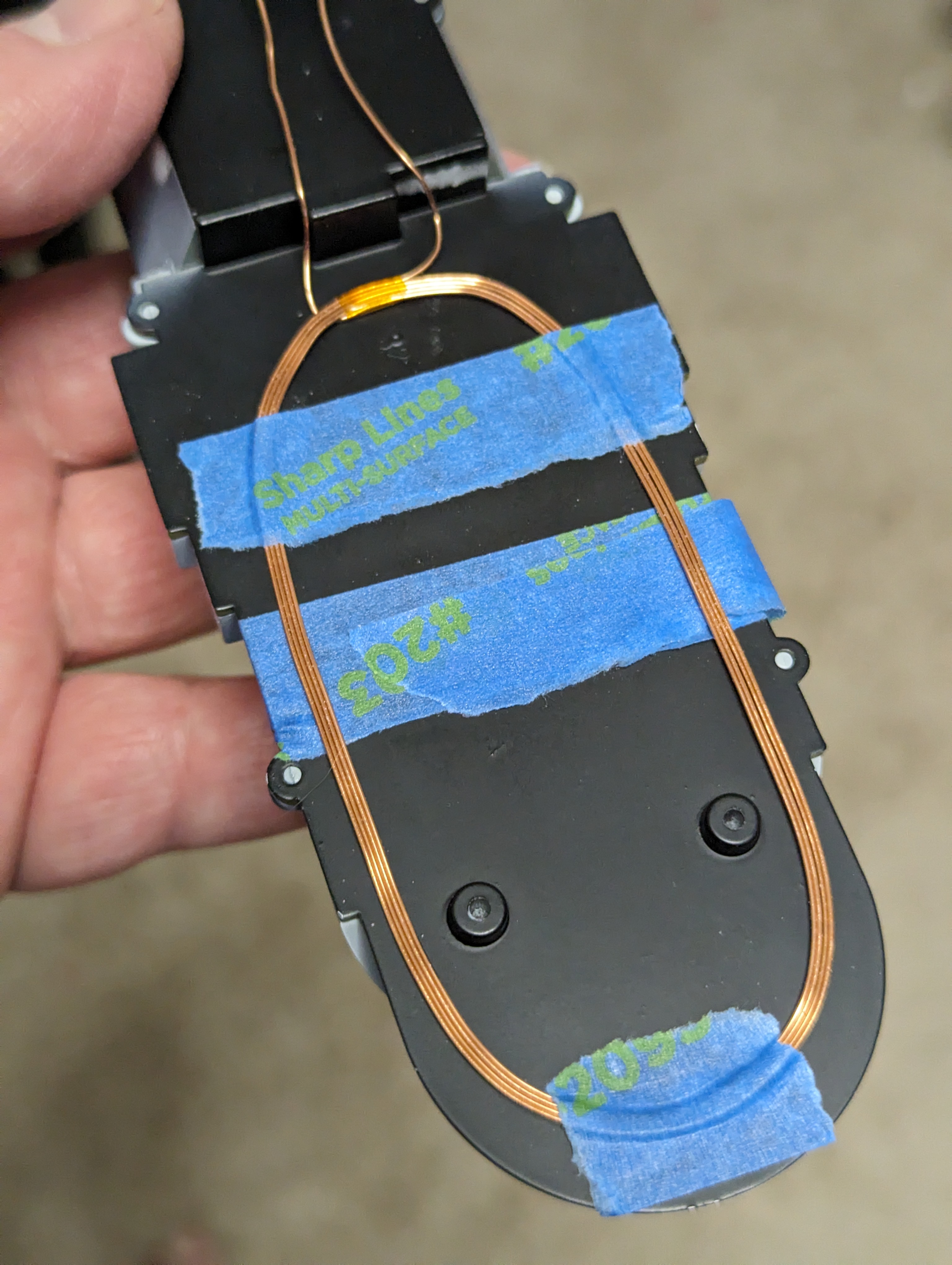

And here is the induction coil taped under the deck. I was able to carefully bend it into an oval shape to fit and it doesn't seem to have much of an effect to the field.
That's a terrific use-case for that! Great idea.
Does the induction coil give off any heat when used?
At least for the coil I have, any heat is negligible. The circuit board gets very slightly warm if you leave it on for an extended period. The Neopixel LEDs I'm using for most of the other lighting on my Enterprise get much warmer at full power.
