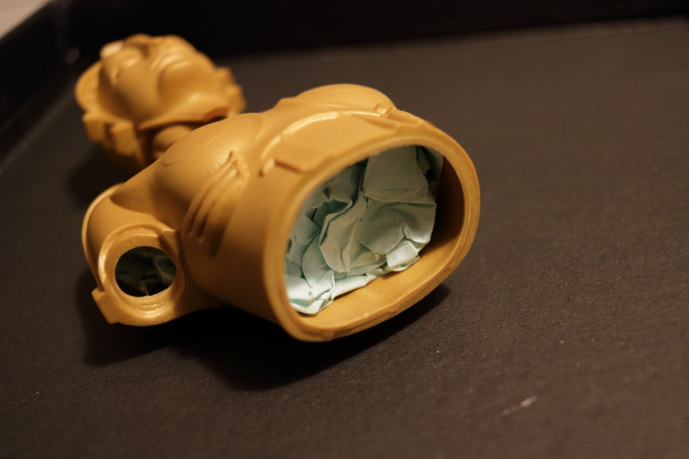

Re: Metropolis 1/4 Maria Maschinenmensch figure
Oh. I was actually going to say that the upper torso hadn't been trimmed enough in the bottom opening. That would have eradicated most of the poor fit if that had been trimmed slimmer. You can see the original trimming had only removed the majority of the extending material, without trimming the thickness down as well. I guess with all the work you've done to fill the gap afterwards, it is not worth fixing that trim to get a better fit.
Also... isn't Maria supposed to be copper?
She's usually interpreted as silvery grey, so I'll probably go with that. Fear not about the remaining lip. That will still file down and smooth over. I deliberately wanted to keep the line of the top part rather than thin too much as they're close to the lines of the prop. That bottom portion is rather skinny, especially at the back.

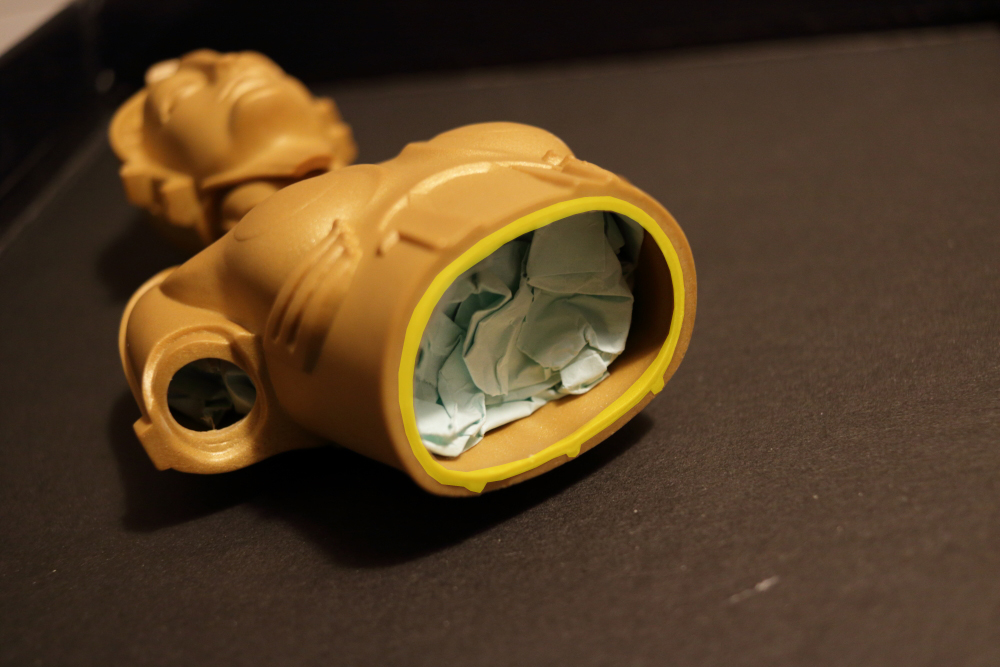

No, what I mean is the inside extra material that hasn't been trimmed off. When trimming you trim from one angle level to the opening to get the majority of the excess out of the way, and then you cut from a different angle up into the opening to trim away the excess thickness of that pour lip area. If that makes sense. You can see it in the image showing the bottom opening, where you can see the extra excess still being left on the piece.
Highlighted the lip I'm talking about in yellow.
Ah! Got you now! Yeah, that was a missed opportunity. Cheers — I shall follow that advice in future. I've been dealing with it from the outside on that piece due to the outer flare that appears to be a feature of the (poor) design rather than a bad fit. I might have been able to attack if from both sides! :)
