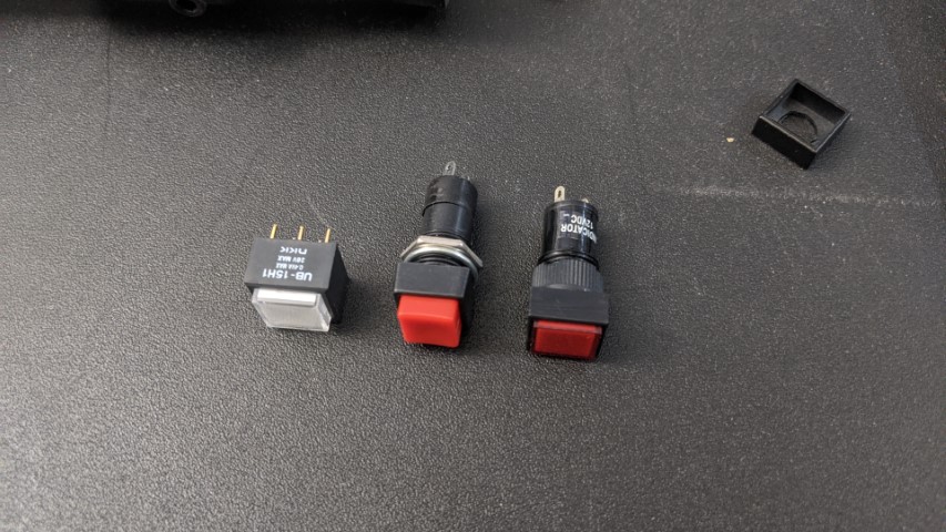

I thought I'd share the results of the 3 different "buttons" I ordered. None of them are an exact match, but it was in interesting experiment.
Here are the three I ordered:

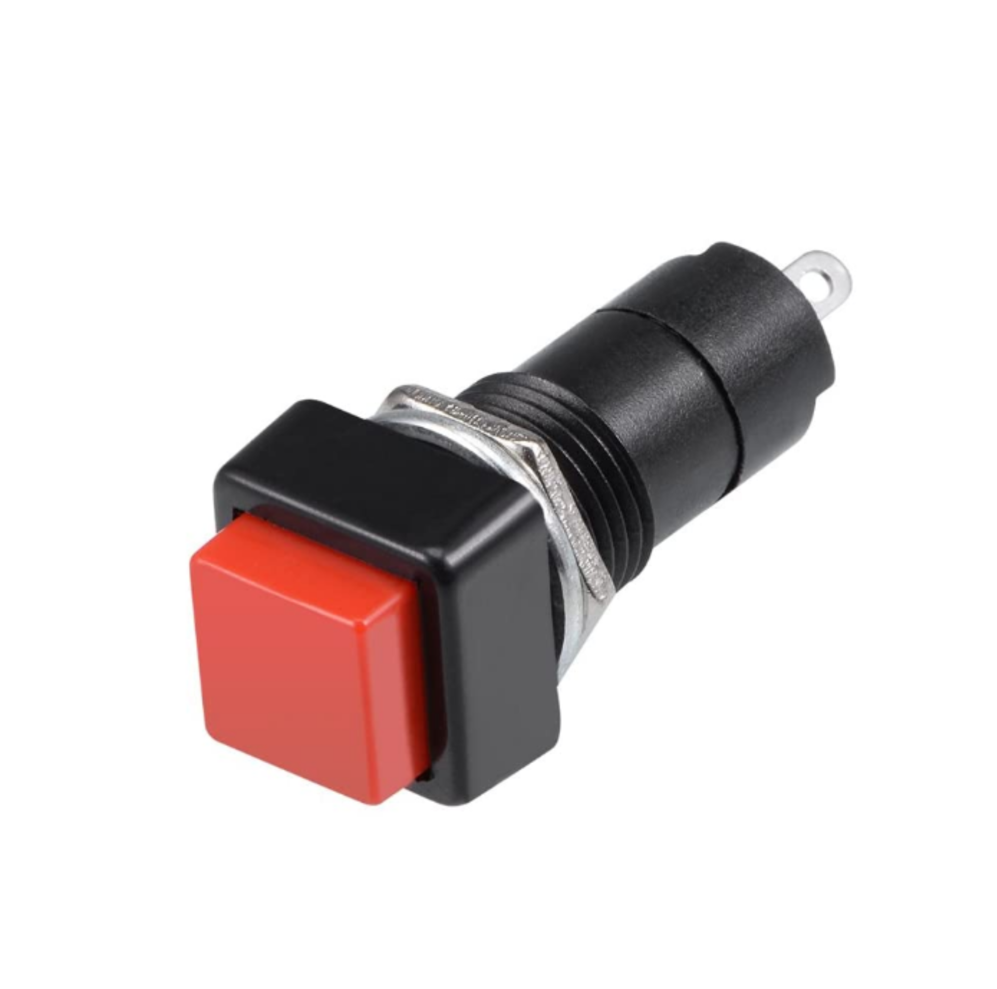

From left to right, #1 is linked in post #8, #2 is linked in post #10, and #3 (on the right) is here:
Mounts in 12mm Round Hole. Low Current Draw. SQUARE SHAPED RED LENS.
www.ebay.com
The third is actually just an indicator LED, not an actual switch (I was tired and didn't even notice that when I bought them).
The first thing is that obviously, none of these are the exact item used. So that's probably a deal-breaker for pretty-much everyone on this forum. But hopefully this might help the investigation. If not, then the rest of this post is probably a waste of bits.

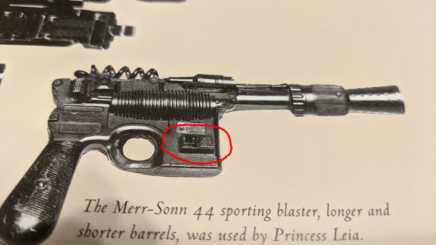

Anyway, I took each switch and painted them up. In the case of #2 and #3, I also took one apart to represent the chronicle photo. I couldn't get #1 apart without destroying the housing. With that being said...

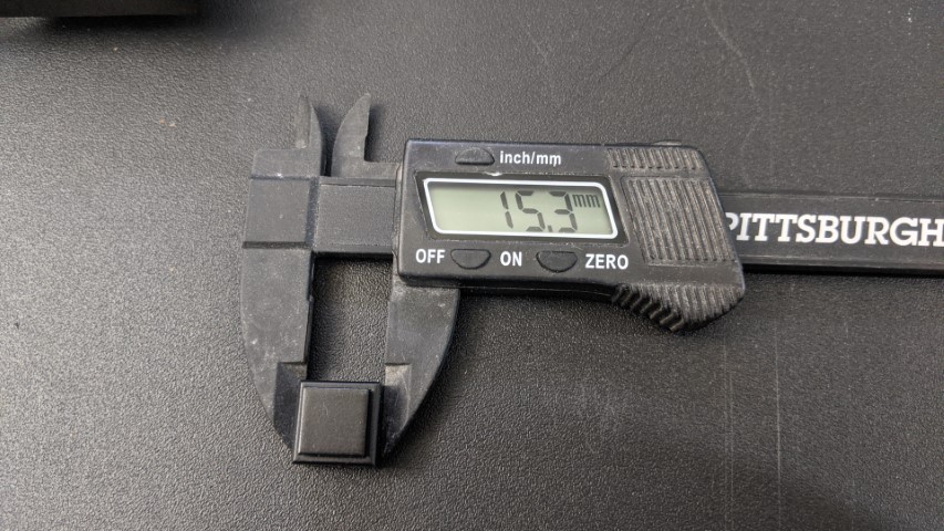

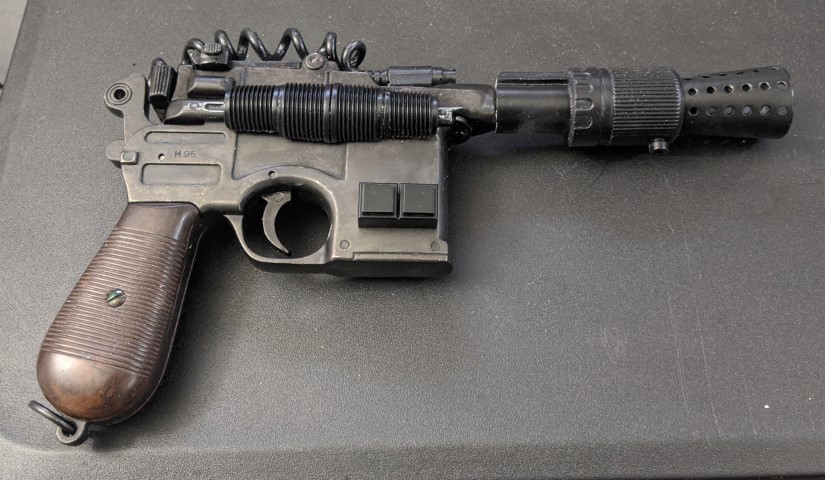

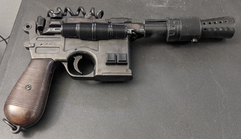

#1 (as kurtyboy pointed out) is pretty big, and I concur that it's too large. Not only does it have too big of a footprint, but it's really deep/tall as well. The plus side of it is that it's easy to snip off the terminals on the bottom to glue it on, and it still feels like a functional button. But, placed on the blaster they are large. Also, as already mentioned I couldn't get the actuator out without destroying the housing, so the odds that the screen-used switch had the actuator removed/broken off without damaging the housing are probably really low.
As for dimensions, they actually come in at over 15mm:

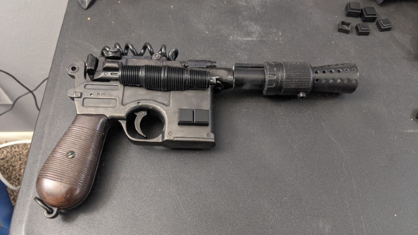

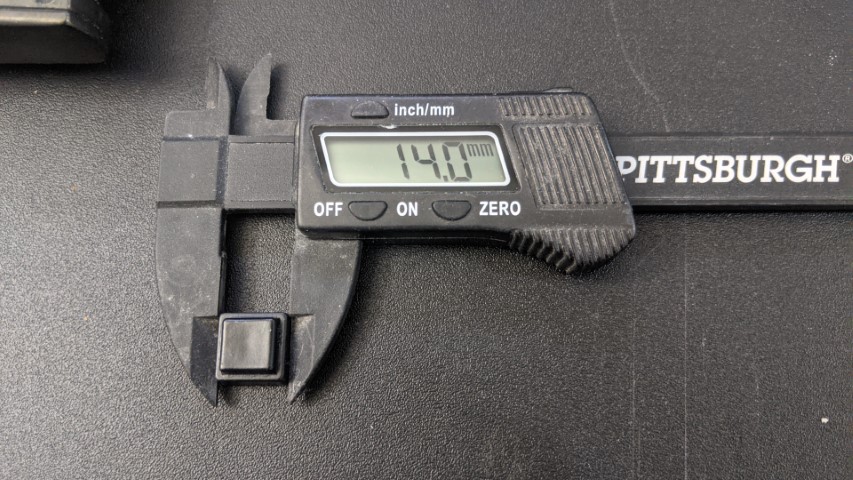

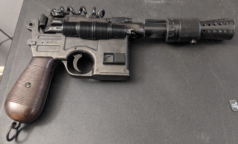

#2 is closer in dimension, but again as Kurtyboy pointed out may be a bit too rounded. I see rounded corners when I stare at the Chronicles pic, but maybe not this rounded. In addition, the sides are tapered, which leaves a larger space between them. The actuator has a slight concave surface to it as well. Finally, when I cut the barrel off, the actual switch mechanism went with it and the entire thing kind of fell apart. I had to superglue the "actuator" in place.
It measures at just about 14mm, or .551 inches

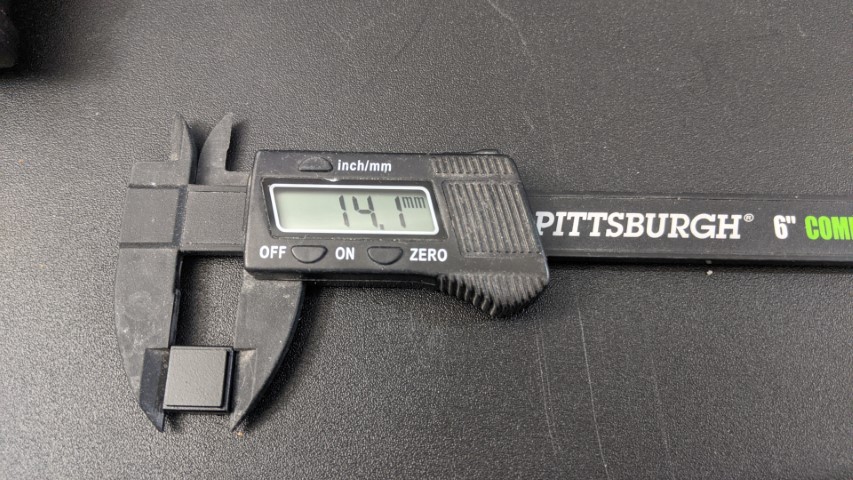

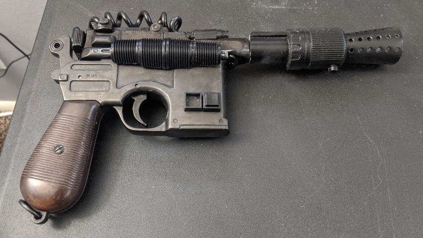

#3, which is actually just a panel indicator light and not an actual switch, I think has the best overall shape of the 3, but might be a tad bit large. The corners are more square however, and the lens actually seems to have a closer profile to the screen-used (based on the one photo). However, it was a bit difficult to remove the lens, I had to push it out from the inside after I cut off the barrel, and it was glued in.
It measures about 14.1mm or .555 inches

-It is
possible that the screen-used part
might a panel indicator and not an actual switch, although the fact that you can see what appears to be part of the actual switch mechanism in the broken one on the screen-used prop seems to indicate it was a switch. It could be some sort of bulb contact, but probably not.
-Modern illuminated switches won't be correct as most modern switches use LEDs, which wouldn't have been the case in the '70s (one of the reasons I wanted to test #2).
-It's probably NOT a panel-mount switch (with the long barrel) because the mechanism would probably be in the barrel that was removed. It was probably a PCB-mounted (or some other type of surface-mount) switch or indicator lamp.
