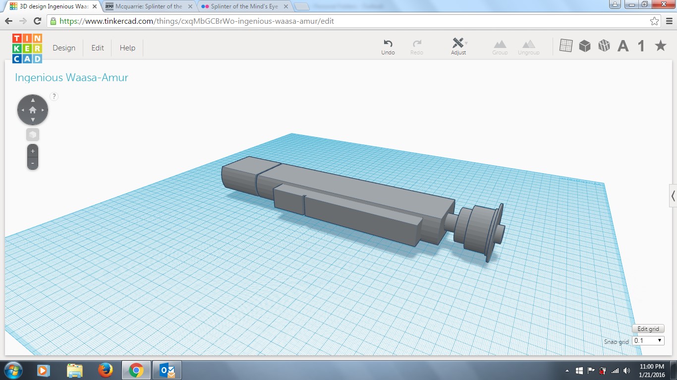

Do you have the basic dimensions? Could be fun for a quick 3d model / print.
Nothing written down. Most of it was build eyeballing it. The only thing I had measurements of going in was Ben's emitter just to give me a rough idea of what I wanted the emitter to look like. I believe besides the width, most of the old hilt that I still have is similar. I'll grab some measurements tomorrow.

As promised, here are some dimensions. Reminder that this is not from the completed one in the first post as that is long gone, but I have a grip section I made originally but remade it as it was too wide. I believe all i changed was the width and everything else stated the same.
Grip length = 6"
Grip width = ?.. Possibly 1.75"... the old grip was 2"
Grip thickness = 1"
Groove width = 1/8"
Groove depth = 1/8"
Groove location = Centered at 0.75" from pommel end.
Control box length = 4"
Control box width = 5/8"
Control box location = 1/4" from emitter end
The curvature on the sides is a result of lathing it to it's proper diameter and then milling the sides equally until 1" remained.
