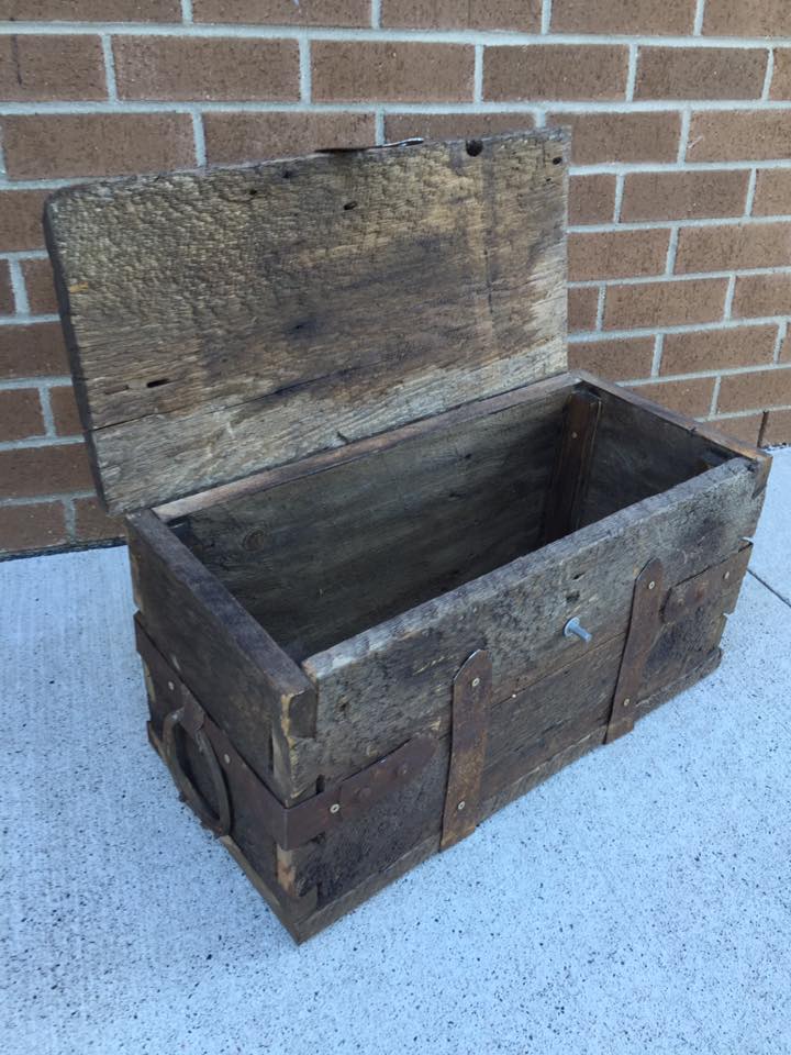

I do not have pictures from fabrication of the hinges, but I can take some of what I did. Keeping in mind that this is a crude type box, I used a dremil and sheet metal cutters and wrapped/beat it into shape.
thats exactly what i was going to do, use a pin at the local hardware store and hammer the ends of the pin like a mushroom so it doesn't fall out
chris mind sharing where you got your strapping and what size and gauge you decided to go with?
I got the strapping at Lowe's in the area they sell U channel and round stock in steel, stainless, and aluminum. This is 1.5" wide and I believe it was .125" thick. You can get it in 4' or 8' sticks. I suggest using a bender when going around sides and front to back, or cutting a groove on the inside to get a good bend if trying to use the box edges to bend it.

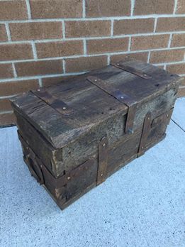

I just realized the back of the box at the hinge is taller than the front, it's not a flat top like I originally thought. A slight but noticeable difference adding character.

14433192_10210499627910572_3355527092178180699_n.jpg14390750_10210499627750568_6844138157429326309_n.jpg
It's looking great. I will need to add a little bit to the bolts/screws, but overall I am very pleased. Anyone interested in commissioning one, let me know.
