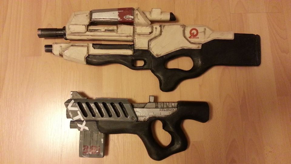

As i am building a Mass Effect Armor i was in need for some weaponry.
I´m not very skilled at working with wood and don´t have the tools for that either, so i decided to carve the guns out of styrofoam.
On Youtube i found some tutorials and thought i just give it a go.
My tools were only a sharp knife, Dremel, white glue (sealed the guns with it) and acrylic paint.
So here are the M8 Avenger Rifle and the Mattock made of styrofoam and some greeblies i found at the hardware store...light weight and cheap...
Hope you enjoy
Carsten

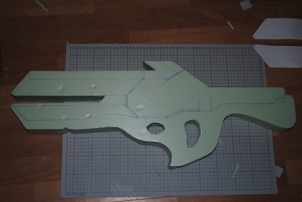

This is such an easy way to build lightweight weapons, there are only a few tips i can give you...
You need a good template, start with the thickest part of the gun (i chose styrofoam with the right thickness) and work your way down to the thinnest part.
Always use a sharp knife and try to cut a line in one step (try not to "saw" with the knife as it results in uneven edges).
I used fine sandpaper to smooth the surface.
Like i said, it´s very simple and easy.

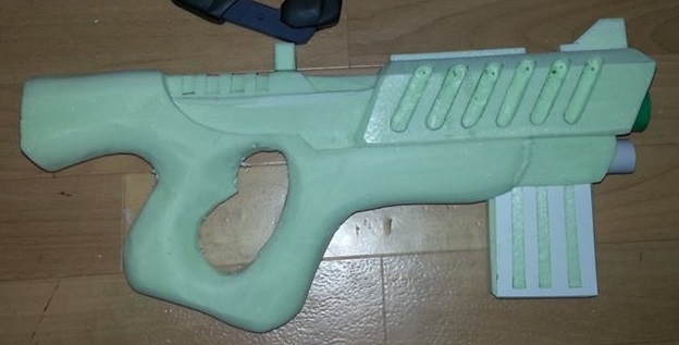

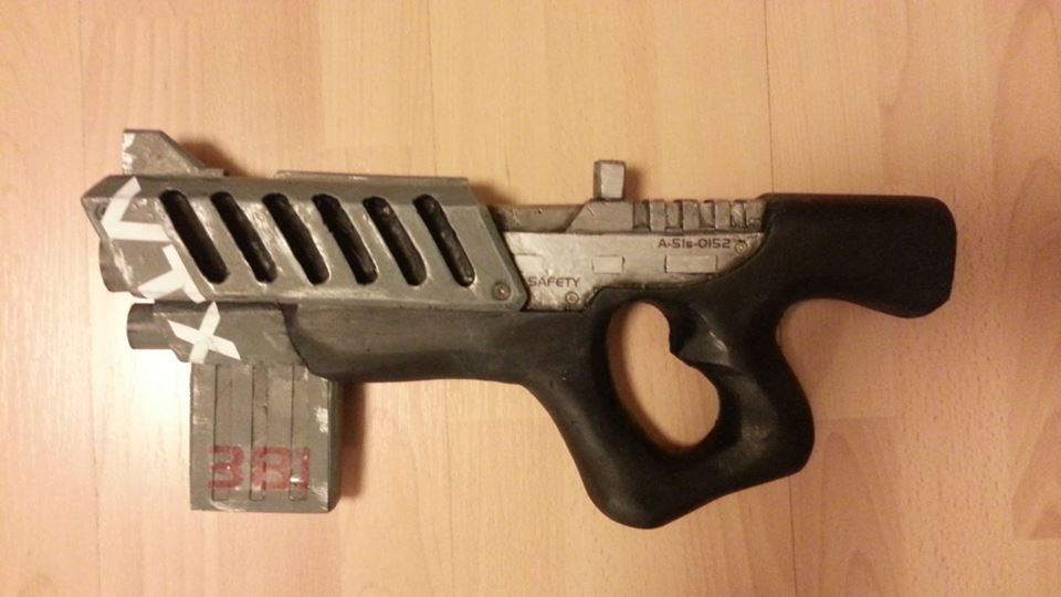

Here´s another gun i´m working on at the moment, the Tempest submachinegun:

The Tempest so far...need to seal the paintjob with a clear coat.
View attachment 295098View attachment 295099
Thank you! I´m using insulation foam.

At first i use a template:
Also very useful are Pepakura files for the righht angles etc:
Next step is to cut out the gun:
View attachment 298118View attachment 298119
Then i draw the details on the gun:
