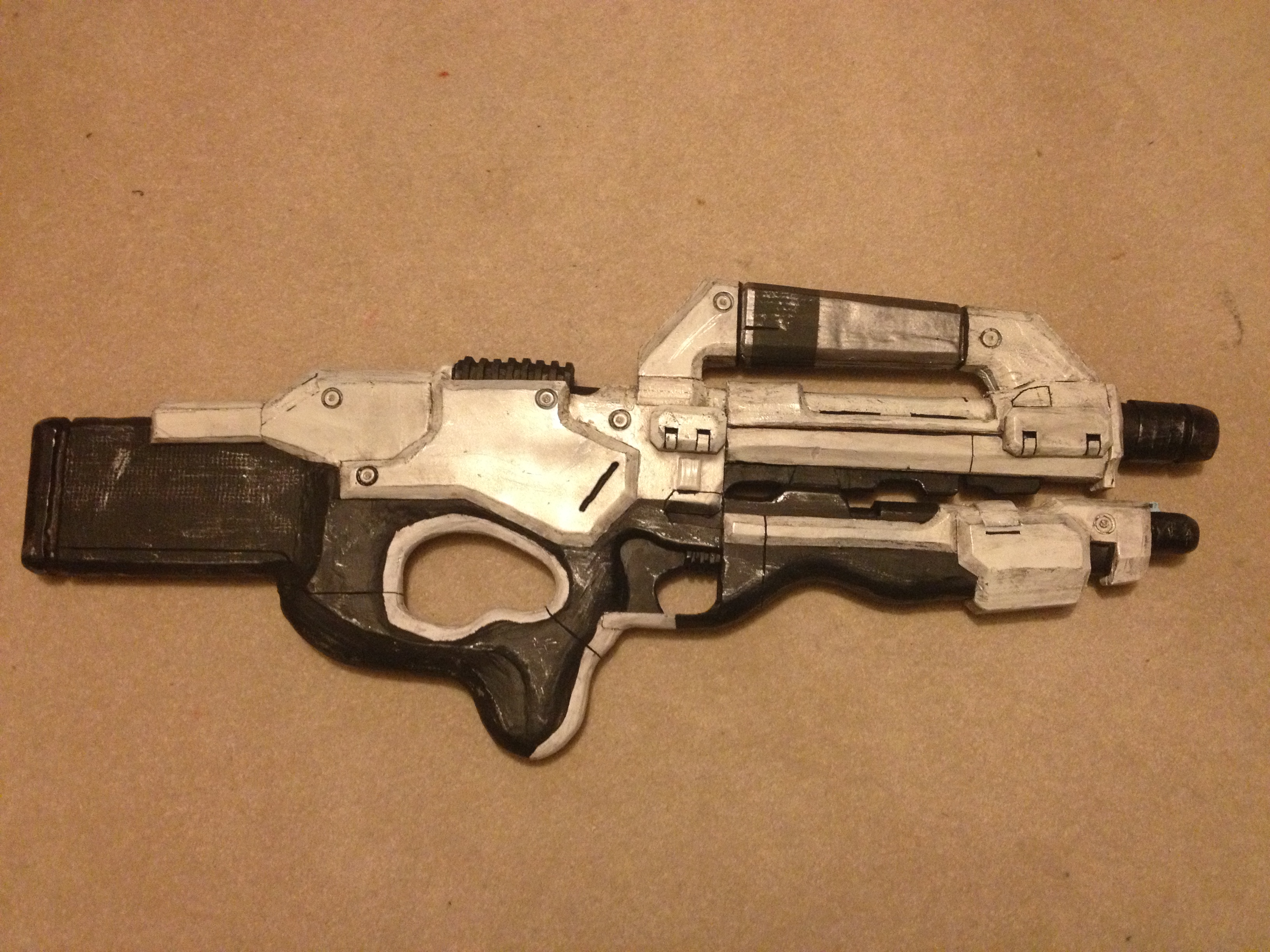

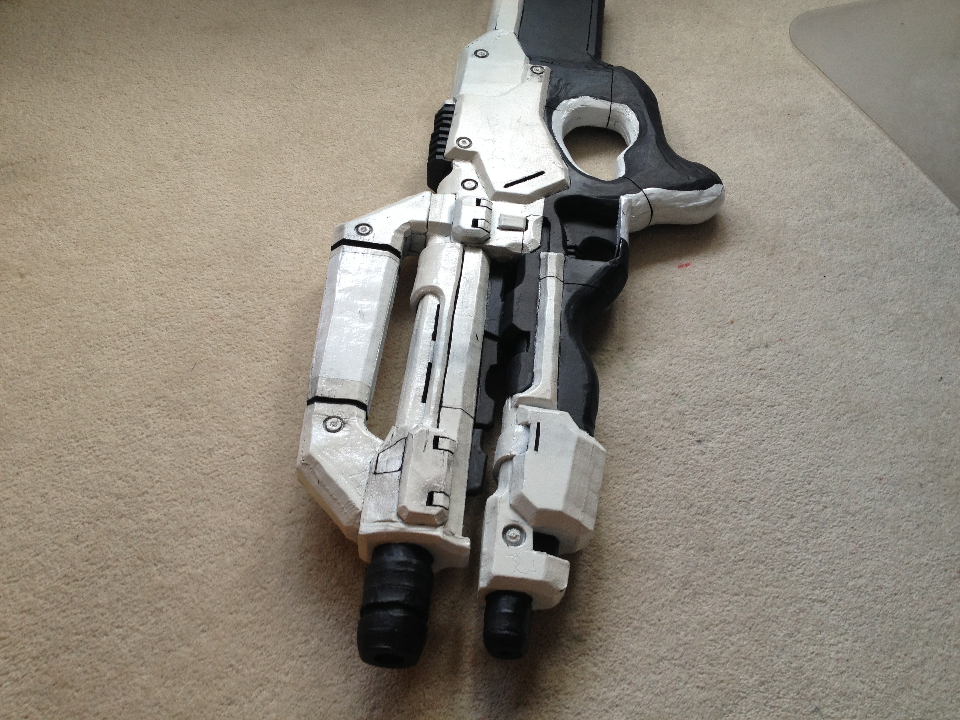

Already pretty far along with this build. It was started when I sucked more at prop-building, so there are some gaping errors (and some actual holes), but it's turned out alright.
It was made by layering sheets of EVA foam cut to the correct shape, then sculpting them with a rotary tool.
Still a little paint to do, but it's almost there.

Hey, thanks! Well, I found a pepakura file and worked out scale and shapes from that, then added details (like all the notches and stuff) according to the game artwork. But all the patterns were improv and I don't have any copies /:

I sealed the foam with a mix of PVA and water, then put a layer of varnish over that to give the paint something easier to stick to.
I read that you can also use plasti-dip (the spray stuff).

It still needs some work...the white strip should actually be silver and green, but it's almost there.

All done! Corrected the painting error on the carrying handle and added the green stripe, plus a couple extra notches for detail. Grime was added all over with a thin wash of acrylic paint, left to half-dry then wiped off roughly. Distressing was done with silver spray paint on a screwed-up ball of kitchen foil.
