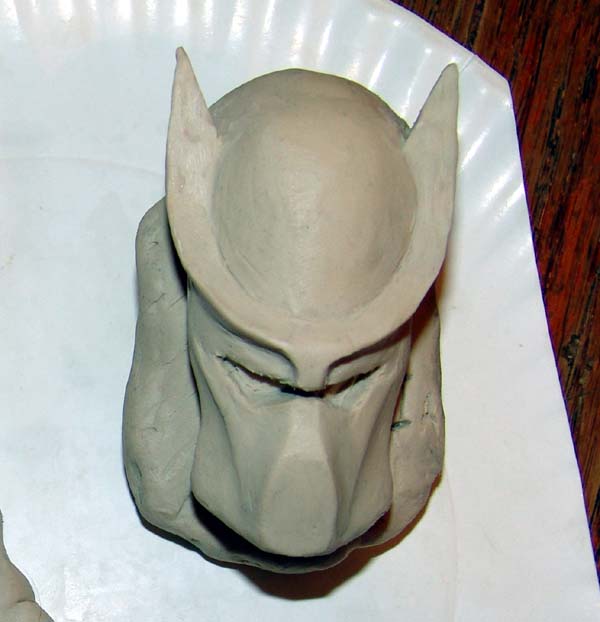

This is the first sculpt with the ears added. This is just my concept.
The ears a still a little bit taller then I like them. The clay is kind of soft and doesn't like being trimmed without deforming everything and I wanted to see how it would turn out. The facial portion will change some.

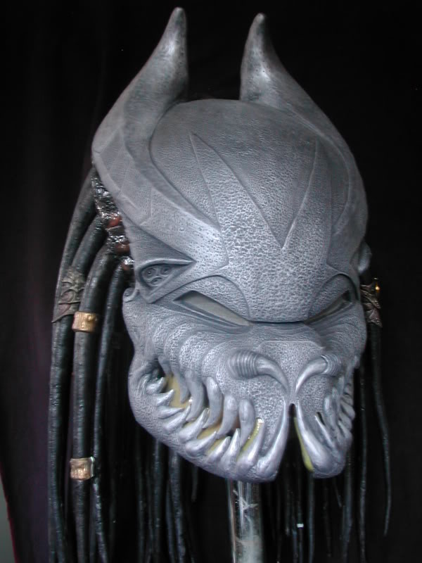

I thought you might want to catch this I was coming across some bios and I know you are trying to build your own, but it looks like there is already one that you are trying to build. The one thing is though that this site is considered a recaster here on the "Lair" check out the list here
Recaster List
Here is the pic of the bio I think you are going for
Recaster List
That bio looks interesting. Generally I'm not a big fan of the bios that actually look like animals(teeth details). That one give me a devil feel. What I'm going for will end up more like the last sculpt I posted. More angular and less organic.
Basically a technological version of the ancient Mask of Anubis. They weren't trying for scary and they never showed teeth. It was just to represent a god.

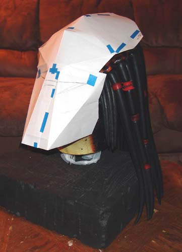

I just got my half mask last night and started a paper template for rough dimensions. I haven't finalized what I want. Starting without a plan can lead to wasting time later. I can get the angles I want now that I have my mask and continue to see how things go. I'll post pics later of my paper portion. It's not much other than a start.

This is my test template for my bio. This will give me an idea what size of pieces to cut for shaping. Ideally, I will make it all out of minila folder and then transfer it to the steel. Then cut the major pieces, shape them and then weld them together. The compound curves are the hardest to make templates for since it cant duplucate the metals ability to stretch and shrink. So, no this isn't the actuall shape the bio will be, it's paper.

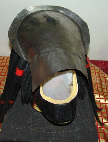

I was able to work on my bio tonight and got some good progress. Since the dome will be the hardest part to get just right (I hope), I started on that. I got most of the general shape and got a feel for how this steel will work. If I can get away with this 22Ga and not add too much during welding, then it should stay under 3lbs total. That will be on par with what hez told me his painted bios weigh.
I think it is looking good man when I first saw the mask I kind of thought the dome on the head was going to be the most difficult part of the bio build, but you are definitely making some progress. Can't wait to see it the next time we meet.
So it's past time for a small update on my progress.
I had to cut a seam in the front to get it to move the way I needed it to without using a torch. I found that a butt weld on this gauge is very hard to do because its at the limits of my welder. If I back it with another strip of metal then I could do it. I just don't want it to be that way this time. It would be the way the rest of the bio would go too, just too hard to do right now.
So, it went on the wall of 'whatever' until I feel like getting to it.
I tried using the other thickness I had and realized(after I started) that it would be the same thickness as a real Medieval helmet. Thats not good for comfort. So I went and got some metal that was just a little thicker then I started with. Now I'm just about where I was at the last posting but on Rev 3.

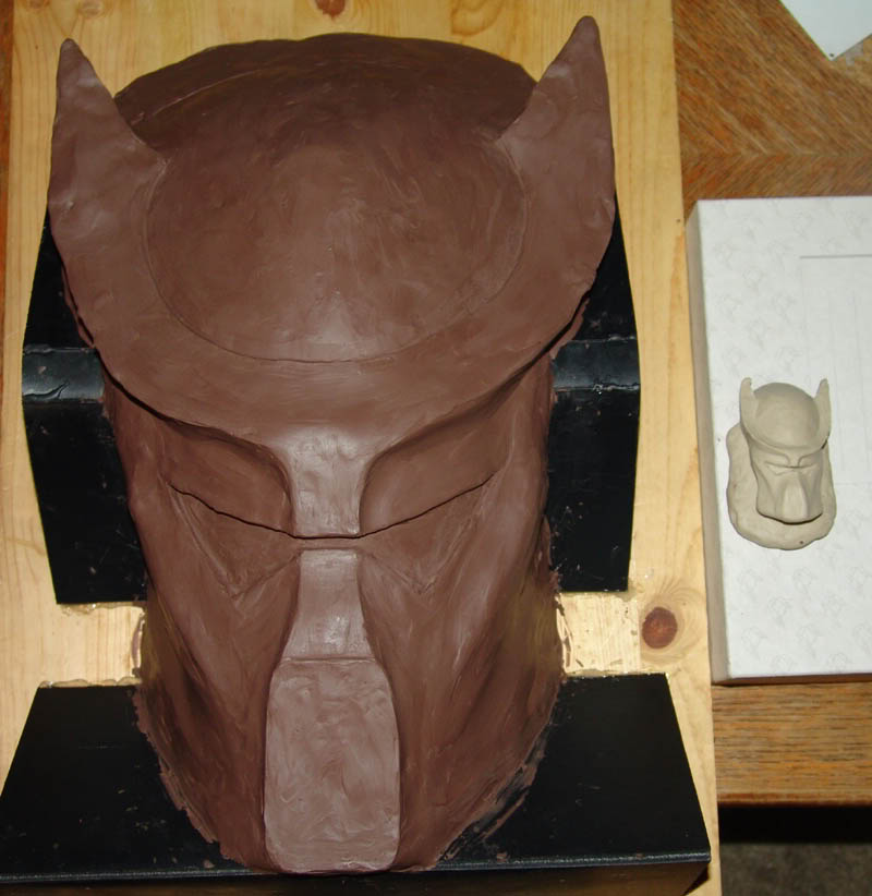

This is my progress from today. I made my armature last night and rough sculpted this today. It's about ten pounds of Classic Clay Medium and I haven't used it before. So far I like it. I might go for a firm next time. My 1/6th scale bio on the right is Klean Klay regular.
