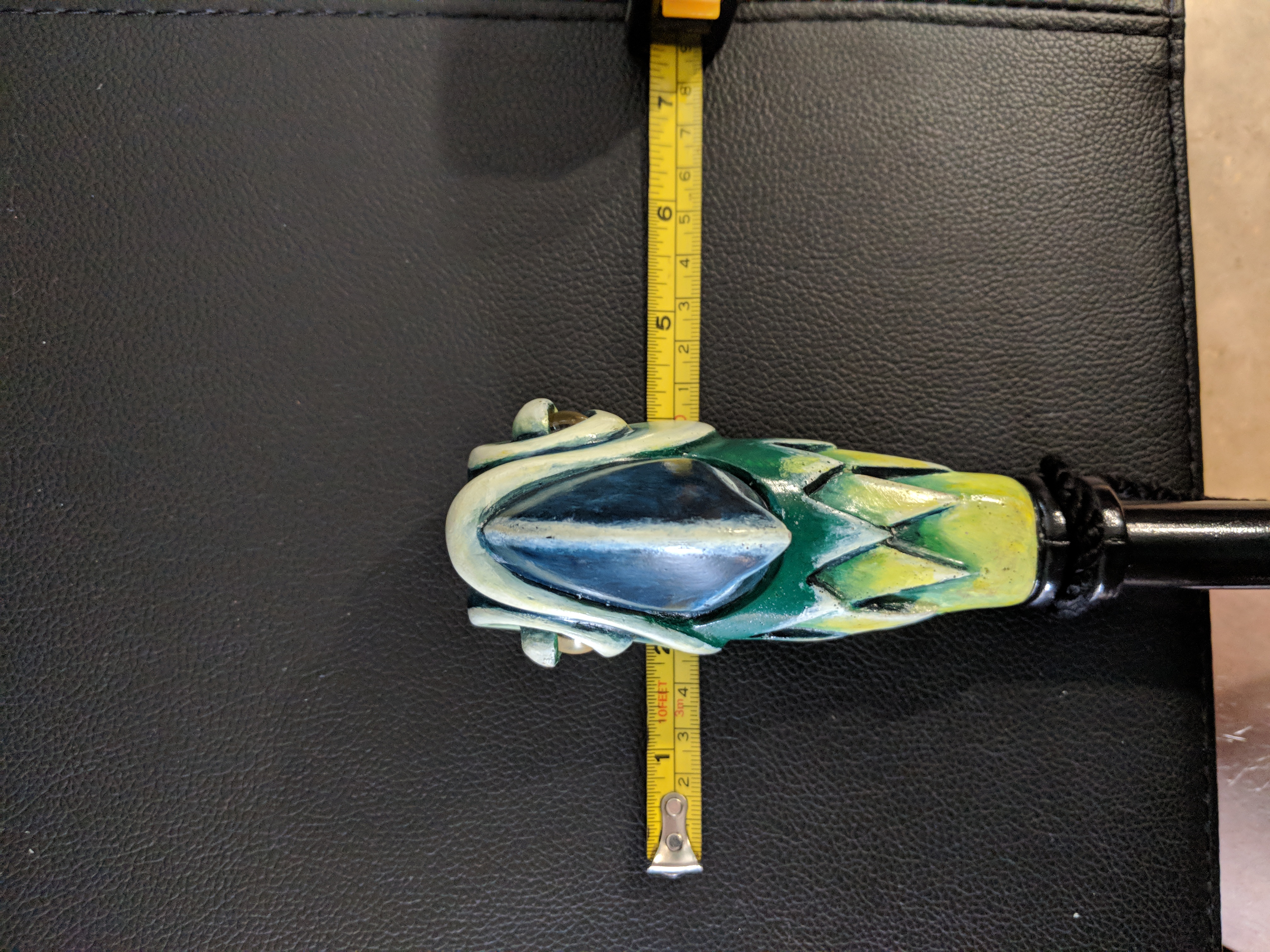

This ICONS replica was made in exacting detail to the movie prop borrowed from Disney to make it, and is as close as we could hope to ever see in person.
That being said, here are my pics showing measurements. It is hard to tell from my picture angles but they are exact. It's clear to see in person.
IMG_20180309_150404.jpgIMG_20180309_150629.jpgIMG_20180309_150404.jpgIMG_20180309_150337.jpgIMG_20180309_150717.jpg
Buch, you can never have too many!
Fantastic pictures! Thank you Benjamin!
So the total length is about 35.5" to the top of the head? Could I trouble you for a wide shot of the whole thing with the tape measure so I can pick out sizes of the top, fabric portion, etc?
