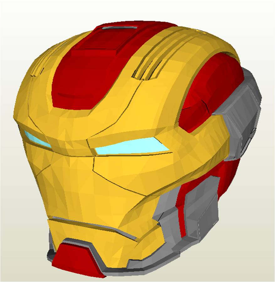

MY OCB part can't stand to see flipped panels.
So I flipped the panels back and add colors.
It took me a lot of time to do this.
I just don't have any motivation to continue the unfold.
I also found several missing lines on the helmet and correcting it.

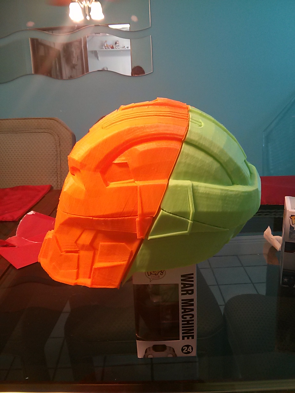

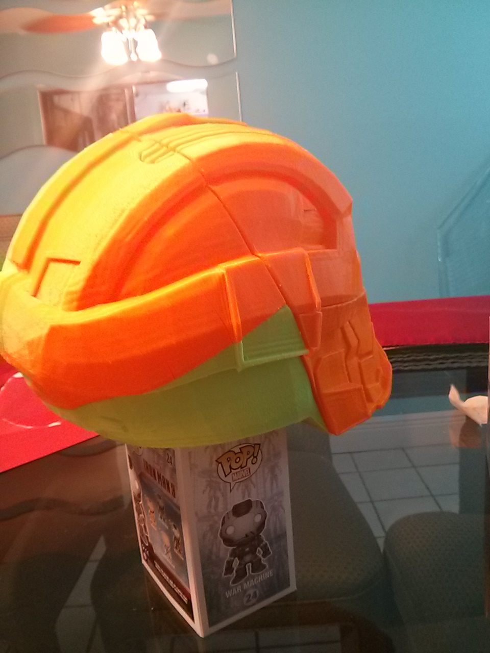

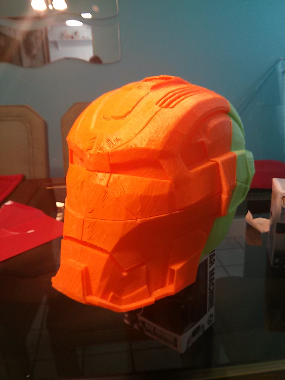

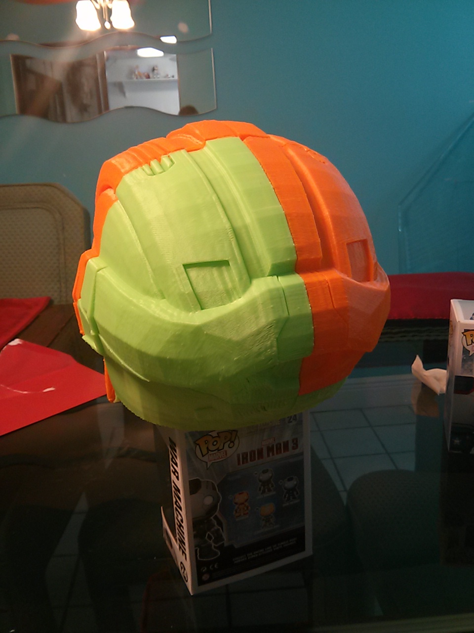

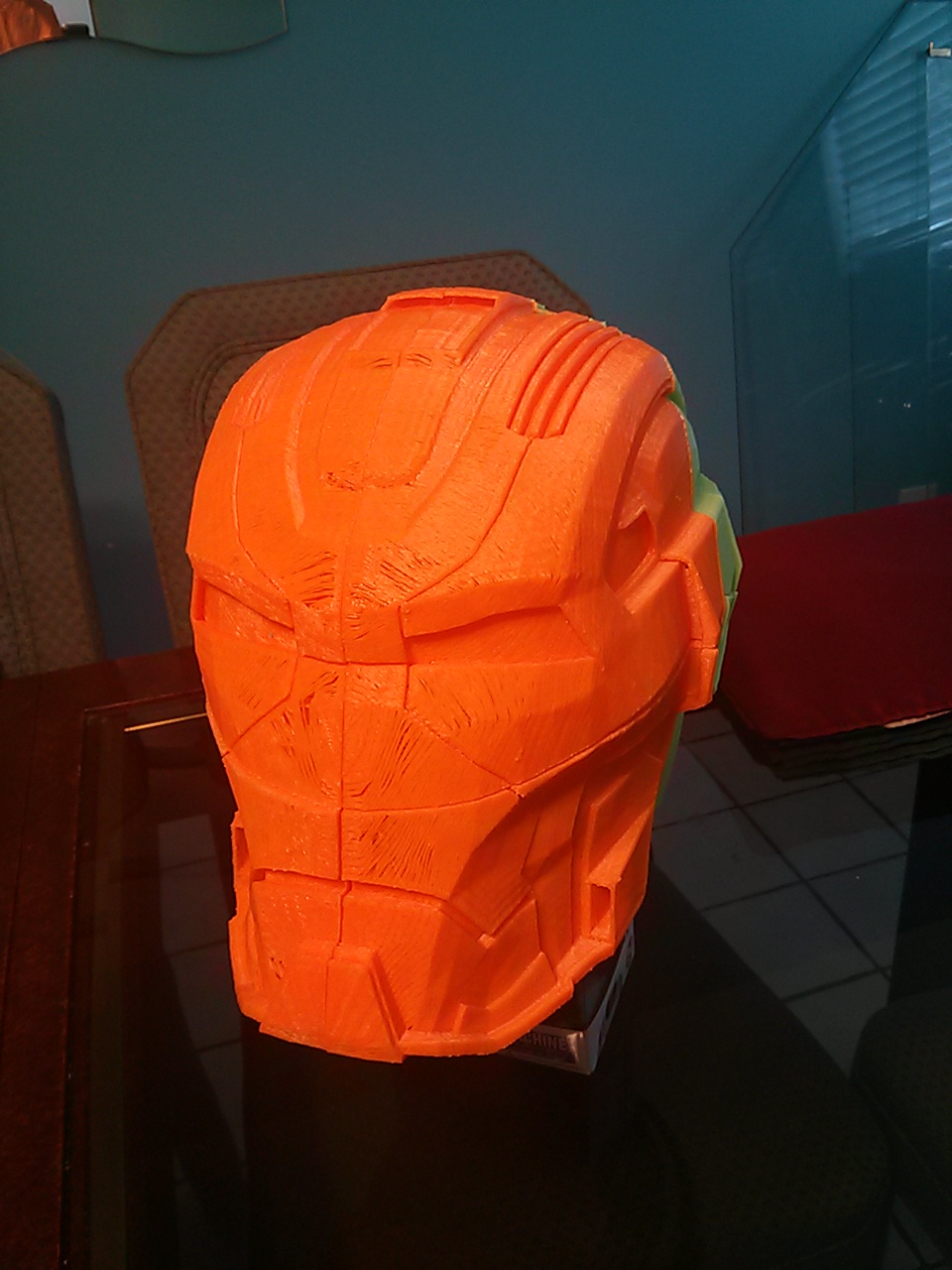

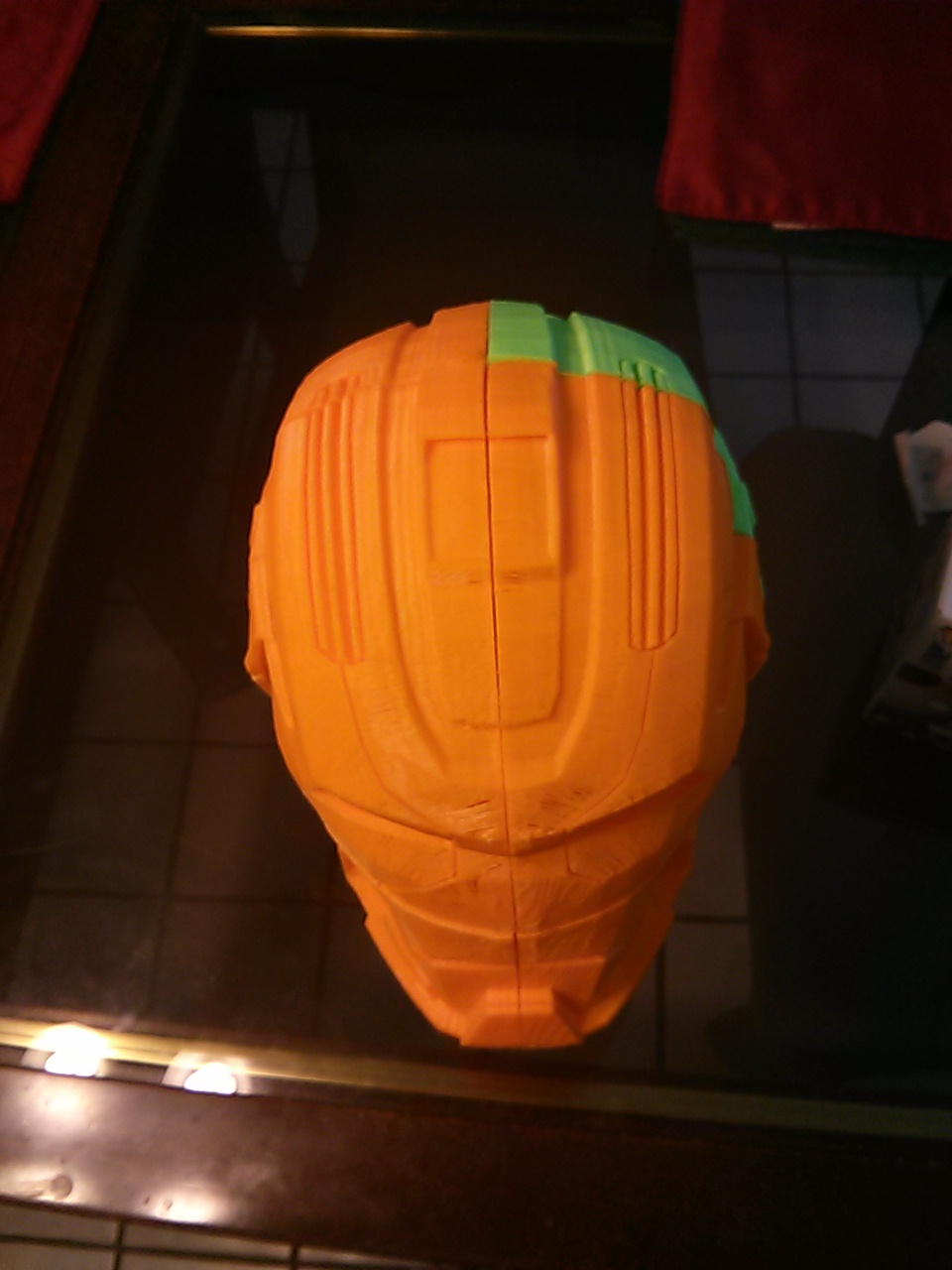

great news everyone, my printer has been printing non-stop for the past 3 days and it just finished the last part of the helmet.
2013-05-05 11.05.47.jpg2013-05-05 11.05.34.jpg2013-05-05 11.05.22.jpg2013-05-05 11.05.14.jpg2013-05-05 11.05.08.jpg2013-05-05 11.05.00.jpg2013-05-04 23.06.58.jpg
my plan now is to use modeling clay to fill in the holes and smooth over the gaps, then make a mold of it. after watching the movie now im really motivated and excided to get this finished

I tried the clay tonight on a test part and im not real happy with the results. my original idea was to make a mold of the 3d print then make a solid cast in a material that I can easily carve or sand out all the printing lines (need to figure out what product to use) and then make a mold from that and finally use smoothcast 65d to make a hollow cast.
With my previous 3D printed items I would seal them using a resin sealant, like a clear coat varnish. If you apply it in thin coats and let it seep into the pores of the printed piece, you can save yourself the need for a junk mold to get a more solid piece.

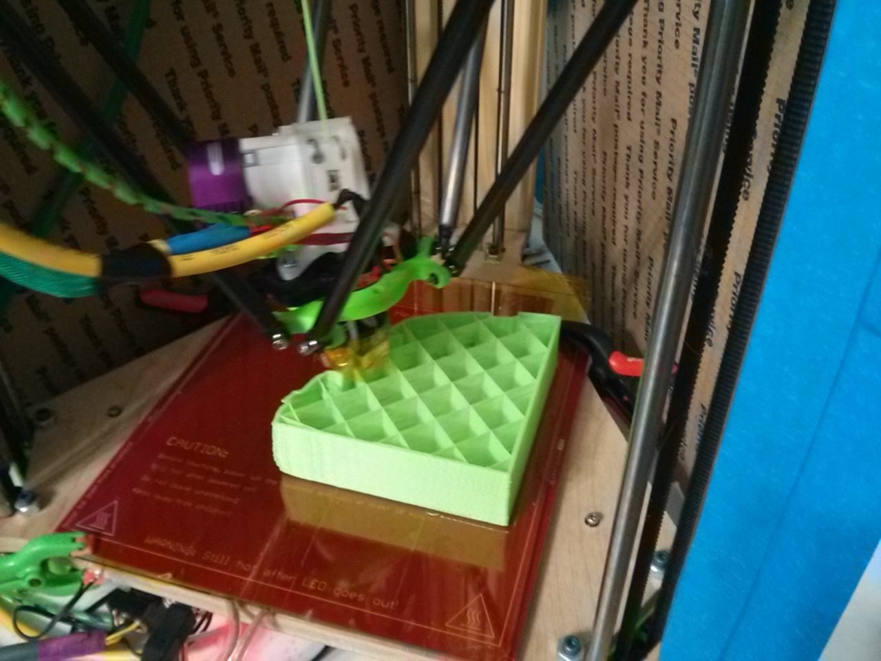

hey buddy where did you bought 3d printer ? looks very nice

I built the printer myself, the design is called a rostock. plans and files can be found here Rostock (delta robot 3D printer) by Johann - Thingiverse to be honest if they sold printers that could print things as big as mine I would have just purchased one and saved a lot of headaches. but most of the printers you can buy have a very small build area 4 or 5" cube. the one I have can print around 8" x 8" x 20".
thanks for the advise, im going to try that this weekend when my smooth on order gets here. the whole clay idea did not work like I wanted it to
