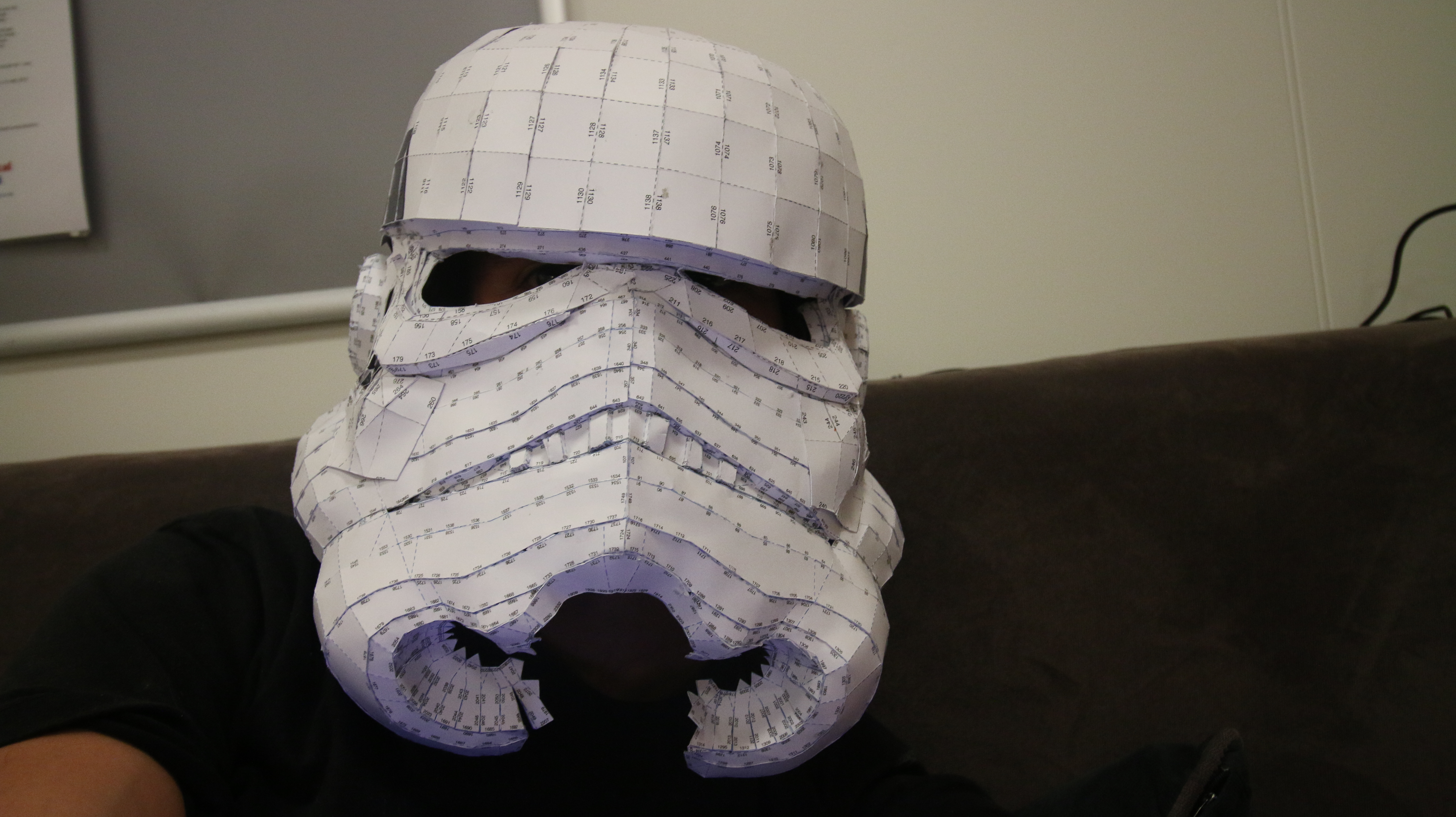

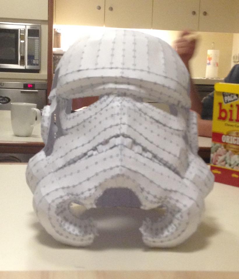

I started building my trooper helmet with the PDF supplied from Feirfek:
(please excuse the shoddy phone camera photo)
For the construction I used 300gsm card (which was pretty much the thickest paper i think the printer could handle) and Loctite super glue.
After construction I started to spot the errors with the build, this is most likely my own fault this is the first paper craft build I've done in a long time, I decided to try building another build as there are so many readily available, I downloaded Spacecowboy's PDF and began to build that. The build of Spacecowboys is far simpler but felt it lacked some of the details that Feirfek's model had, so I took what i liked from Spacecowboys and applied them to my Feirfek build, namely the helmet dome and the eyes. Also I was getting a little inpatient with the development and was eager to get on with filling as I want this thing finished before Halloween.
This is the two pep builds combined taking the eyes and dome from Spacecowboy and everything else is Feirfek

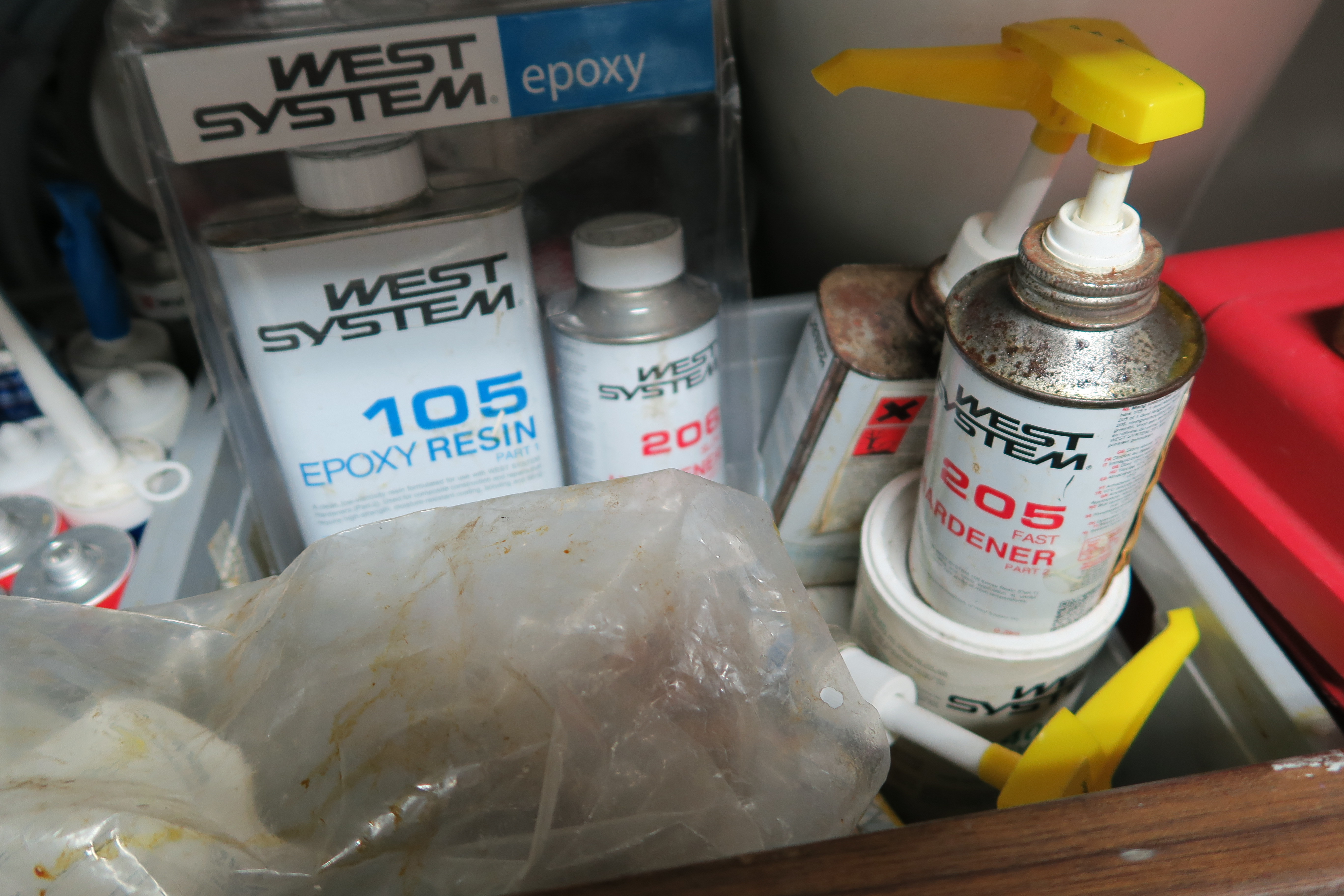

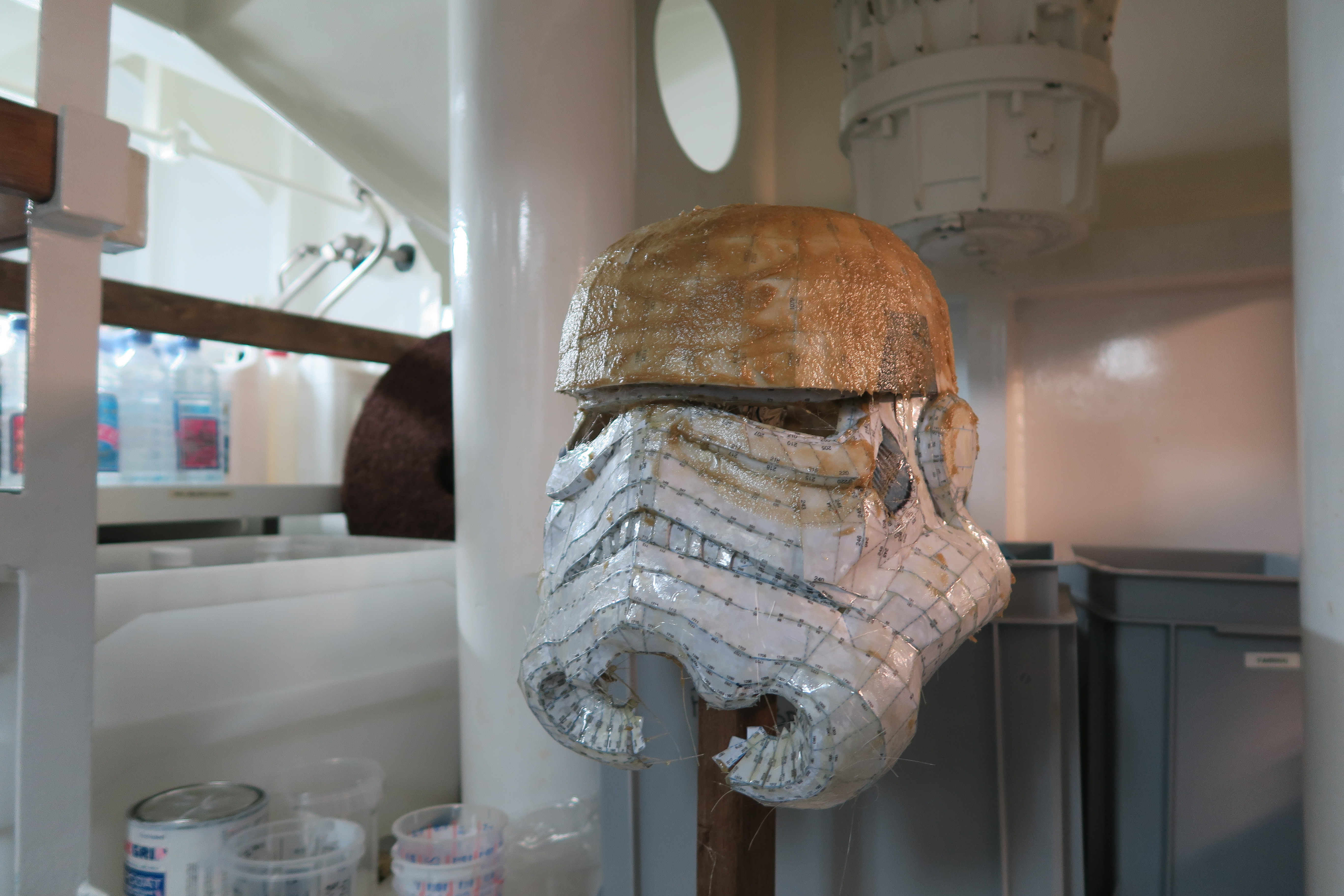

I covered my paper craft with West System epoxy resin, this is a 2 part resin with a 8-12 hour cure time, I brushed on over the outside and inside of the helmet, the card didn't absorb the west system like i was expecting it to so I didn't get drastic warps with the shape.
After the initial coat hardened I put in West System with fibre glass mat on the inside of the helmet to give the helmet the structural strength. I also mixed up some west system and their micro fibre which acts like a filler and covered the dome with it and shaped it by hand to get a round shape to fill onto.

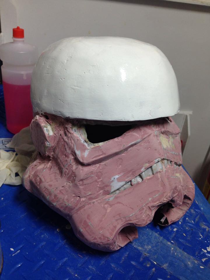

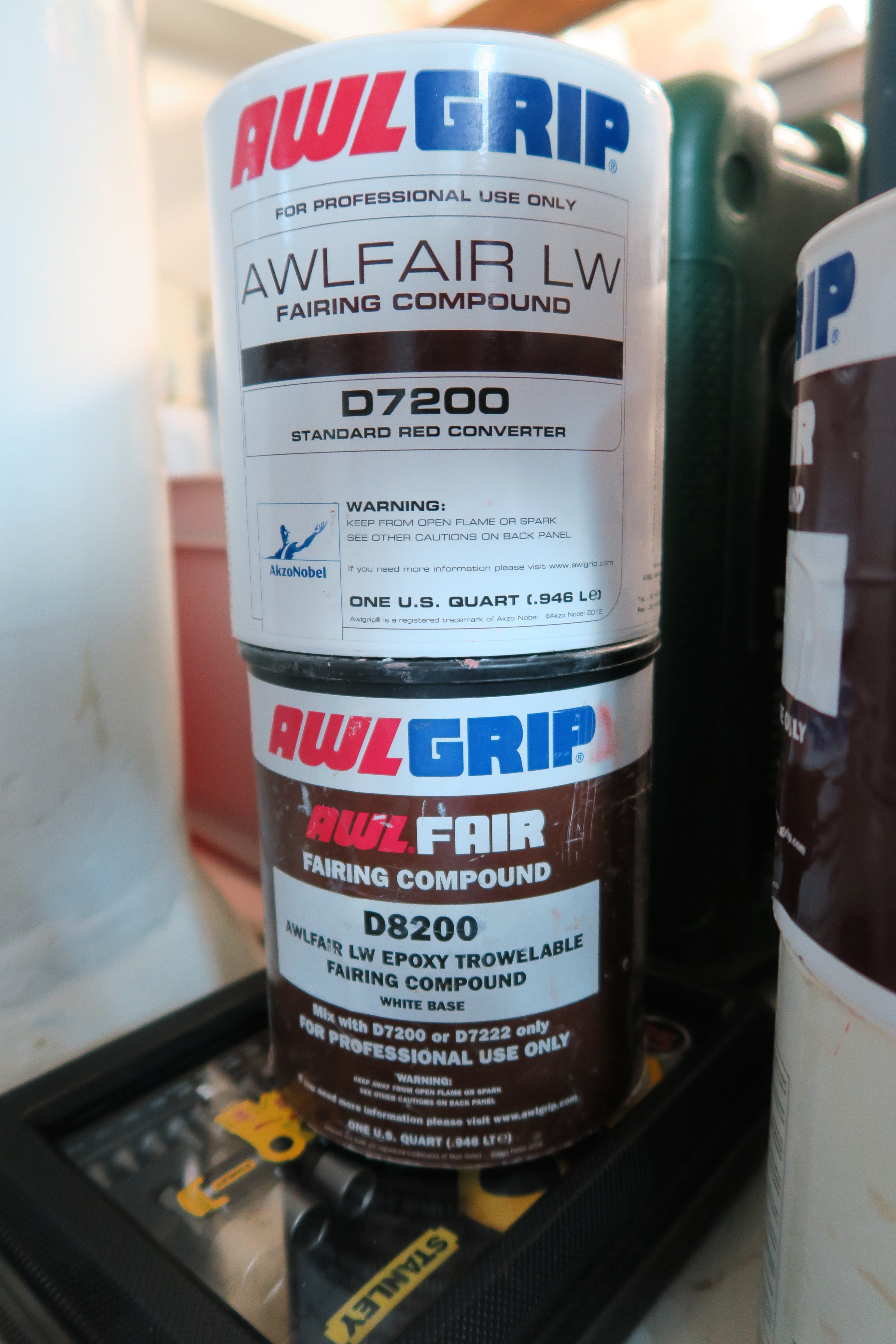

Once this was hardened I sanded it and applied my high build fairing (the pink stuff), this is Awl Grips Awlfair again this product as a very long cure time so a lot of time to work with and dries rock hard. These products are designed to take a beating from the sea for hull repairs and things like that so this helmet is pretty much hard as a rock by the time this cures.
After sanding i put on a poly filler this is a much finer filler than the awlfair but not as strong, when this had dried I sanded it then painted the dome with Awlgrips 545 epoxy paint primer, this was so i could easily identify the bumps and low points of the dome.
