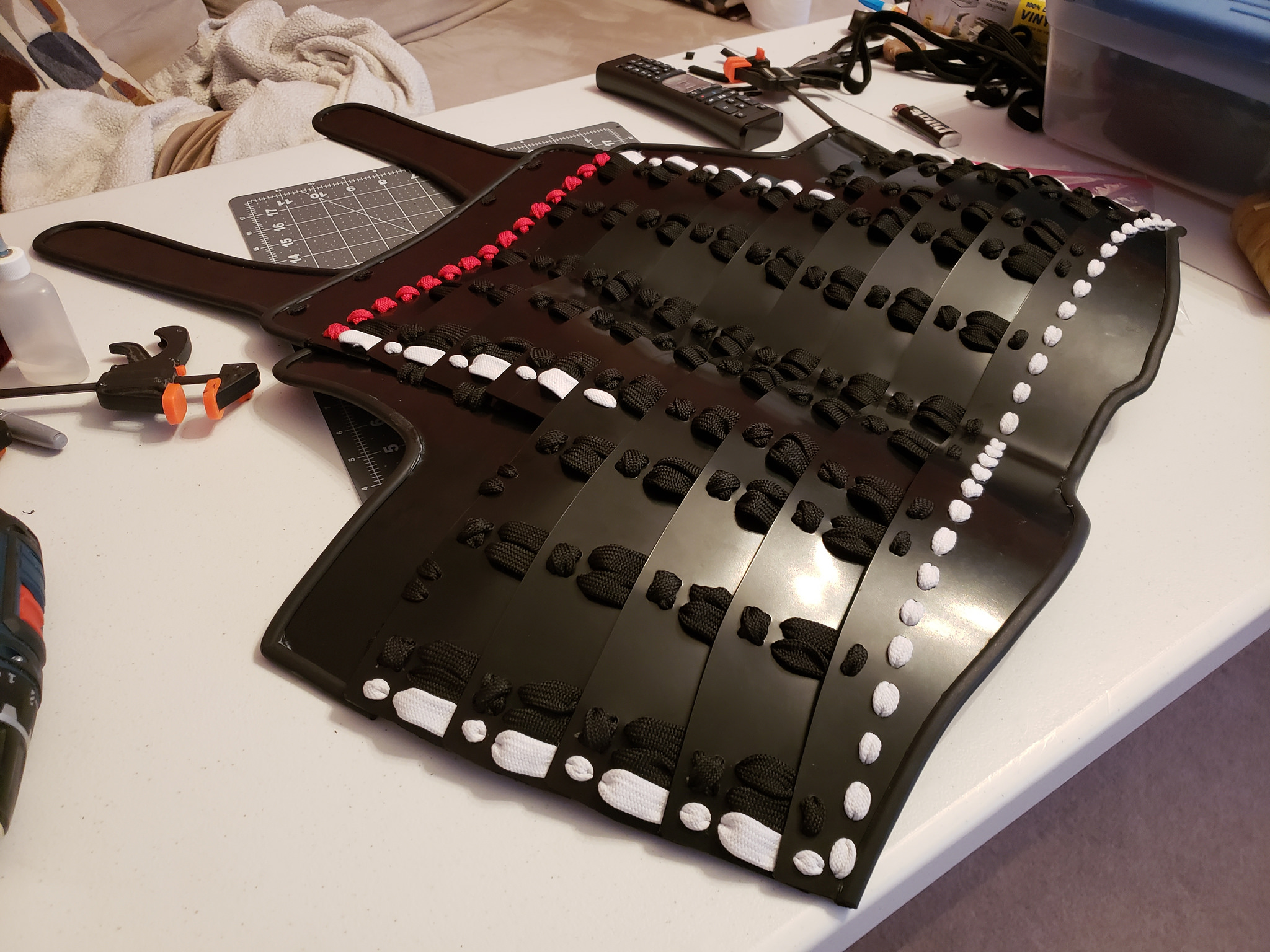

Work continues. I got the back of the Do all drilled out and shaped. Instead of using the oven, this time I used my heat gun clamped still and moved the lames across the heat (wearing proper safety gloves, etc.) and shaped each piece to the last. I started lacing it up but ran out of lace. I have ordered more and am waiting on it to arrive.
In the mean time I have started the process of drilling out the front of the Do and shaping them up. Also I have begun putting together the Waraji sandals.
