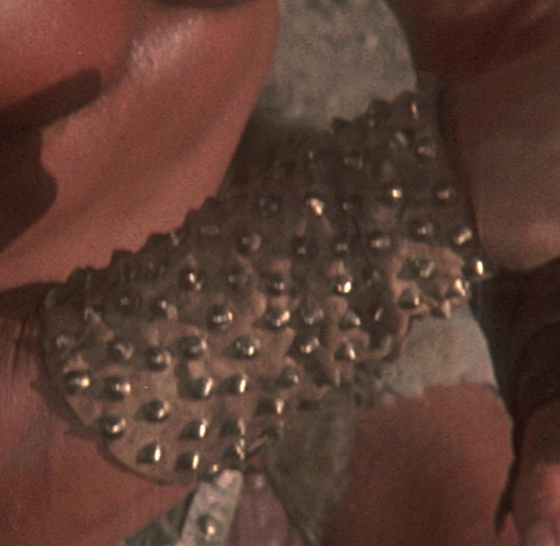

These bracers appear in both Conan films. In the first one sometimes at the right, sometimes on the left arm. In the second one only on the right arn. In the second image we see that many of the rivets were lost or removed during filming. So I will build a prototype to figure out the pattern and how best to approach this project ...

Tried to figure out the exact pattern of the rivets from the movie images. Very difficult. However, since the rivets are too pointed and smooth as compared to the originals (see lower row of rivets), I hammered them in shape (top row of rivets) ...
