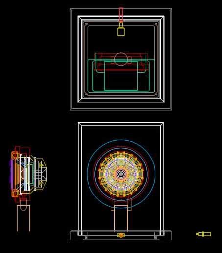

I have been PMing Jason about this and he has made it clear that he doesn’t have the time or desire to produce a kit for this prop.
I have looked at the drawing he posted and I can not understand how he built his reactor from them
When I pull it up all I see is this:
[SIZE=+0][/SIZE]
I am completely confused on how this drawing could be used to create the reactor that he built.
Am I missing something?
Hi Boba
I checked the file and it opens just fine.
It is an autocad file...you need to be using some sort of cad software that opens .dwg files.
As for "desire"....you might want to check out post 156. I found that the reality of reproducing this prop entirely in metal to be quite cost prohibitive.
If you have other resources that is great.....I shopped it around to 5 CNC companies in the US...and quite frankly I think their quotes were fair...its just a lot of parts as shown which quickly added up.
Hopefully you have better luck with the numbers than I did.
Take care
Jason
Jason
I was wondering what the deal was. I downloaded a viewer and the above screen shot is all I see when I open the file. I guess I need to get some autocad software to fully understand the drawings.

Hi, I was very impressed with the quality of the finished piece and saw some people were having trouble understanding the CAD drawing that has been posted here for download.
To help, I have produced a 3D CAD version.
I will post link as soon as I can.
Re: Machined Iron Man Arc Reactor: New Post #153
Here are the images
To explain for people who don't understand what they are seeing when opening the DWG file. Each color represents a layer in the overall assembly. In AutoCAD and many other CAD systems, you can turn off layers you don't need so you can focus on certain ones. The DWG that was provided is every single layer as an assembly in the 3 critical views required to reproduce the part in 3D (Top, Front and Side).
If you want to only see a fin for example, open the DWG and go to the layer manager (any CAD program or viewer worth anything will have this), and click the little lightbulb to turn off each layer you don't need.
