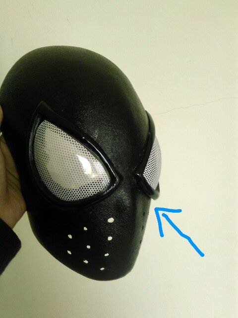

Hi luna, i have a question about shaping the lense frame to the shell, so when i using heat to bend it, does the frame needed so soft to bend it or...
I try to bend it few time and the upper arena of the framr shape good but the bottom arena of the frame cant shape to the shell 100%
Um… The frame does indeed need to be heated to the point where it is soft in order to bend it--if you try to bend it before it's hot enough you will snap it. You likely haven't gotten the frame evenly heated on your attempt.

I heated the frame then bend it, the upper arena shape to the shell good but the bottom arena cant shape to the shell perfectly :(
Oh and in the pic,the mesh it just i put it in, not glued yet
And i did wait for the frame to get hot, but it just not work like i expect, and i already broken a pair of my frame when i try to shape it ( although fhe frame is already hot)
You're not getting it hot enough. I had to use a heat gun with a max temperature of 1600 degrees (f) for a few seconds to get the frames flexible.
