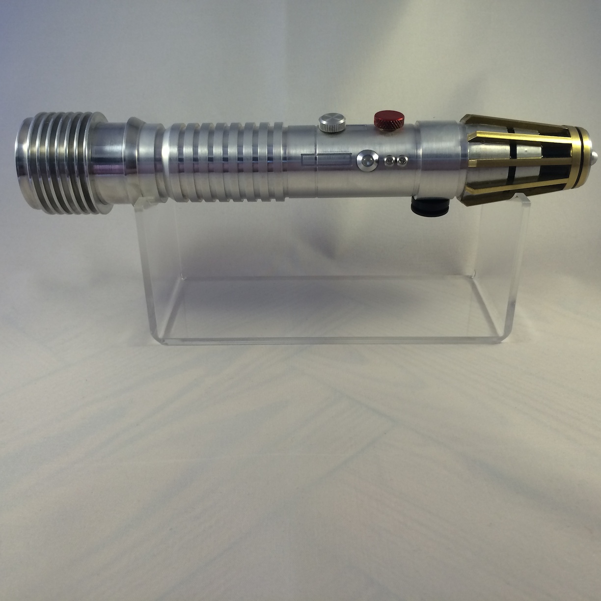

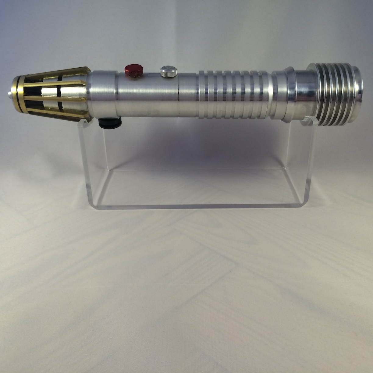

Here is my Luminara Unduli!
I commissioned OR to build this one for me a while back but just never got round to doing it because I wanted to make some improvements.

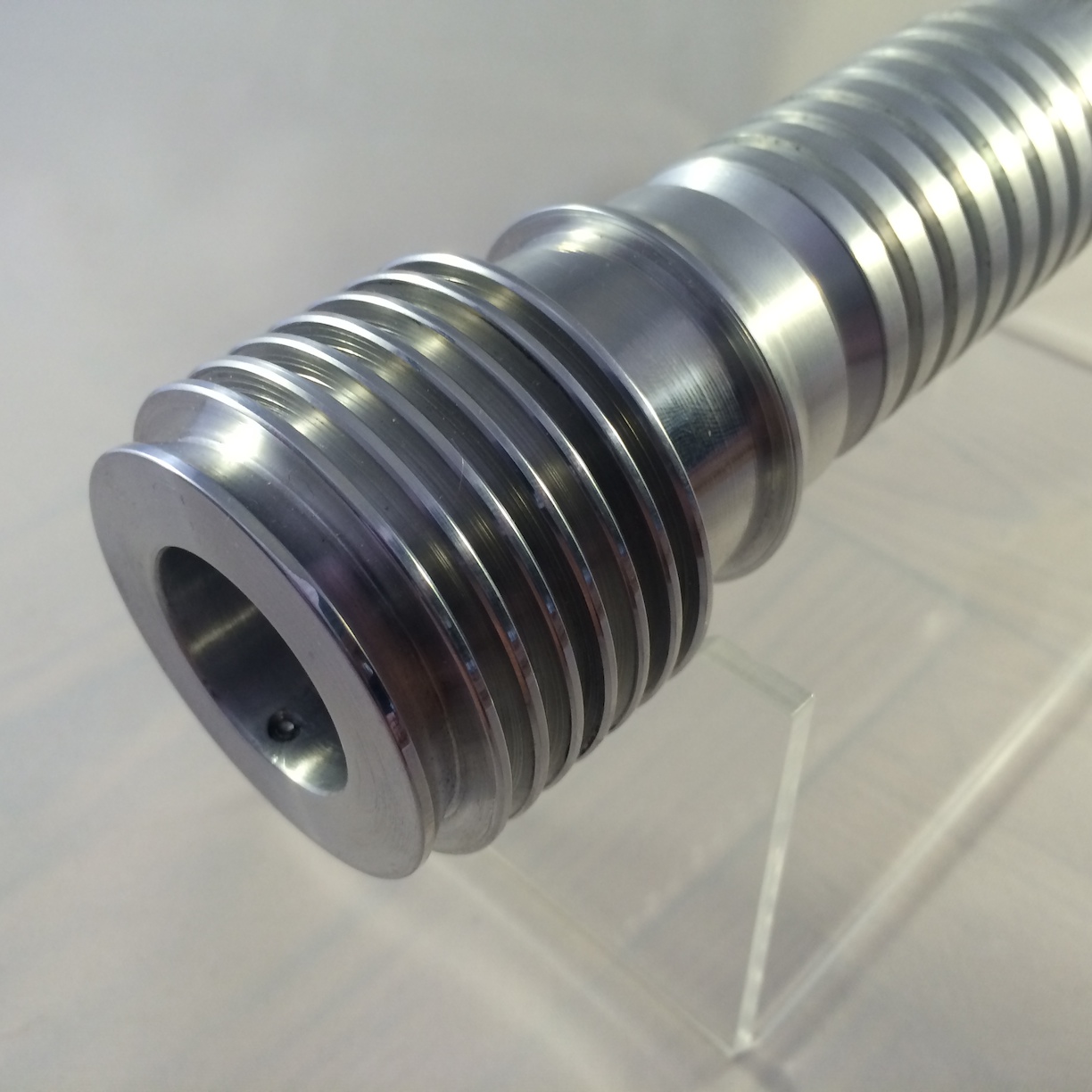

I had to machine the heat sink module for it, which I did by modifying v2 and v4 TCSS heat sink module. Then I drilled and tapped 2 holes for some small thumbscrews to sit next to the LED like the Luminara hilt should look (I believe)

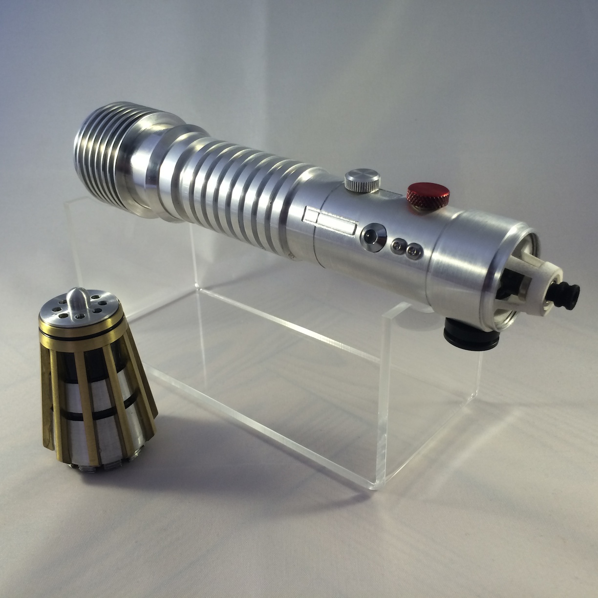

After all that was done I cracked on and done the install!
This one features:
PCv3.0
Tri Rebel GGW (Green in series so super bright and white FoC)
Yellow power on indicator
Twin 14500 7.4v Pack
2W Deluxe Bass Speaker
In hilt recharge port
3D printed chassis and speaker/recharge port holder
Easy SD card access under emitter
I really enjoyed building this saber. It is just so gorgeous and feels great in your hand. Shout out to Force Relics for the 3D parts! You guys rock!
Video and pictures below - let me know what you think:
