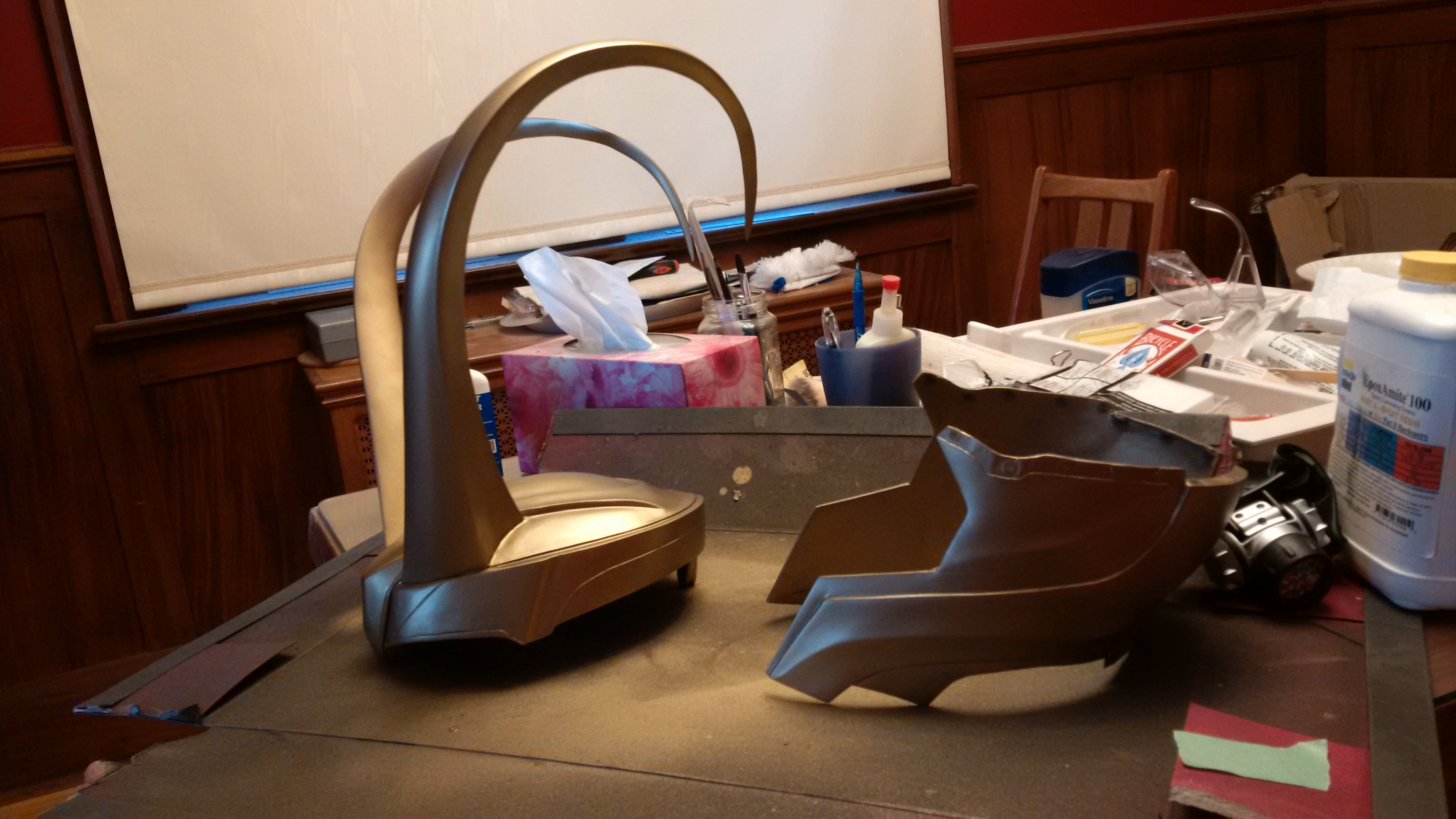

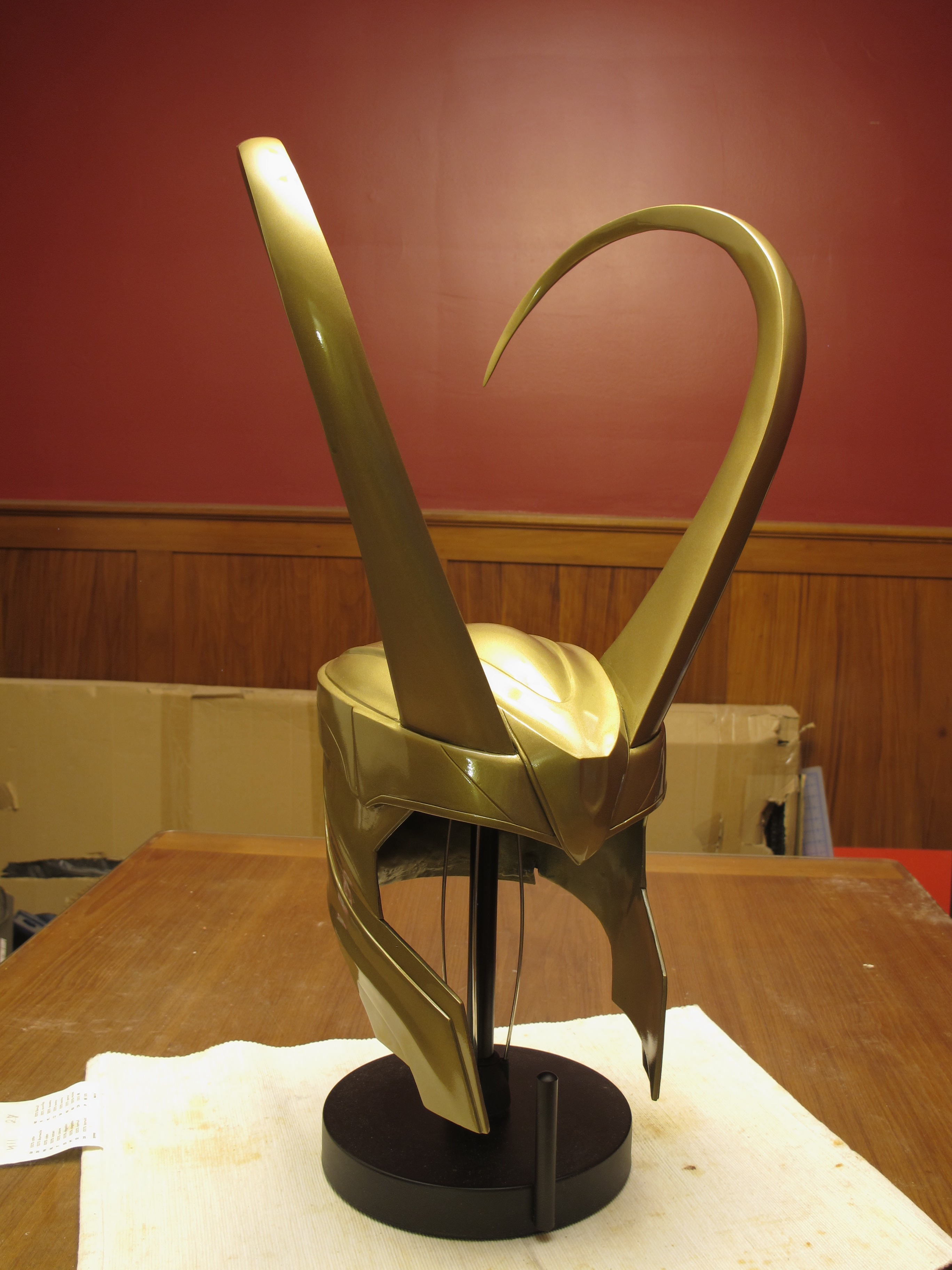

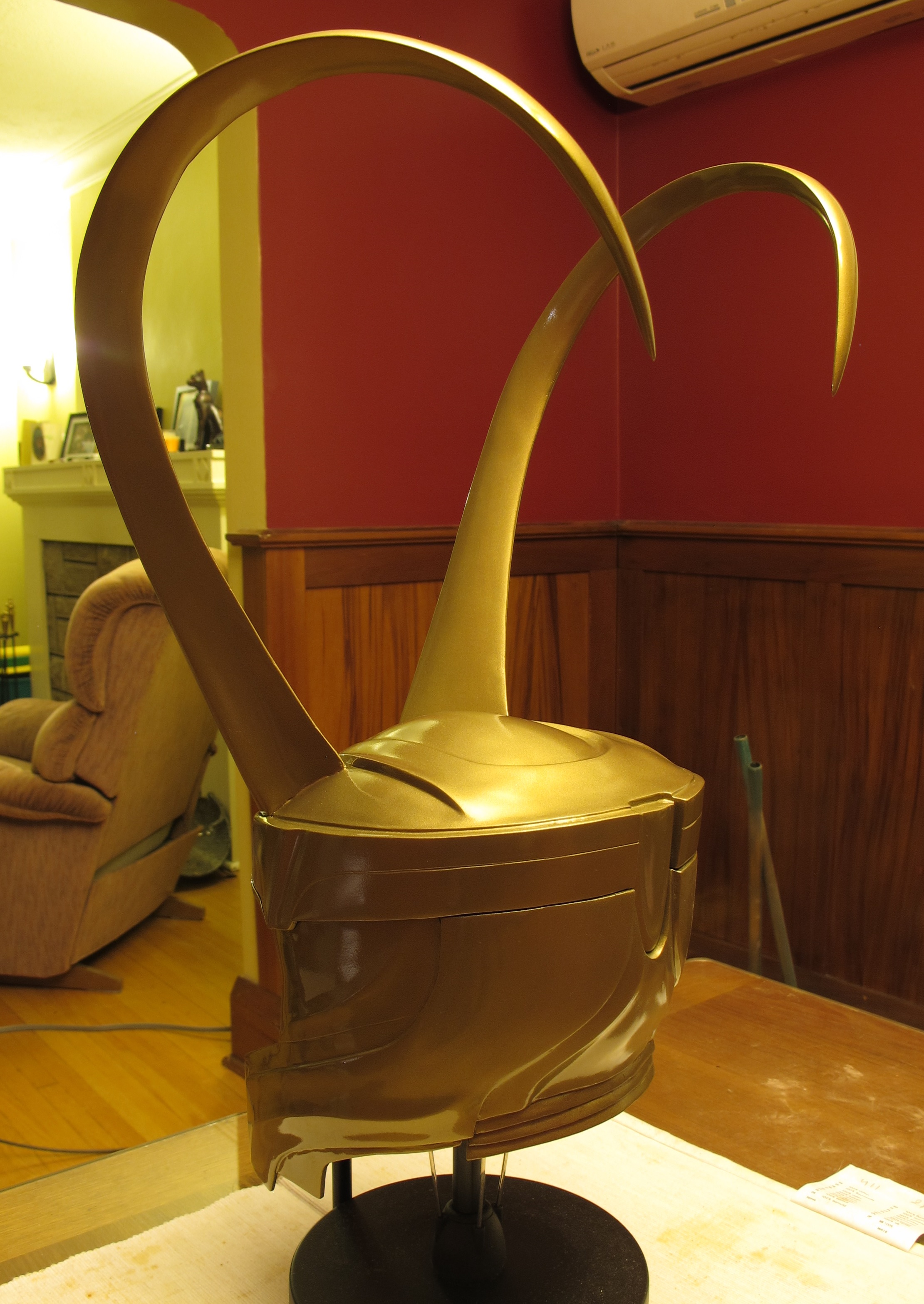

Hi everyone, I've been sort of lurking on this board and the 405th on and off for the last few months as I worked on my own project. This is my first pep ever, although I had to restart twice before reaching the final product, but I learned a lot along the way.
The pep was hardened withe epoxy and fibreglass cloth, then sculpting and details were added with bondo. The helmet is mostly finished now - I'm currently trying to decide if I want to wet sand, buff and polish the clear coat on it.
It comes apart into two pieces in order to be worn, like so:
I have 'in progress' photos if anyone is interested.

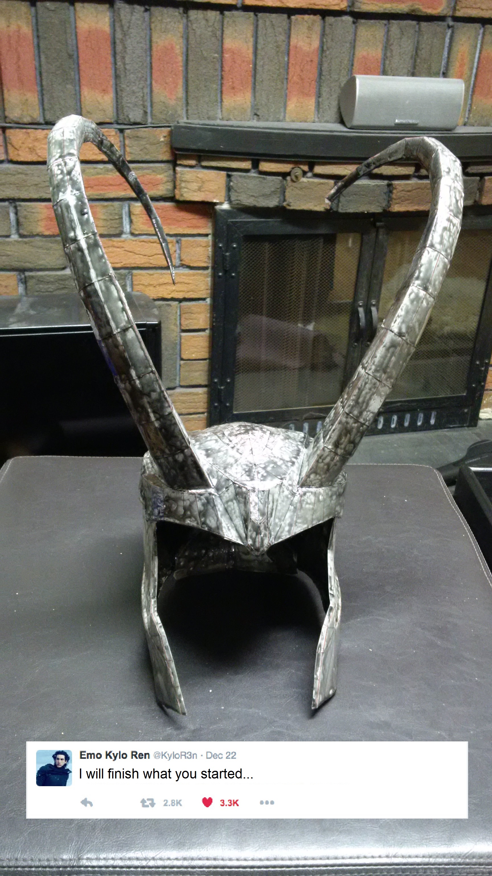

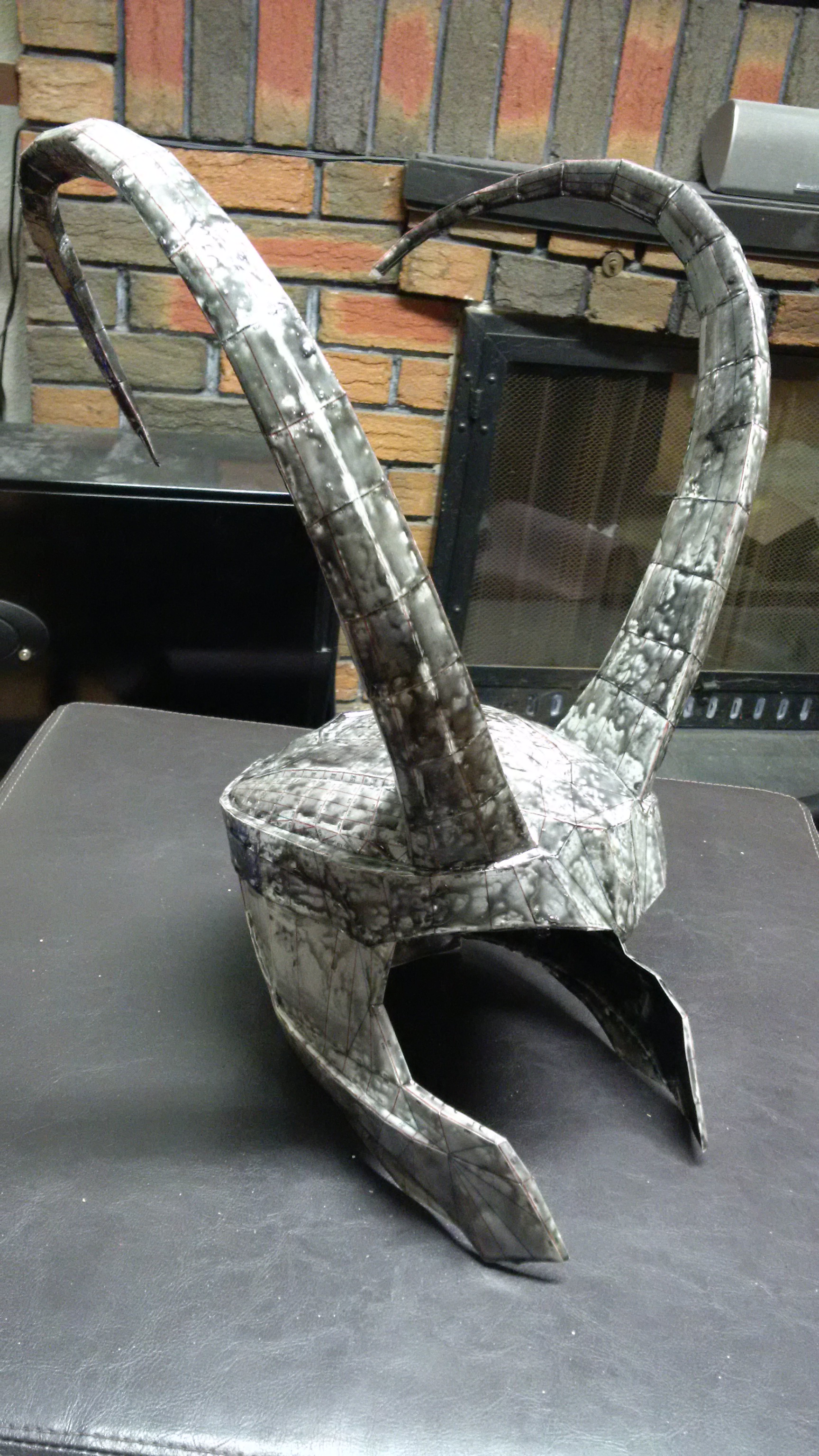

Thanks! This was actually my third attempt at building this particular pep. On my first try I used a brush to apply epoxy as a hardener and I ended up with drips. Also because the sides and front of the mask aren't a closed circle, its harder to brace properly, and some parts mask warped badly during the process.
So I took the opportunity to do some more editing to the model to make it closer to the movie prop and tried again. On the second try I noticed that some of the scaling wasn't quite right for the two sides of the mask and it ended up being too short, so I had to go back and make more changes.
When I look back at my disastrous first attempt I can't help but think of this:

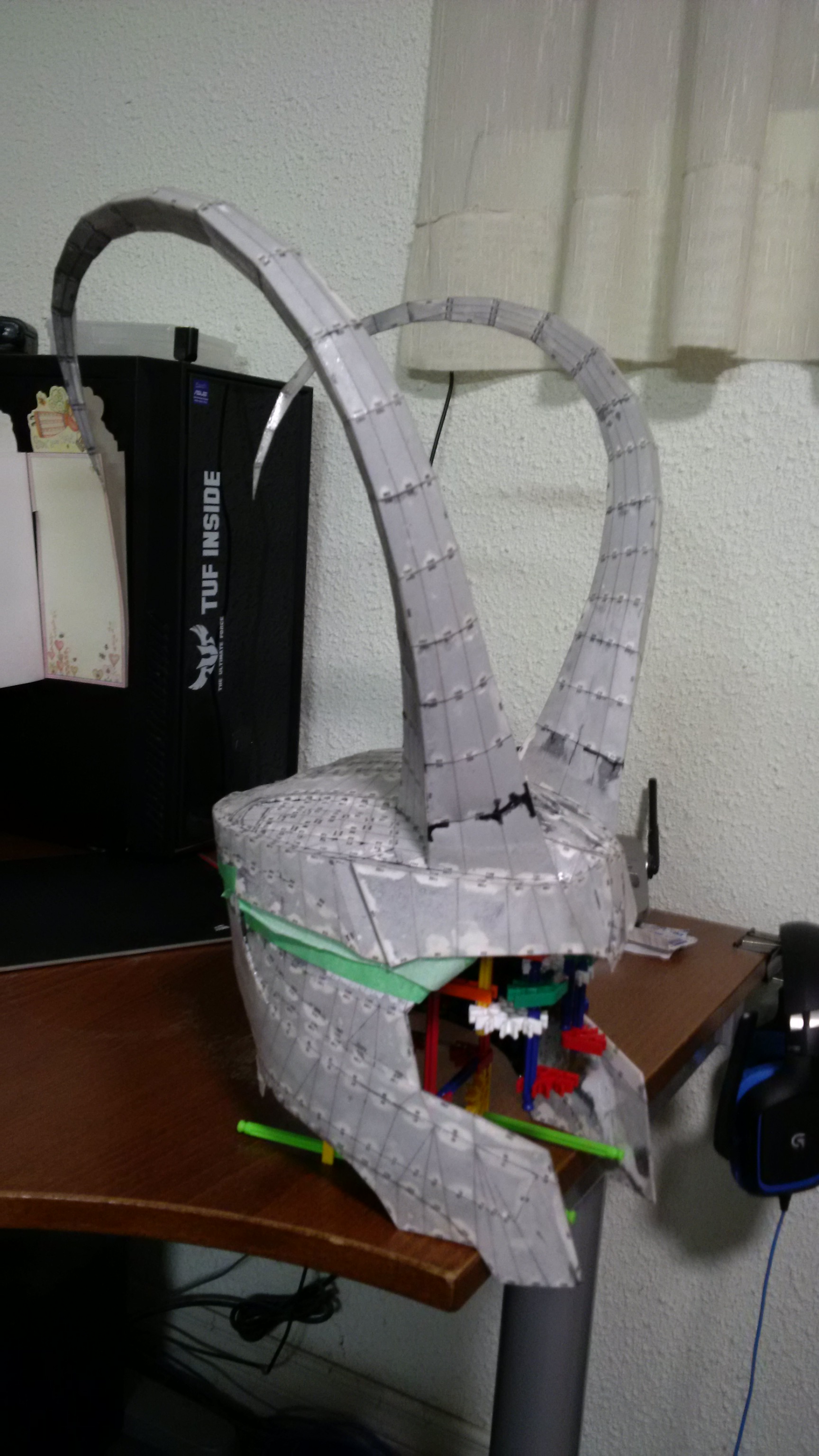

For my third attempt I bought some K'nex and made a frame to hold everything in place. Here's a comparison of the first and third attempts after the hardening process was complete on each.
That is really clean. It looks amazing.
