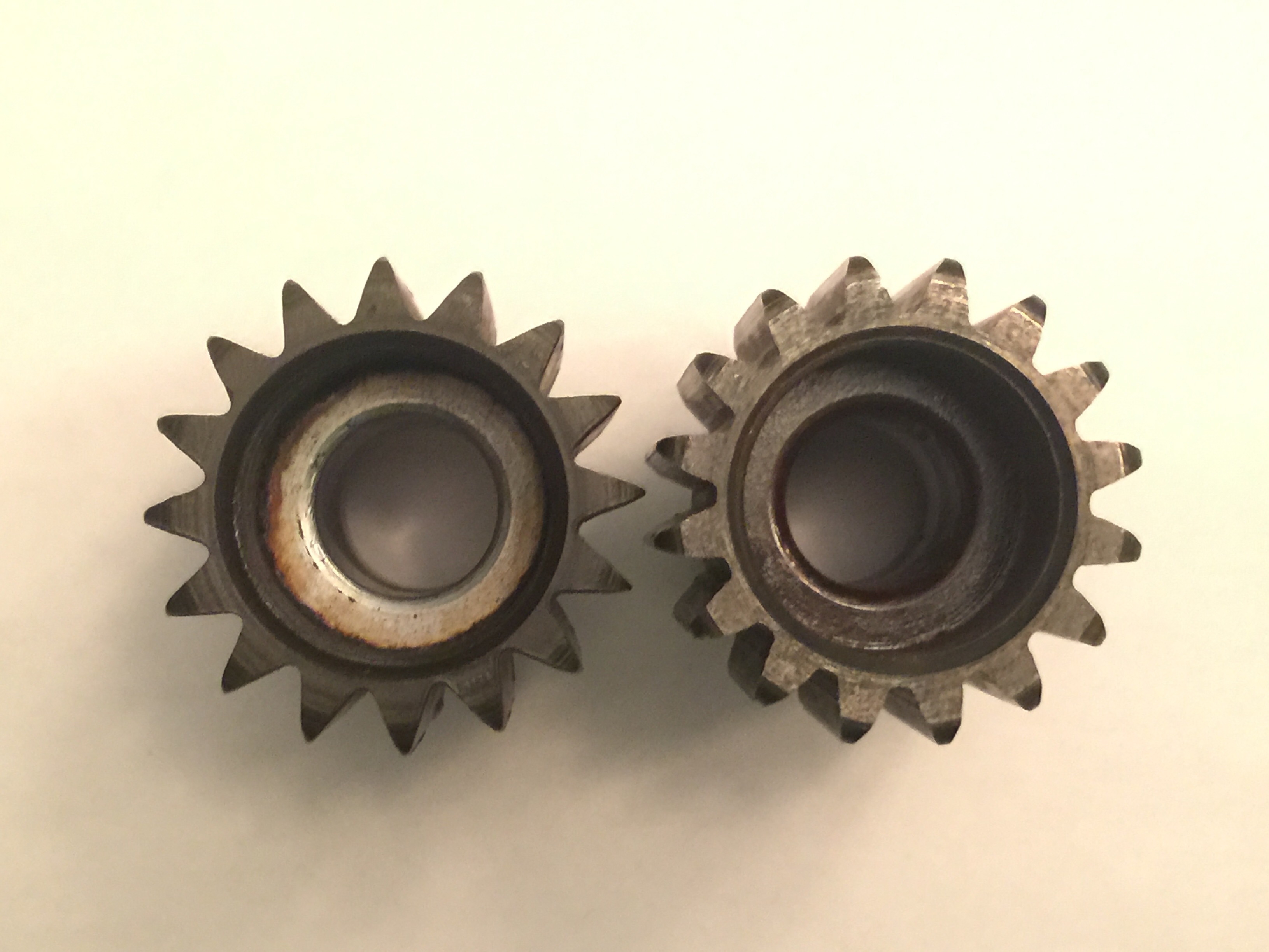

Heartblade, there are a couple of ways to tell:
1) the peaks of the booster vanes are typically sharper (more pointed and thinner) than the repros that I've seen.
2) real boosters will be parkerized everywhere except on the inner surface which will be chromed. This was developed some time during the Mark II cycle due to the caliber of the Browning being too small for the high rate of fire. These two factors combined to create too much fouling in the bore of the original boosters which were entirely parkerized. The chroming was done to help facilitate the ejection of gases, debris, etc. during rapid cycling.
3) generally speaking, real boosters tend to be nasty dirty. And I don't mean like a booster has been sitting in a barn for 50 years collecting dust sort of way. I mean grimey greasy nastiness, but that isn't always the case, just usually.
Re: LIGHTSABER - OBI-WAN KENOBI - REAL PARTS BUILD - THE JOURNEY HAS BEGUN!~Ridire Fi
How do you guys tell if you have a genuine booster? I would jump on it as long as the financial strain is not too much. Although you can't say that and go for the Obi at the same time. The booster, grenade, and balance pipe compose the holy trinity of the Obi so I would jump on it.
Here are some comparison shots from when I finally got my 1st booster. Note the sharpness of the fins on the vintage one on the left; Roman's excellent replica on the right.
This particular vintage booster is now in the Teecrooz National Star Wars Museum.

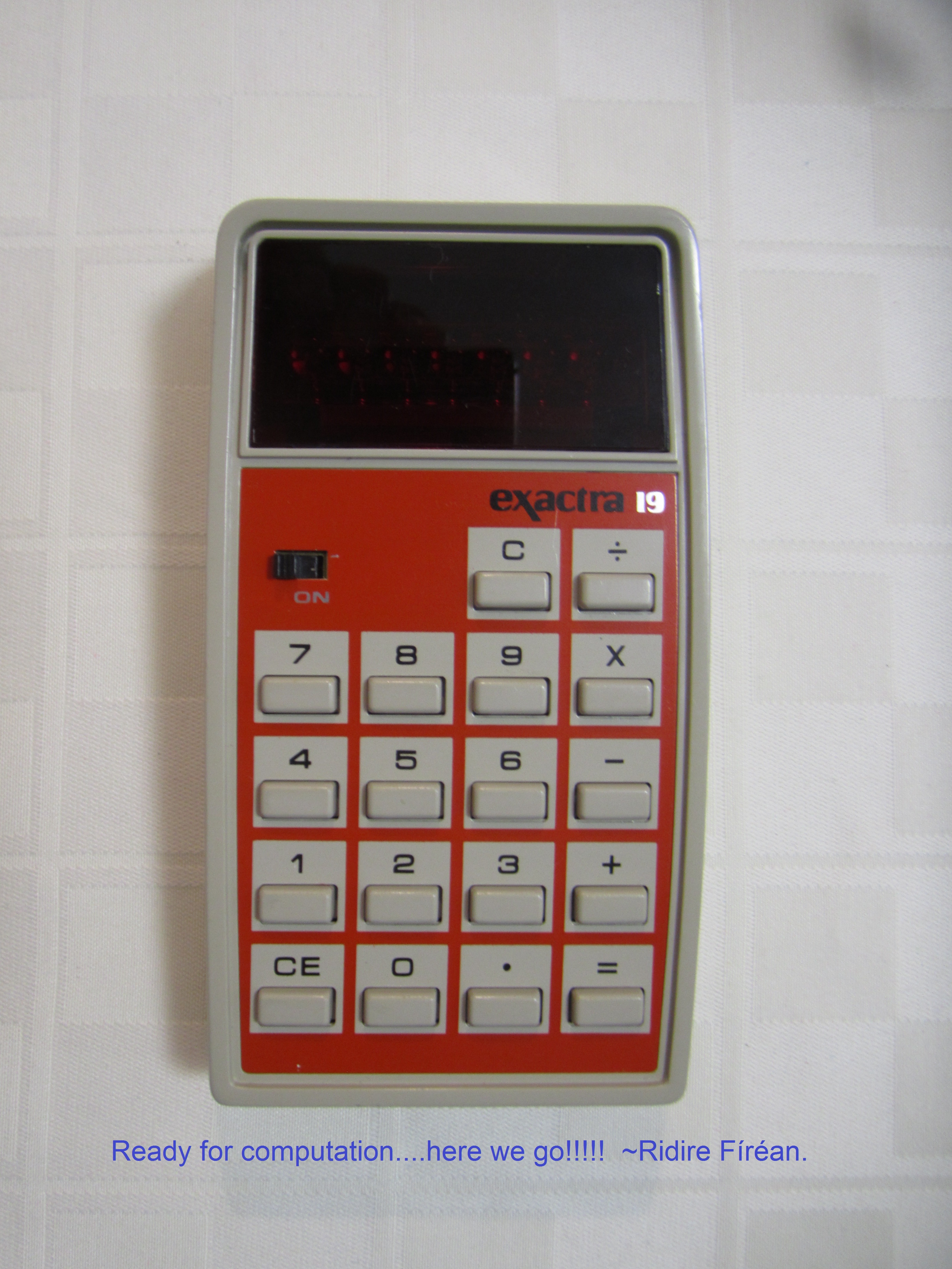

Episode II : THE EBAY STRIKES BACK
A long time ago in a camerashop far,
far away....
It is a dark time for the build.
Although the EXACTRA 19 has been
found, the Vintage GRAFLEX Camera
Case has proven to have two very
small and inaccurate D-Rings.
Evading the dreaded Ebay
Snipers, a group of Benjamins
sent by Ridire Firean have
established a new special
activation plate on
the Real Parts Obi-Wan Lightsaber.
The evil lord D-Bag, obsessed
with bankrupting young Firean, has
demanded thousands of remote
Washingtons for the procurement
of the Booster Bearing....
Pics here tomorrow, I started to create this post, but I'm spent for the day.

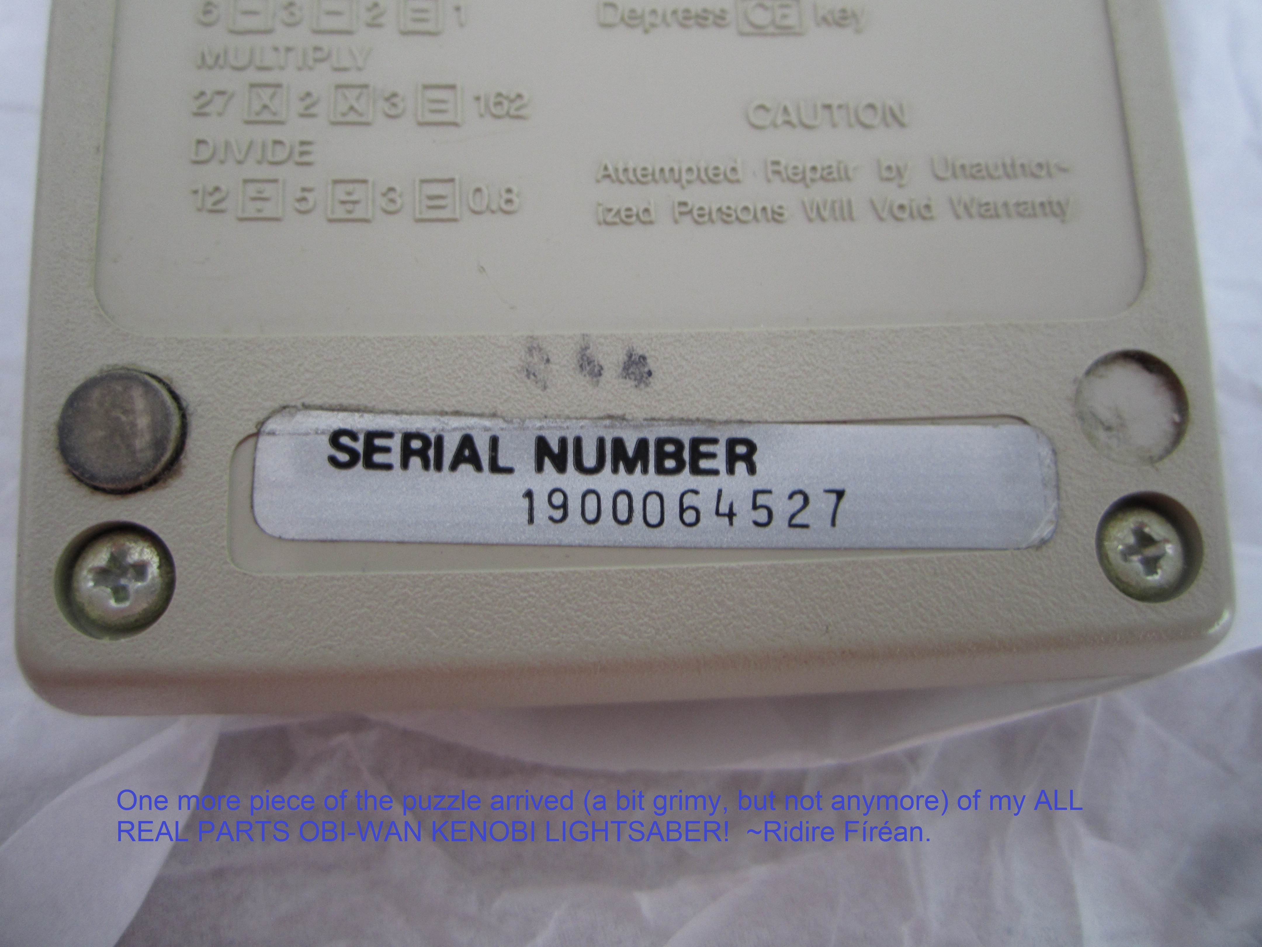

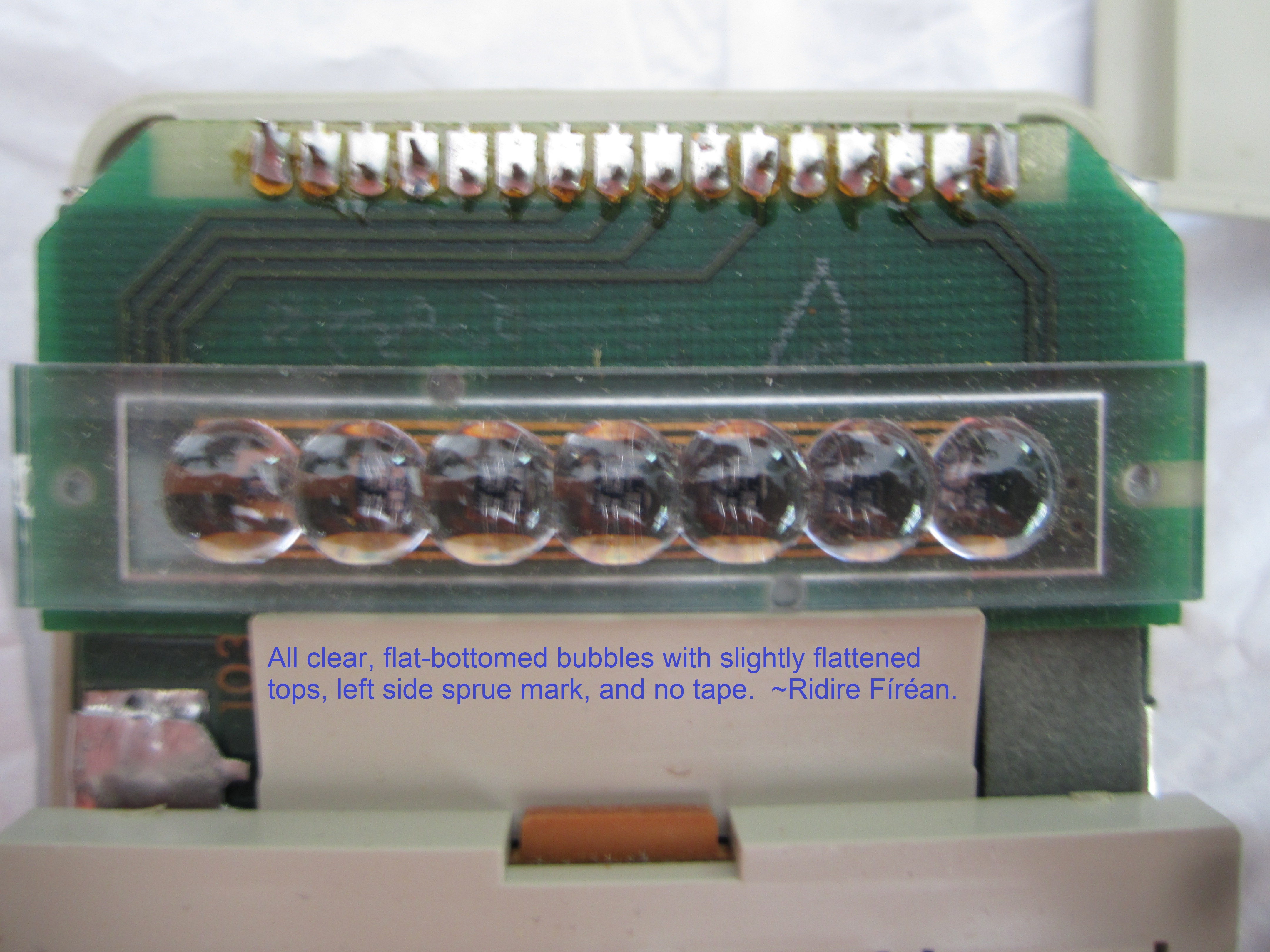

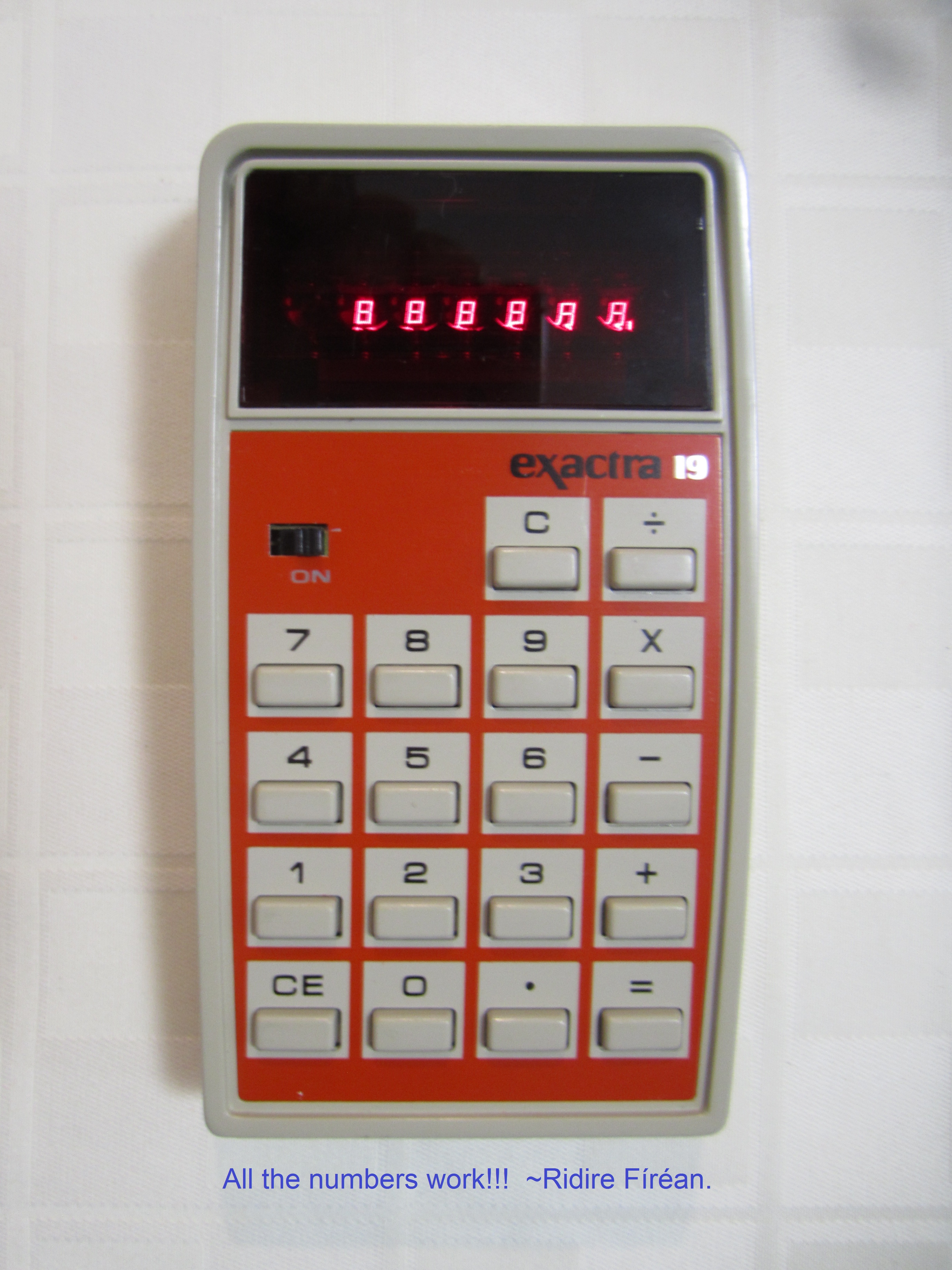

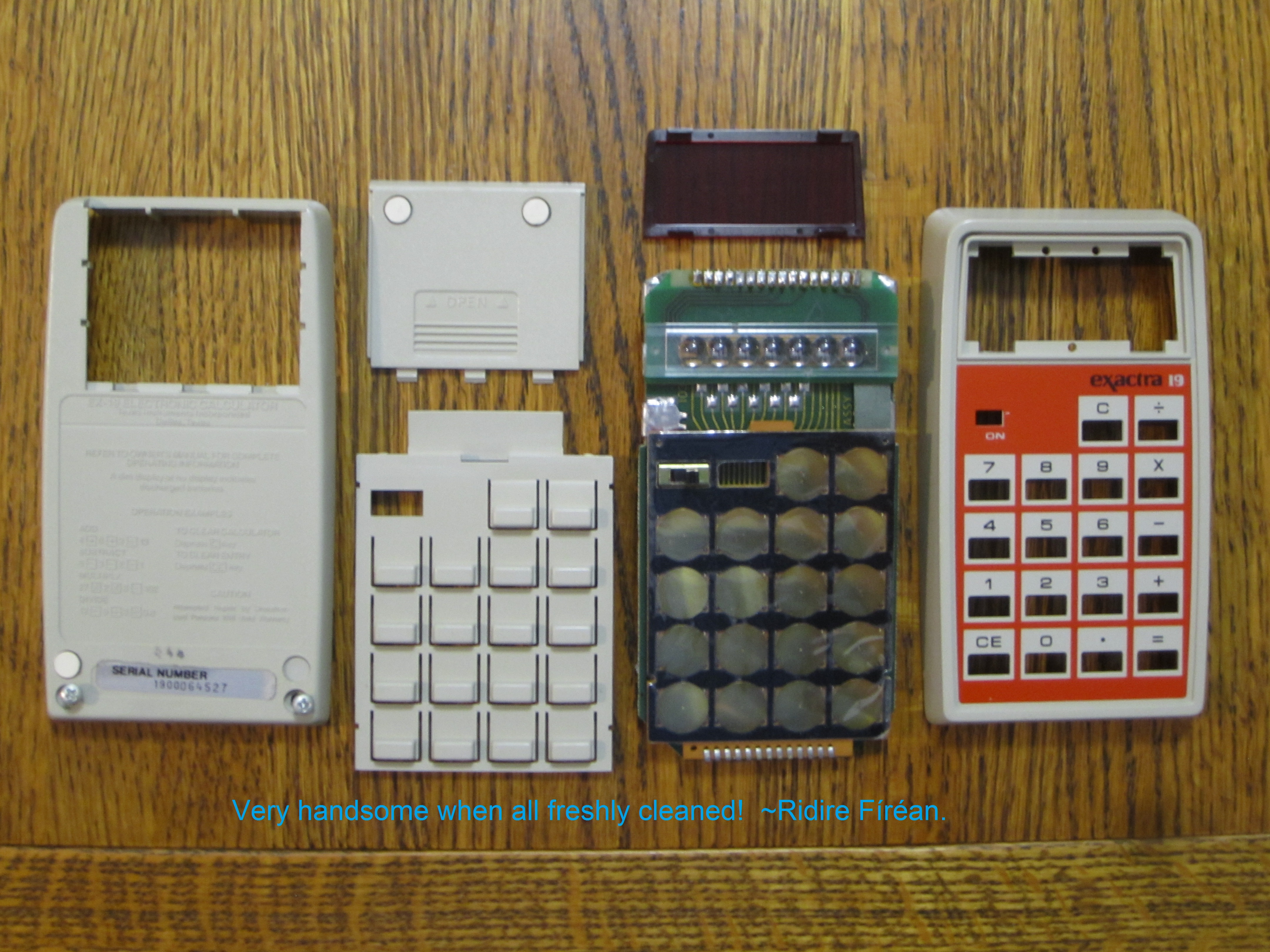

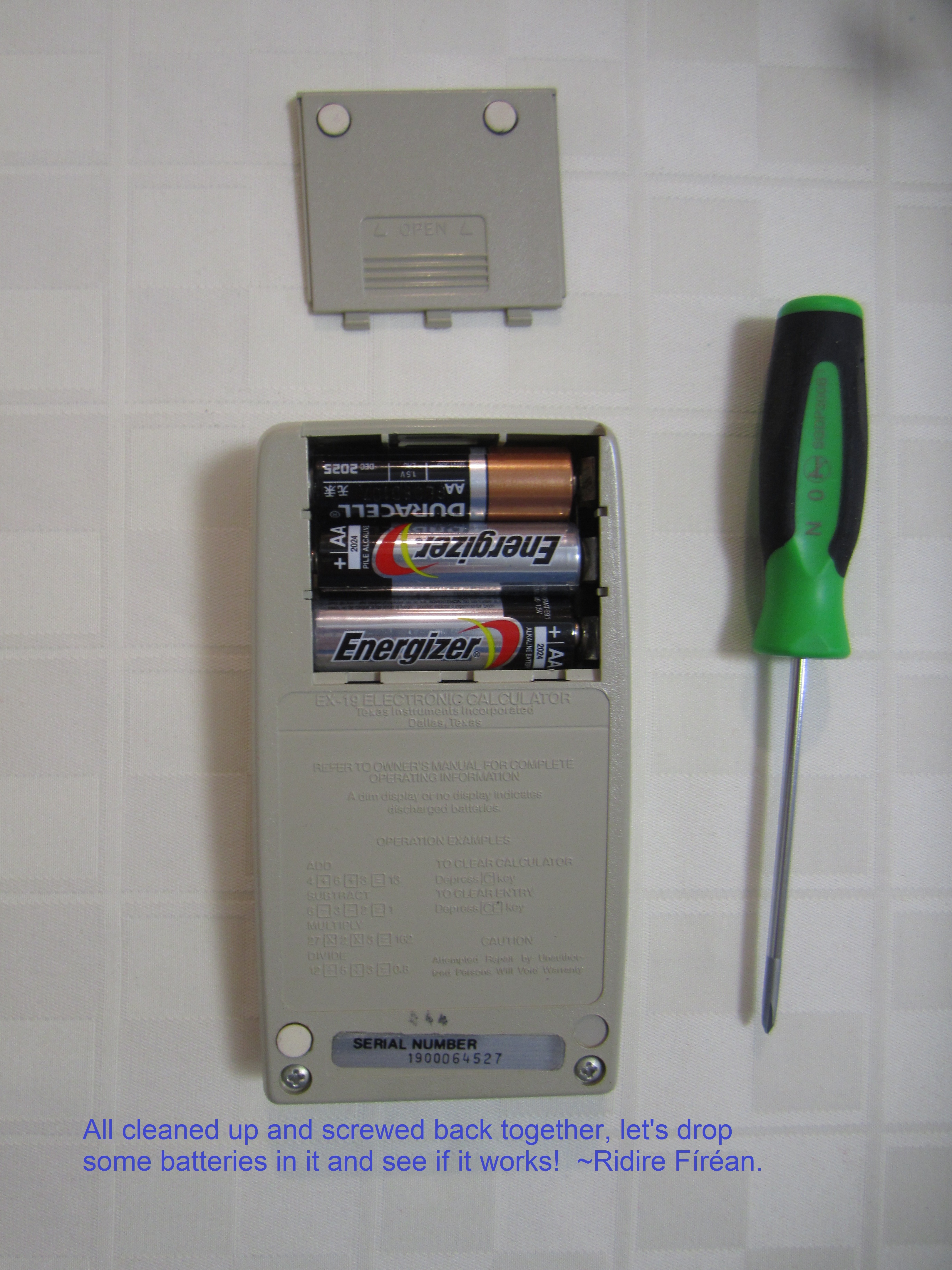

UPDATE EDIT: Here's those pics, well, some of them anyway. I'll have to do another round of photos to show y'all what to look out for when shopping for a Vintage GRAFLEX D-ring on another day.
Ridire Firean - ALL REAL PARTS OBI-WAN KENOBI LIGHTSABER - EXACTRA 19 - 1900064527 - 01.jpg
Ridire Firean - ALL REAL PARTS OBI-WAN KENOBI LIGHTSABER - EXACTRA 19 - 1900064527 - 02.jpg
Ridire Firean - ALL REAL PARTS OBI-WAN KENOBI LIGHTSABER - EXACTRA 19 - 1900064527 - 03.jpg
Ridire Firean - ALL REAL PARTS OBI-WAN KENOBI LIGHTSABER - EXACTRA 19 - 1900064527 - 04.jpg
Ridire Firean - ALL REAL PARTS OBI-WAN KENOBI LIGHTSABER - EXACTRA 19 - 1900064527 - 05.jpg
Ridire Firean - ALL REAL PARTS OBI-WAN KENOBI LIGHTSABER - EXACTRA 19 - 1900064527 - 06.jpg
Ridire Firean - ALL REAL PARTS OBI-WAN KENOBI LIGHTSABER - EXACTRA 19 - 1900064527 - 07.jpg
Ridire Firean - ALL REAL PARTS OBI-WAN KENOBI LIGHTSABER - EXACTRA 19 - 1900064527 - 08.jpg
Ridire Firean - ALL REAL PARTS OBI-WAN KENOBI LIGHTSABER - EXACTRA 19 - 1900064527 - 09.jpg
Ridire Firean - ALL REAL PARTS OBI-WAN KENOBI LIGHTSABER - EXACTRA 19 - 1900064527 - 10.jpg
Ridire Firean - ALL REAL PARTS OBI-WAN KENOBI LIGHTSABER - EXACTRA 19 - 1900064527 - 11.jpg
So there you have it, one more piece of the puzzle checked off of the list! Now to find a 20! Wait, what?! Oh, I suppose. Can't hurt to have one of each right? ;) Good Night everybody!

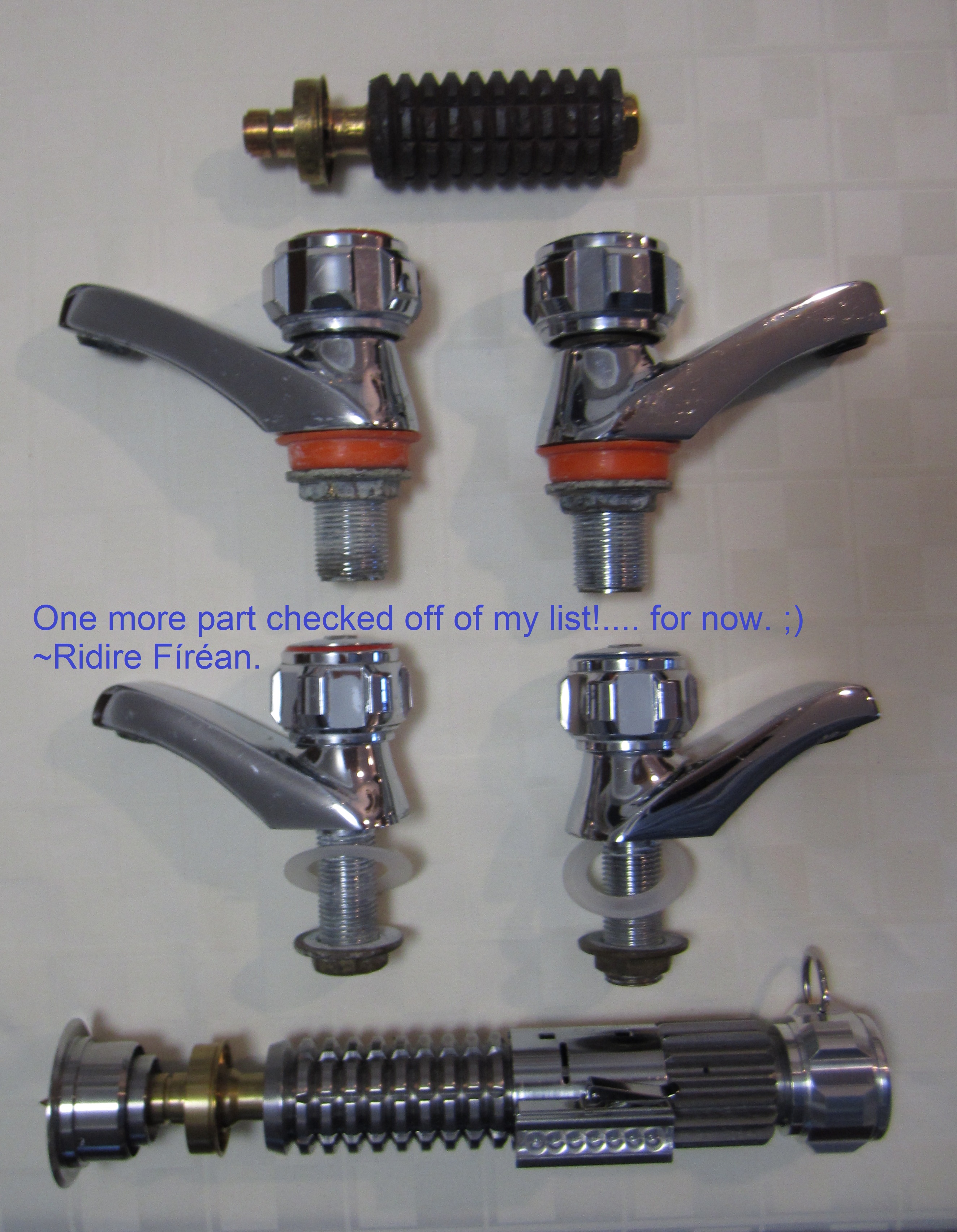

And Coming Soon!...
Episode III : RETURN OF THE HANDWHEEL
A long time ago in a sink far,
far away....
Ridire Firean has scoured the internet
on his home search engine of Google in
an attempt to rescue vintage taps from the
clutches of the vile gangster
Britt the Scrapyard.
Little does Ridire know that the
GALACTIC EBAY has secretly
begun shipping boxes with even
fewer and ridiculously more vague
updates than the dreaded USPS.
When delivered, this well searched
part will spell certain completion for
the small section of the ultimate
weapon known as the pommel and
will restore a sense of hope
to the galaxy....
Capt'n Jack Sparrow : 'It's pronounced pommel . . . not pomell . . . now bugger of . . . and fetch those stinking Washingtons to reach an accord!' . . . :behave
Chaïm

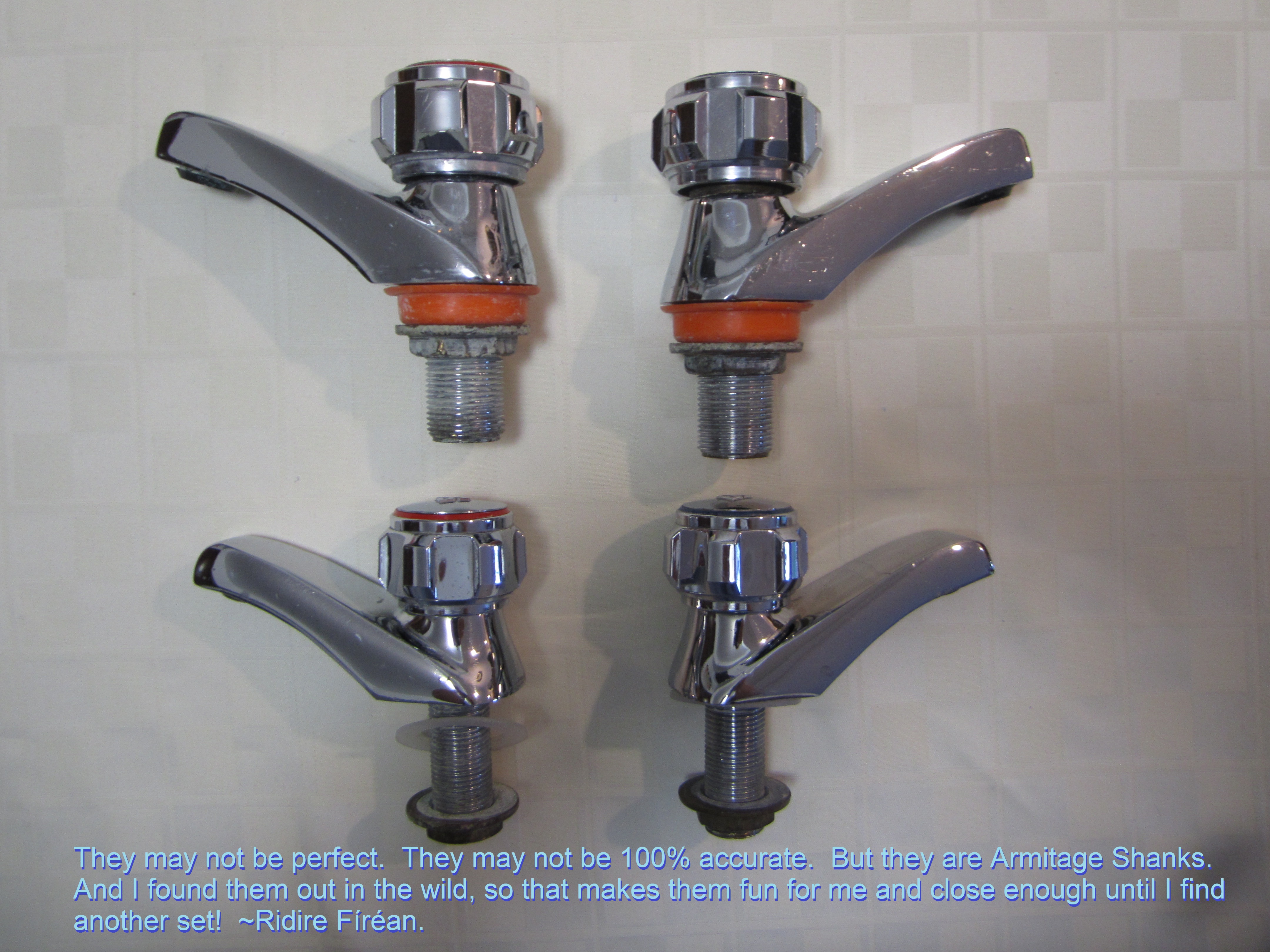

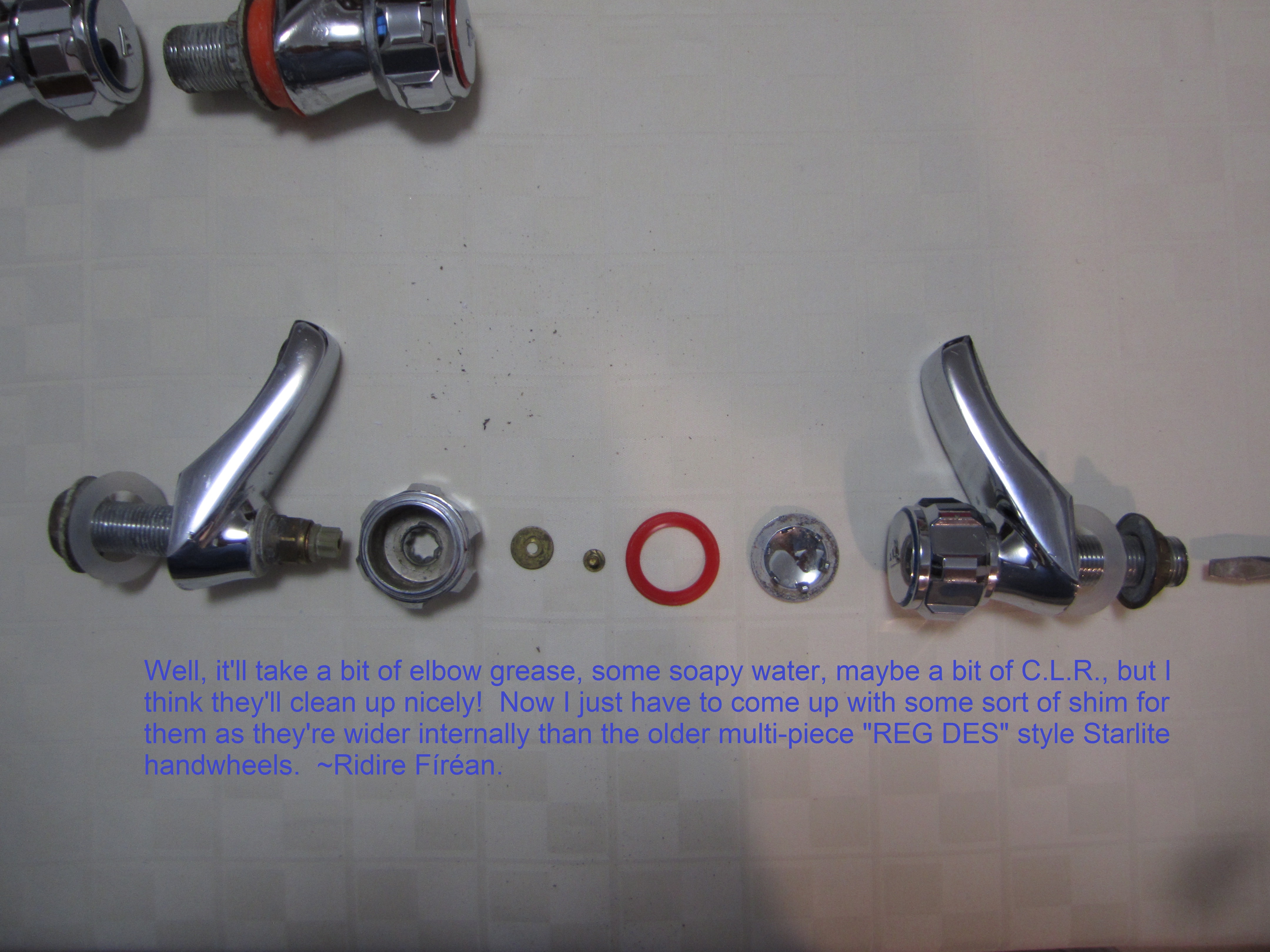

Lookee what arrived today from across the pond!
Now then I'm left with a conundrum...
What to do, what to do? STAR WARS themed bathroom?....Or 2 Obi-Wan Kenobi Lightsabers, PLUS 2 115%-Scale Obi-Wan Kenobi Lightsabers?
Decisions, decisions, decisions. ;) A Jedi's work is never done. :lol
All in all, I'd say I did pretty good for searching through 38,678 listings. And I think I certainly got my $59 worth! The chap I bought them from was an awesome guy and went the extra mile for me relisting the auction several times, not only to exclude the things I didn't want, but also as he learned how to list for international shipping. I'm very thankful that he and I got along so amiably, that we were able to work through sorting out the listing together with great accord, and that both of us were pleased to get we wanted out of the deal. With any luck, he'll tell his neighbors about selling his old faucets to some bloke in the USA and they'll ask him for my information when they go to redo their bathrooms! Lightsabers crossed!!!
