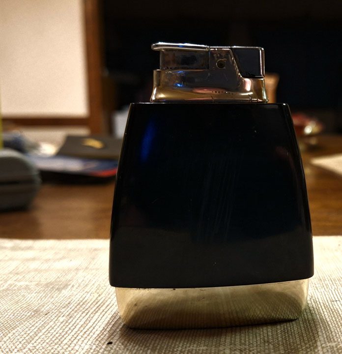

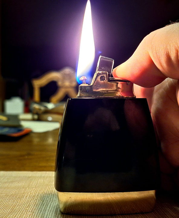

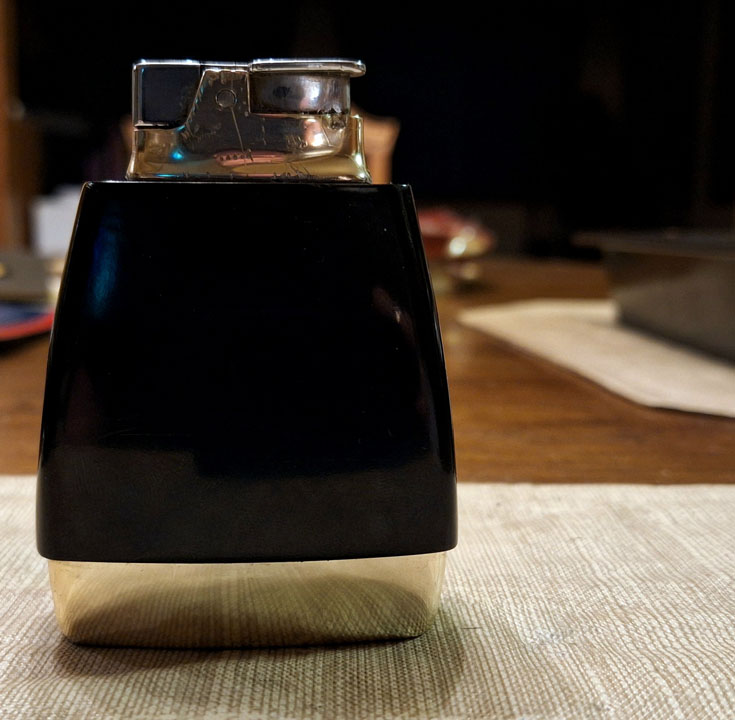

Ronson Pioneer Table Lighter (1960)
I had a heck of a time getting this thing out of the base and made some marks on the side in the process. It was similar to the New Yorker lighter in that the plastic base tightened up over time and created a suction effect. I drilled some material out and it's much easier now, but the damage is done. There was some marks already there as well, but I got it for $16 so....
It's got some kind of rivet mechanism on it too. Fortunately, I was able to drill the old flint out with a drill from below (straight channel) so I didn't have to touch the snuffer mechanism. There was a bunch of yarn in the bottom as well. I don't know if that was supposed to be extra material to soak up lighter fluid that could be absorbed through the Zippo style bottom of the lighter or what. I removed it. I'd put cotton in instead if I was going to use it like that. String just doesn't work as well, IMO.

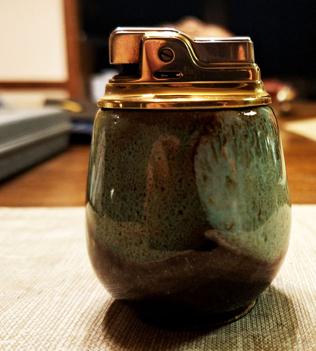

Ronson Tropicana Table Lighter (1954)
This was available as part of a set with a matching ashtray, which is quite rare as a full set. I'm not certain if it was sold separately. In any case, only the lighter was for sale here. I cleaned it up, polished the brass, removed the frozen flint and manhandled the stuck fuel cap off.

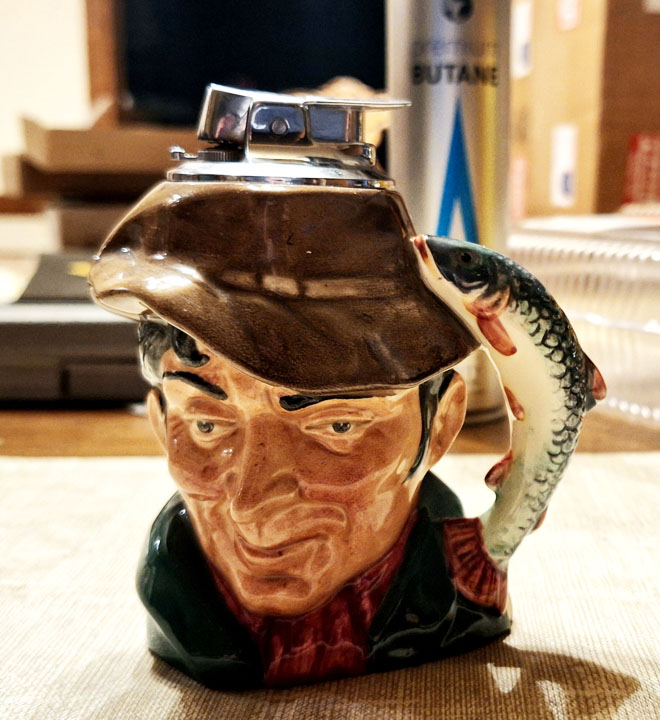

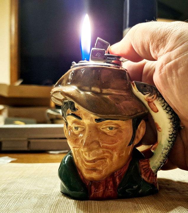

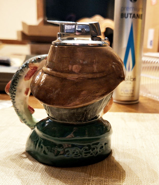

Ronson Butane Insert (1954) with Doulton & Co Ceramic Base "The Poacher" (1954)
It was hard to pass this one up at the price they were asking given the ceramic base sells by itself for $50-200 online without the lighter. It's called "The Poacher" and was made in 1954 by a Dutch company. I think it kind of looks like Dean Martin with a fishing hat.
The lighter was modified around the base slightly to fit tightly into the opening. It had a flint stuck in it and some kind of pink wax thing inserted in the flint tube I had to remove. I replaced the fill valve with a new one obtained from a seller in Britain that has them.
It was still leaking out the top valve and yet if I push on the tip with my finger no gas was leaking. This means the spring is too weak on the ball bearing on the snuffer to hold it down tightly. I don't have the tool needed (tri-connection by the looks of it) to remove it and I don't have a replacement spring anyway. I've had this problem before with Ronson gas lighters. My quick and dirty solution was SteelStick mixed and inserted into the opening of the snuffer so it's a flat metal-like top instead and then shove down on the snuffer to fit the needle in a bit. It then holds the needle down just fine.
Edit: I've since discovered this body originally came with an Evans wick lighter.

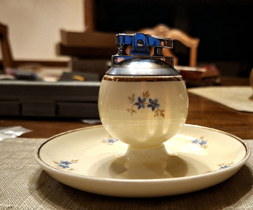

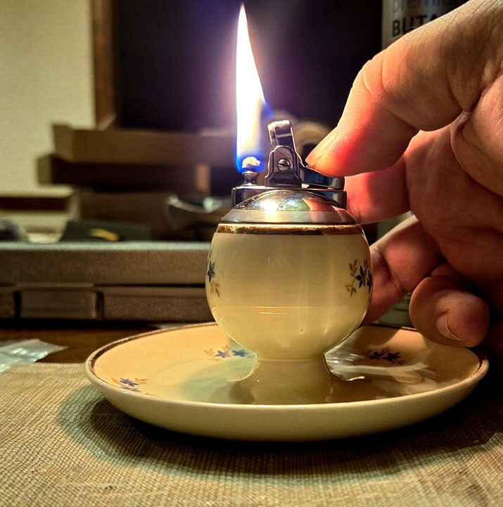

Ronson Duette Tray/Body (1938) with Ronson RonDeLight Lighter Insert (1932)
I had an opportunity to get one of the most rare Ronson lighter bodies ever made (mostly because it's part of the fragile ceramic saucer itself, not a separate piece. It doesn't have the correct RonDeLight insert (it had vertical metal slats on top), but oddly the insert is technically older than the body, which is from an early 1930s RonDeLight insert. Combined, it's probably worth $1000. With the non-matching insert, who knows. I got it dirt cheap by comparison (the insert with its own body typically sells for $150-500). In any case, it still looks beautiful combined.

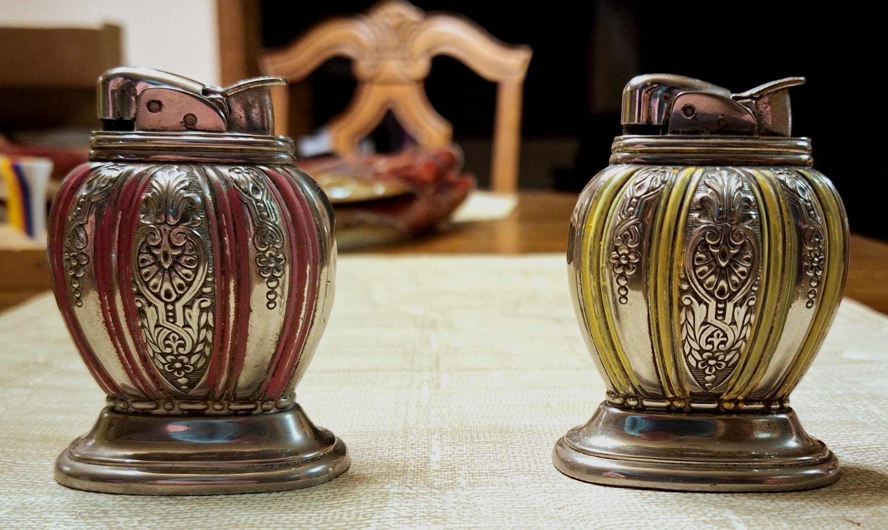

Evans Windsor lighters (1947)
I posted one earlier in the thread. These are modified to have painted stripes (A family member wanted one like mine I put removable gold stripes on with a marker board gold marker, but they wanted more permanent stripes so I bought a pair and made one with a paint marker to look similar to mine and tried a different color for the other one). They're both fully functional.
I also discovered while checking the year that the above lighter called "The Poacher" (that looks like Dean Martin) actually came with an Evans wick lighter originally.

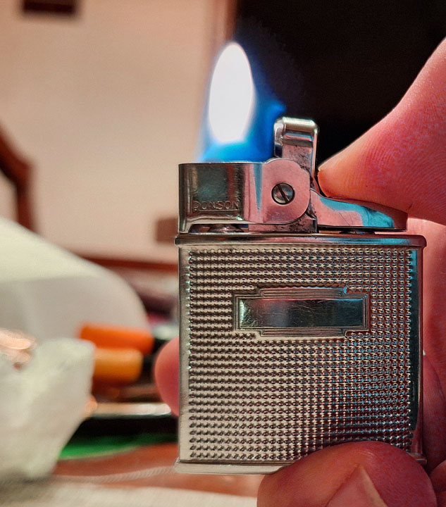

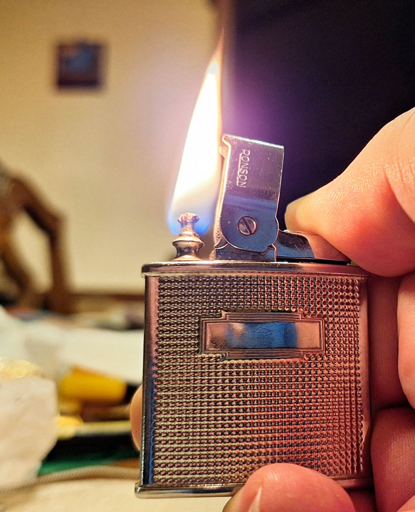

Ronson Cadet Pocket Lighter with Windshield (1959)
The Cadet series were all made by Ronson's England Division in the British Aisles. Previously shown was the Cadet Adonis and Cadet Adonis Table Lighter. This is the regular Cadet from 1959. It featured a couple of slight variants including one with a windshield attached (shown here) for outdoor use.
