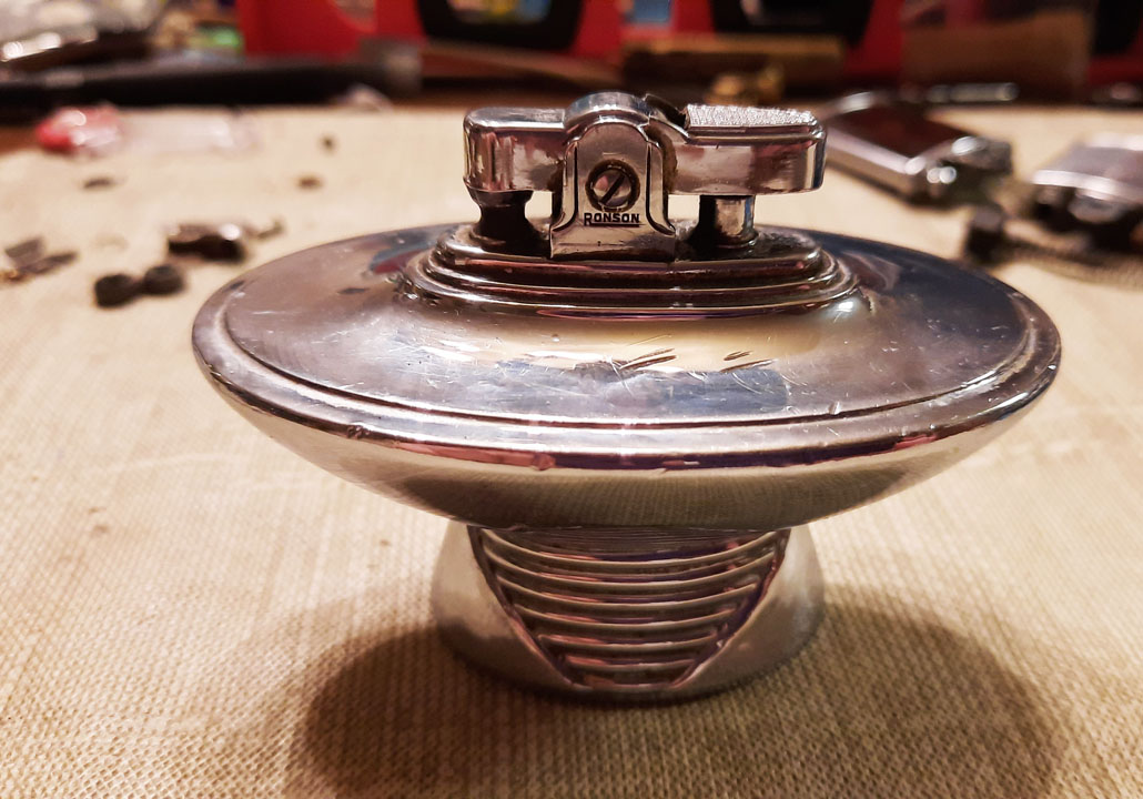

Ronson Tempo #2. I guess I missed the two gouges on the top seeing it only had 3 photos and the gouges were on the far side looking back almost invisible from that angle. This is why one shouldn't trust eBay sales with 1 or 2 photos, particularly when they're blurry. Look how well I hid them with sharp photos (middle top facing left).
Otherwise, it looks pretty good. It was full of those "seeds" again. I don't know WTF those are, but that's 4 lighters now that have been full of them!!! WTF!?!? So I installed a new wick and cotton and cleared the flint and yay, it works fine now.
The light scratches came out with a bit more polishing. Nothing I can do about the two little gouges (at least the chrome didn't come off).

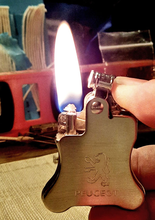

I picked up this one from FedEx on the way to work. No lighter fluid to test at the moment, but it sparks extremely well.

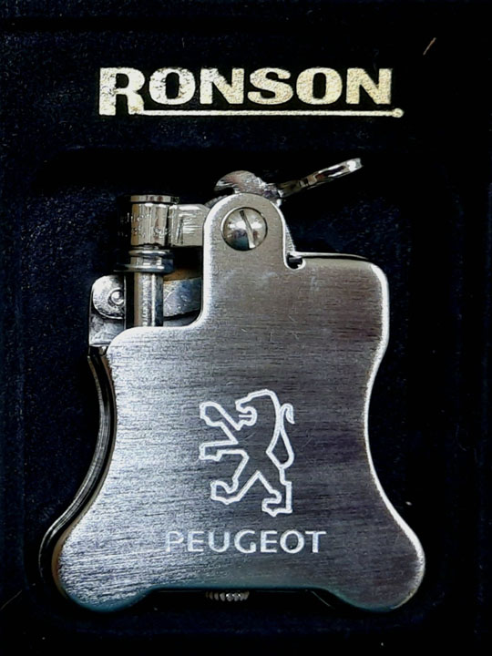

It's a Ronson Banjo pocket lighter, which was Ronson's first "automatic" pocket lighter, partly patented in 1917, but not manufactured until 1927.
This is a modern reproduction made in Japan by Ronson (there were some reproductions made in the 1980s as well). The originals tend to sell for $300-600 in fair to good condition and rarely shows up in excellent condition. These sell for $70-300 depending on the seller and age (1980s closer to $300 and current closer to $70).
There's also a table lighter from 1927 with the banjo mechanism. I just purchased two vintage models recently at auction (one with the banjo mechanism and one with the De-light mechanism) I'll show later when I get the 2nd one in to compare and get them cleaned up and working.
This one in particular was made with the French Motor company Peugeot's name on the front, which at least makes it slightly more unique than the boring "Ronson Since 1913 New Jersey" logo that's on the rest of the Japanese made lighters.
Peugeot cover slides over Ronson box
Inside box
I'll show a lit photo later when I get some lighter fluid in it....

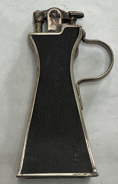

Ronson "Banjo" Table Lighters (1927-1932) (Left with "Banjo" mechanism" and Right with the De-Light mechanism).
This is Ronson's oldest table lighter and one of the first in the world. The "banjo" mechanism (seen above on the newer recreation of the pocket lighter) came first and was replaced by the "De-Light" mechanism approximately two years later. This lighter was available with both mechanisms. Somehow, I managed to acquire both of them within 6 weeks of each other. I still need to figure out why the banjo one isn't working (possibly stuck flint as the de-light one had one and I just got a drill bit that can reach it, but it doesn't fit my drill....yay. I managed to hand turn it through the crumbly one in the de-light lighter. I haven't tried the other one yet). I polished the de-light one a few times. It could still use a bit more cleaning, IMO. I haven't touched the banjo mechanism one yet.

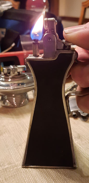

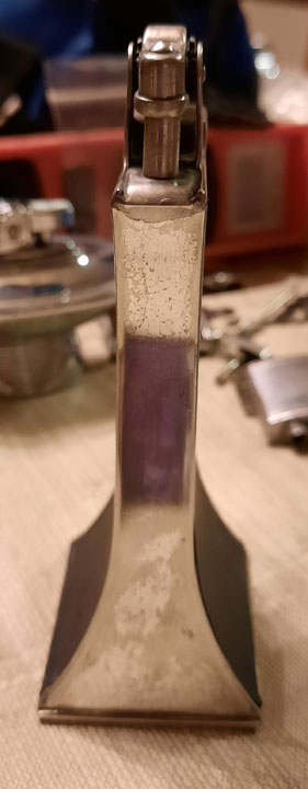

OK, it really was just a stuck flint in the other Banjo table lighter, after all, although the snuffer doesn't raise up as high as I would like. I'm sure there's a way to adjust that somehow.

I guess someone thought Ronson's rather unusual first automatic lighter design resembled a banjo somewhat (based on the pocket version, not the table version, which inherited the same lighter mechanism originally and thus the name, sometimes even when they changed to "de-light" that particular table lighter seems to be called the Banjo table lighter when it's listed for sale).
This looks like a Banjo? Original "Banjo" lighter (patent 1926 and partial patent 1917 and usually listed as first made in 1927) was called an automatic pocket lighter and nicknamed The Banjo. (This is a more recent recreation of the original model, identical except for using 2 screws to hold the snuffer together instead of just one as newer Ronsons all used to more easily take it apart and put back together tight).

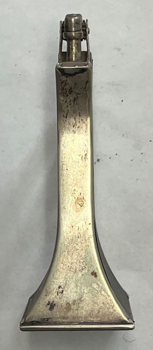

My Handbook of Cigarette Lighters calls it a "Ronson Table Lighter" WITH a Banjo or De-Light mechanism, implying it had no other real name as it was their first table lighter and probably thus retro-called the Banjo to differentiate it the following year in 1928 when the Tabourette table lighter came out. The book I have has it reversed, showing the Tabourette as 1927 and the Table Lighter as 1928, but I think they have it backwards (based on historical online information). The first version of the Tabourette had a similar leather front option and the 2nd version was all chrome with the De-light mechanism still and the 3rd version switched to the "Standard Fitment" (Ronson's 3rd pocket lighter mechanism and the one used until the Adonis in the mid 1930s, which was really only different on the button side, held by either originally a spring loaded onto the base inside (like my "Dark Passage" sterling silver version) and later with a rivet in the back that goes through the spring inside).
The Ronson Tabourette Table Lighter 2nd version (1928?)

Tabourette
Banjo
It seems the Banjo table lighter is worth $175-275. I paid around $175 each while I watched the Maltese Falcon Touch-Tip sell for $910 in not-so-great condition at auction that is supposedly only worth $350-550 in EXCELLENT condition (but in reality goes for $800+ because of the movie and rarity in near-mint condition), but someone paid way too much for that one. I guess they really wanted a Christmas present for someone special?

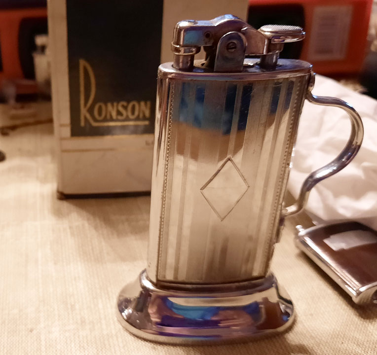

I polished up the Ronson De-Light Banjo Table Lighter with many a Q-Tip using Flitz and silver polish rag. It's about as close to as new as I can get it....
BEFORE:
AFTER:
Ronson Banjo Delight Polish 02.jpg Ronson Banjo Delight Polish 01.jpg Ronson Banjo Delight Polish 03.jpg Ronson Banjo Delight Polish 04.jpg

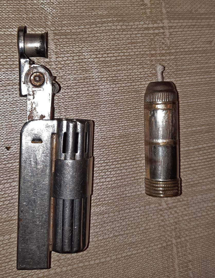

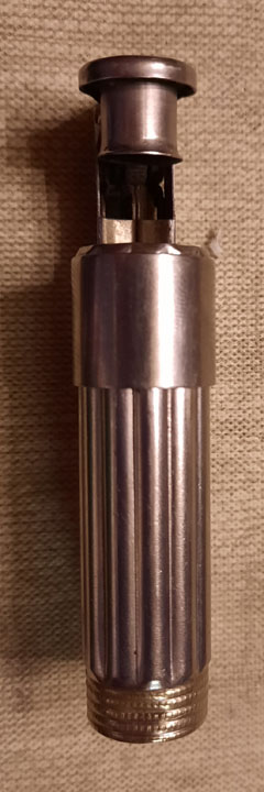

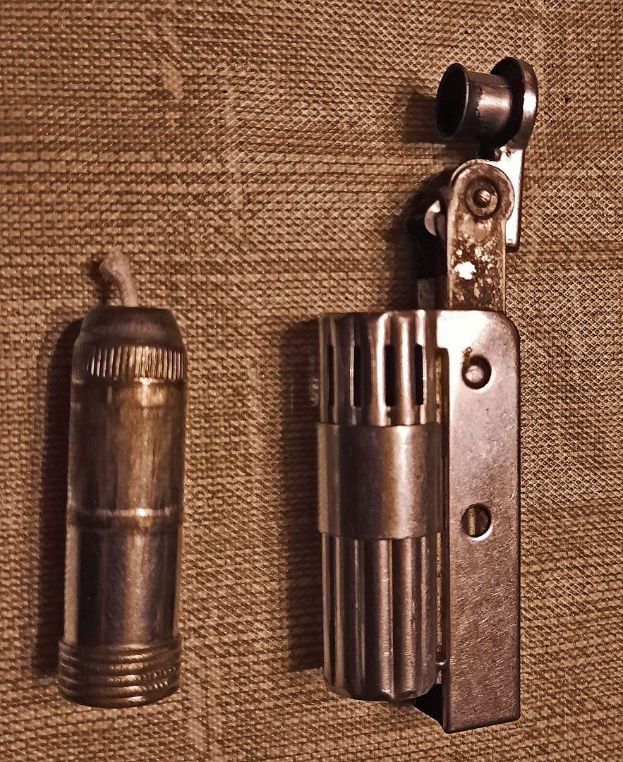

I finally remembered to finish cleaning my IMCO 4700.... Bit of sanding and polishing, especially around the part where it pops up where there was rust/gunk before.
BEFORE:
IMCO 4700 Triplex Back Side Tank Flash.jpg IMCO 4700 Triplex Front Side Tank.jpg
AFTER:
IMCO 4700 Polish 02.jpg IMCO 4700 Polish 01.jpg IMCO 4700 Polish 03.jpg IMCO 4700 Polish 04.jpg

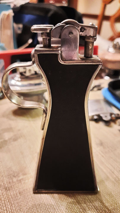

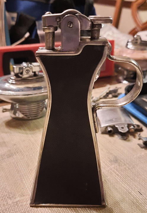

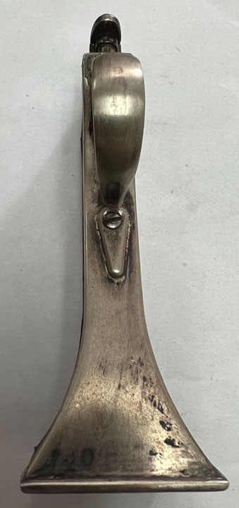

OK, I just couldn't let the 1927 Ronson Banjo Table Lighter go like that. I found a schematic online and figured out a way to adjust the push button lever (and thus the snuffer height) without having to remove the center screw that holds the spark wheel mechanism together (which may or may not be hard to put back together). This was slightly difficult to get the screw back in, but low and behold, the snuffer moves out of the way now! It also lights almost every time now too. I went ahead and did some more polishing and truly get it up to snuff with the other one.
RESTORED LIGHTER
Who doesn't love ostrich leather?
Oh yeah! That's how it should look!
