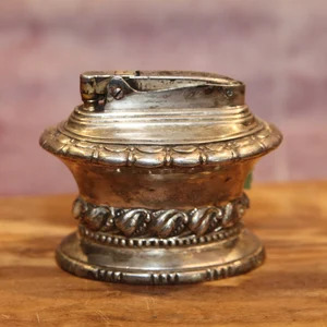

Ronson Waldorf Lighter (1936)
The "Before" photo from the Etsy listing is a bit deceptive about how dirty it actually was except for the top which looks pretty accurate. I'm sure it's the lighting. Heck, now that I took the cleaned photos, it's pretty obvious why small, non detailed or non-sharp photos suck and are deceptive as to quality as the parts where the plating are off really show up in a closeup photo. It doesn't look nearly as bad to the eye as the photos below make it seem, IMO, but it's definitely worn. I've got it sparking finally, but it needs a new wick....
The main visual quality issues are the plating has come off in a few places, especially around the top. The snuffer and handle can be replaced with one from another "Adonis" lighter, but to match it would need to be silver plated, not chrome. I'm also not certain how to get that fulcrum shaft pin out of the back to remove the back handle button. It looks like you could just shove it out, but it doesn't budge. I'm sure there's a trick to it....
Issues:
1> It was dirty as hell. I spent almost two hours just cleaning the outside and while it went from OMG that's dirty to hey, that's pretty sharp looking, it's then I noticed there are some bits here and there where the plating has come off, notably on the bottom lip near where it goes vertical like a line and on parts of the button you press to activate it. But it does look 1000% better now.
2> The stuck flint from hell. This one made that last one I cleared seem like child's play. I just kept digging and digging between manually and a drill and it wasn't like I wasn't making progress, but it just kept going and going. Finally, when it did pop out, half the flint was still intact! That's like a brand new flint that was never used and got stuck. I had to dig through half of it before it let go.... Unbelievable.
3> I put it back together the way I thought it should go and...no spark. I'm going to check the manual again next to see how I managed to screw that up.
4> It looked like it had a wick that was lifting up, but felt kind of crappy. I pulled it up to cut the top off and it just came out. It was at the very bottom and so it needs a new wick and that means pulling freaking cotton out of the bottom of the lighter for god knows how long and trying to get a new wick through it.
5> The fuel door was not super stuck, but stuck enough to still cause consternation. I'm starting to think it wasn't worth it just to get one step closer to my strange "Zork" quest to get a complete Ronson table lighter set (not counting some early "DeLite" artwork sets as there's many and they're rare and mostly expensive, although I did get that New Yorker Baronet set recently. I don't know if I should bother with butane versions of similar lighters (well there's the Queen Anne; I already have the Crown Butane).
I'm worn out for one night. I'm kind of a perfectionist and hate leaving things unfinished, though but it's late and I can't do that wick tonight and I need to remember to stop and buy some lighter fluid on the way back from work tomorrow. I've gone through 2 bottles in the past 6 weeks (table lighters use tons of fluid compared to pocket lighters and I've added so many table lighters in the past couple of months).
"Before Photo" from Etsy:
"After Photo" of Waldorf

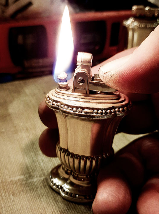

I give you the Ronson Waldorf lighter (1936) cleaned up and restored to working order with hard flint removed, spark wheel sharpened and new wick and packing installed. It lights 10/10 times.

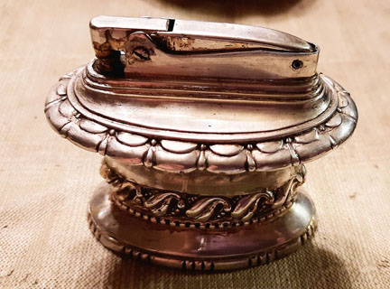

The Ronson Newport table lighter (1947). I'm not sure if the plating is starting to come up after trying my silver polishing cloth on it or it had a clear coat or what. It's not in perfect condition, but for the price I paid, not bad. It's slightly taller than the Mayfair lighter, but still pretty small.

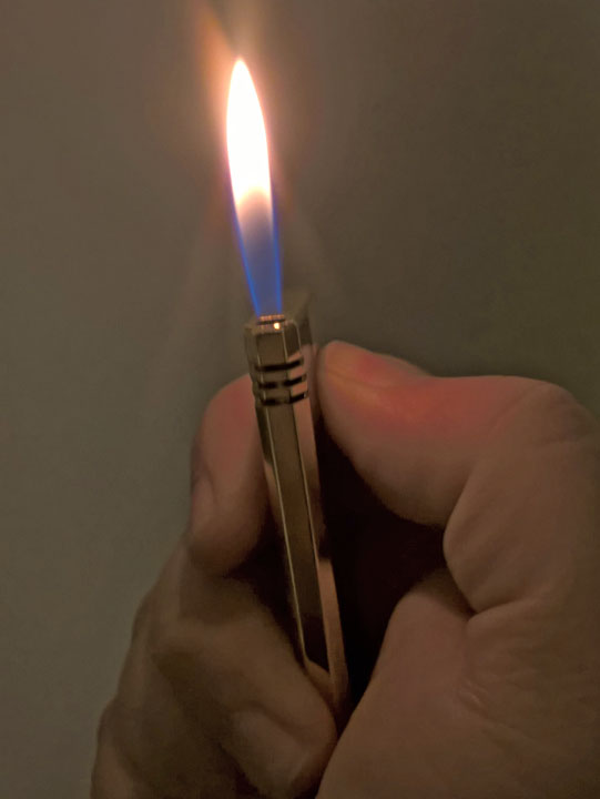

Some real fancy lighters for sure.:cool::cool: The only one I have is a woman's slim, stainless steel lighter. No brand, flint is gone (no wick, just an opening for the flame near a little wheel striking the flint) 3" long, 1/2" wide and 3/8" thick.

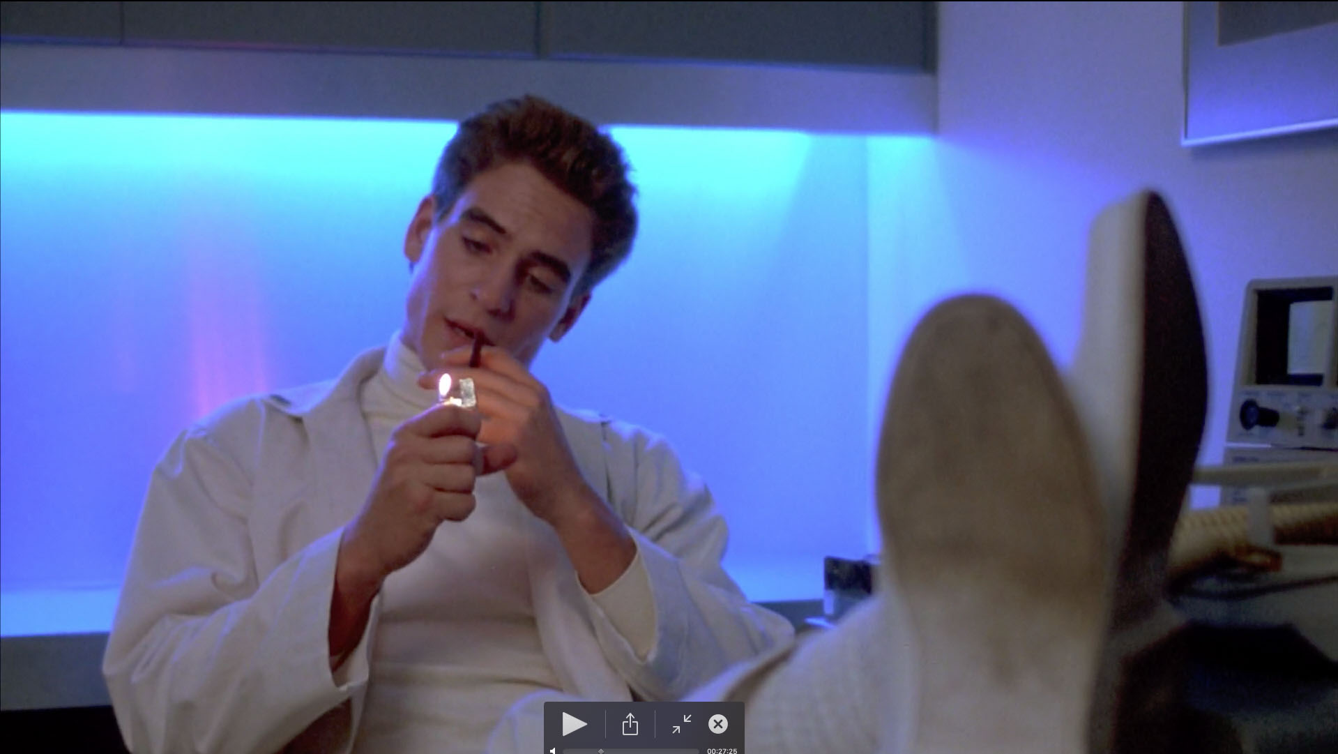

I was watching The Running Man (1987) and I noticed two lighters in it. The first one is hard to tell because it's from the side. It reminds me of a WIN lighter I have from that profile, except the igniter is clearly on the side, not the front. It may be a Colibri model. They had so many Quartz ignition models, many still made in the 1980s like that one in Blade Runner that's so hard to find.

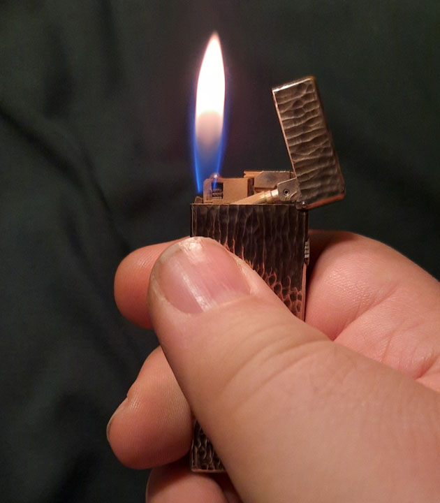

My Dunhill Rollagas Lighter with Silver Bark Pattern

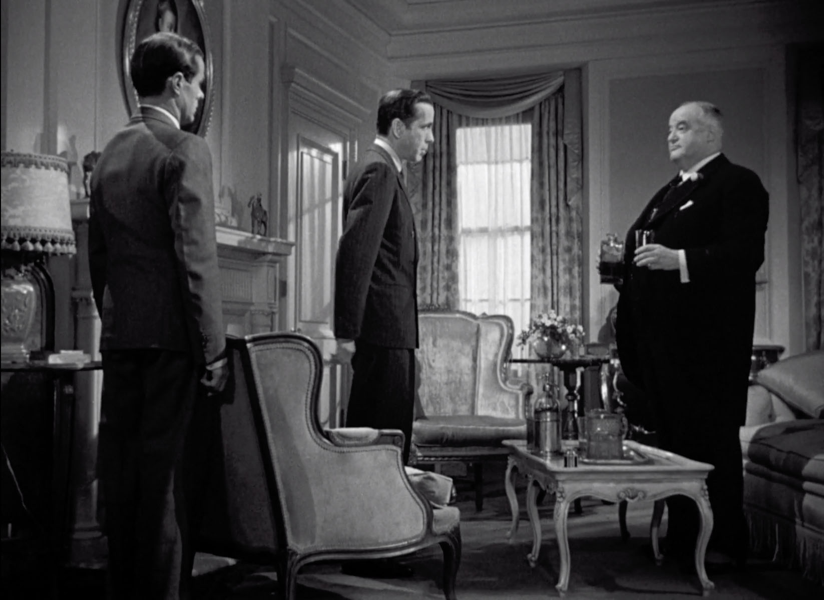

The Maltese Falcon Gutman Lighter (also seen with Bogart using it in Bullets & or Ballots). It's a 1929 Ronson New Yorker Lighter part of the Ronson Baronet Set. The one I received today looks to be in pretty decent shape for 93 years old, but the first thing I have to do is figure out how to remove the lighter from the tray. It's mounted pretty solid on there at the moment. I don't know if paint could be stuck or it slides onto a groove holder or what.
The Gutman Lighter
In Scenes from The Maltese Falcon:
