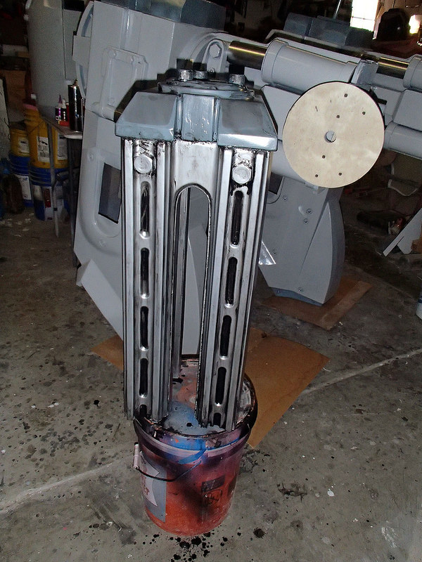

I've started assembling the legs. This time around I'm making the frame from wood:
I think it'll work:

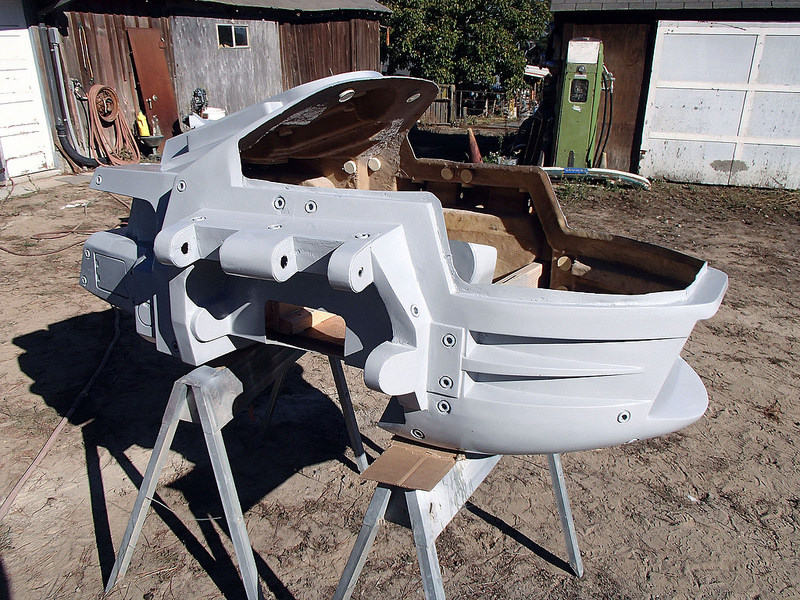

2nd ED is still moving right along. The frame will be wood this time around. It'll be a little bit heavier than the steel frame, but I'm expecting it to be stronger and stiffer:
It'll still look just the same on the outside:

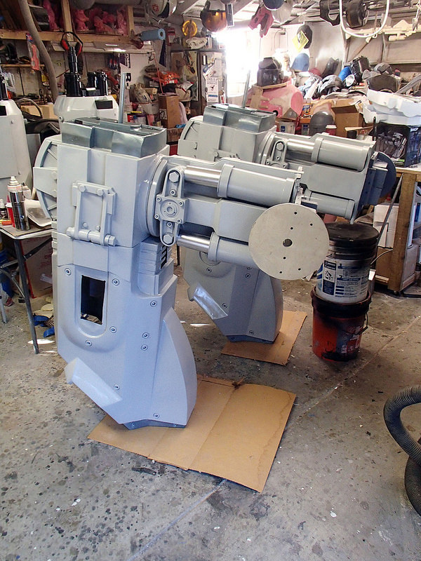

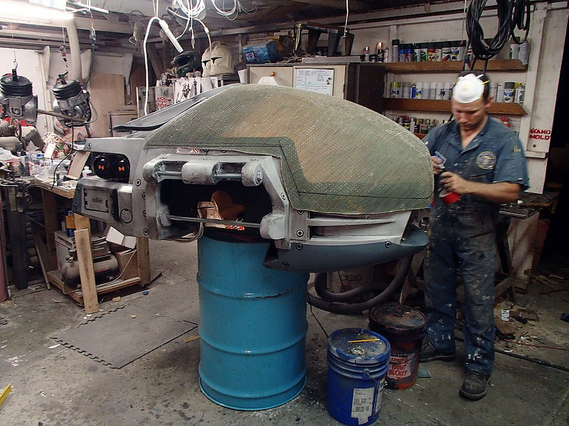

I have to apologize for the lack of posts lately. The last week has been overwhelmed by getting the second one of these guys wrapped up. At the end of my last update, I had a bunch of parts in primer. The next morning, I sprayed on the base color:

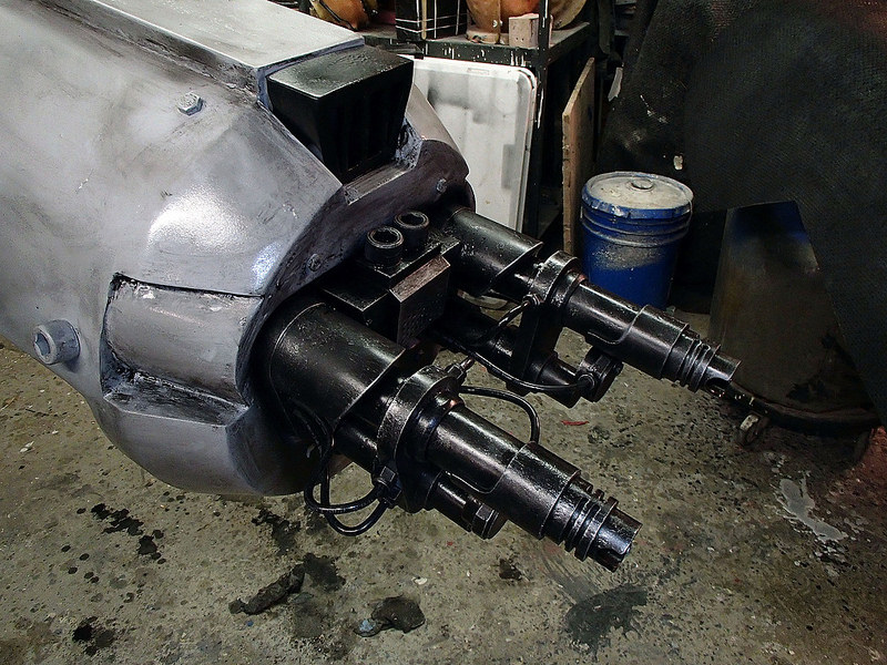

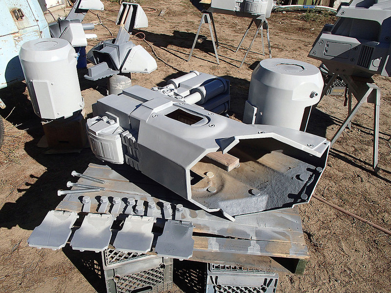

The grey was an industrial urethane finish from a company whose name I can't recall. The color itself was called, "grey" which is perfect:
Once it was set up enough to handle, I brought the parts inside and stared adding on the details:
I also had to pick out some of the other colors:

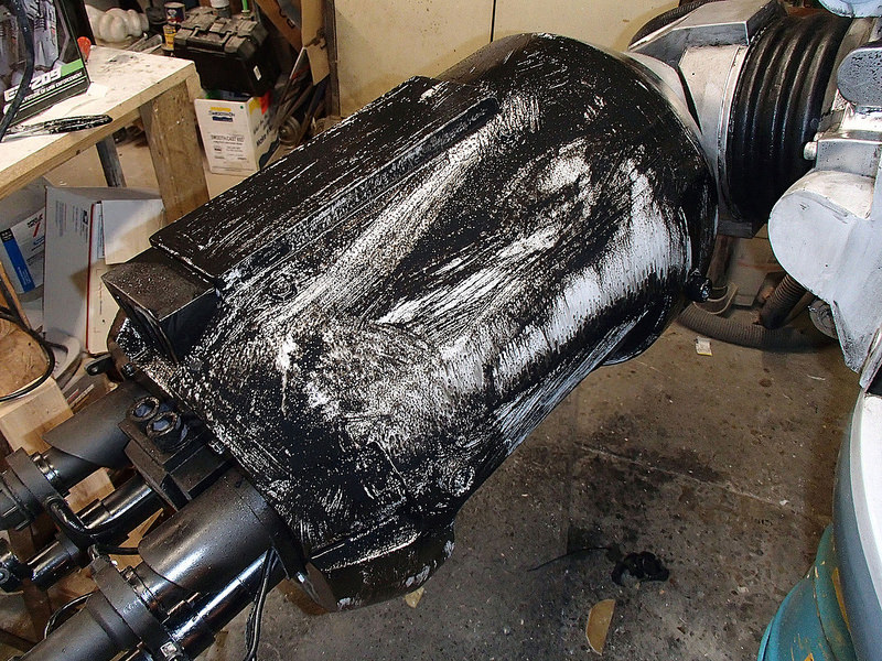

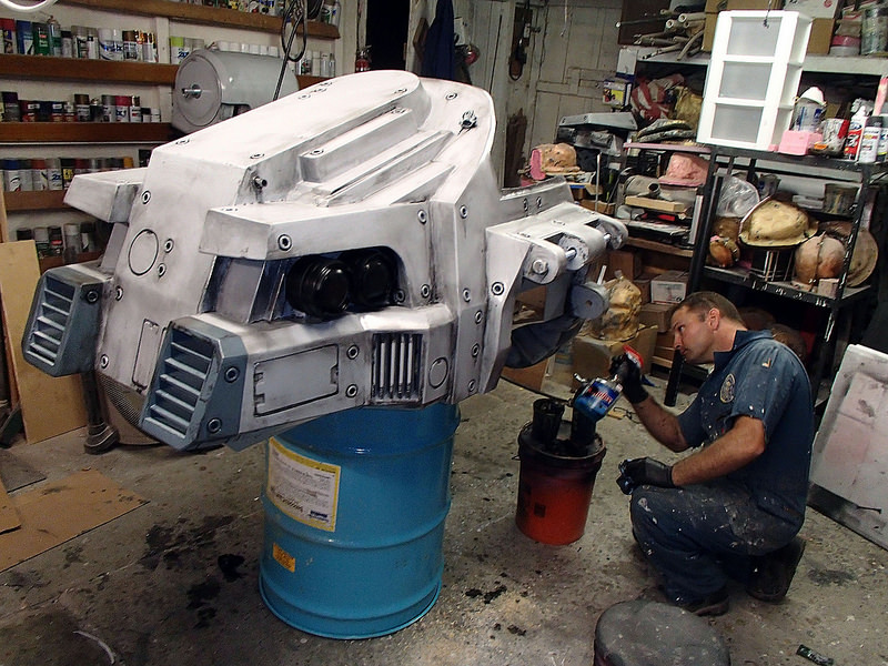

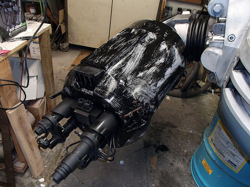

Like the first one, the bulk of the weathering was just a heavy blackwash:
Here's a quick overview of the blackwashing method I use. I start with a heavy coat of barely watered-down acrylic paint:
Since it has a tendency to bead up on the surface of the painted parts, I spray the whole thing liberally with Windex or isopropyl alcohol to break the surface tension:
Then, while everything is still very wet, I'll go back over it with sponges and rags, blotting and wiping and smearing and getting most of it back off:
A little drybrushing on the "metal" parts and it's all good to go:

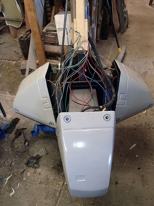

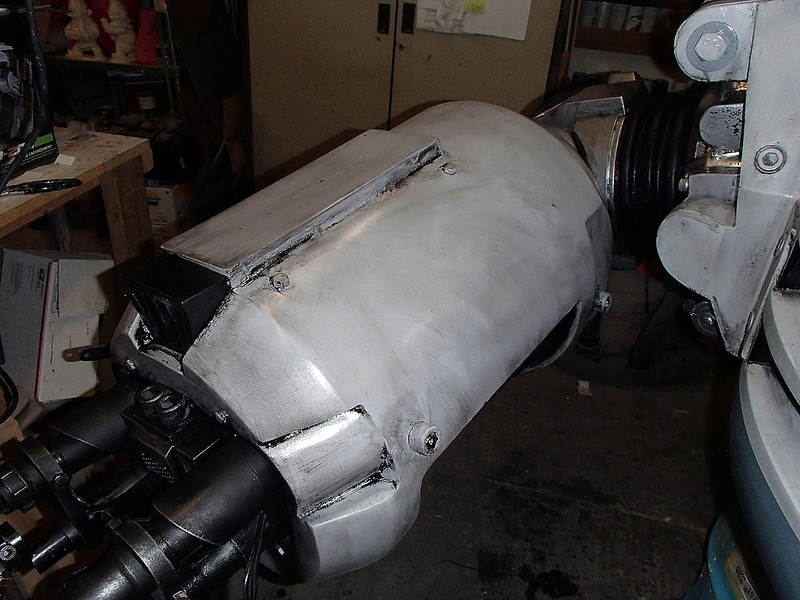

The very last thing to do was to trim the dome to the correct size and shape. In order to find the edges of the opening in the body, I set a worklight inside:
Once we had a good set of lines to work off of, it was just a matter of cutting, painting, and adding some rubber door edge trim.

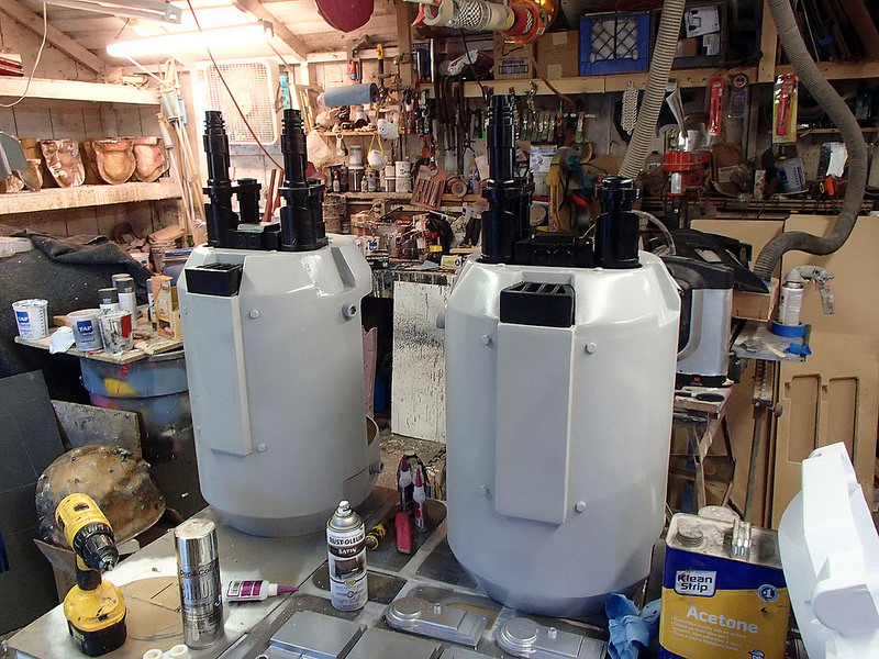

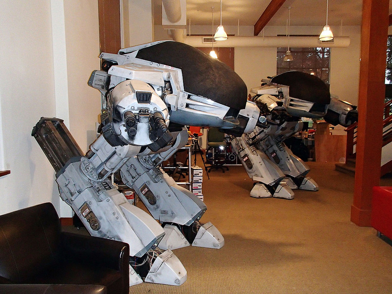

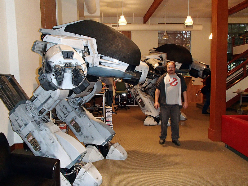

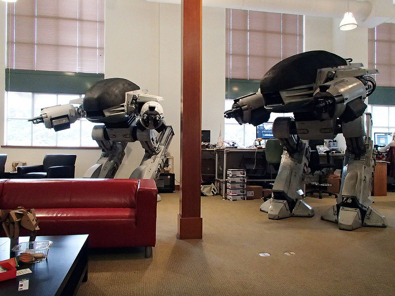

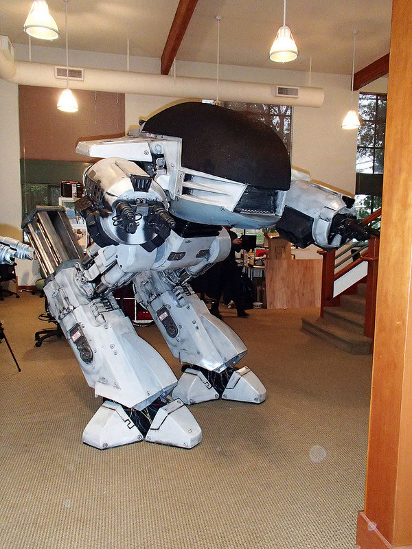

After the paint had dried and the dust had settled, my friend Matt and I loaded everything into a utility trailer and took 2nd ED to meet his twin brother down at the Make Magazine headquarters. Here's the two of them side-by-side:
The new guy is pretty sexy:
Here's Matt standing in between them for scale:

Have you calculated the total weight on both EDs? What is the weight difference steel vs wood? Looks incredible!
Very, very cool. Thanks for documenting your processes, it's been fantastic watching this come together.
crazy crazy CRAZY! I would be freaked the hell out if i didn't know beforehand and walked in to see two giant ED-209s pointing those guns at me. Fantastic work man. Really awesome!
Awesome to see the final finishing touches and some of the before stages this time round. Thanks for showing us!
