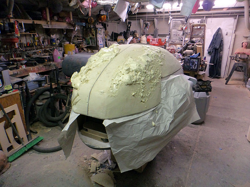

Here's the main body as of yesterday:
I think it's going to work:
