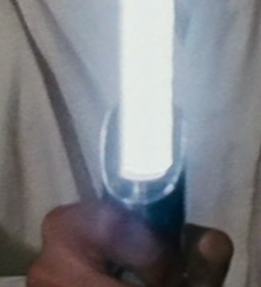

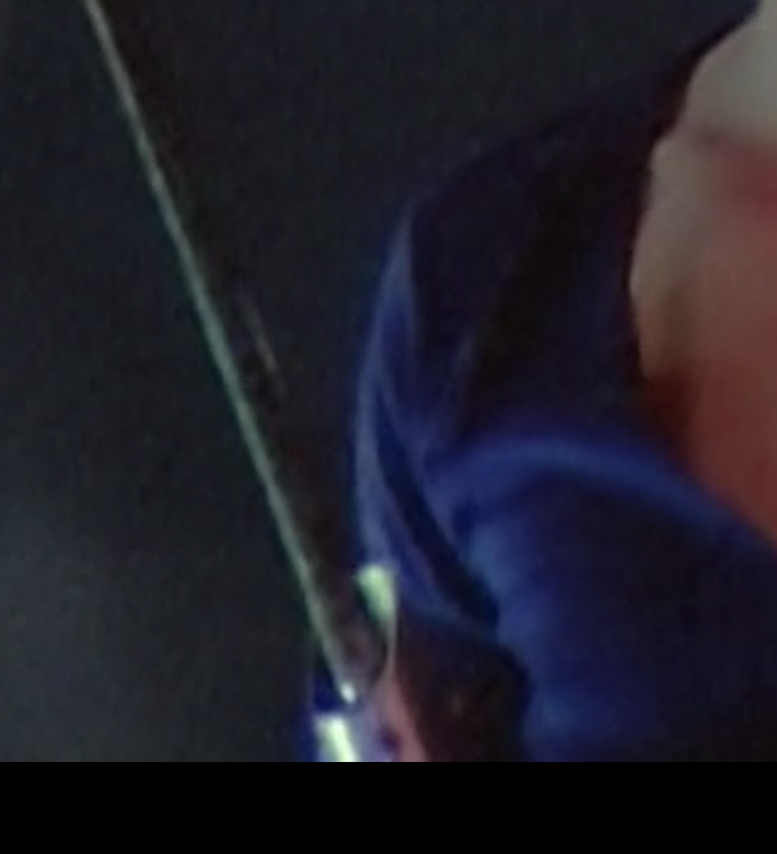

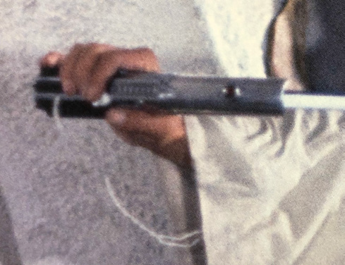

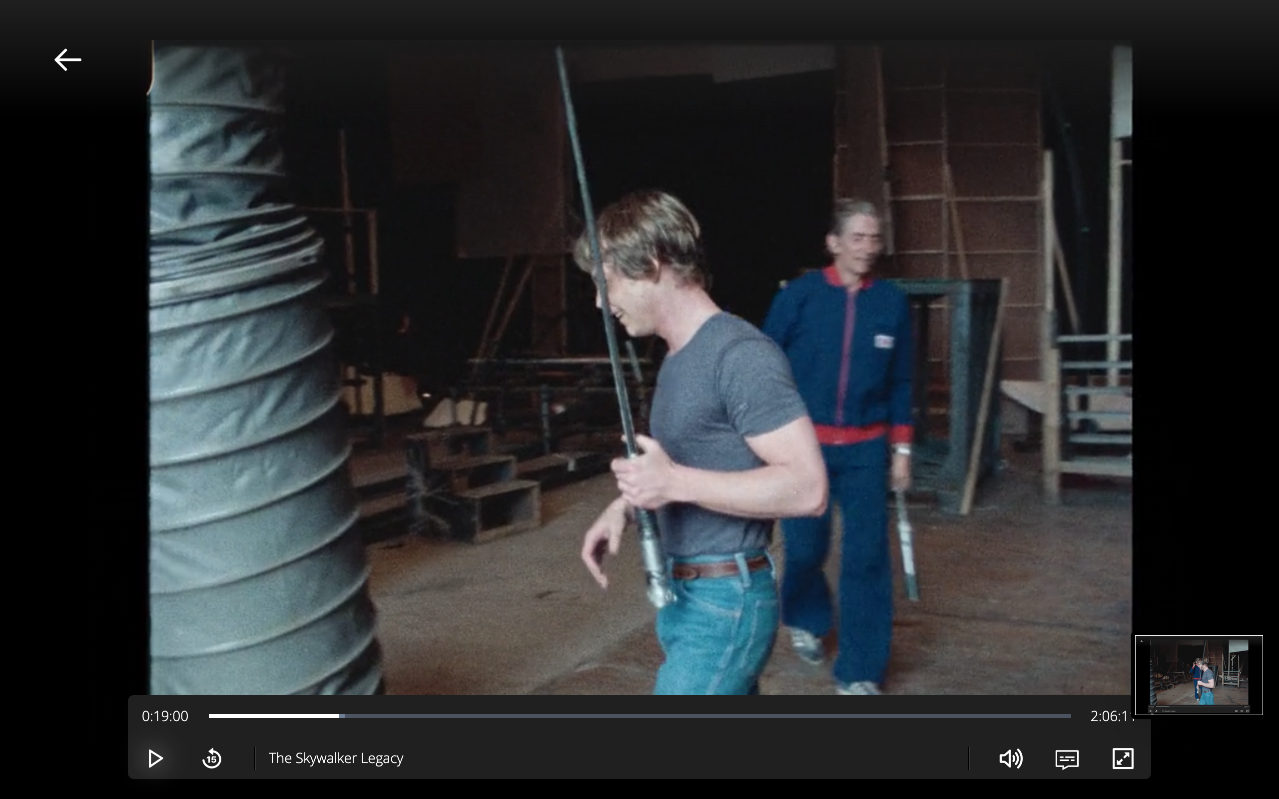

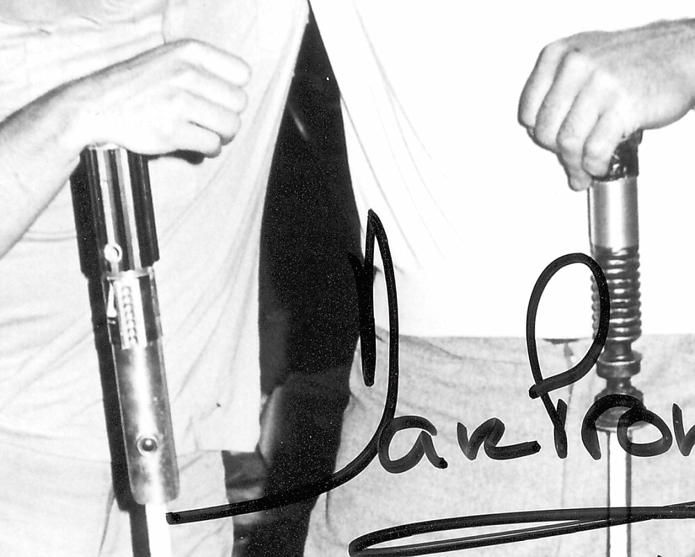

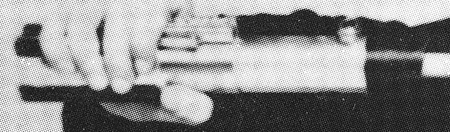

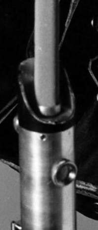

1) Warehouse saber - ANH stunt with push button, thin knurl red button, plugged wire hole. I'm pretty sure this is the Luke/Vader shared one, you can see the set screw hole pretty clearly in one of these images. Also noticed it matches the falcon scene in placement.
(Sometime between the first image and the rest, the lamp button was removed)

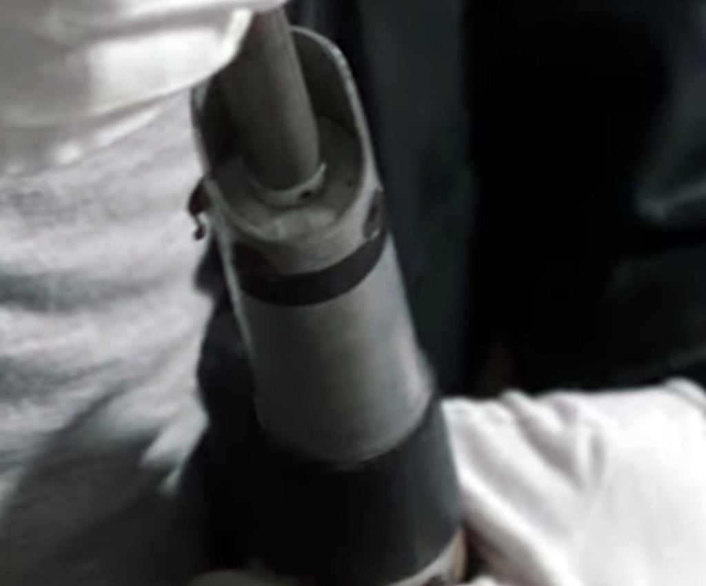

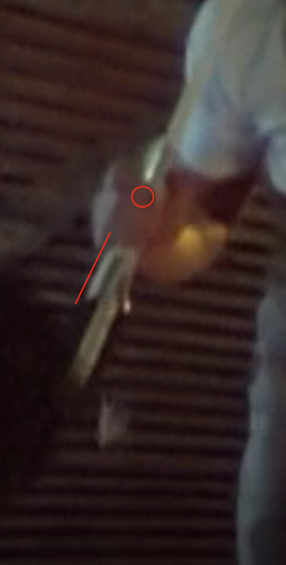

2) "Blue shirt Walkthrough" is what I'm going to call this - Red button, no bolts, normal grips. Slight shadow discrepancy on the 2nd image looks like it could be the set screw in the same spot on the warehouse/ANH saber, maybe. I'm not completely sold on the S-Curve either.
2.5) However, it does look like it has bolts on the first image here but not the second. So it's still up in the air. (Where are these 2 images from, some BTS footage, right?)

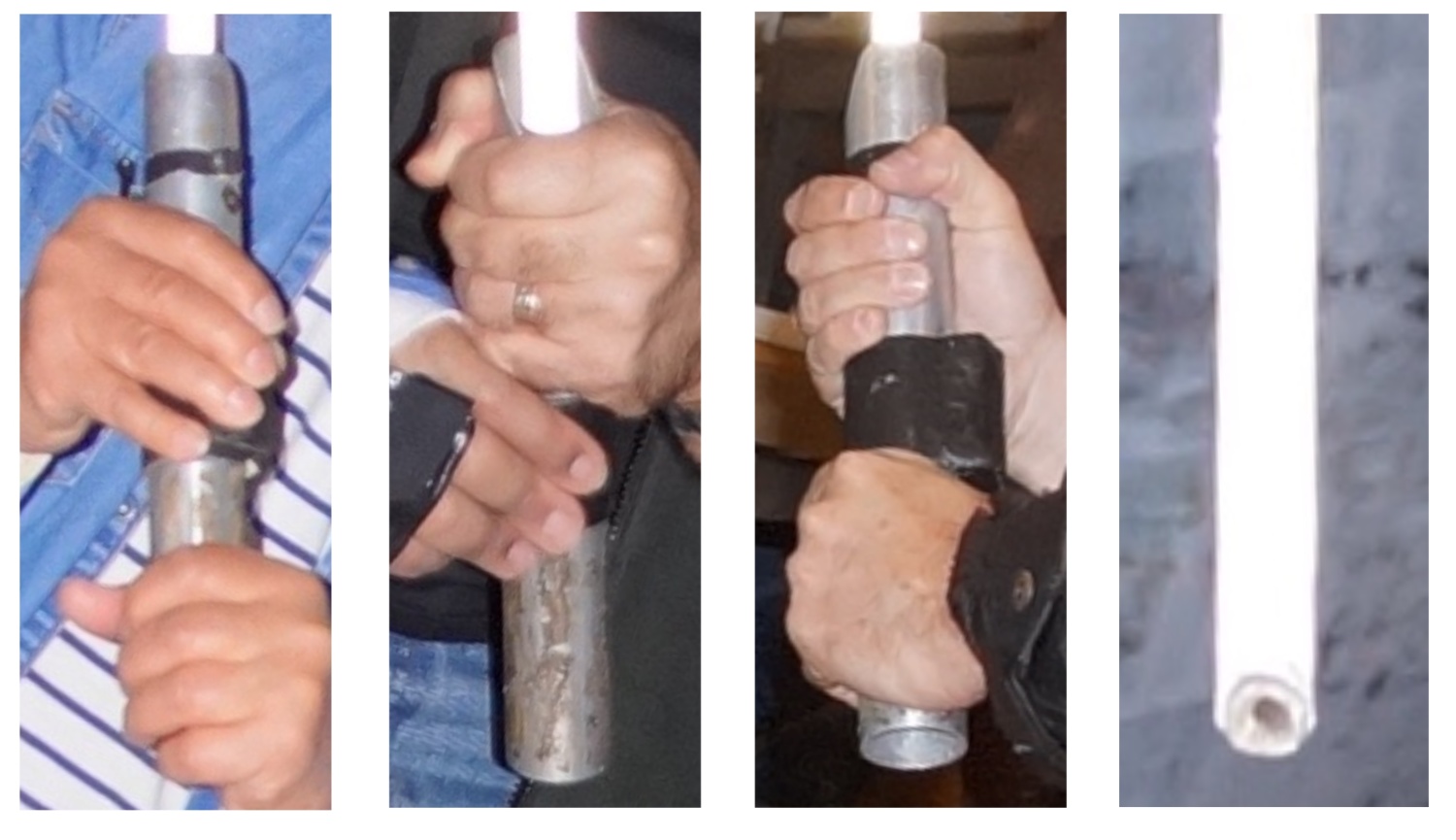

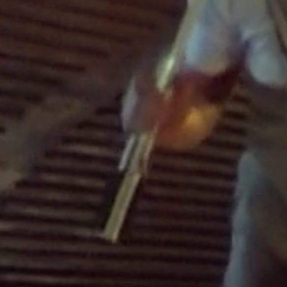

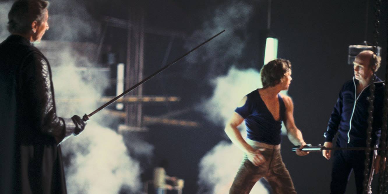

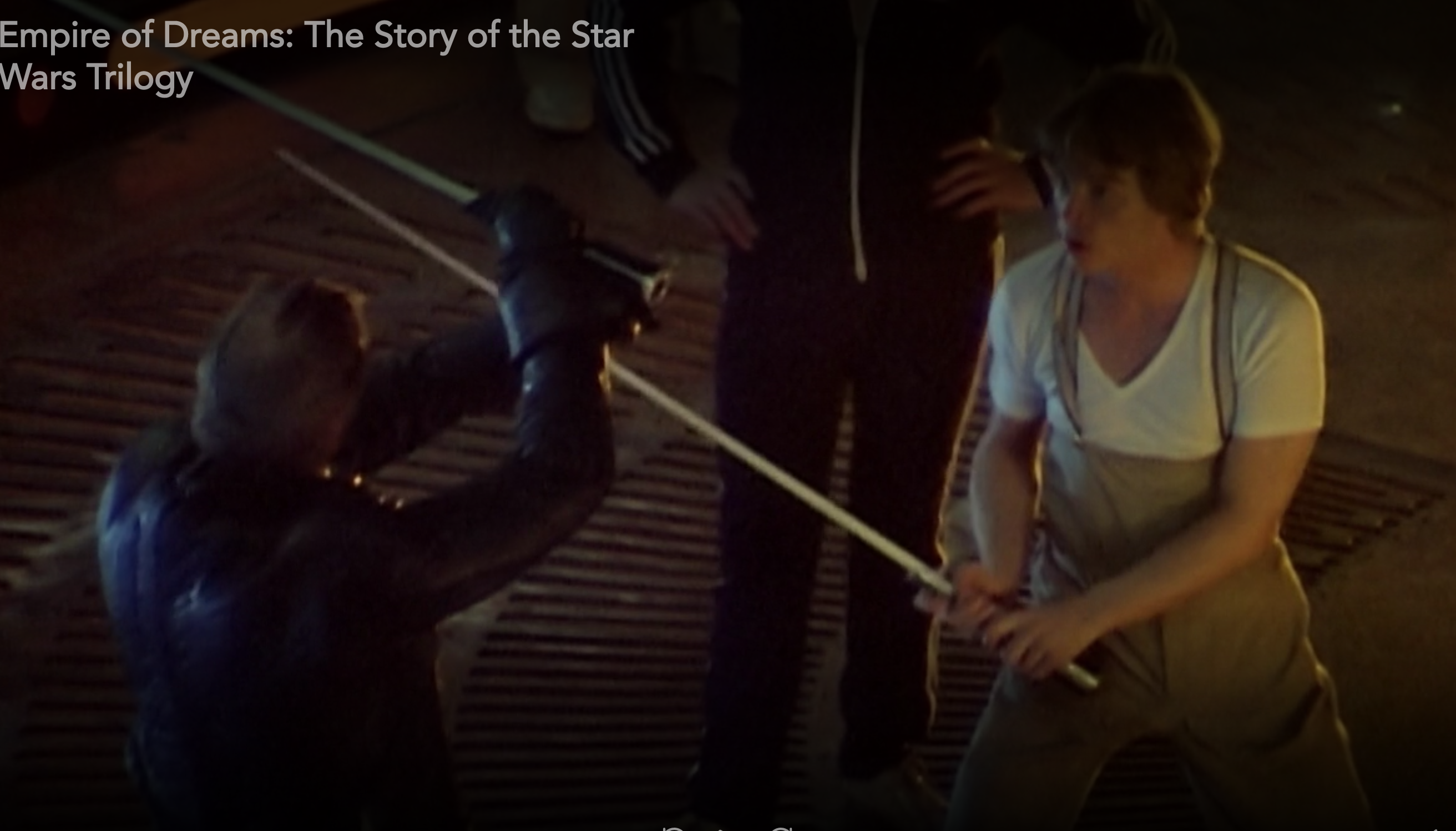

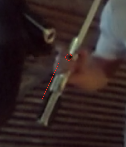

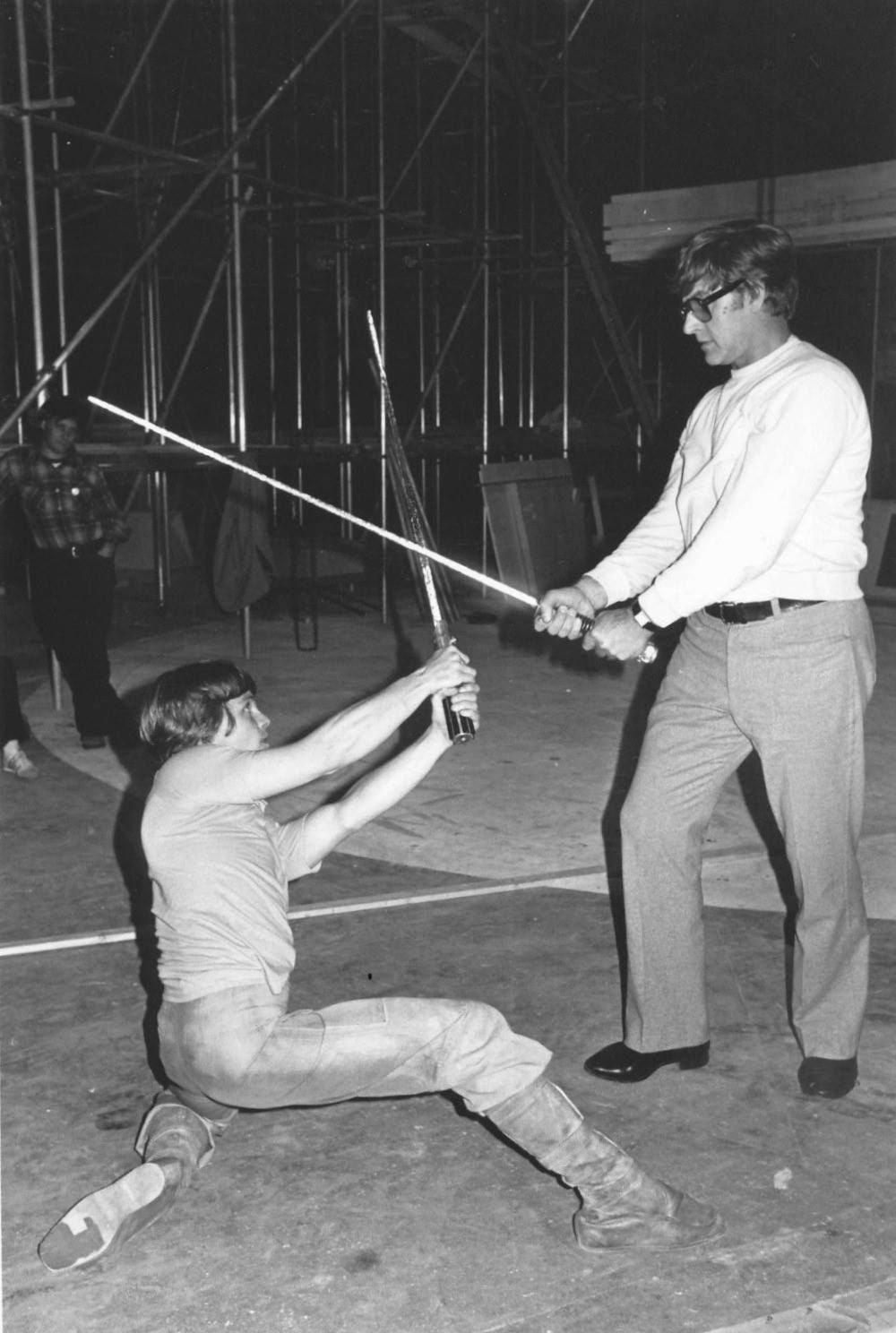

3) Dress rehearsal for filming the carbon-chamber duel - Long lever, no red button, foam grips, and what appears to be a wire hole
(I found a higher res version of this! Definitely looks like a hole.)

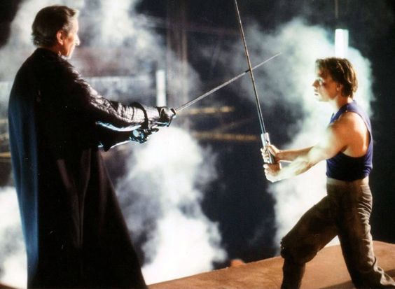

*These stunts don't appear to be used when the actually filmed the duel in full costume - none of the BTS pics with Hamill and Anderson in full attire in the carbon chamber scenes look to be pipe stunts. All of them look to be bolted Graflexes
I think #2 re-appears on the catwalk here... I don't see any bolts on this one still.

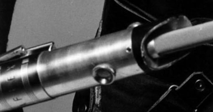

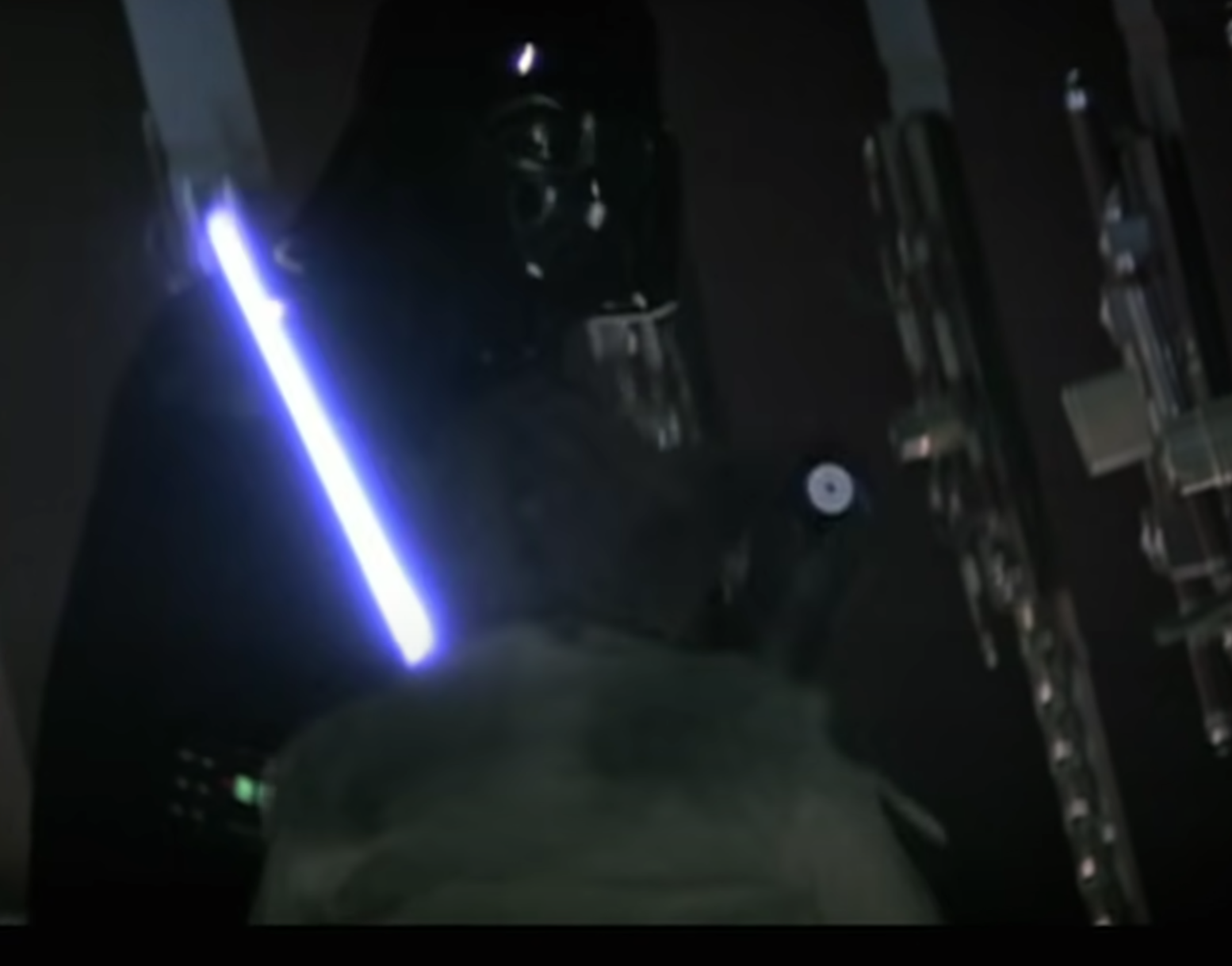

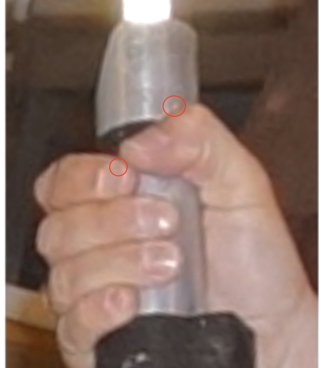

Wanted to point out this black bolt first, on the left of the hilt.

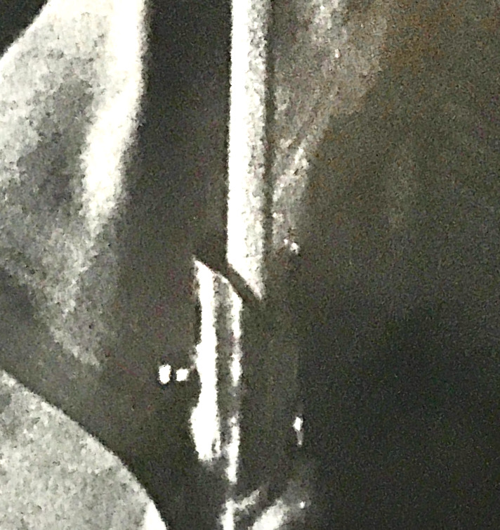

Now, They also screwed up the placement of the front bolts on the "pipe", this shot from kurtyboy shows the left with the arrow is higher than the right. Check out the space available under cut emitter. I copied this on my hilt
And, this saber has the same pattern

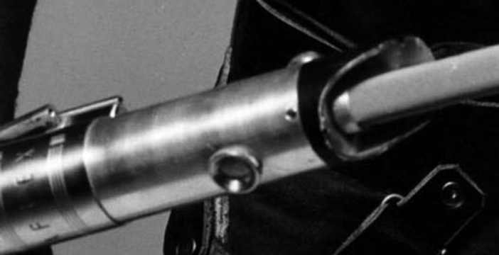

Weird... also, the bolts on the back of the current pipe stunt are so low you wouldn't see them in this shot. They sit below the tape line which is below the "red button" area too

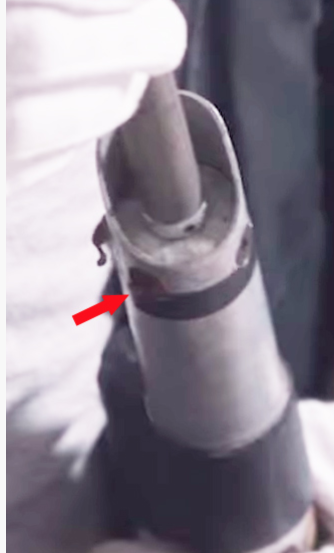

Also, I'm of the opinion now, this is NOT a bolt - but a hole. way too big for a bolt. I think this was where the red button was on ... the ANH Motorized stunt.
The newer pipe stunt only has a threaded hole here, so maybe the current pipe got it's start in empire

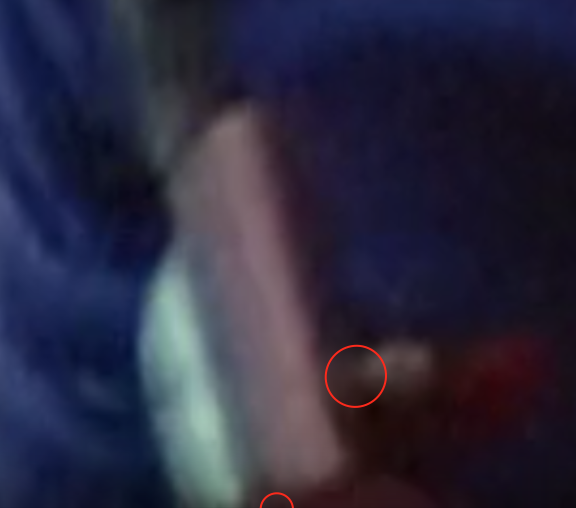

Ok - I'm seeing the bolts now! What I thought was the grub screw could very well be a bolt. A grub screw probably wouldn't show up on a photo like this as well. So the blue shirt one could is probably the best candidate for the pipe stunt.
The long lever one - that could be a hole. Does anyone have any pics of the hut saber on the lever side?
This is the only photo I've got and Luke's finger is in the way...
Being in Tunisia, there's a chance the long lever Jawa clamp could've ended up on it?

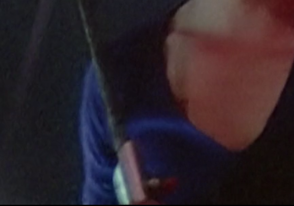

I don't think this is the red button. If you look at the 'emitter' area there is uneven amounts of blade showing indicating that we are seeing some the 'scalop' here & that this black bit is off the dorsal center line by 20-30deg.
This something I noticed some time ago & leads me to believe this is the 'other' ANH motorised graffy. Wherever you can find shots of the silver nose one the clamp 'Graflex' name stamp faces the other way to this one. In just about every shot I can remember seeing of any graflex clamp stamp - it's reads the other way to this one. To get a clamp to reverse/invert the name you have to take it apart & swap the clamp bars over. To do this on a completed motorised stunt you not only have to swap the bars over but slide the clamp off & turn it round. This cant be done rearwards as the grips are in the way. When I assemble mine sliding the clamp on (from the rear before fixing the grips) it scratched the finish lengthwise, so sliding off forwards would scratch the front of the tube finish. It's feasible this isn't good enough resolution to show up in this photo. Lastly there is nothing that warrants removing the clamp or grips to disassemble the internals of this saber. I'd say the balance of probability is this is one of 2 motorised stunts.
Lastly - missing grip. I don't know about you guys but on my motorised stunt, when swinging it about, that particular grip is under a lot of lateral force & was the 1st to come off when using it. My point being this isn't strong evidence for same saber as grips in that area on any saber are more likely to detach.

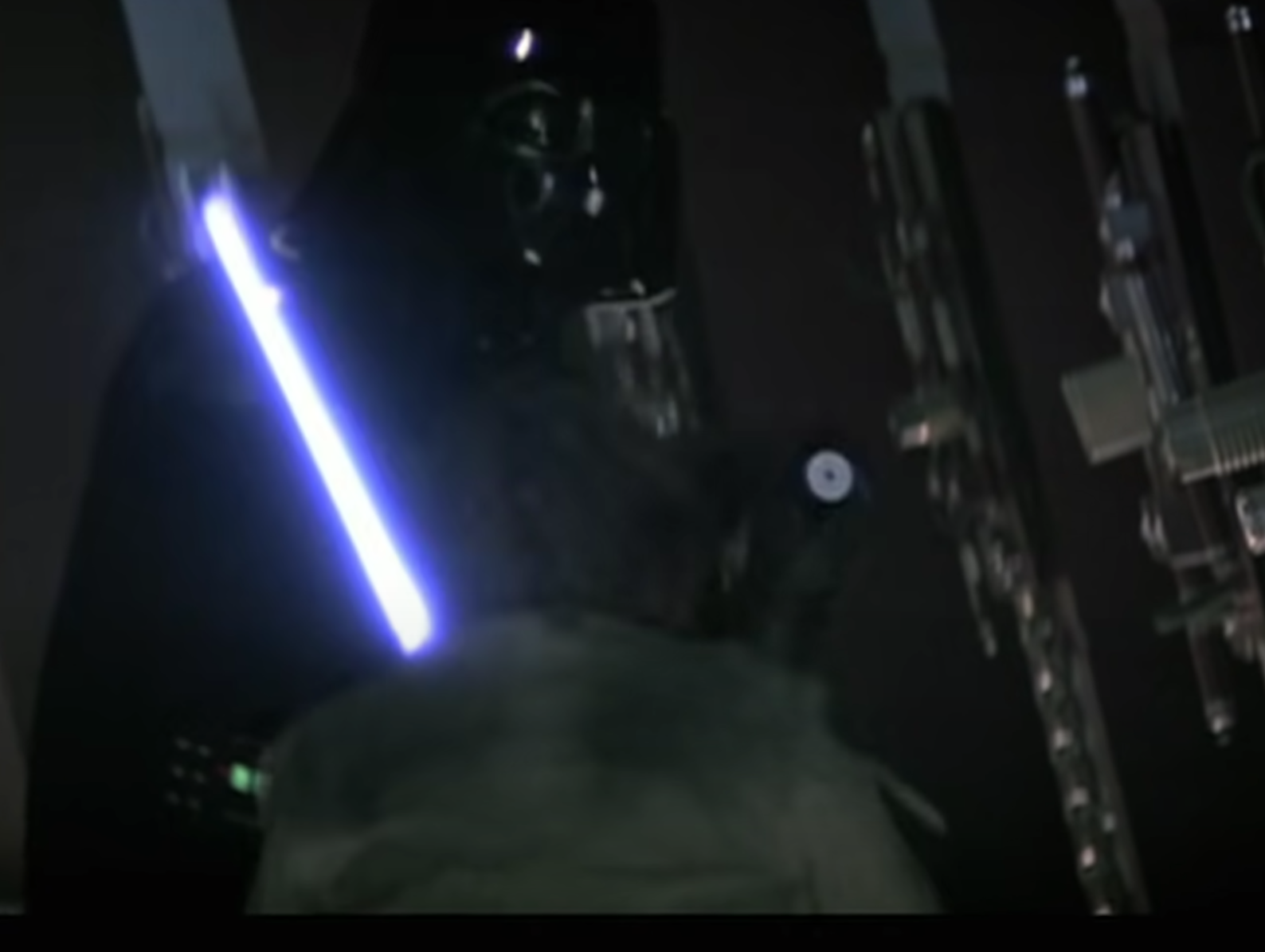

Vader uses a Gx Stunt many times in ESB. Meaning it has a black top. Also it has the 1/4" jack hole in the endcap, so an ANH era stunt.
