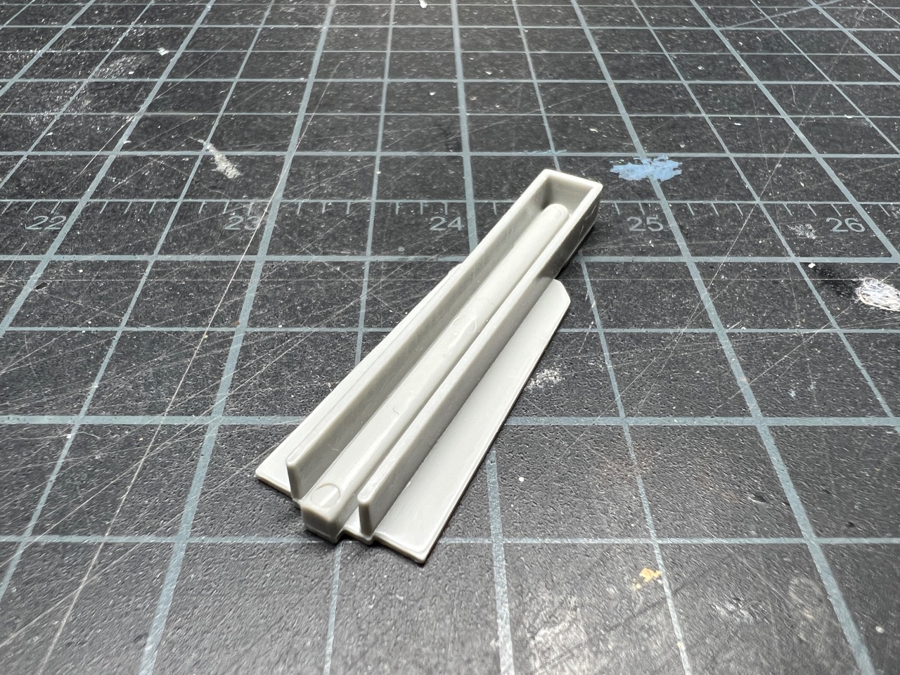

This is one of those parts that come from a $150.00 kit and you need two. I was crazy lucky and was able to get one at a swap at a swap meet for $50.00. (See exhibit A below)
With that said, this was my motivation to learn how to cast resin parts so I did.
(Text and photos unavailable)

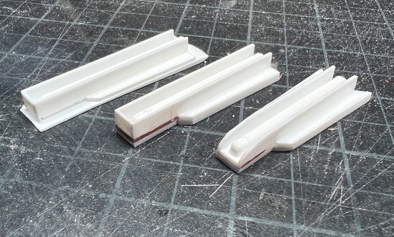

With the original in a safe undisclosed location I began by gluing the part to a piece of 2mm(?) styrene. You have to build up the underside so that you can sand it back to match the curve of the body tubes.
I trimmed back the excess with a knife before doing the shaping with a sanding stick. When I was building scale armor models I rarely used a grit below 400. The thought of using 100 was mortifying and unheard of. Now I rarely venture above 400. Hey, I ain't got all day.
There were a couple of voids that needed to be addressed and they were with some Bondo. A little more sanding, a little shaping and a little clean up and I had some good results.

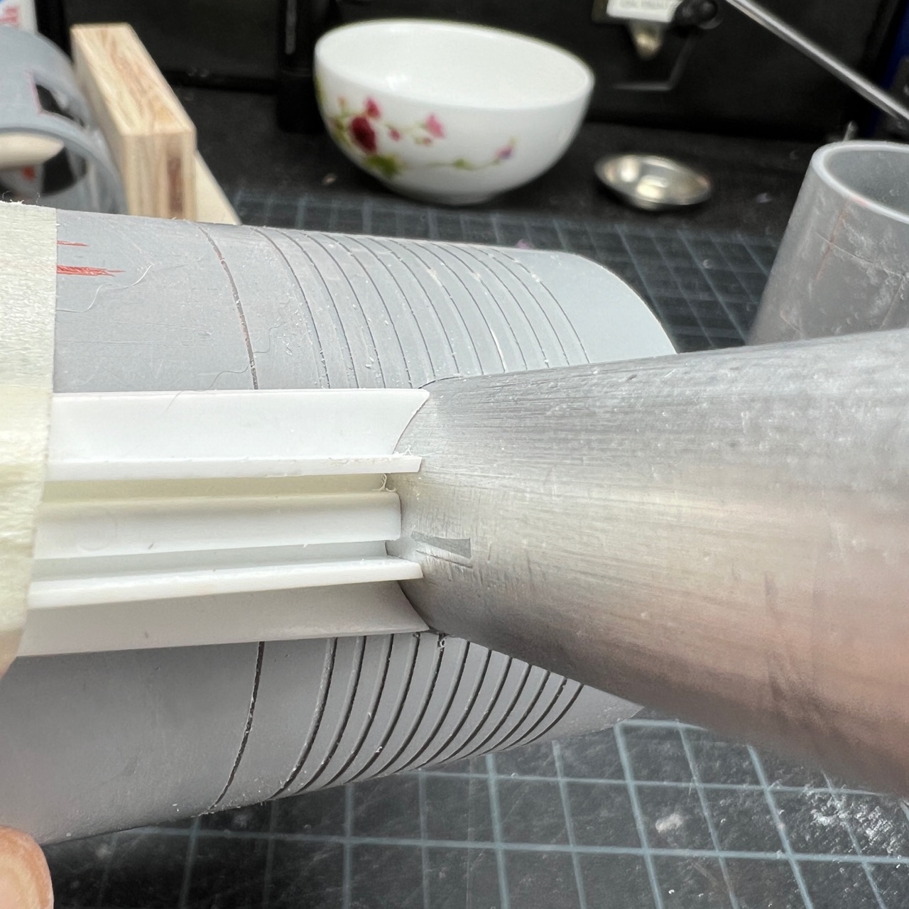

By wrapping a piece of sandpaper around the tube I used the armature itself as a guide ensuring a perfect-ish fit.
It was time to bring the MVP into the game once again, this time by wrapping it in sandpaper and using it for a guide. For those interested, I used 150 grit for these parts
This took some work but I was very pleased with the results.

Looking at the parts map over at X2creativos what are the other details on the side view of this part?

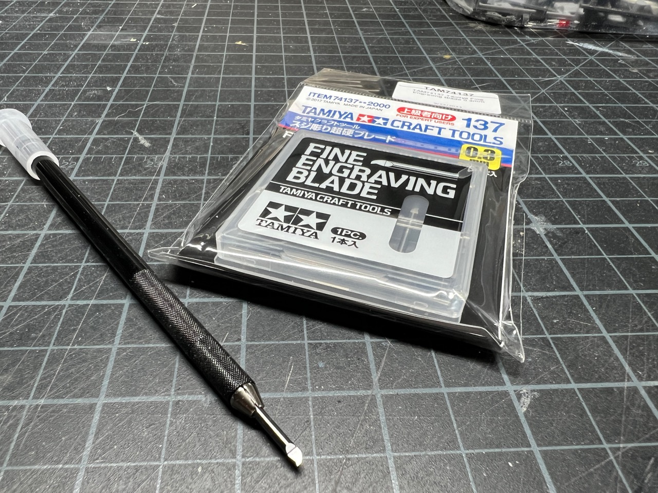

I had posted some pics over on the Nerf Herder' Workshop Facebook group and Lee Ralph was kind enough to shoot me a short video showing the tool he used and some useful pointers.
He recommended the Tamiya Engraver Tool and I have to say, combined with other things, it changed my game. I think there's a name for those kind of things. The blades and handle are sold separately and will set you back about $50.00 but it was totally worth it.
This time around rather than drawing pencil lines and going off them I took a different approach. I used a combination of parts maps and existing parts glued in place for reference. Once I determined the line I was going to scribe I used Dymo tape as guide from point A to point B.
Regarding my new scribing technique, the first thing I changed up was how I held the blade. Rather than gripping the handle like a pencil I rested it in my hand with my index at the blade tip to apply and control the pressure at the tip. My middle finger acts as a support and guide as the blade is pulled back, very much like someone doing pin striping.
Second, I kept the blade at 90 degrees to the surface at all times. This along with keeping the handle parallel to the Dymo tape made for a uniform line and prevented the corner edge of the blade tip from either wanting to wander or gouge the surface. I noticed that the couple times that the blade strayed it was because I wasn't doing one of those two things.
Finally, like has been said many times before, several light passes works! I know, I know, you tried to tell me but I get it now. My new knife and technique of holding it really allows me to feel what "light" really means. My old Tamiya panel line scriber is like using a linoleum knife.

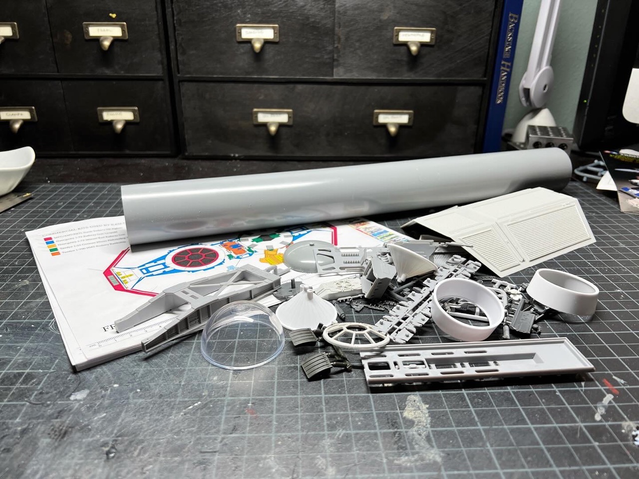

Fresh off the big high from my 232 Imperial Probe Pod, my next build will be the TIE Bomber. This one seems to have had a heyday 10 years ago but I haven't seen many that weren't 3D prints lately.
I already had a good start on the kits needed so I started collecting kits and materials until I got to the point where I got to the point where I could start. That time is now. Some parts I'm going to cast in resin due the cost of the kit so as not to go completely bankrupt. I got lucky last weekend at a model swap meet when I picked up an original Hawker Harrier and Stuka kit for $80 for both.
That brings me to WHERE to start?

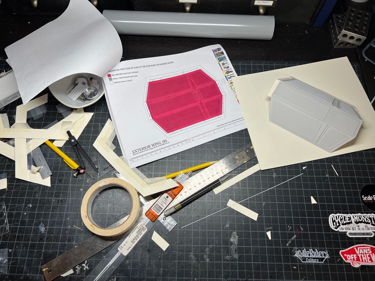

I'm not using a starter kit and I'm still sorting out what form the armature will take so I figure I can start with one of the many subassemblies. I chose the wings.

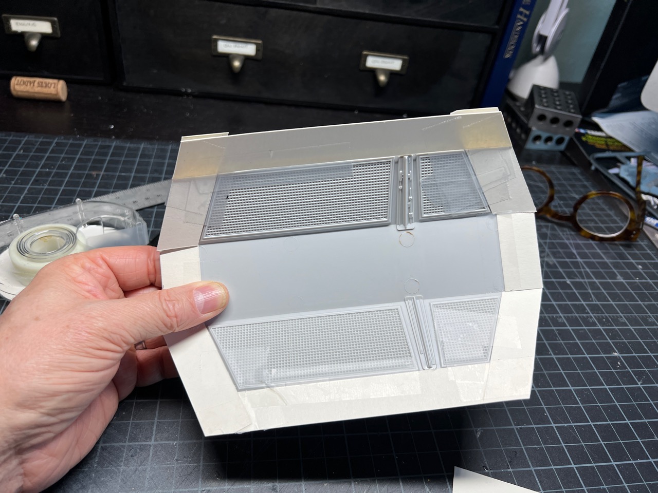

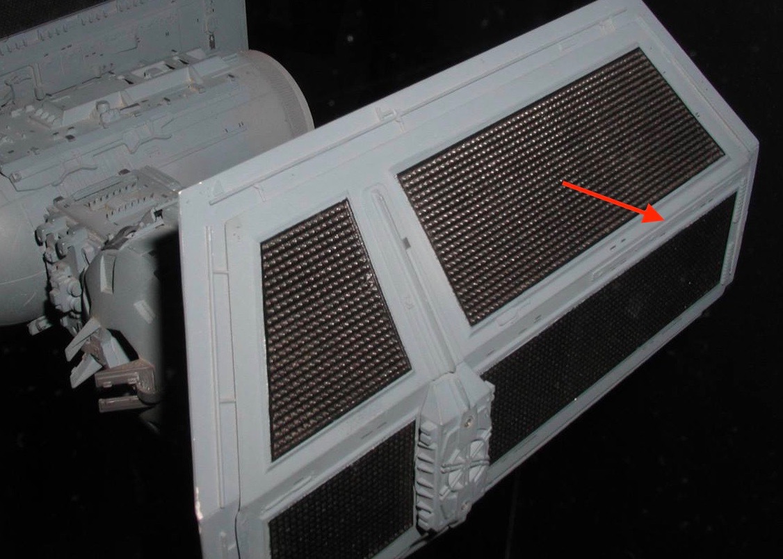

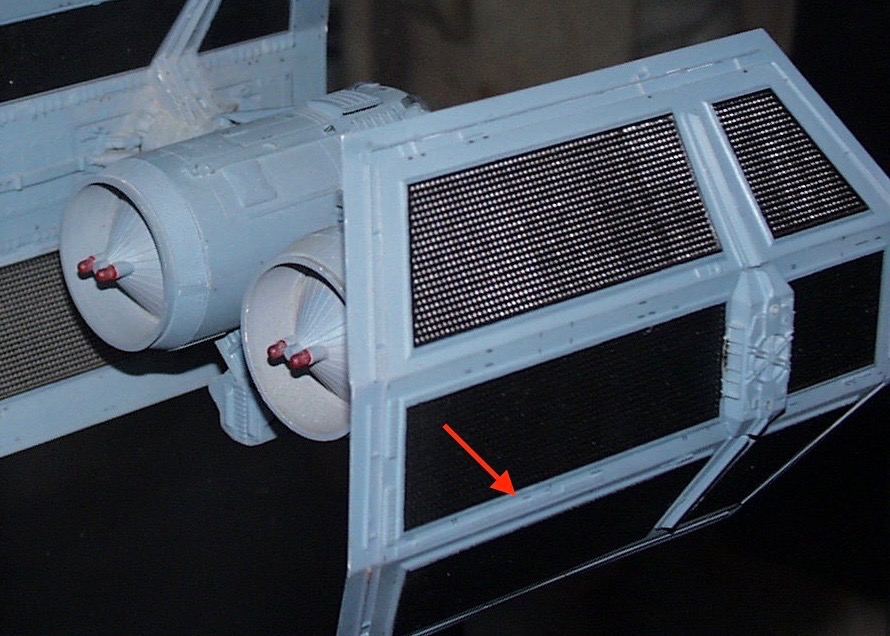

It was brought to my attention a detail that some people miss is that the wings aren't matching so you need two Vader TIE kits. On the outside of the center panel there's a detail strip that is on the top on the left wing and on the bottom of the right one. If you use the two wings included in the kit that strip will either be on the top or bottom of both sides depending on the orientation of the wings. So you need two kits. Who knows if this was intentional or just by accident when the the original was being built.

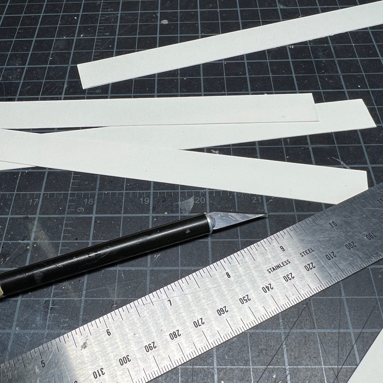

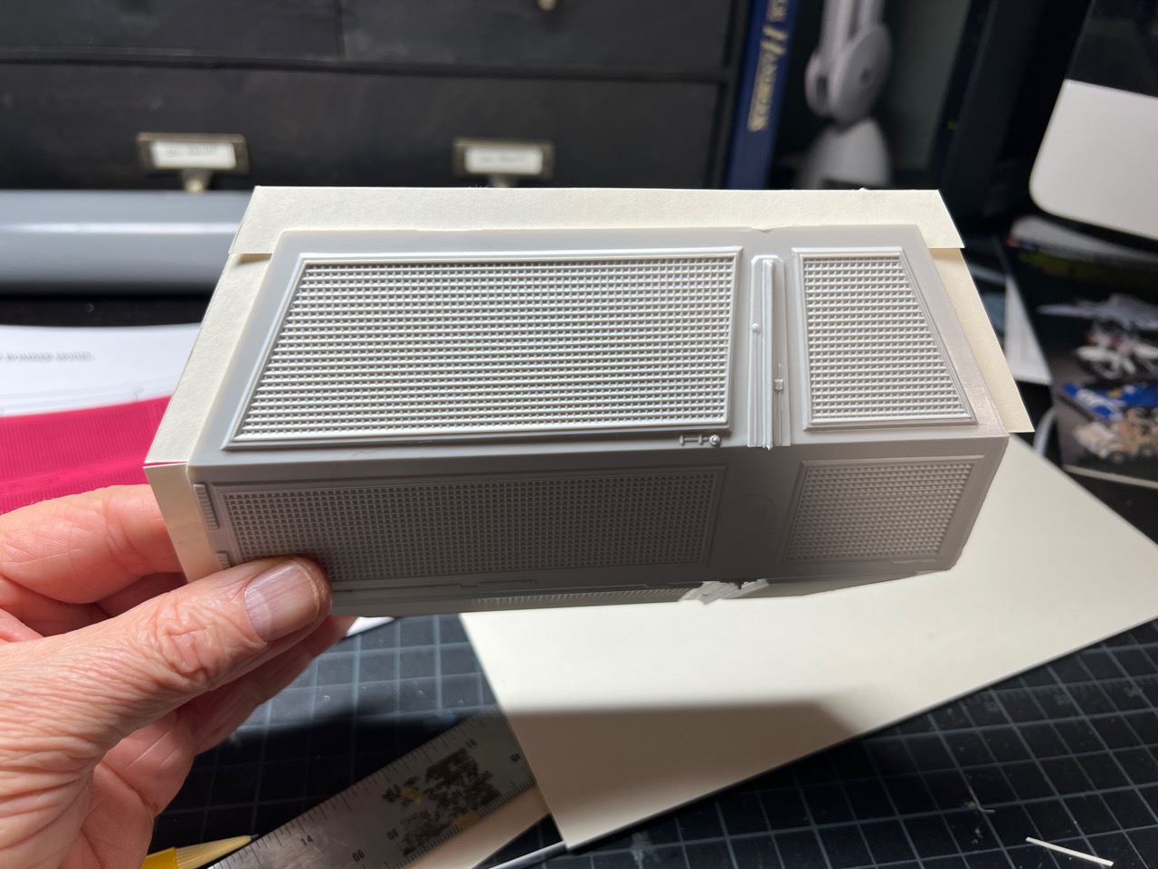

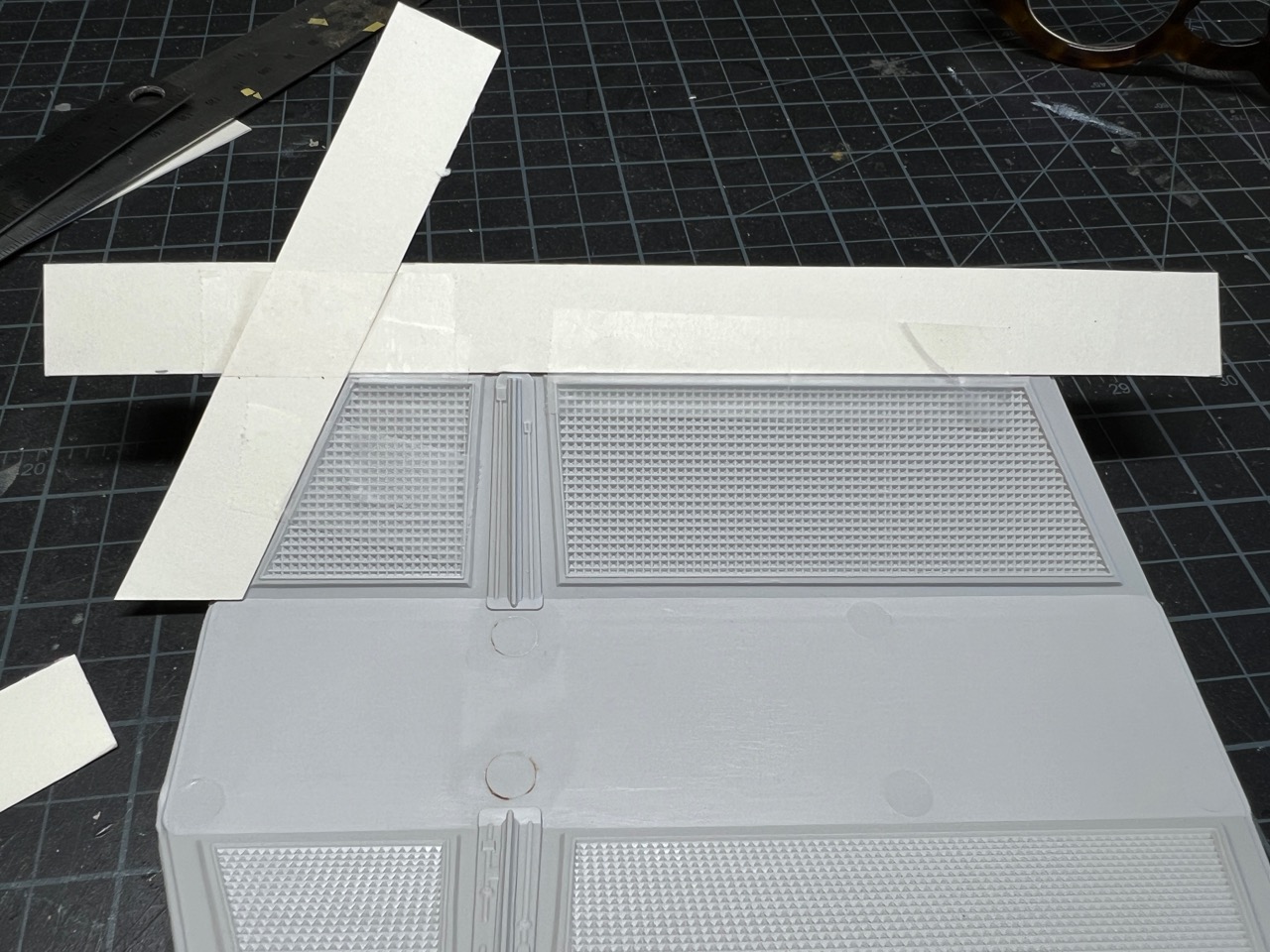

With that straightened out I started on the wing extensions and figuring out the measurements. I've read of people doing their wing extensions in varying widths:
12.6mm
15mm
15.8mm
I know there are some templates out there and I'm capable of making my own but I found it faster to cut some strips out of card stock and just taping on the wings to see what looks best. Afterwards I would then just trace the pieces onto another piece of card to make the final template. I know it seems like a lot of work it's just a quicker way of working for me.
I started with the 15mm measurement and it didn't quite look right so I tried 1/2". Again, not looking right. Too small.
In the end I found myself in that familiar place we've all been in where I was getting tired and nothing looked right.
I'd be curious to hear from anyone out there what measurements for the wings you used.
