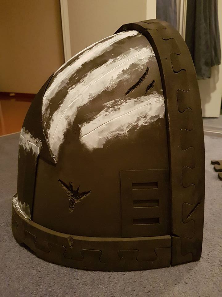

Of course I couldn't help myself and started some detail work on one of the shoulders. I've started patching up the seams (will need more sanding and maybe another coat on those seams) and I've popped a big Tactical Marine arrow on it as well as some battle damage.

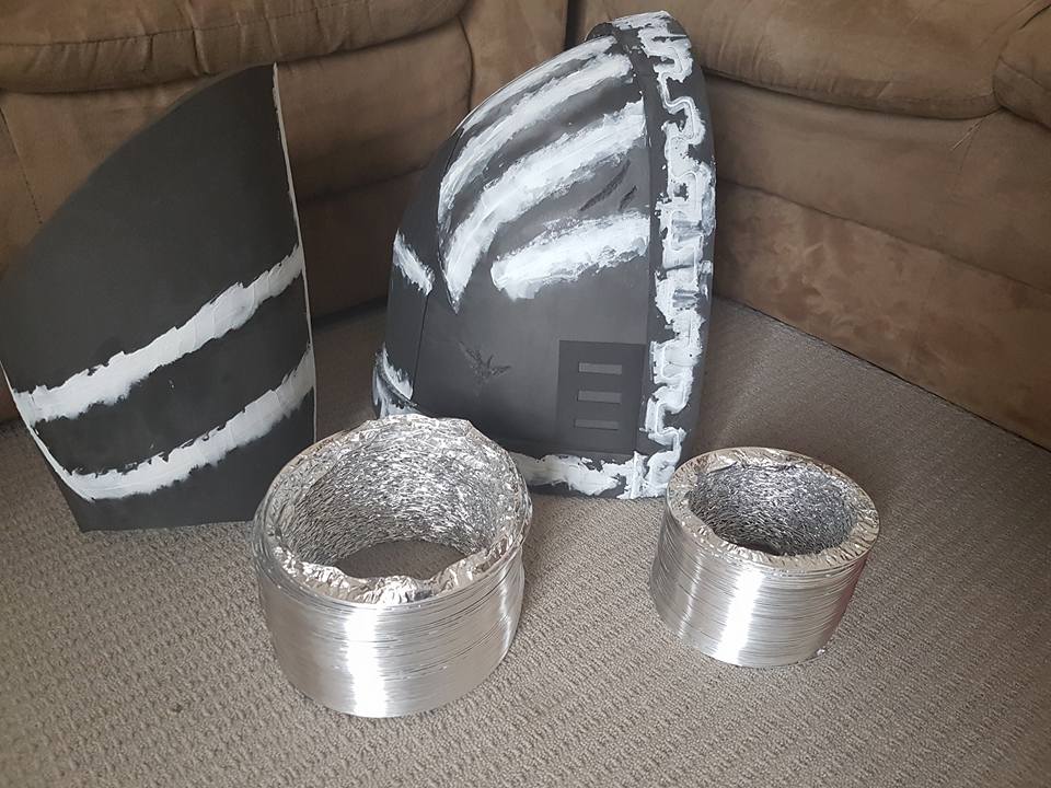

I'm using air conditioning ducting for the arms and legs, which will go on the back of the knees and in the gap between the thigh and cod.
Slight update! Have been filling in gaps with acrylic filler and sanding down seams. Also my ducting had finally arrived after being lost with the couriers and the seller just resending the item after being unable to track it down.

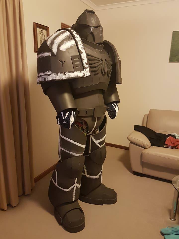

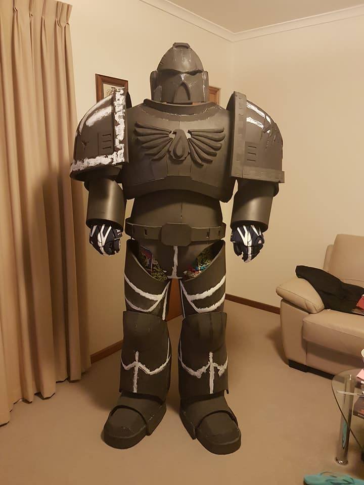

Hey guys!

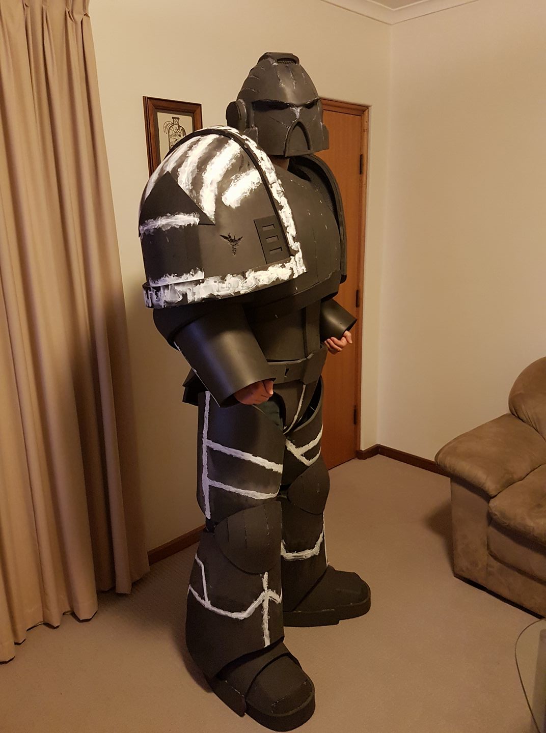

So it's been a little while since I shared anything on here for the build. Been a little occupied with work. Anyways, progress that has been made so far is majority of the build is done (missing a boot) and there is still detail work and fixing up seams, but most of the rigging is complete, which means I was finally able to try on the costume!
I learned a lot from have the costume on. I'll need to rework the ab section, still needing to add the extra height within the boots and increase the gap slightly between the shins and the thighs. I'll also be making the shoulders go up higher to reduce the overly stocky look in the torso section. Should also be getting a pair of hockey gloves soon so I can get the arms looking right.
Still lots to do, but this was a great milestone to reach! More updates coming soon.

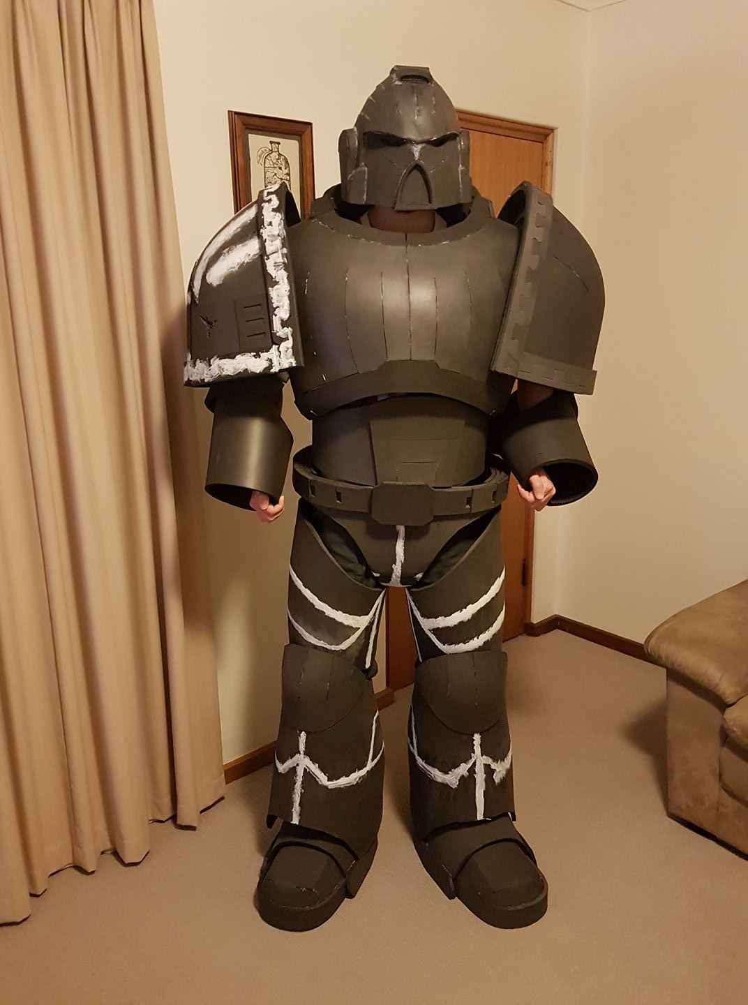

Looking good so far[emoji1303][emoji1303] how long has it taken you to get to that point ??
It had taken me quite a few days work to get to the bottom picture. Being my first foam build, there was a lot of trial and error in the cutting and gluing of the foam (as you can see by the terrible quality of my helmet... I'll be remaking that). Also due to the sheer size of the costume and amount of foam needed, it was quite tedious and took a long time.
I haven't been able to source large sheets of EVA in my area for a good price, so these are made of the floor tiles which are roughly 60cm x 60cm each, so while some of the pep files I was using required larger pieces, I had to cut each piece into smaller pieces and glue them back together.
More progress has been made since and I shall be sharing some more snaps in the coming days :)
Update time!
Changes I've made since my last pictures are;
-I've raised the shoulders so they sit higher
-I've raised the torso as well so it sits higher
-I've added a few cm's in the gap between the thighs and the shins
-Both boots have been made and have shoes attached inside so I can easily wear and walk around. They also add around 3-4 inches to my height
Overall I'm much happier with the proportions of the suit now and I no longer look too stocky. Boosting the torso up has created more pain with where it sits on my shoulders, so extra comfort in that area is something I will be investigating and improving.

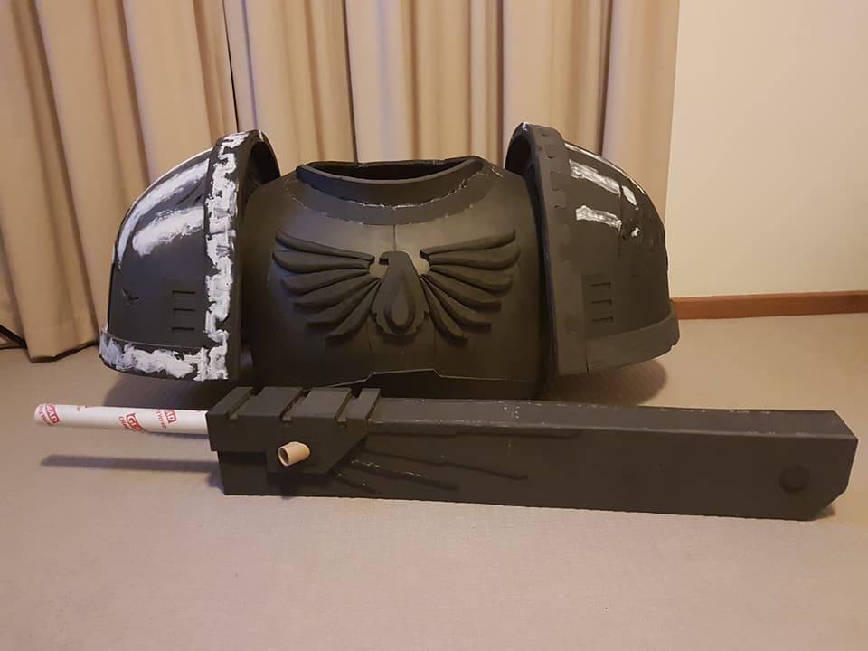

Things that have changed, I've added internal supports inside the torso to stop it losing shape under the weight of my arms/the shoulders. New ab section that covers some gaps that were previously visible. New collar. Added some knee joints to have the legs more stable and moving as a knee would. Plus some detail here and there. Also have started making a chainsword, but I forgot to grab a picture with it while I was suited up :(

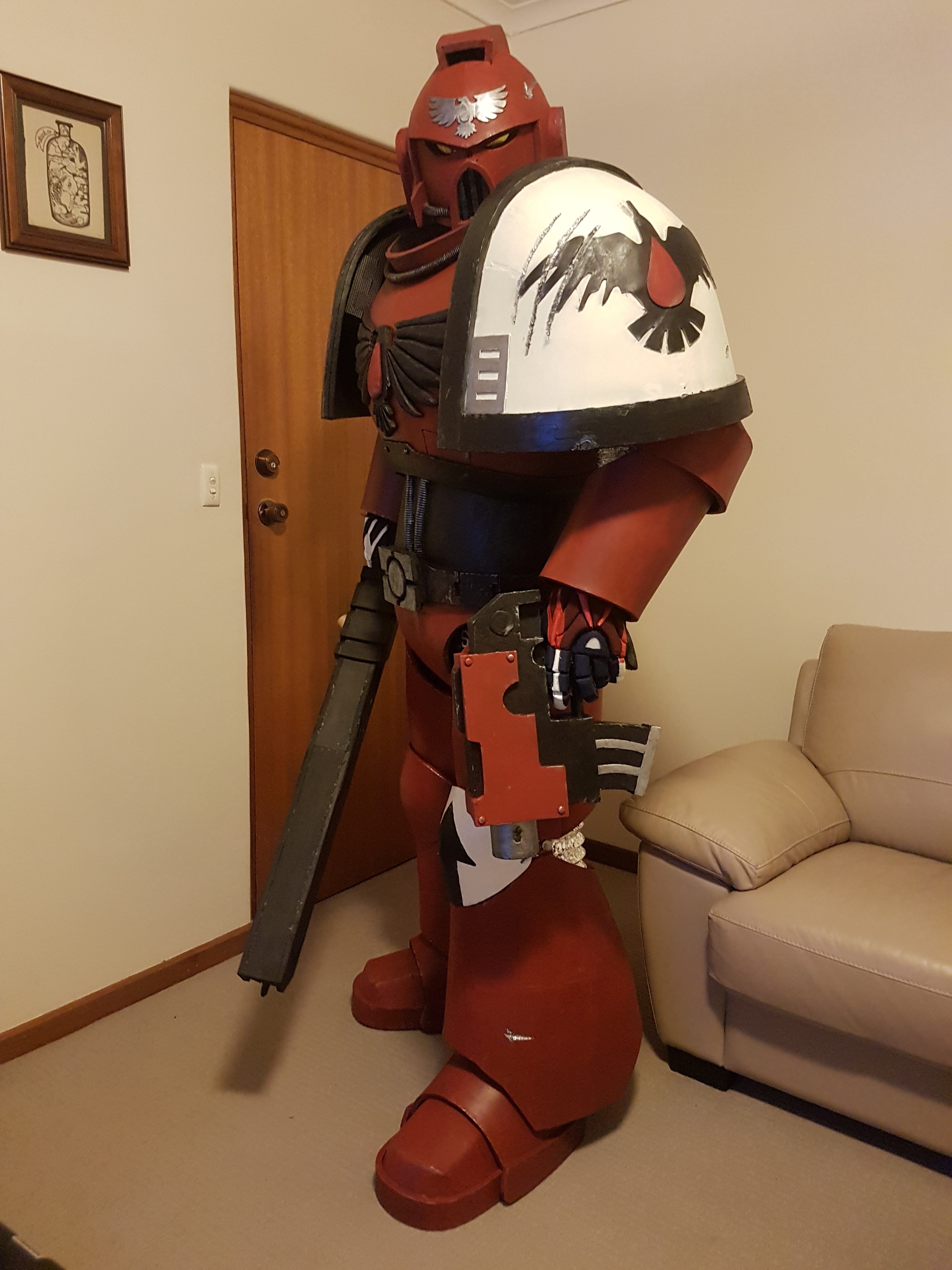

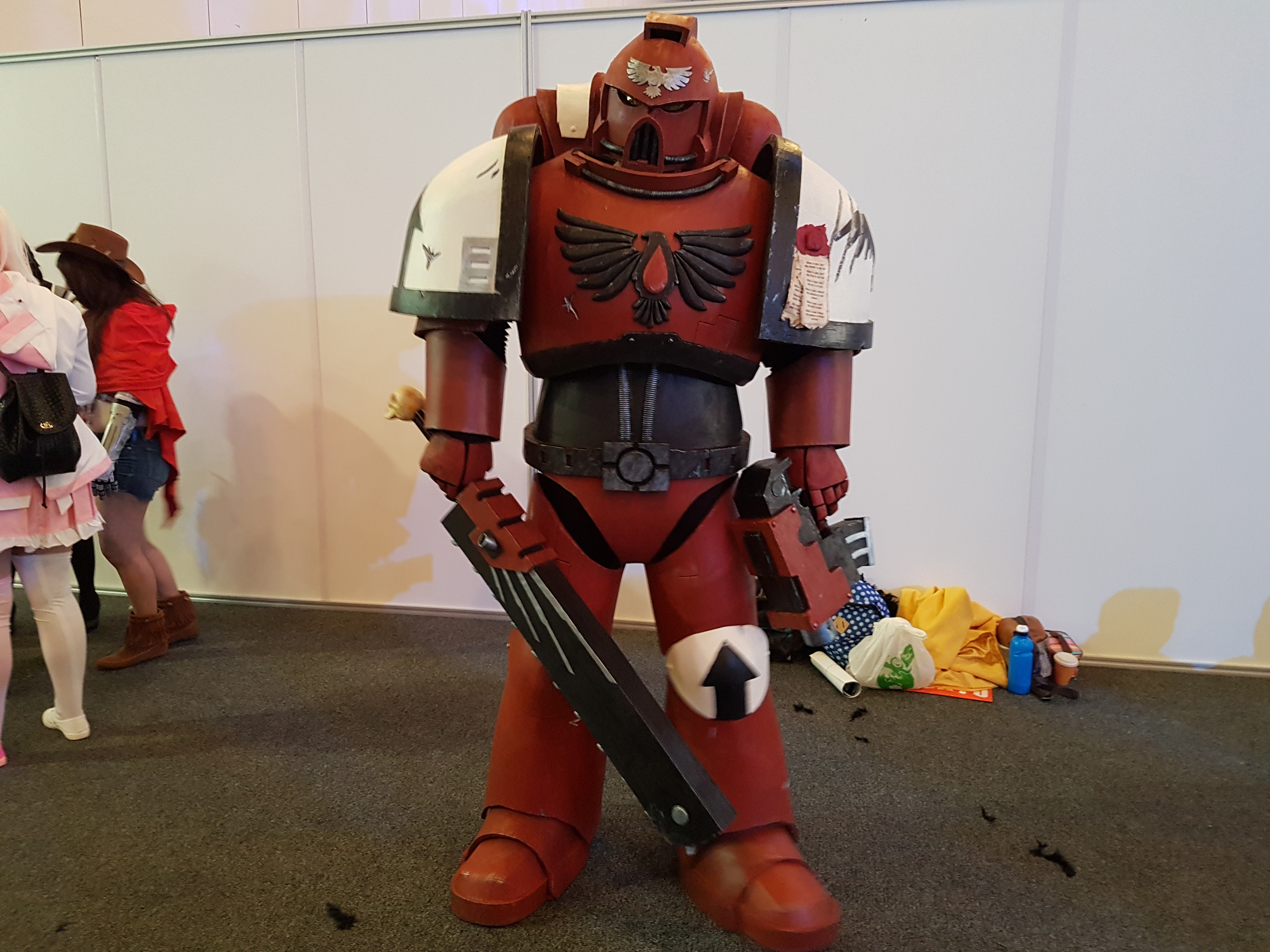

Been super quiet on here. Have made great progress so far though! I'm planning on wearing it the first time this coming weekend at a local convention called AVCon. What's missing from these pictures is the backpack (currently being painted) as well as purity seals (which are almost finished and will be attached). It's been such a learning experience and although some times it got super on my nerves, it's been a blast making this cosplay. Can't wait until everything is done and I can share some pictures from the convention!
So the convention over the weekend was great! It was great to finally stomp the floor in my first foam build. Got lots of great compliments. It made me feel great and I can't wait to get started on the next build! More pictures will come (there are some coming in soon from professional photographers at the event which will look amazing!) but I won't keep spamming bumping this thread, so I'll be posting them up on my Facebook page: https://www.facebook.com/lemonhunter33/ so if you want to see them, I would appreciate the likes :) shameless self plug.
