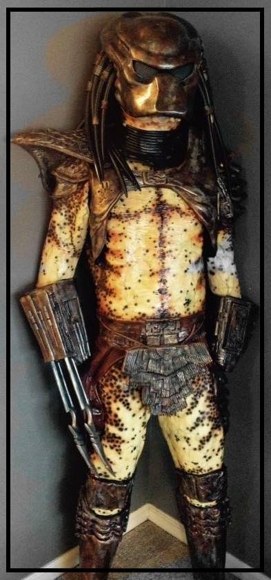

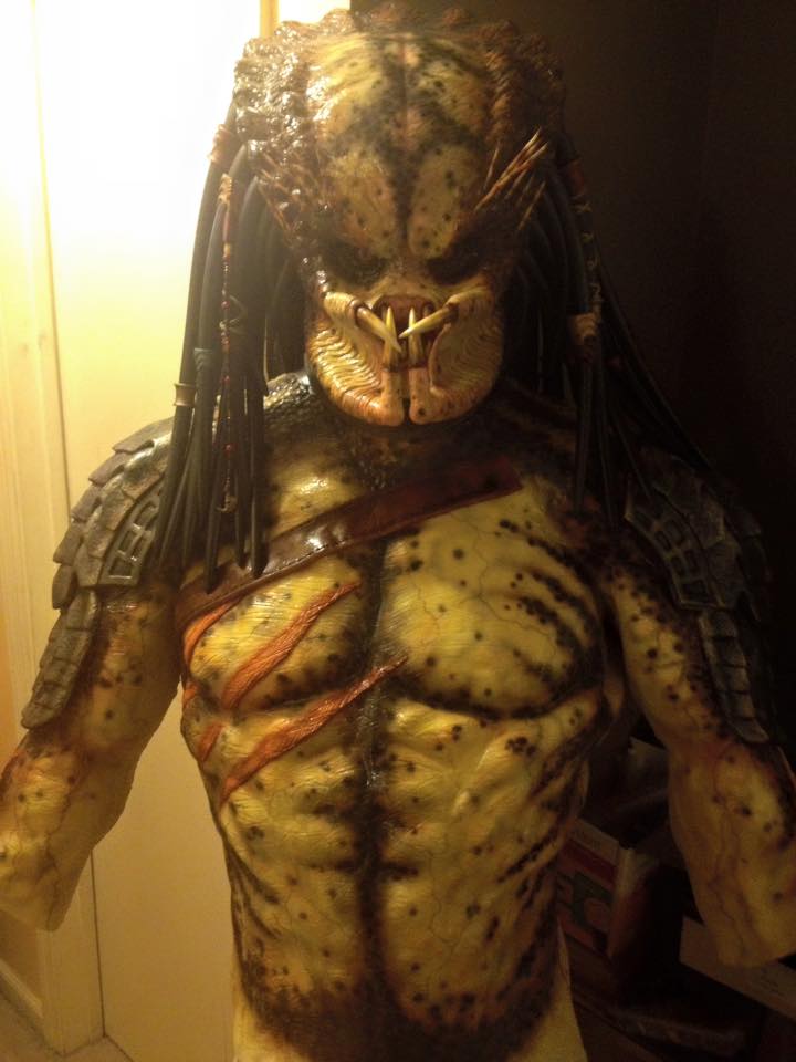

The ratio on mixing these inks are 60% ink + 40% Naphta or MS. But in my own experience using them you can do 25% ink + 75% Naphta or MS for a translucent effect.
Here is some of my work done with these inks. Please always remember to work in a well ventilated area and wear a respirator.
I hope this helps
