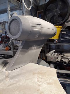

Landspeeder full size, 3d printed!
Little break for Easter so need to catch up on progress...

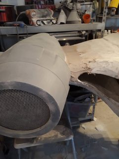

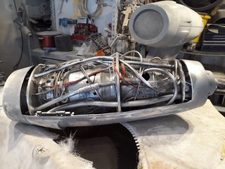

Got the right hand engine fitted
The tail fin fixed and finished

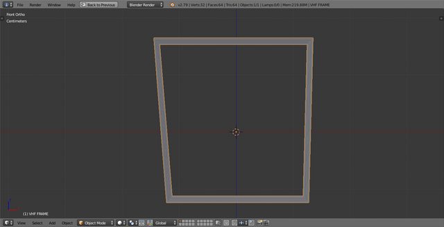

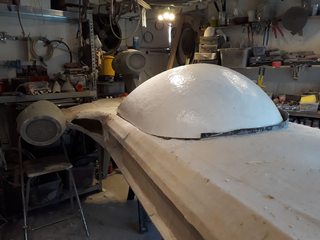

Made the former for vacuum forming the windshield...still more to do

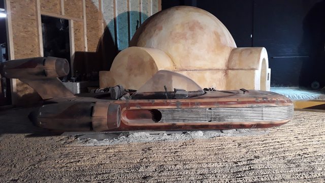

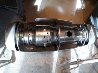

Installed the flame tube turbine in the open engine bay...will probably give it some sand weathering as well when the whole car is done
Would you be willing to provide more information on your windshield process? I am planning on scratch building a landpeeder, but without a nice windshield it just cannot happen. I think this would be the only part that I would not be able to create at home.

same thing here, you beat me to the punch! I am going to make it be able to drive. (hopefully)
Hey guys...yeah the windshield is a bit tricky. I basically just modelled it in software to exactly fit the windshield outline of the car, then generated the STL file and sliced it up to print. Glued all the pieces (4) together and then stuck it to a board. Cut the board to shape and then filled the whole thing with PU foam. Added a 2" block of wood to lift it off the bed for vac-forming and then finished it all over with bondo etc until it was like glass. Vac-formed it in 6mm PETG. There are probably other ways to do it but this was the most DIY method for me

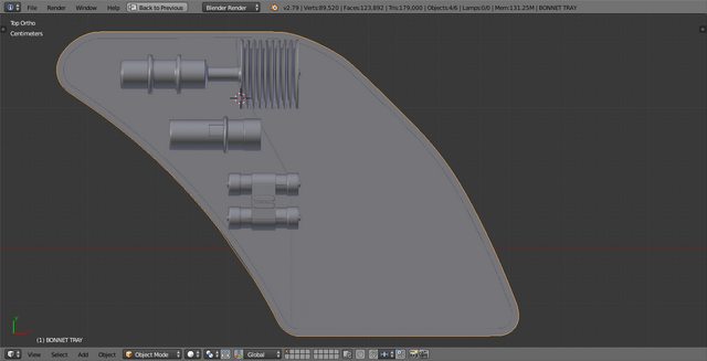

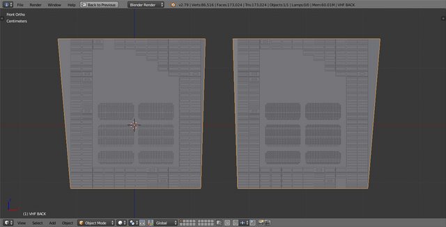

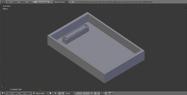

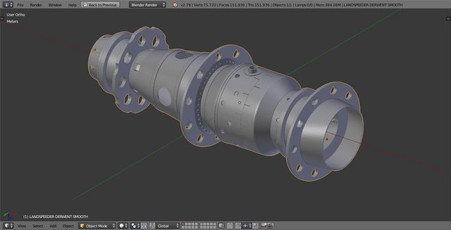

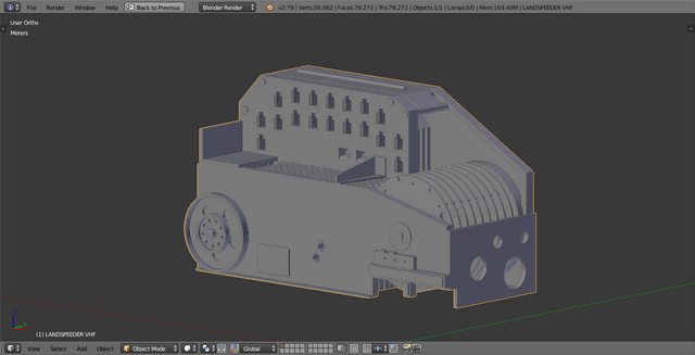

And here's the greeblie bits for the body shell. They will need to be cut out of the shell and fitted. I just modelled the tricky stuff,,,the other parts of my build were found parts/electrical elements etc. The main greeblie for the bonnet tray is the same as from the top of the Mouse droid which u can find on Thingiverse
BONNET TRAY; Dropbox - BONNET TRAY.stl - Simplify your life
Dropbox - BONNET TRAY1.stl - Simplify your life
Dropbox - BONNET TRAY2.stl - Simplify your life
Dropbox - BONNET TRAY3.stl - Simplify your life
BACK BOX; Dropbox - BACK BOX.stl - Simplify your life
Dropbox - BACK BOX1.stl - Simplify your life

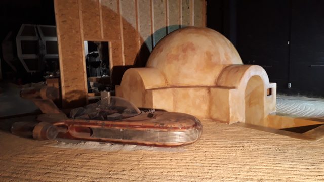

Can you share some more informations about this museum in Germany!
Being from Germany I’m really excited to hear more about this.
Who is involved? As far as I know there are only a handful of people to cover such a project...
OK I'm not sure how much I can say as It's not open yet but it is a walkthrough of the original trilogy. It's near Lubeck
