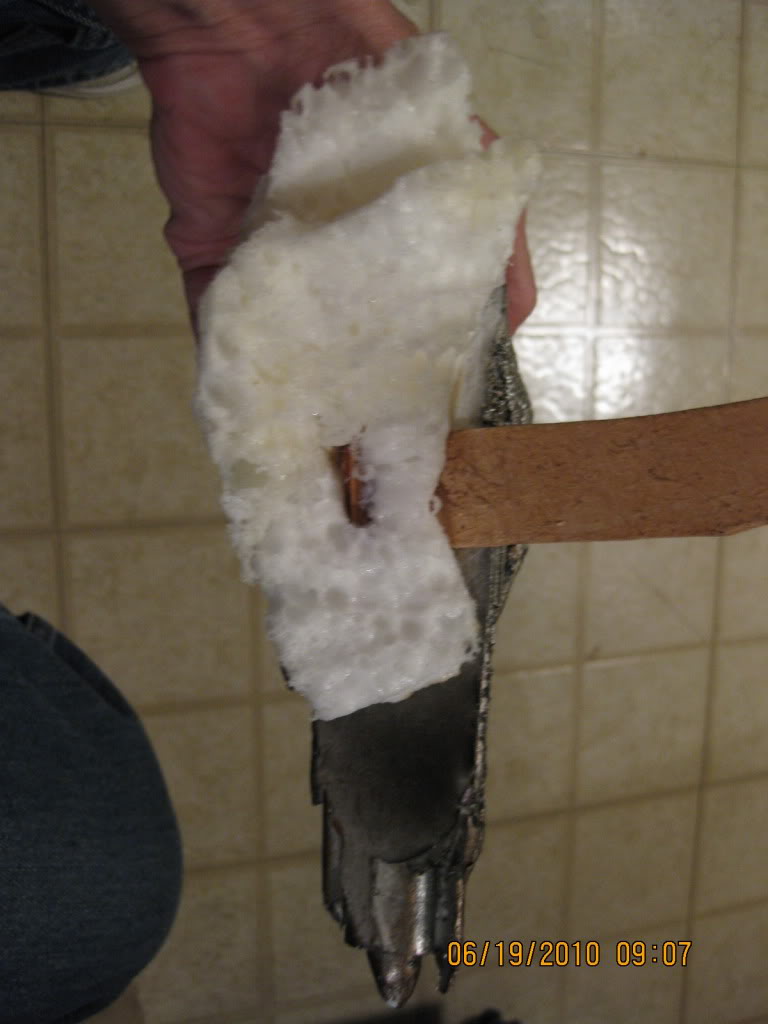

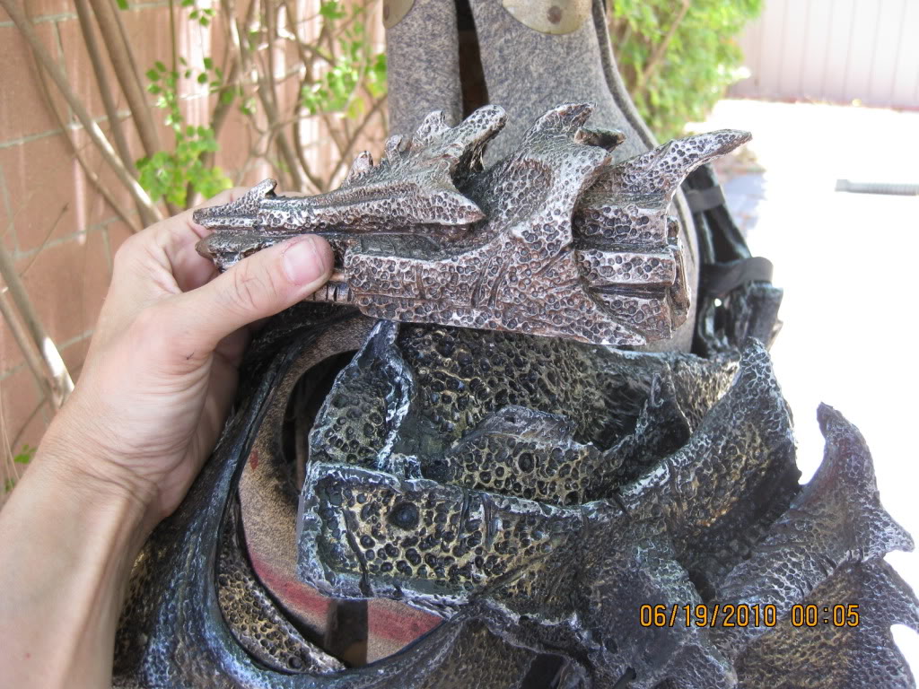

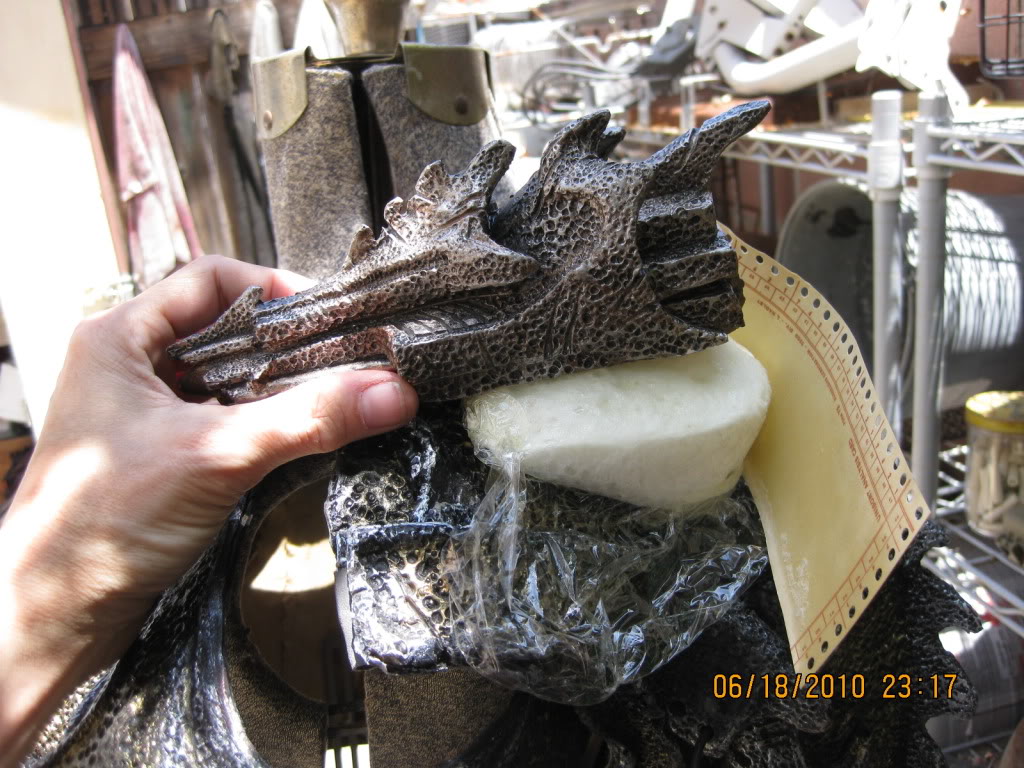

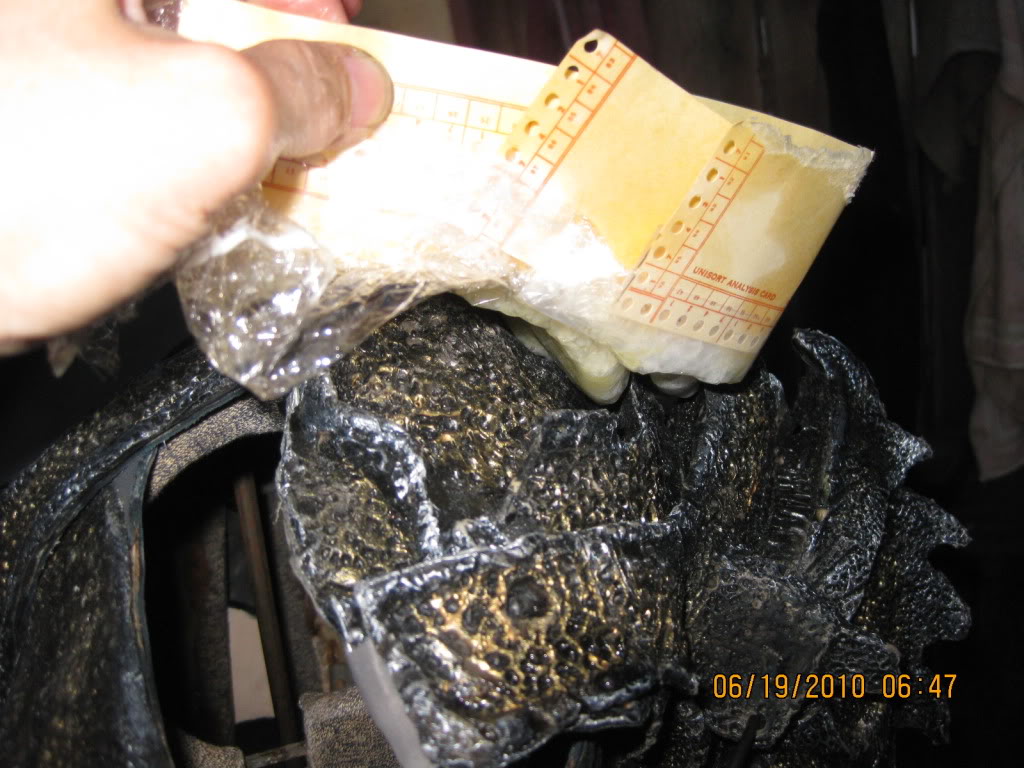

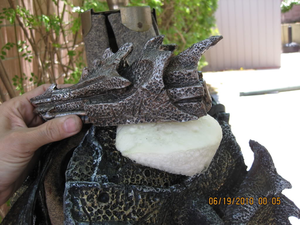

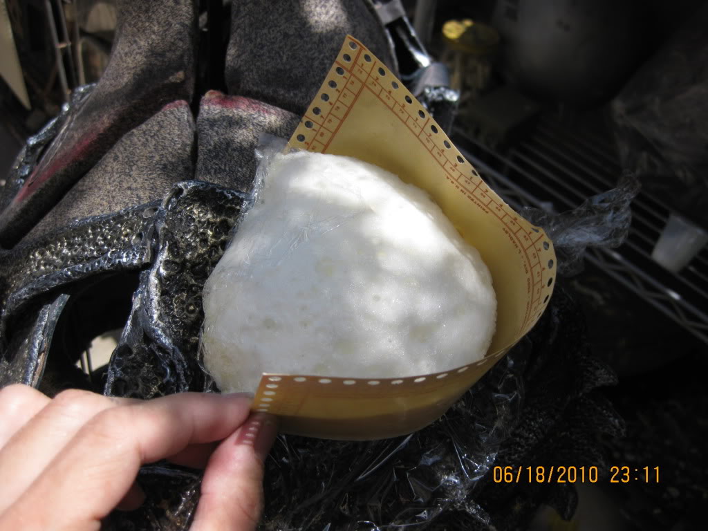

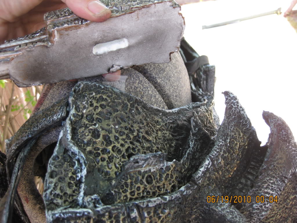

The cannon needed something to adapt it to the shape of the torso armor/medkit scallops, so I played around with that two-part foam...
cannon mounting hole:
checking where cannon goes:

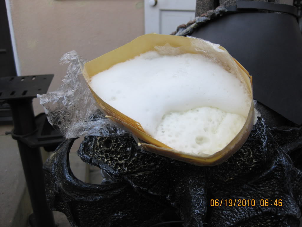

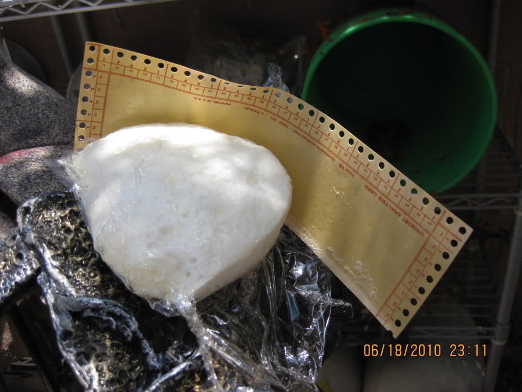

Paper form and twopart foam:
peel paper off:
shoulder cannon fitting wedge:
Redid the wedge:
Paper form and twopart foam again;
saran wrap protects the armor from the foam:
closeup of mount in mold:
peel the paper:

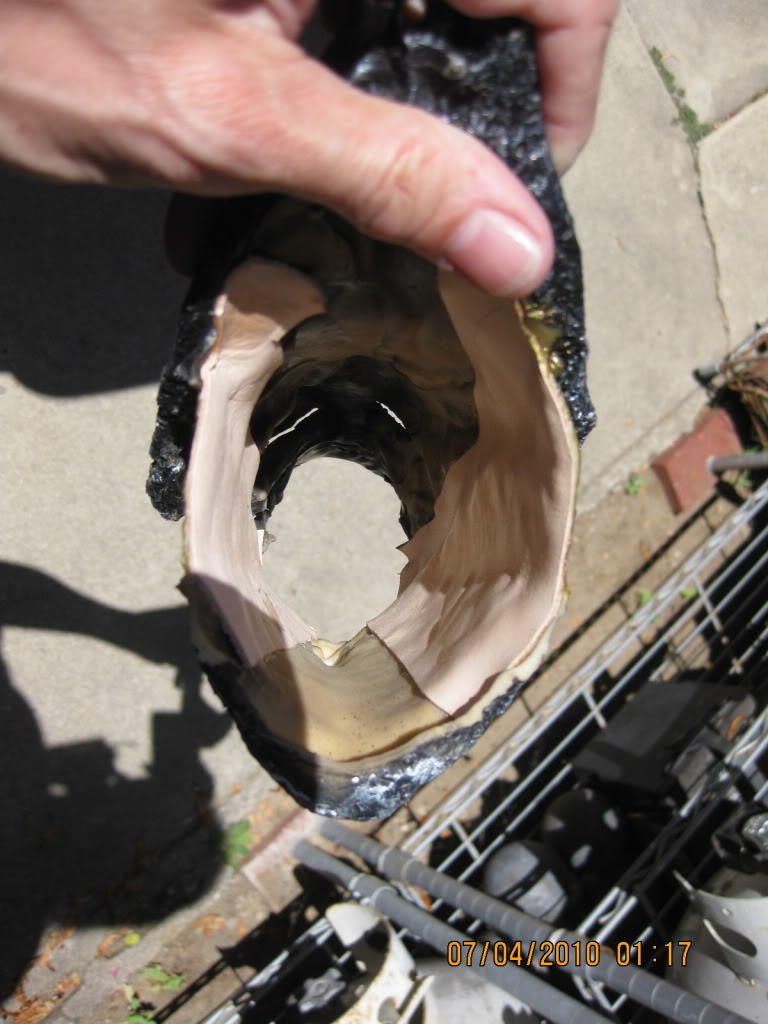

Strap for cannon glued in:
bottom view of foam:
painted cannon mount side1:
painted cannon mount side2:

the cannon finished on shoulder:

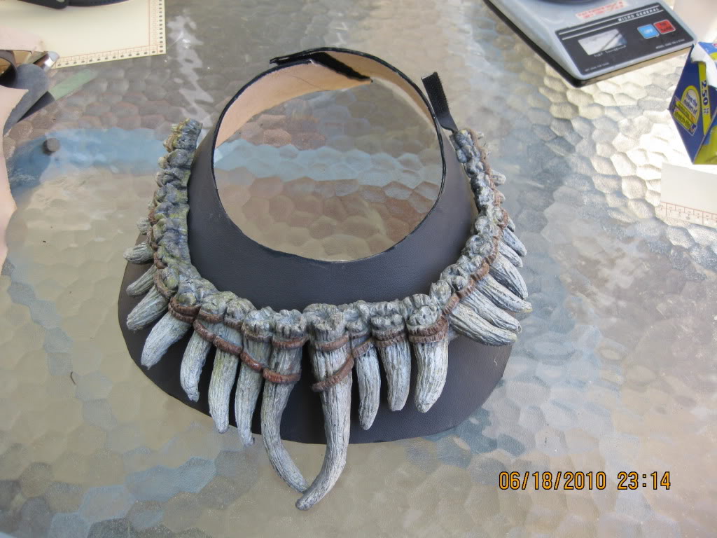

I made a go at a neckring, but turns out the black one (SuicidalRaider made it) I had from my AVP armor looked better
neckring:
neckring detail:
back of neckring hides the zipper:

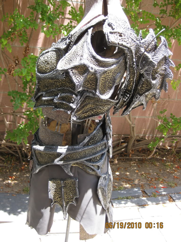

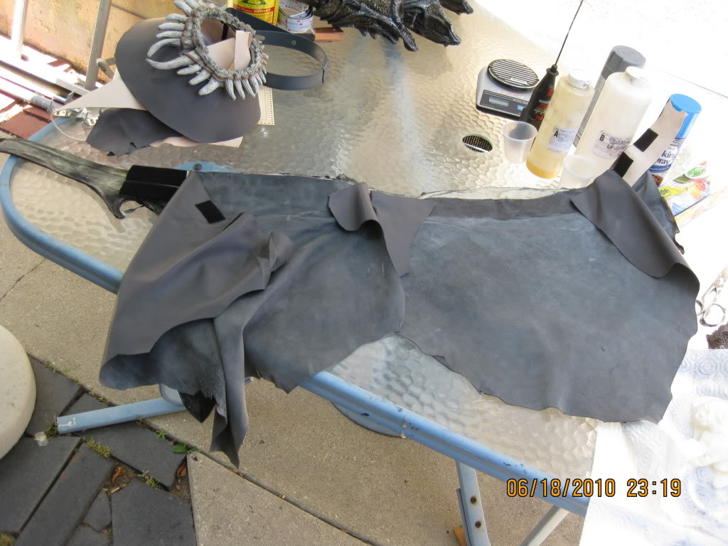

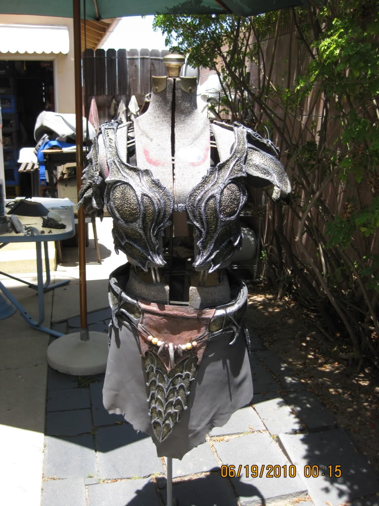

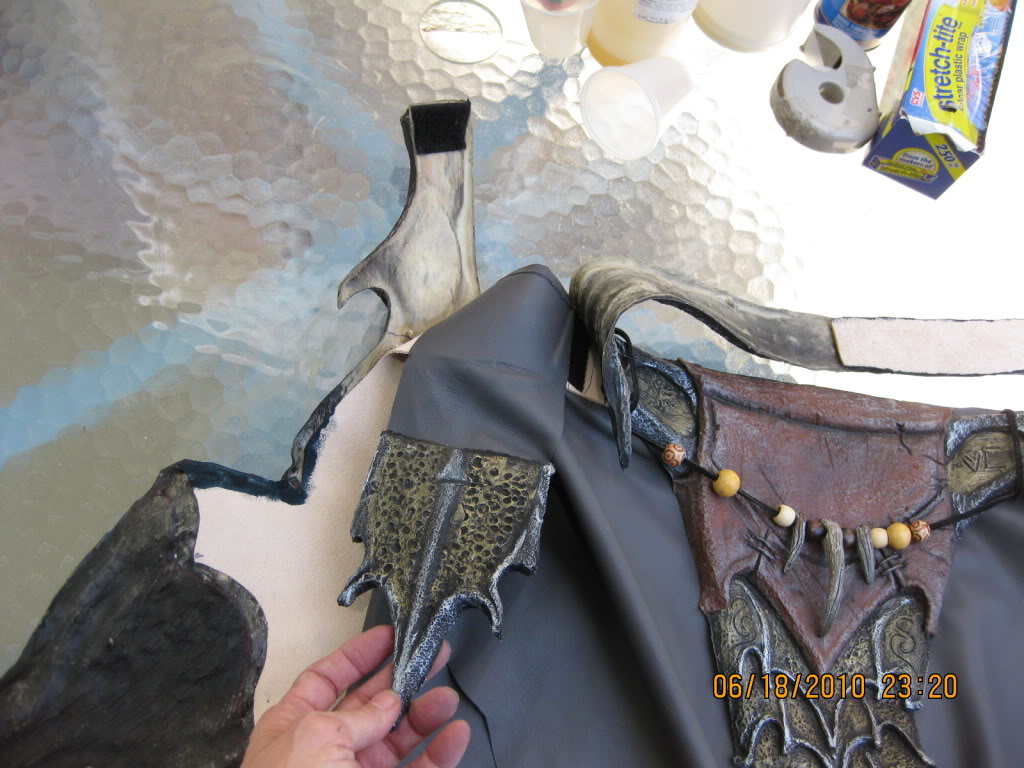

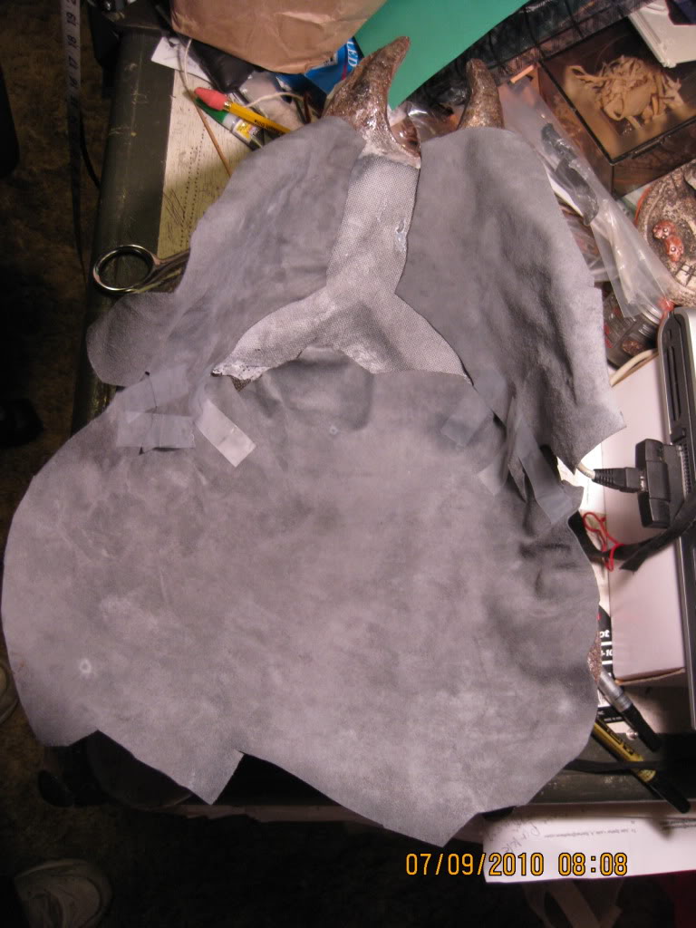

I had to reinforce and attach torso pieces together; not shown is the thin leather inside along the back torso neckline out to the shoulder seams and onto the front torso armor's shoulder straps.. I also had to figure how to hold the waist armor pieces together; I used the same scheme as my red-and-gold armor.
right shoulder with velcro strap to the torso armor; its lined with leather; also knife scabbard reinforced with leather and strap added to hold it onto the back armor:
waist armor back and front belt is reinforced with a leather band; the grey front/back cloth glued on also:
thigh armor attached to waist armor leather:

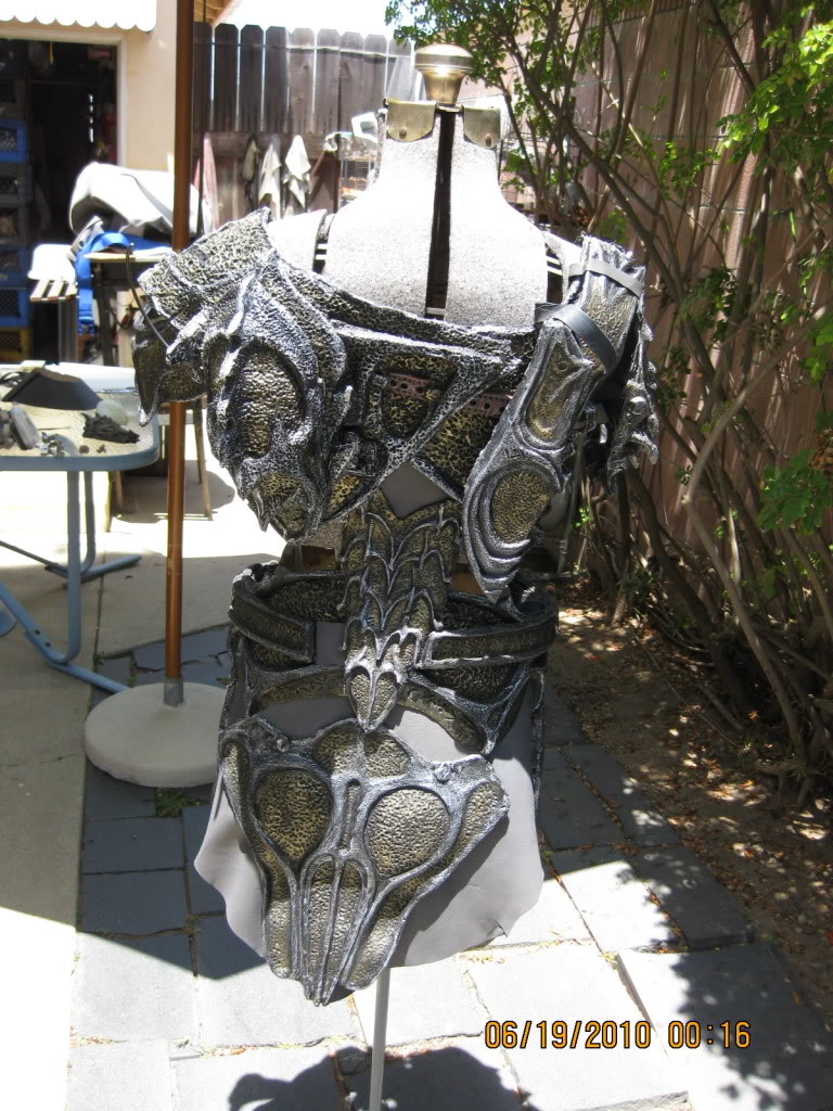

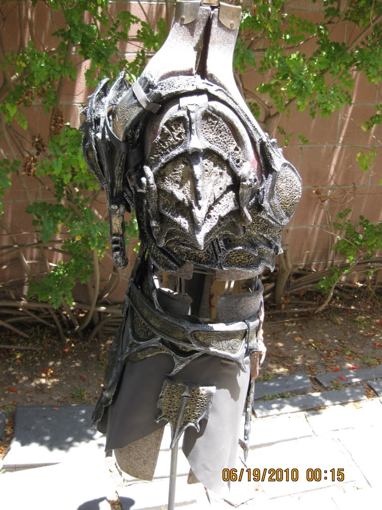

I put it on my dress form; the shoulder cannon isn't mounted on it, but the velcro is inside the armor.
on dressform; front:
on dressform; rightside:
on dressform; back view:
on dressform; left view:

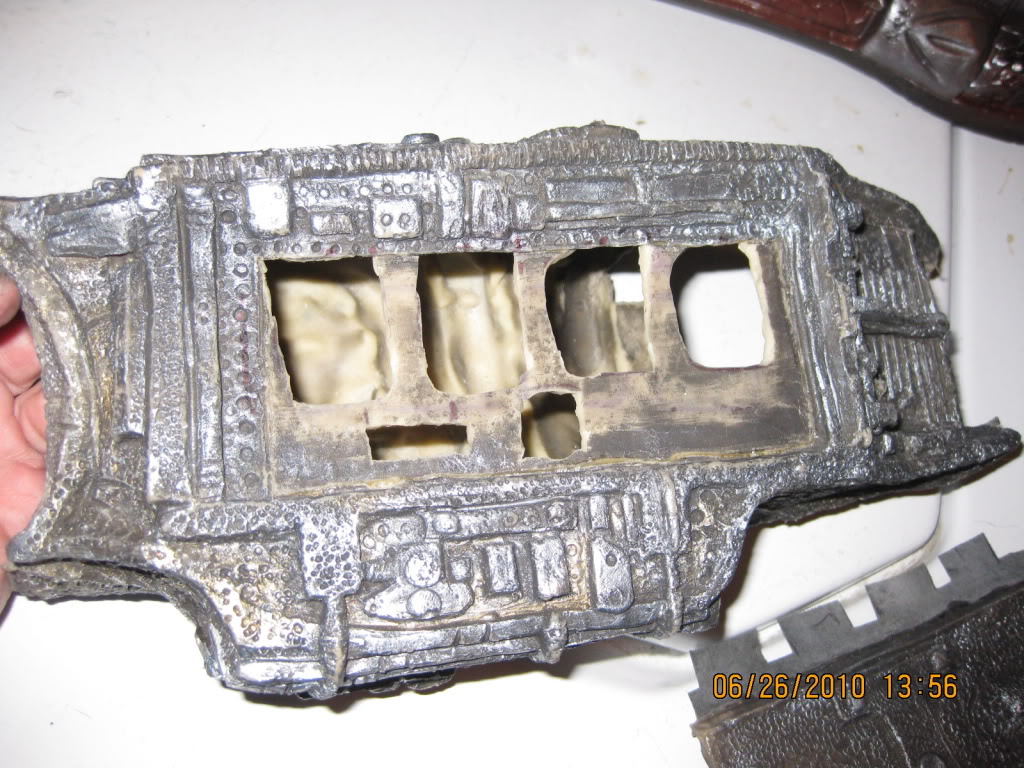

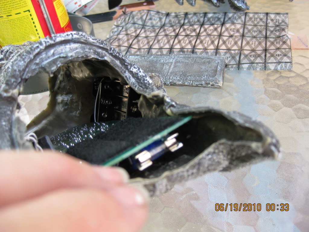

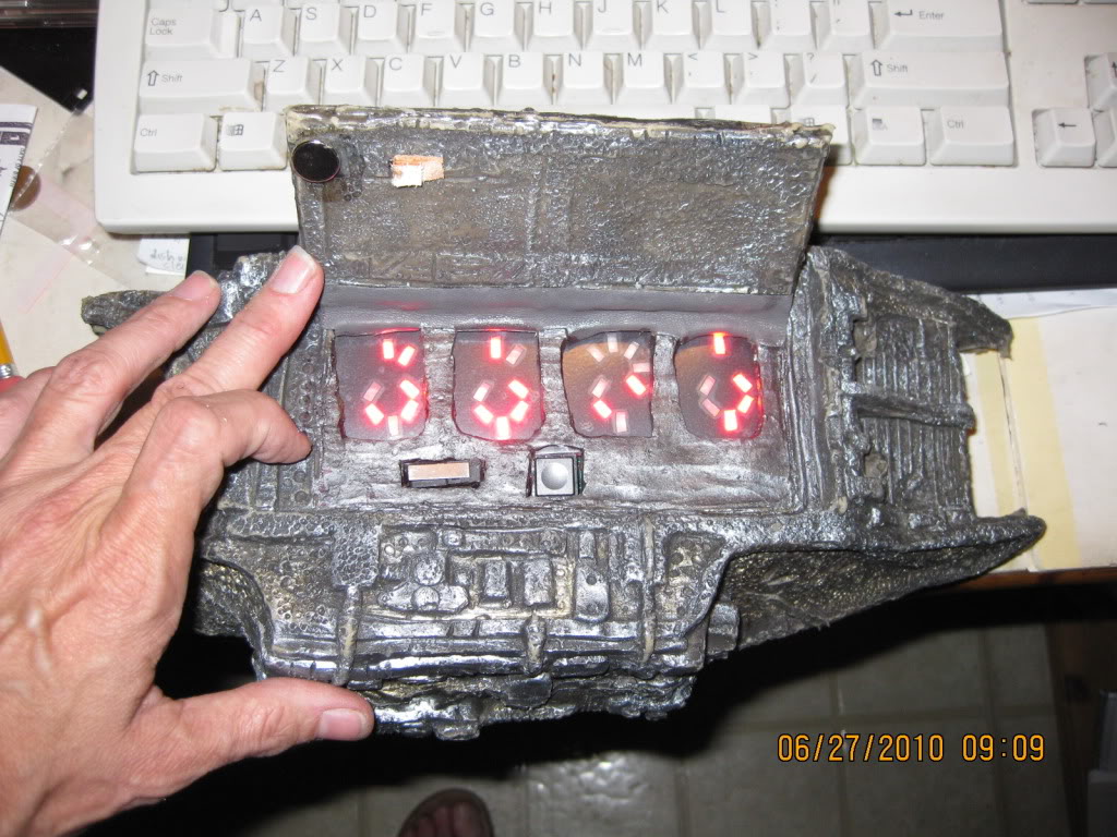

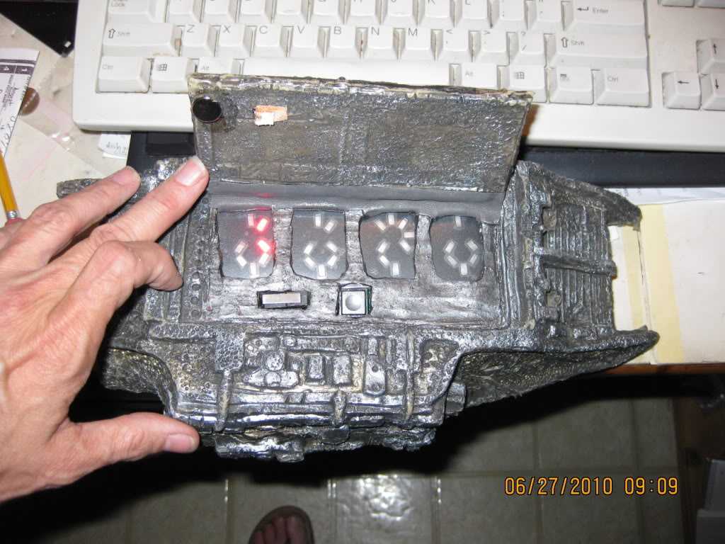

More pix of the build... I sent AntCarb a template for a countdown board I have, and he built the gauntlet so it would fit in there...
it has room for a 4 window P2 style of countdown circuit...
installing the countdown electronics:
countdown windows cut out:
Lid with leather hinge:
countdown running; the lid has a magnet to hold it closed, and the switch is pressed with a 'nub' that is glued to the lid:
countdown running:

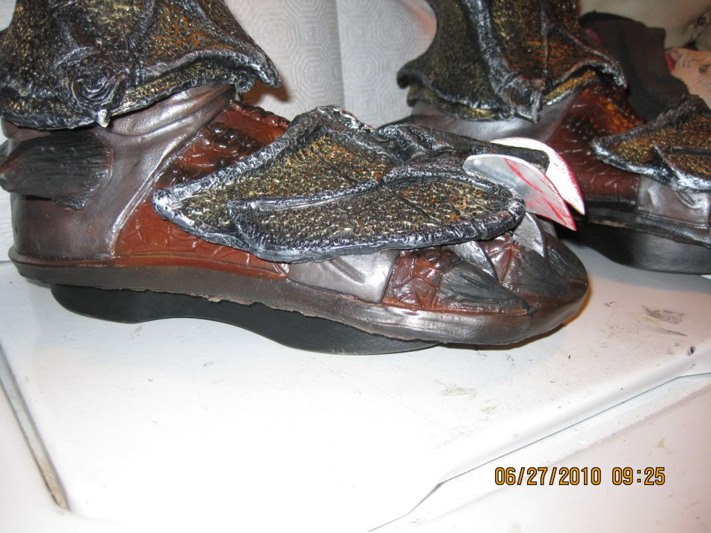

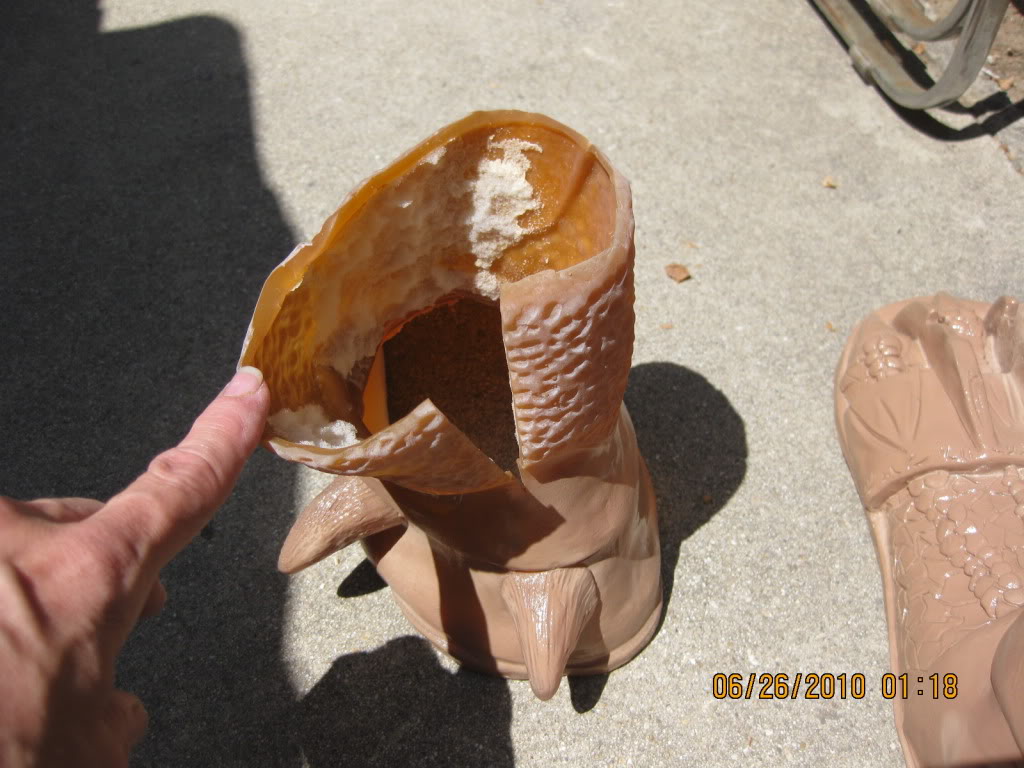

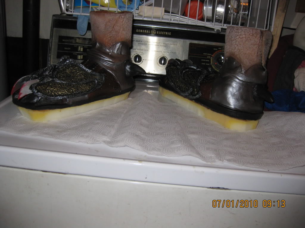

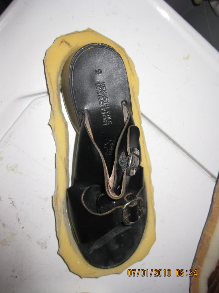

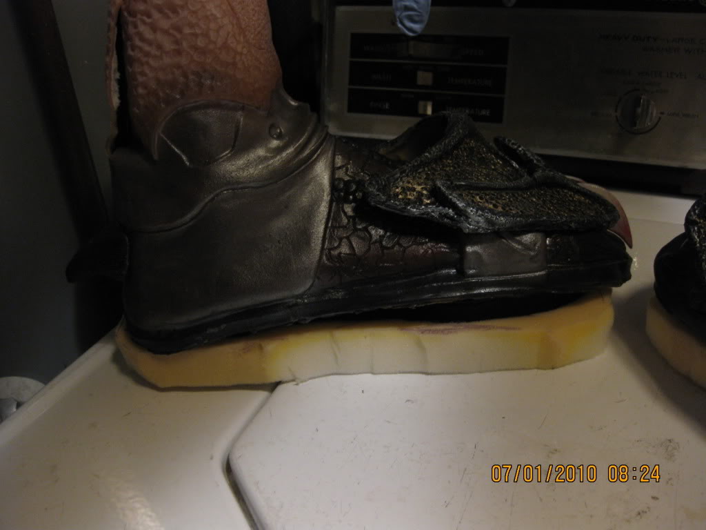

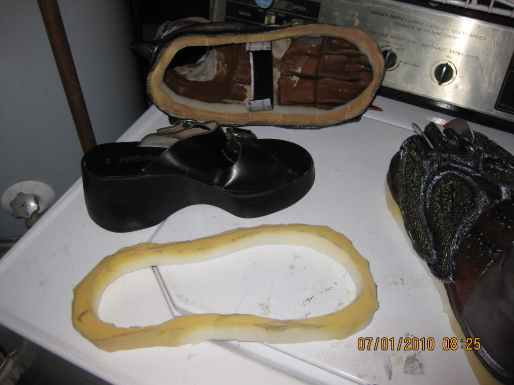

I had to use new feet (many thanks to Dakath) since the instep guard/toeduster wouldn't fit over the AVP feet; their toedusters were already glued into the sandal holders. Also I had to extend the sole on the sides, the sandals I was using were a little thicker than the existing space inside the feet.
cut sole out of feet:
slot in the back:
painted foot:
foot with toedusters magnetically attached:
making sure the shinguards fit the feet:
pieces of the foot assembly:
check the fit:

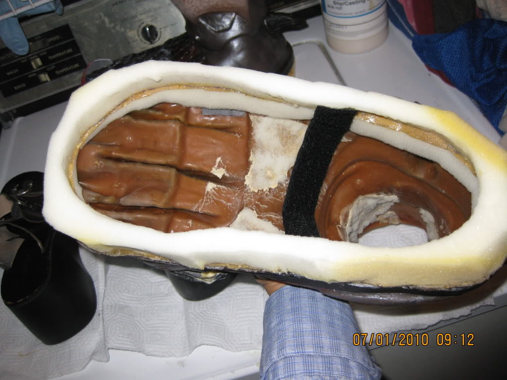

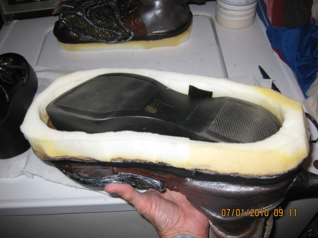

fitting the foam on the sandal; one continuous ring:
inside view of the foot; velcro holds it to the sandal:

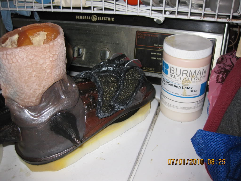

put latex layers on the foam around the outside:
bottom view with sandal in the foot:
ready to be painted:

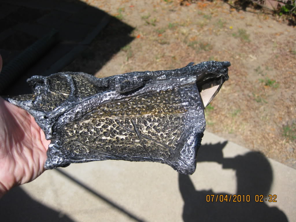

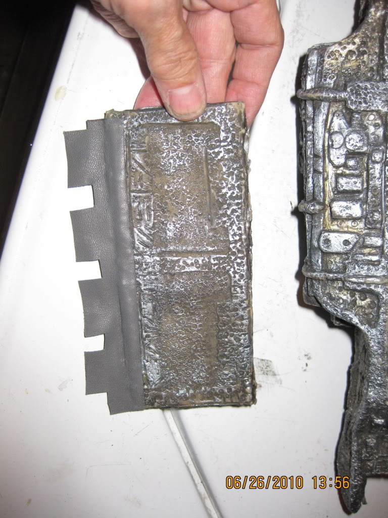

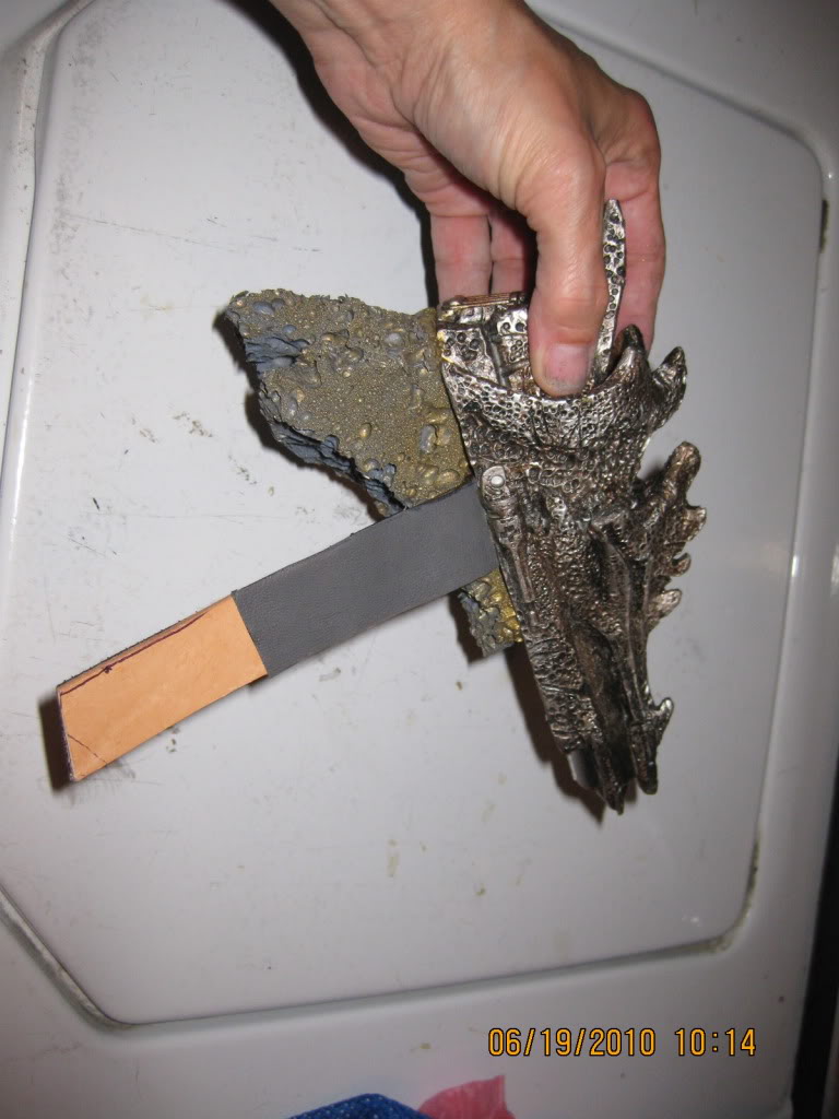

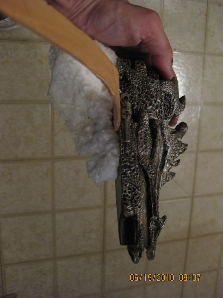

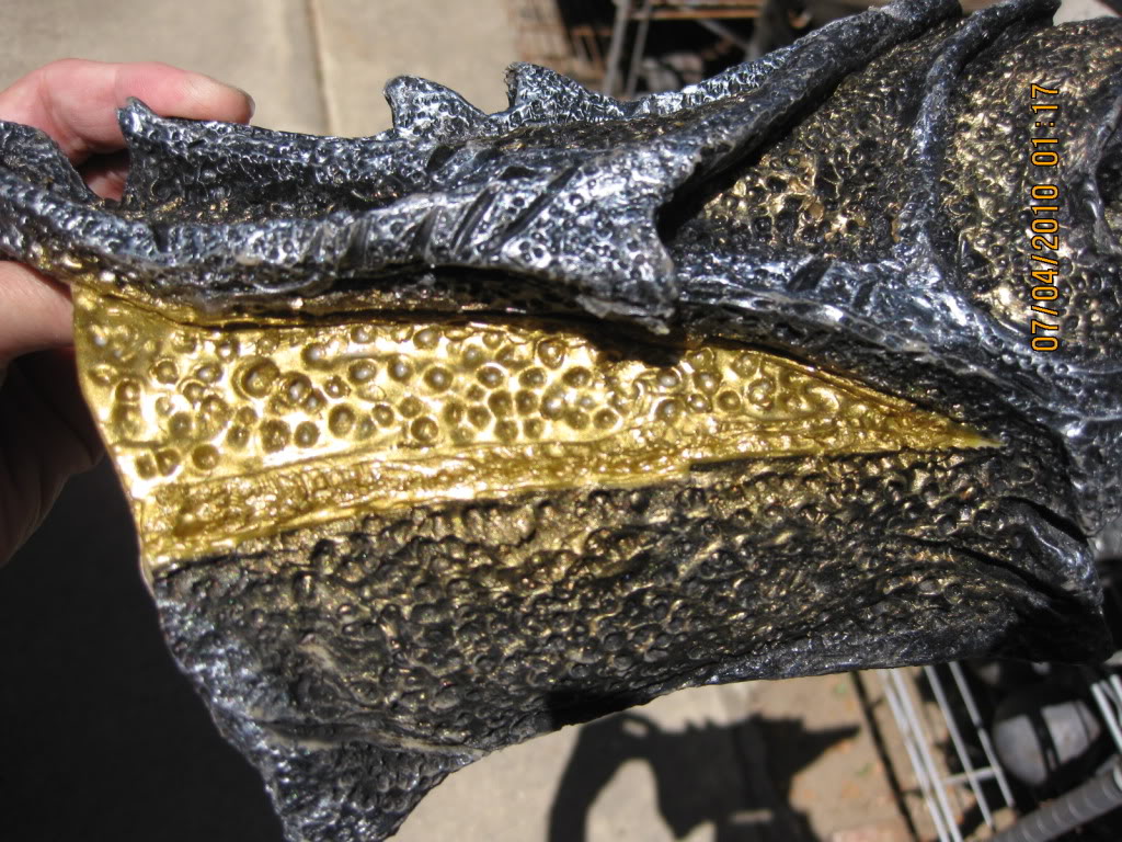

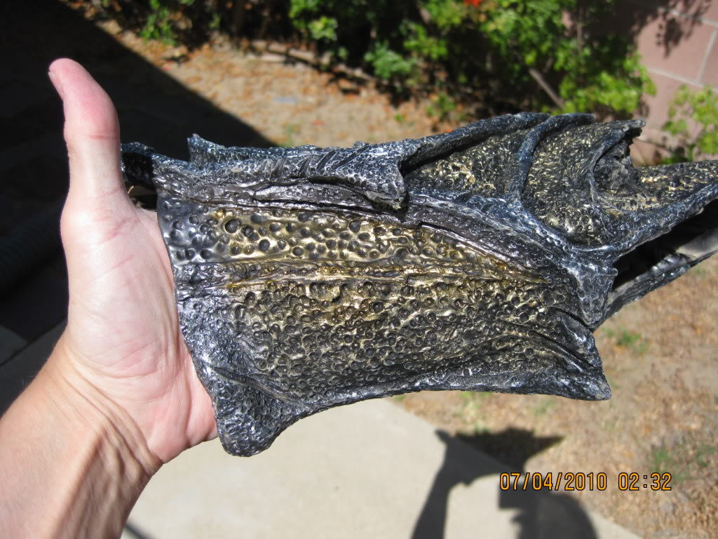

The wristblade gauntlet was a little too small at the forearm, so I had to figure a method of altering it.
I turned to that thin leather and came up with this solution:
Wristblade gauntlet alteration; cut a slot, insert thin leather and mark the wedge- both sides:
Inside view of altered gaunt, leather glued inside:
I filled the new section with latex till it was level with the old latex; paint with gold mixed with prosaide:
Weathered gaunt to match the rest of it:

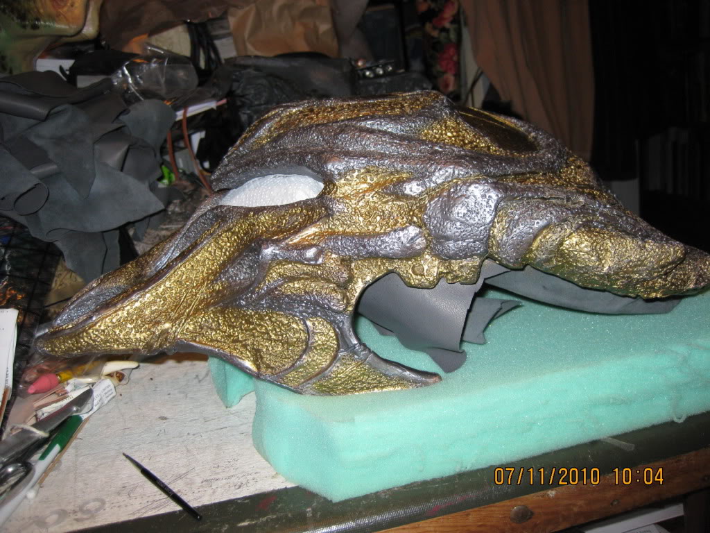

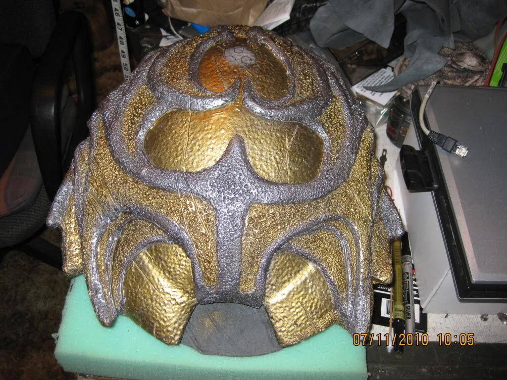

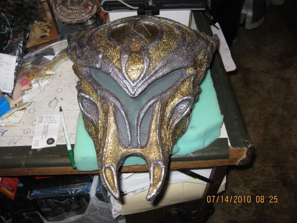

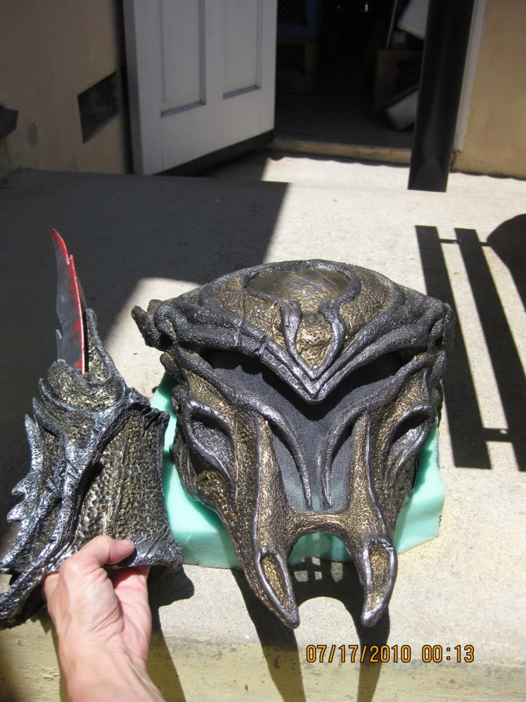

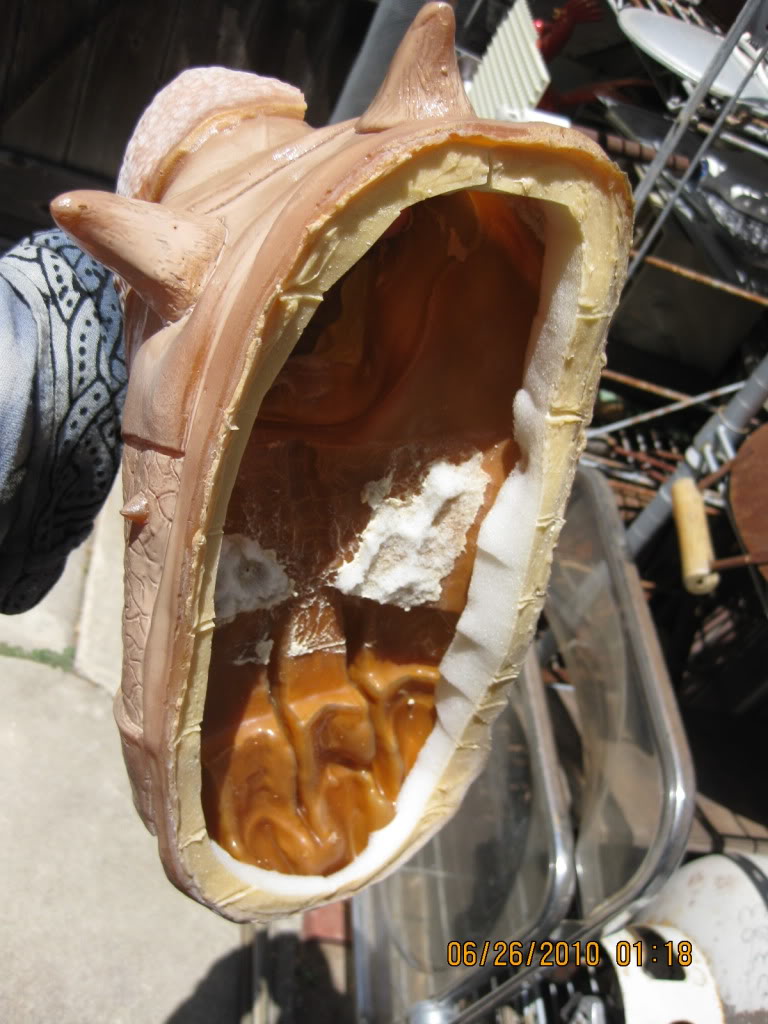

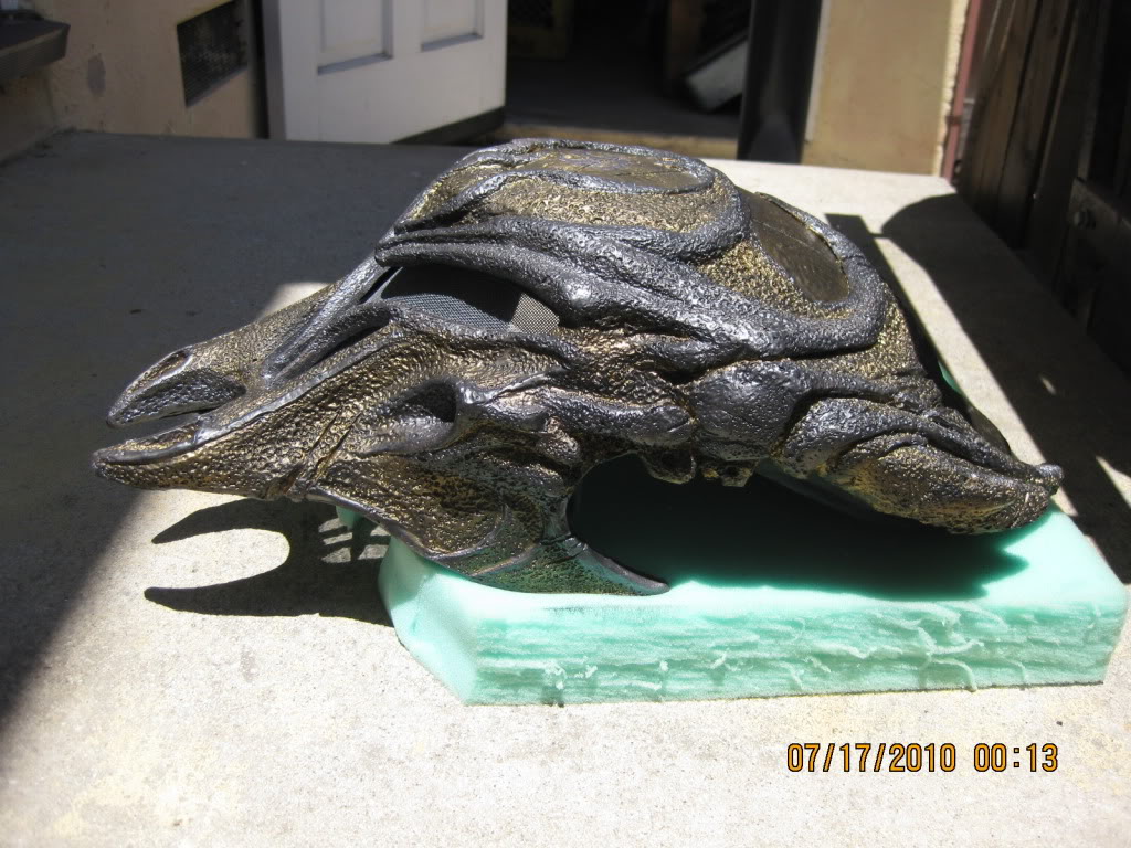

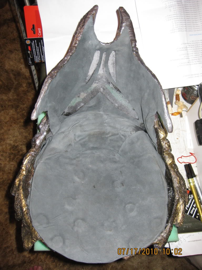

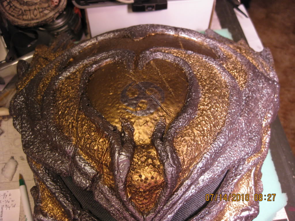

The Bio:

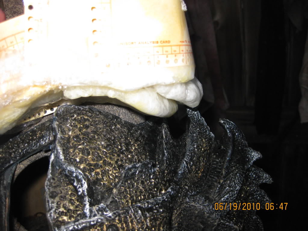

I had to adapt the bio to the existing mask, so that the magnets would align and it would stay on.
I put a foam insert in bio, then a leather layer with magnets, then this liner over all:
Finished bio liner:
Painted bio, side:
Painted bio, back:
Painted bio front; screen out, to get at small areas:
Mesh installed:
Arbitrator logo:

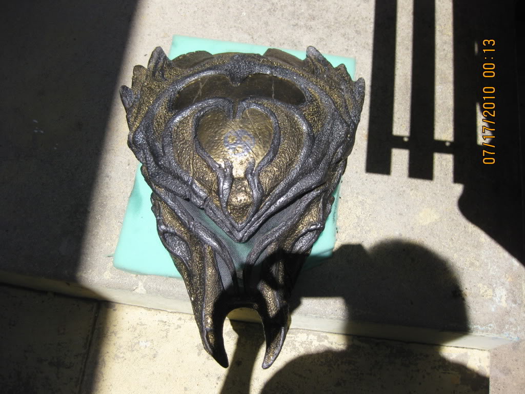

Weathered bio, side view:
Weathered bio, top view:
Blade gaunt and bio match:
