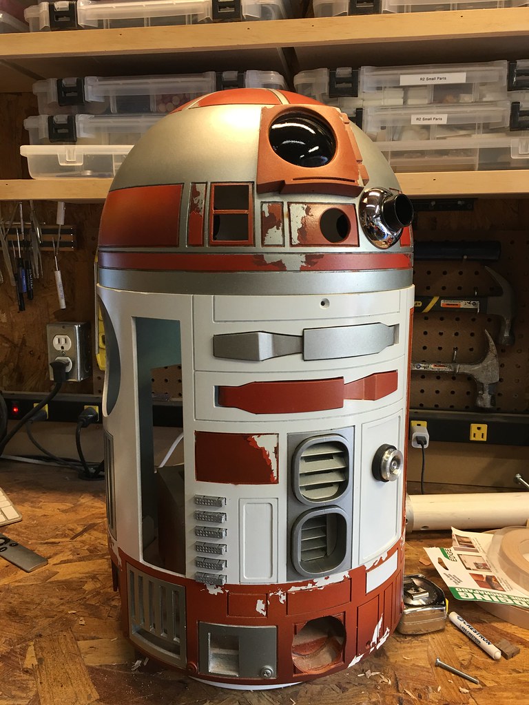

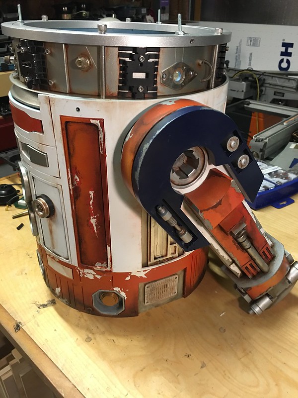

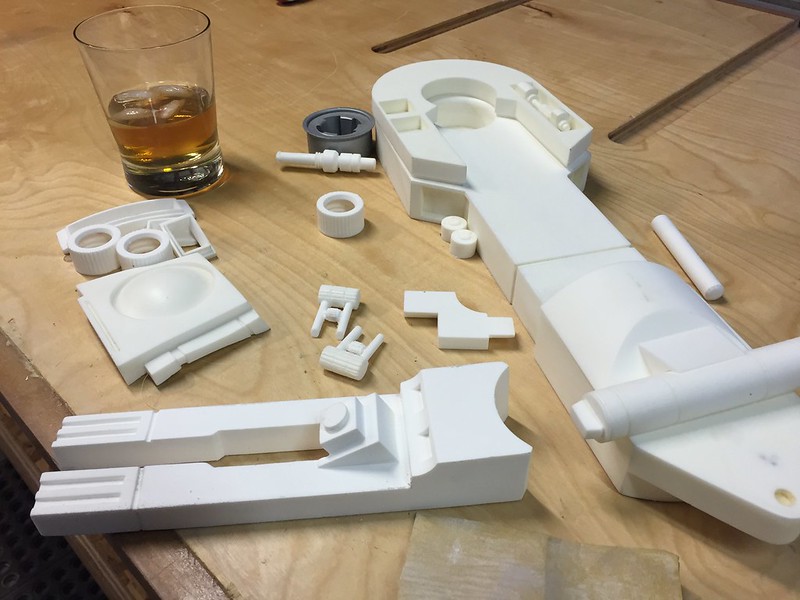

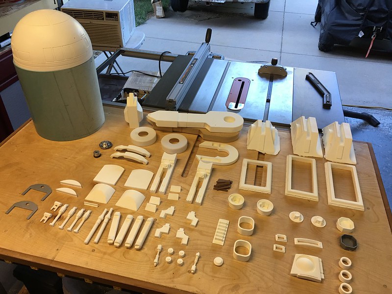

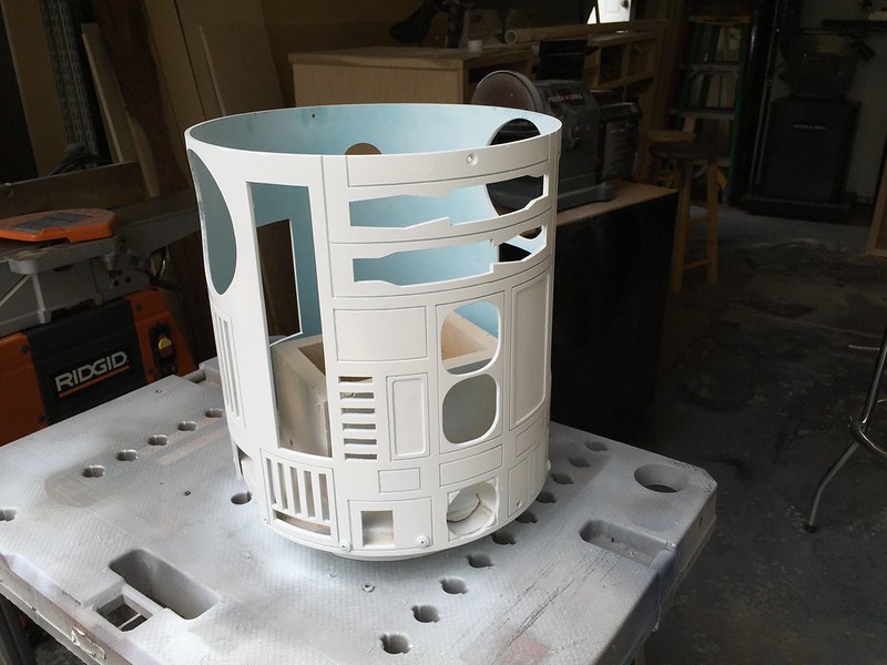

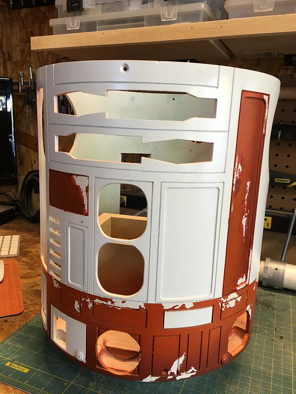

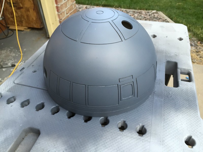

First; you sort all the parts and make sure you have everything you need. You are sure to wash everything in warm soapy water. (yeah yeah, you have to melt the snow, and then wash. Its a real pain, but an important step as the resin parts will need it.)
Then you sand all the parts down. 320 grit sandpaper will get the job done. It leaves the parts smooth and still provides the paint a place to grip.
now don't forget to pour a glass of Jawa juice while sanding and cleaning. This is tedious work and a refreshment is very important!
More sanding and prep and more parts. Yes I see it, the tube has been cut out and routed already. I had one too many Jawa juices and forgot to properly document that step. So sue me, its Hoth, and its damn cold so I forgot!!!:( lets just remember I "found the droid" right? (don't worry, i have reference of that somewhere in the archives I'll find for you all on what we do with the body)

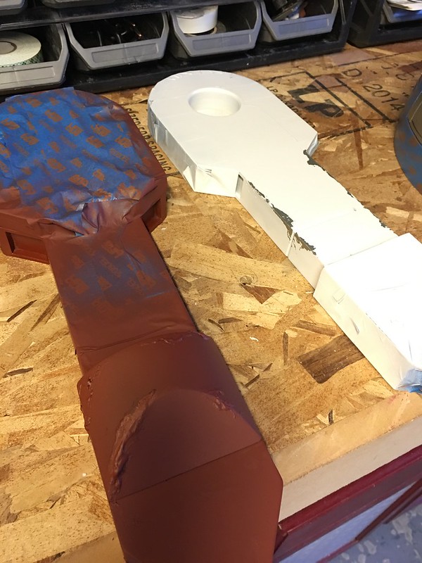

Next up we do a little primer work on some of the parts. Maybe you don't work in a specific order, maybe you get easily distracted, maybe you do what you want . . . get off my back already I'm doing the best I can here!!!!:wacko

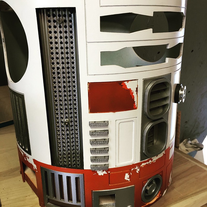

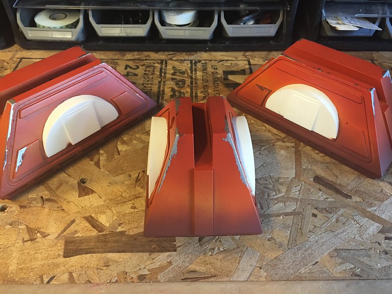

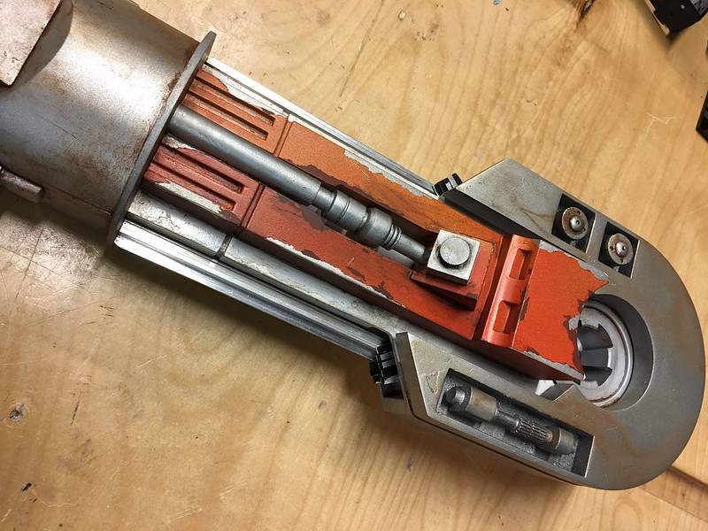

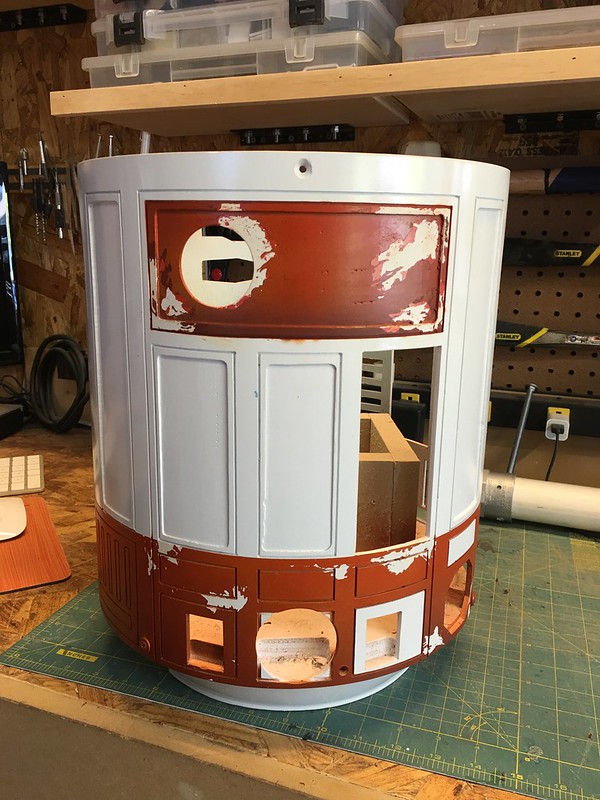

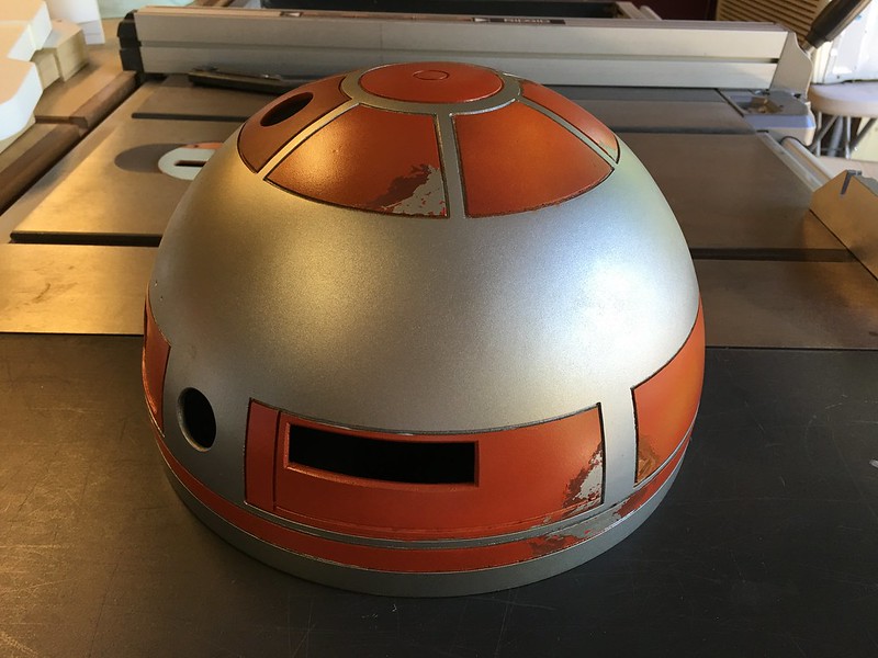

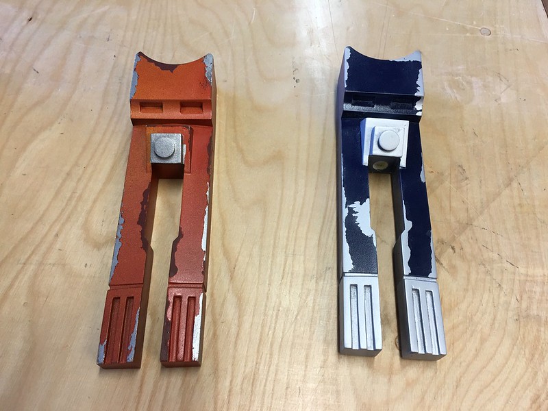

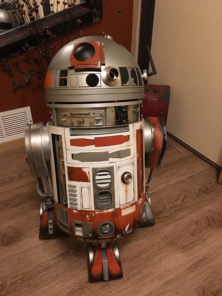

Now on some of the parts you want to recreate the look you found him in. I mean, I know you got all his parts cleaned and a fresh coat of primer on them, but you don't want him to look all pretty do you? This is not a beauty pageant here he need to look rough and worn just like you and your ship. Its a used universe out there after all isn't it!
So what you do is lay down some primer, and then a base coat. Maybe you lay down some silver or metallic spray paint (like Krylong fusion metallic shimmer, looks pretty cool and shines nice.) Then you apply a little rubber cement (the cheap stuff you used to huff as a kid . . . I mean use, use as a kid:unsure) Then you let that sit for a few minutes or even a couple hours. Then you apply another layer of color, and add a bit more rubber cement over the new color)
Let that dry over night, and then just rub away the rubber cement spots . . . instant weathering!!!
The initial weathering technique can be used on all the parts. This one is going to be really beat up, and i get carried away (yep, you guessed it . . . jawa juice) so remember, less is more in most cases, but I'm good with this so far.
Next you are going to repeat this step and this process for all your parts. Tape them off, apply primer, rubber cement the areas you want, layer the paint, dry, and repeat. ***NOTE, let the paint dry completely, you will be tempted to mess with it, but if the paint has not entirely dried you will absolutely end up with a muddy mess! the paint will smear and look goopy, and trust me it will not look weathered it will just appear that you rushed it. I speak from experience:wacko
