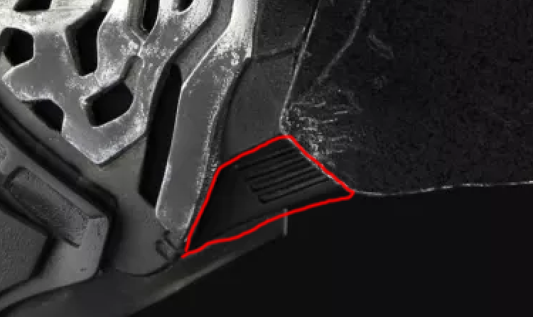

On a different note, for his mod, he is going to try to reproduce this part and wants to use either weather stripping or rubber strips.
Has anyone found a good solution for this apart from just adapting the Disney? He is going to mod his helmet without any heating and bending.
