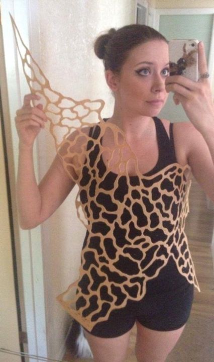

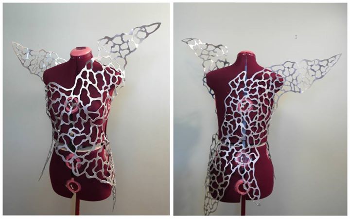

I've started with her....wing?...piece that decorates the front of the gown. The real deal is very thin metal encrusted with gems; but to save weight and keep it in my prop based skill range (I'm a disaster with power tools...) I've opted for a worbla base.:
So far it's given me the right base shape once heat formed and has the same flex and movement the piece does in the movie.

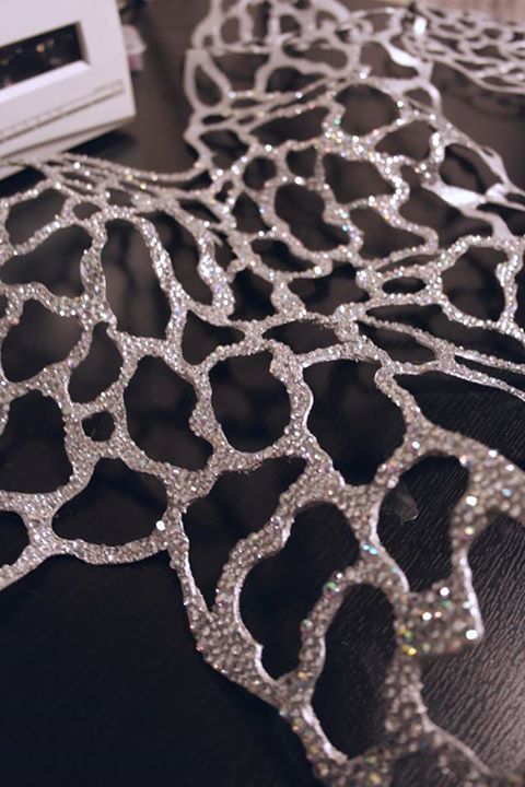

Currently in the process of covering it in rhinestones. Still have literally thousands to go, but it's at least an easy task to marathon watch series too as you do it.

Small progress, nearing half way mark of rhinestone application; on my third tube of E6000.....I ordered around 21,000 rhinestones of various sizes for this, and am just a little over half way through them; so my final count will be around 15,000 stones is my guess.
Starting work on the hoop this week, all the math is done and double checked, and materials acquired.
Done the wing, only have a small handful of stones left; so probably finished with around 20,000 rhinestones on this and went through about 5 and 1/2 tubes of E6000. Now onto the monster work that is the gown. Photo's don't do the rhinestone attacked nature of it justice, so happy with my sparkle beastie <3 <3

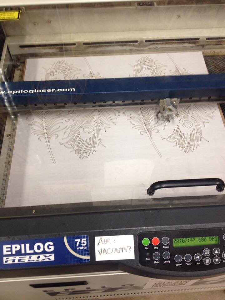

Found someone one who knew how to use and had access to a laser cutter! So I spent last night at the studio with their aid cutting out tons of fabric feathers for the bodice of the gown
10929207_707922205994165_9197804040963451061_n.jpg10881607_700493833403669_8230165664227209776_n.jpg

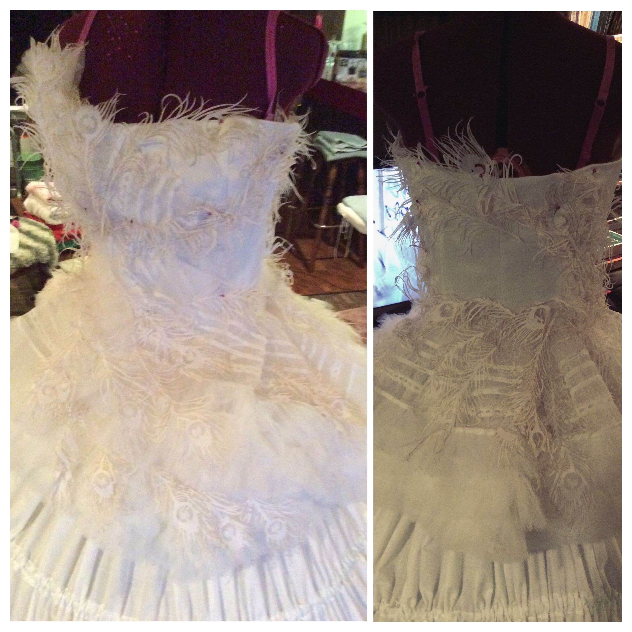

Lots outs of draping and hand sewing later but my bodice is done aside from a few weeks! Now comes the big push to finish detailing my skirt fabrics and then draping and sewing it. Wish me luck!

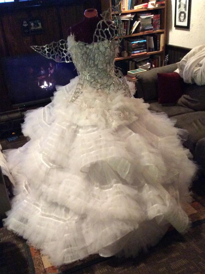

Next update after this will be a PHOTO OF THE FINISHED DRESS OMG GUYS I’M NEARLY THERE. Also have a few shoots booked at the con, so a few weeks after Katsu I should have some nice photos of both the dress and me wearing it :3After getting more tulle ruffles on I did a test drape quickly again to see if going for the screen accurate number of tulle ruffles would over-whelm it; consensus was that it would; more tulle would just swallow the silhouette. currently sewing the last of the flat lace and ribbon lines on, then will drape it all nice and carefully for real; and hand sew the skirt down.
Second picture is to show scale of the beast head on…I’m laying horizontally under it…that’s all of me that shows when I do…and I’m 5’10.​
