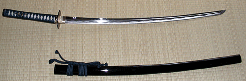

I am building a couple of katanas for a cosplay, just a regular plain set of katanas out of plywood. I am just going to cut it out, shave it down to a blunt edge and make a tsuba out of pvc. Problem is, i want the katana to have a good finish, so it looks like a real or atleast close katana. I have spray paint, but the effect it produces is somewhat like this -->
6a00df3520a4fb88330105371d5be3970b-300wi
rather than more metallic. I was thinking of using this as a base coat, then applying aluminum foil on the top of it like-->
But when I did a test run, i could not get it nearly as smooth as this guy did, always leaving streaks no matter what i tried. Can someone either suggest a better way to achieve a realistic katana with a hamon or way to get the foil this smooth?

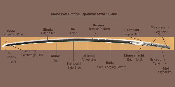

Not really sure what you mean by "black bands"... the only thing I can think that might be mistaken for bands would be the bo-hi, what some people incorrectly call a 'blood groove', but that is actually a recessed area in the blade designed to lighten it while minimizing loss of strength.
Maybe this: http://www.shinmyoken-phoenix.co.uk/PC-sword-parts-600px.png will help you figure out which part you're talking about.

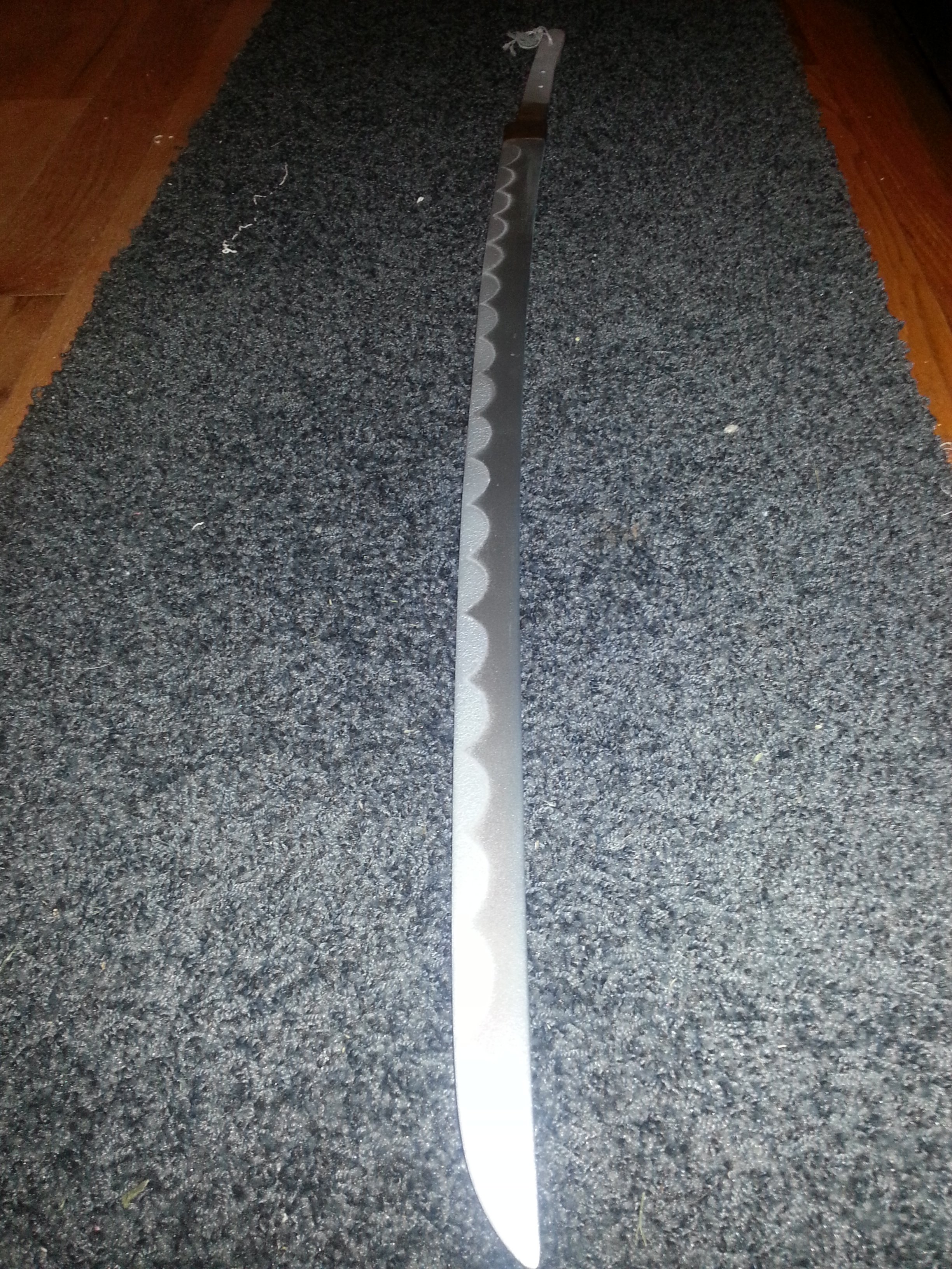

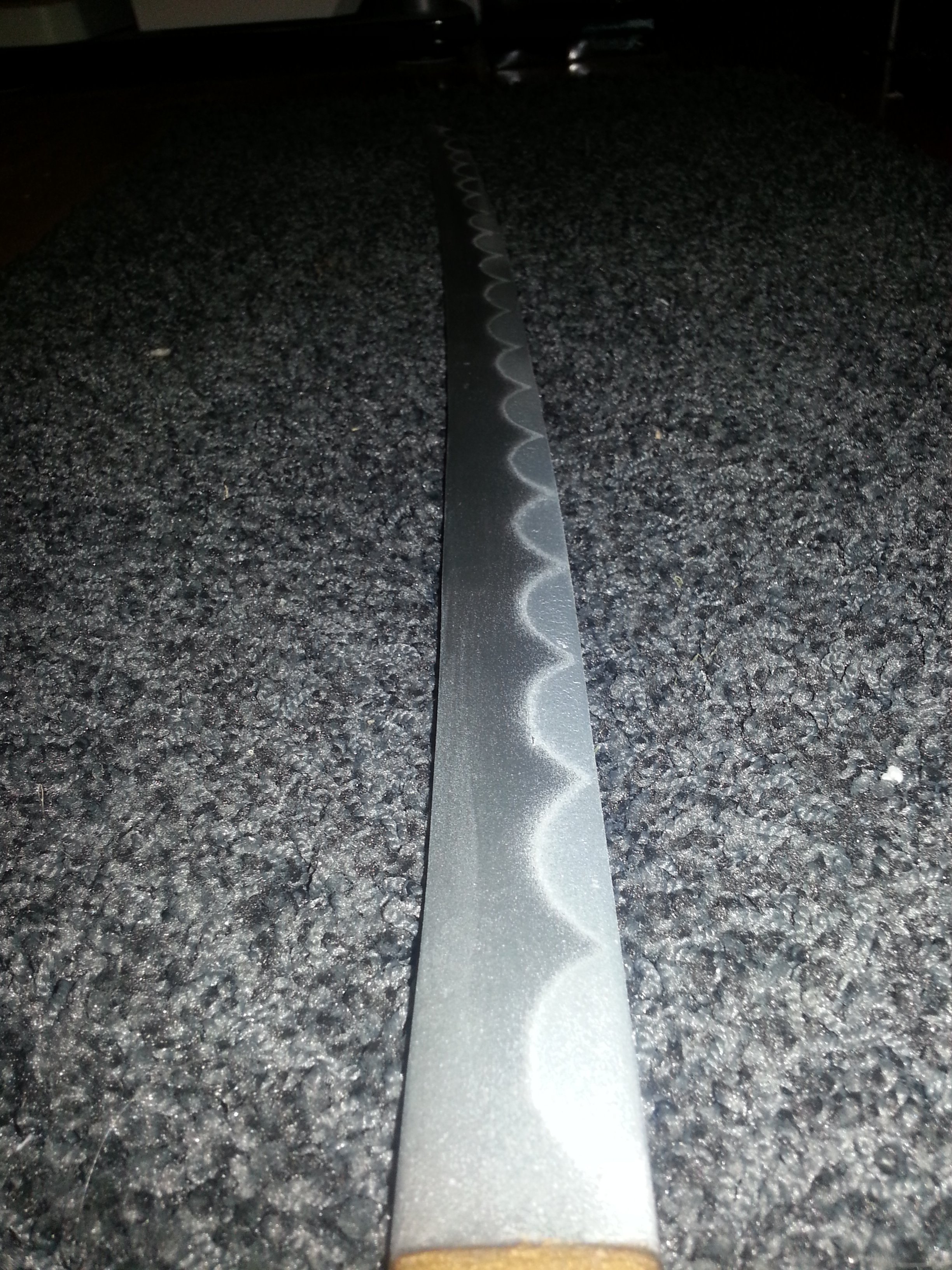

I don't think that those blades have a hi carved into them, but it's difficult to tell for certain. I think what you're seeing as a band is really just the way the light is reflecting off of a part of the blade that has been differently tempered. If you want to try to recreate that light diffusing effect I'd still recommend experimenting with the way various clear coats effect metallic paint finishes. Just as an example this is the fake hamon on the blade I'm making for my Yamato using the afore mentioned method:
This was with a matte clear, I'm sure you could use a gloss or satin in a mask along the shinogi to get a different diffusion effect. I'd test it on some scrap first however to see if it's what you're looking for. Airbrushing some very diluted black along the spine might also give you the differentiation that you're looking for.

Thanks, I'm fairly happy with it; though this is the 6th time I've repainted it. If I were to do it again however I'd make the pattern a bit wider and more irregular, I'd also pull it back from the blade edge a bit.
Most craft and hobby stores in the US sell metal powders, if they ship internationally Smooth-On also sells them in larger quantities.
Normally I use either shellac, polyurethane, or simple rattle can clear depending on the project and how each finish will react to the type of paint it will be protecting. I've never taken much stock in brands, but that paint job is done with Rustoleum Brilliant Silver and Matte Clear. I don't do any kind of roll playing or masquerade so my props generally don't see that much convention wear.
Correct, if I were to spray on more clear the effect would cover the entire blade area and the 'hamon' would be lost. For this project, which will see some wear from drawing and sheathing the blade, I'll either pick up some Pledge/Future floor wax, which has a good reputation for not dulling metallic shines. Or I may try some automotive wax to see how that works.
