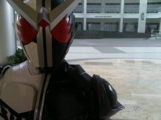

Kamen Rider Ryuki/ Dragon Knight low budget... :P

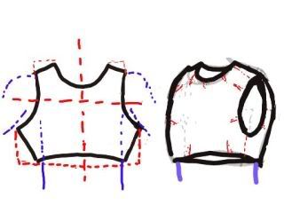

I sort of have an idea how to do it in a vest type form.
the problem was he won`t given any chance to gave it to me bro :(
well, actually he done it with a body manequin, or you can try this method, there`s many site in i-net that help us to get a body measurement bro, how to get a specific ways to making a vest or bodysuit, like i said, why don`t you try to show your idea first, sketch maybe?
but i`ll try to makes a rough template for you next time
as my promise, hopes this thing can help you out

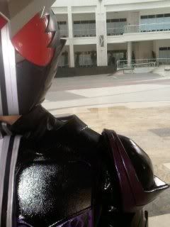

and here`s the simple method to make the neck, cause usually some of my friend stuck with this part
after the armor done in one pieces(back and row and glued), you see, there`s a space for the neck, in fang joker armour, it has a W shape, simply cut the paper with circular shape like the neck, and then get the paper tapped in the neck, grab the pen and makes a small sketch in between the edge of the paper and the neck`s armour
release the paper and...now you get the perfect pattern of your armour`s neck :)
hello guys, some update of my latest works, well because the fang costume is commision for my friends, i can`t get proper pic of this suit
and yes, the helmet is made from resin and fiber, perfectlly done by my other pall

with the W neck line was it done as a seperate piece? did you make the neck in parts cover with the vinyl then stick each bit together? or did you make the whole theng then cover it in the black and white vinyl?
^i heard of it, just dont know where to purchase though it would be really neat if i could , i dont really get how resin and fiber work, i mean did he mold it or something?
usually people sold it in fabric shop, that selling a stuff for making a sofa
yes,it done with separated pieces to get a separated looks
