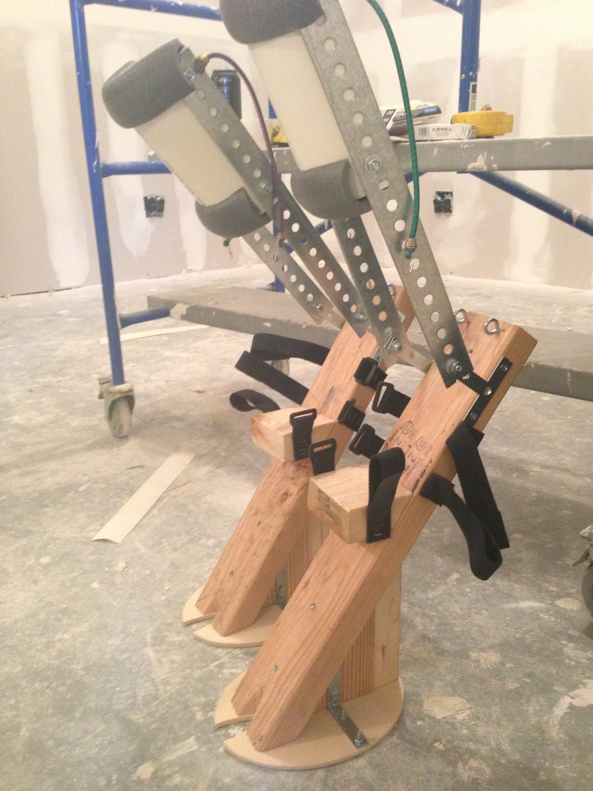

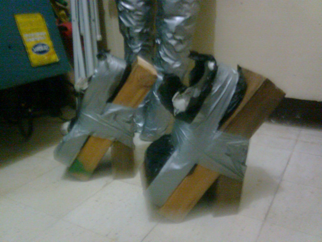

Dave, just a quick question, as we are building more or less the same raptor type suit I would just like to ask if you will be wearing stilts or as your drawings suggests, you are planning to have your feet protruding through the raptor feet just below the raptor's ankle level? I had originally designed a pair of short stilts having had the impression that Rosengrant wore those based on the pics and vid.
content_jurassic-park-raptor-suit-stan-winston-studio-archival-photo-dinosaur-practical-effects-.jpgcontent_jurassic-park-raptor-suit-stan-winston-studio-archival-photo-dinosaur-practical-effects-.jpgcontent_jurassic-park-raptor-suit-blog-8.jpg
However when I tried mine on
I was thrown into a world of ankle, knee and back pain not to mention that torture that every step took. My wife said it’s because they’re too short. Well that was the way I planned them as I did not want to end up using a pair of digitigrades (like the hoof type picture here) stilts because they would make the raptor legs too long. Day4.JPG
Any thoughts or suggestions?
View attachment 220948View attachment 220950View attachment 220951
I was thrown into a world of ankle, knee and back pain not to mention that torture that every step took. My wife said it’s because they’re too short. Well that was the way I planned them as I did not want to end up using a pair of digitigrades (like the hoof type picture here) stilts because they would make the raptor legs too long. View attachment 220949
On this picture View attachment 220950 it looks to me that the guy is wearing digilegs like another RPF member did when building The Wolfman costume (Link to thread).
If you ask me, it looks pretty similar.
Well, I'm glad to see somebody else was able to provide you with some suggestions. I am NOT planning on wearing any sort of stilts. I'm in the middle of working on the feet now. I'll post some pics when I get a chance, but basically, the claw-area of the feet will be flat, but then the foot takes a sudden 30 degree upward tilt. I will be putting my feet THROUGH this piece, with a shoe being attached underneath that 30 degree angle. So, if people look closely, they'll see the back of my foot. But after another 12-15 inches, that 30 angle will suddenly bend back forward, giving the illusion of short digitigrade legs.
If I were 20 years younger...and perhaps had a bit more time... I might have tried the digitigrade stilts method. But I'm 45 and too out-of-shape. And I'm the sole bread-winner in my household. Sure, insurance would cover accidents, but why risk it when I don't have to?
