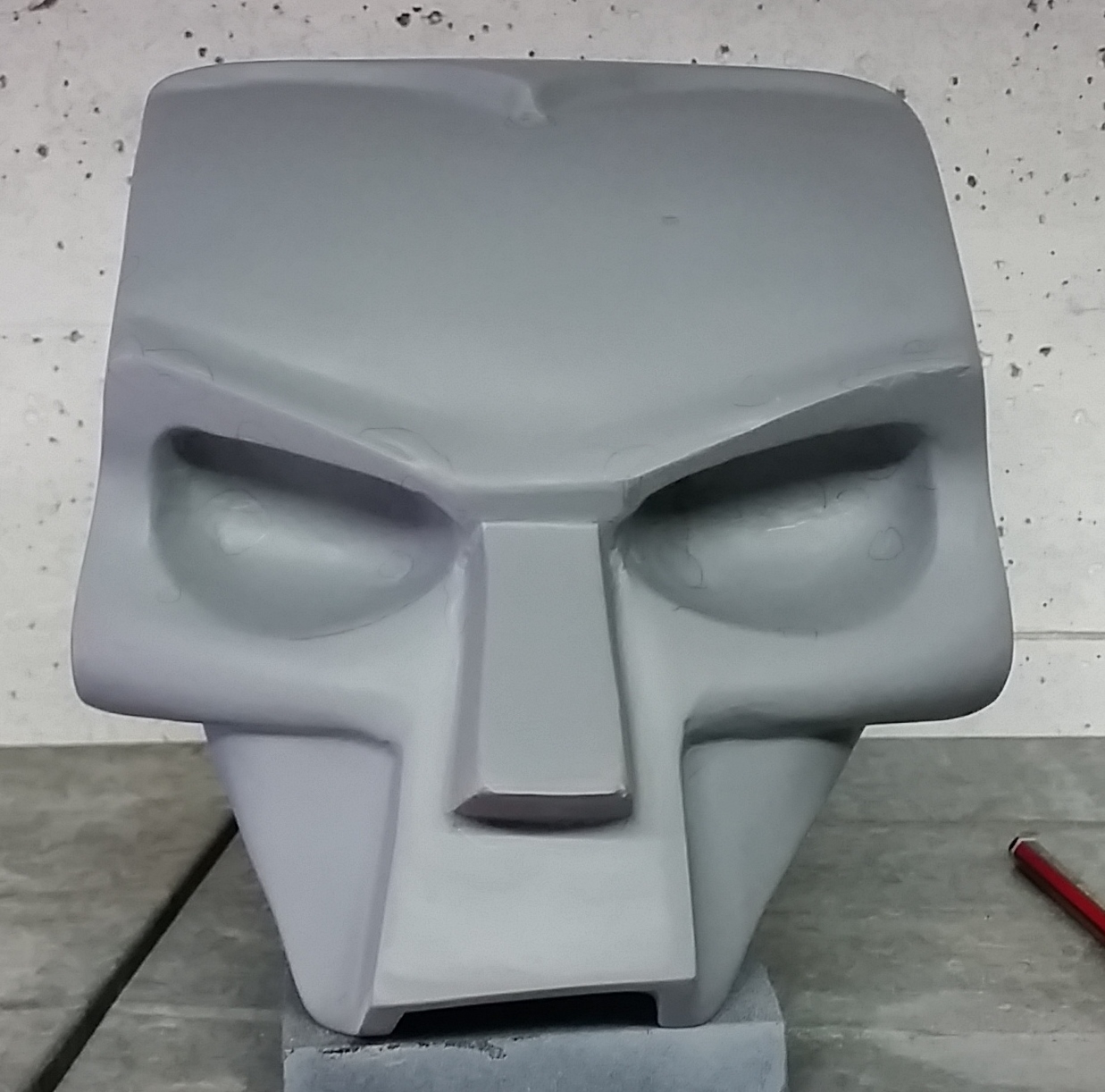

Small WIP. This will end up being my build thread I guess rather than starting another one. Started the slow labourious process of smoothing the head out. I've got a few adjustments to make including the eye shape which is a bit flat at the bottom of the head and the brow which I can't quite get right yet. I think I might need to shift the eyebrows a bit and of course each change affects the other elements of the eyes. Still its a fun project glad to be tackling a part of the robot that I can actually finish
Nice one, Oota! The glare is coming along nicely and the eye sockets have a really deep, intimidating appearance.
Bit more on this. Still haven't quite got the eyes where I want them yet but a lot closer. The one on the left is a bit angular at the bottom. At the brow need s to come forward a bit. Otherwise I'm nearly at spot putty time ya hoo!
Not a hell of a lot to see round the back at this stage. I've mucked about with the brow again and the eyes a bit more, still stuffing around trying to get it to look right. It looks good with the lower jaw

That is looking really impressive now. When the glowing eyes are set in place, it will really have a sinister expression.
Are you going to sculpt in the bulge on the bottom side just behind the front teeth?
Cheers Blax. Yeah I've got the piece of mdf ready to go for when I've finished up the main body. I think the brow might be slightly more arched than the real one but I think it's close enough :)

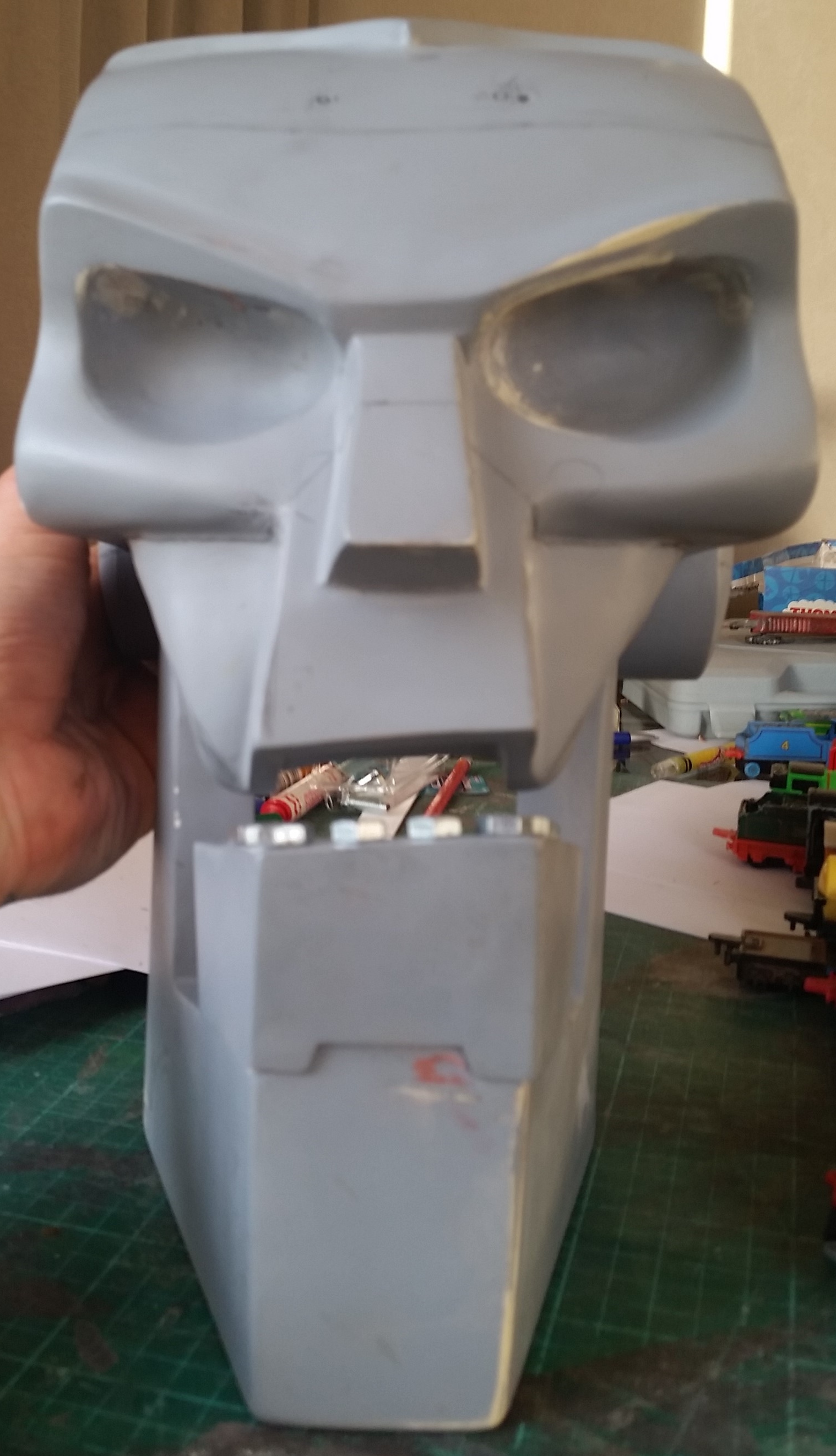

ok here's the jaw pretty much ready to go just need to find some bolts for the teeth. I'm figuring a 6mm or 7mm bolt head should do.
Having trouble getting the camera on my phone to focus must be something about to do with the light or something

a few more blurry WIP pics. Got the bulge-thing under the head done. Not sure if I got it quite right it's close but I might need t make it a bit thinner. I've taped it under the head so it will be easy to adjust after I've put the pistons in.

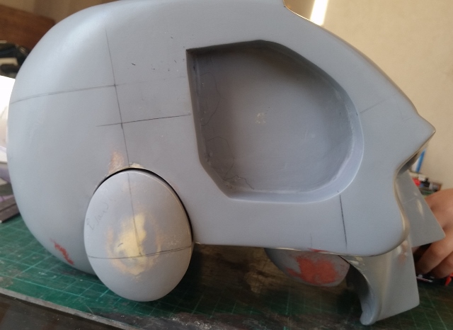

I finished the ears too but everything looks a bit weird as I've not done the detail lines yet. The ears look too big at the moment but again I think I'm close to where it needs to be

Spot on! Ears look to be the right size, and the robo-epiglottis makes it look complete. Regretting not doing it on my build now.
