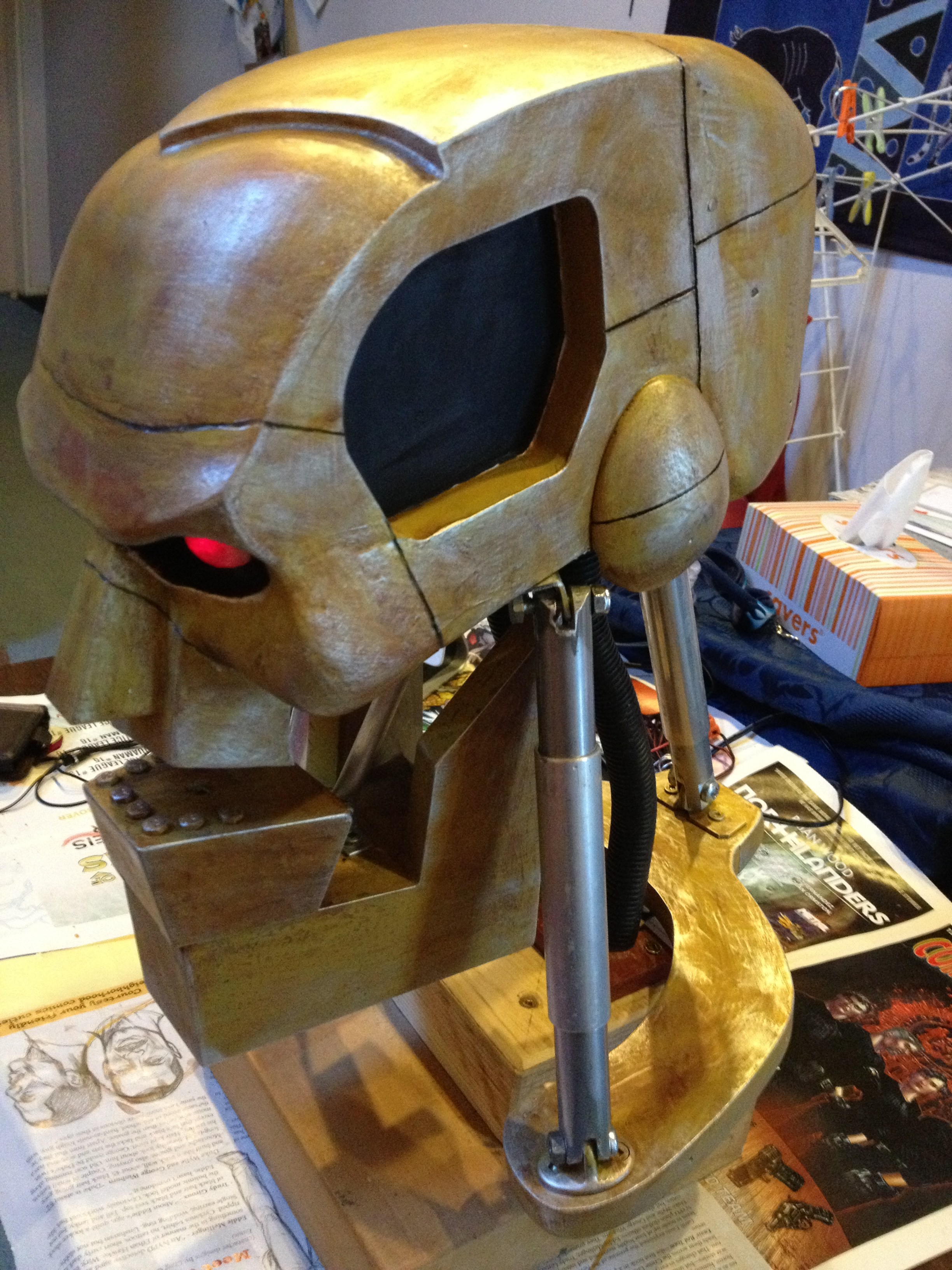

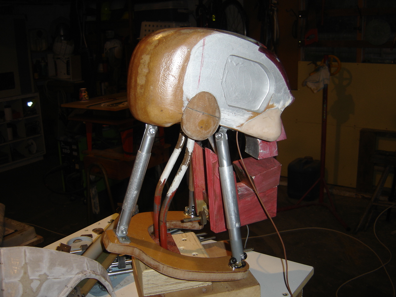

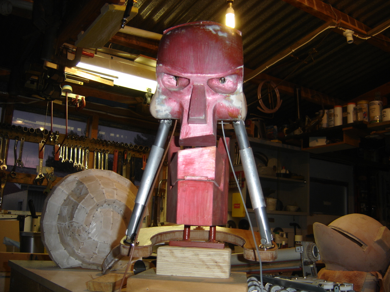

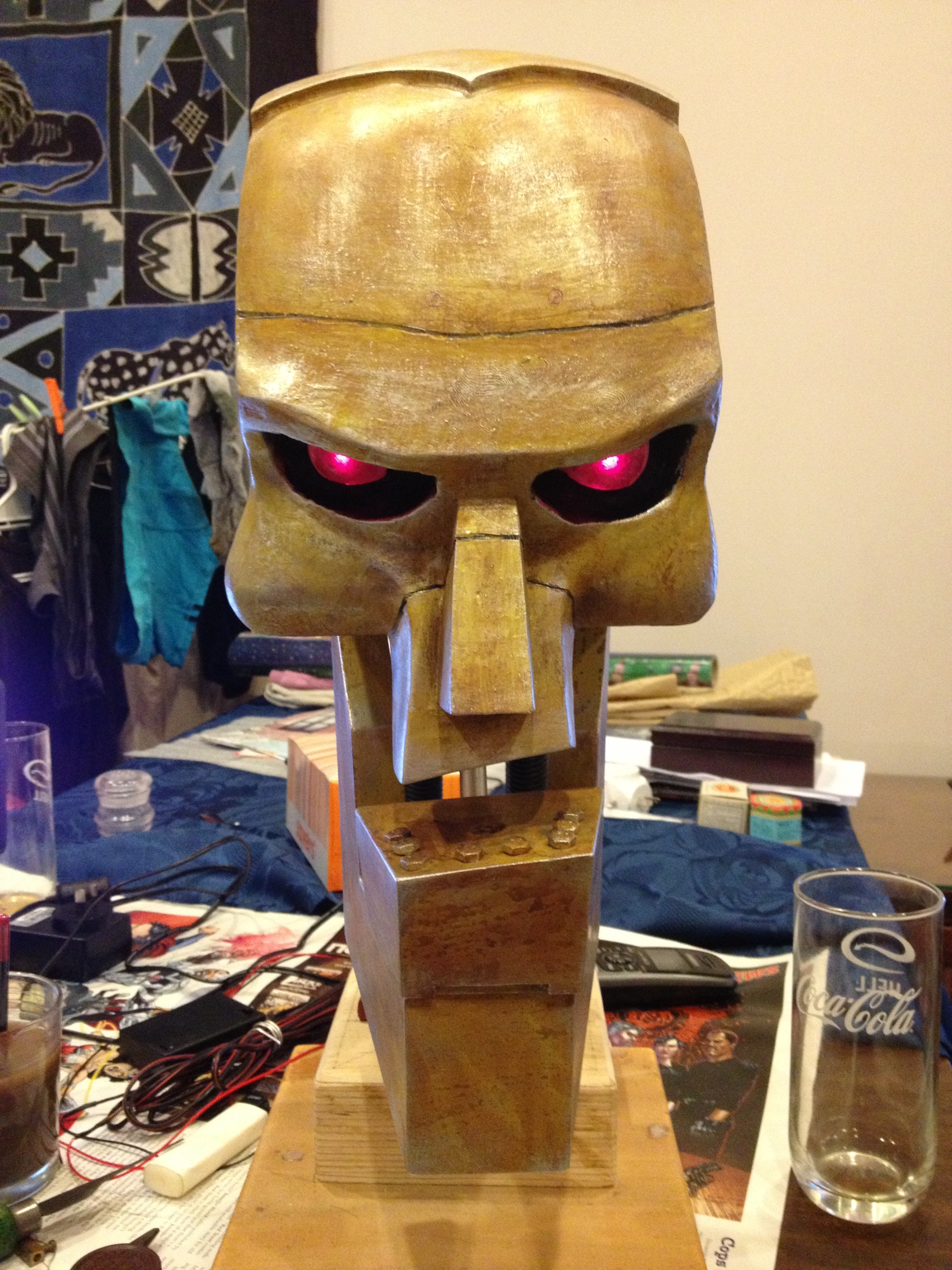

Yep, it's one of the older threads that's still getting new info added. Here's a couple of pics of my scratch built ABC head. It's in my son's shop in Wellington at the moment. The eyes are wired with red LED's.
DSC03810.JPGDSC03811.JPGDSC03812.JPGDSC03813.JPGHammerstein_24_Dec_2012.jpgIMG_2957.JPGIMG_2959.JPGIMG_2960.JPG
Crikey, I was just thinking about how long this project took. I drew the profile by pausing a VHS video tape, then drawing with felt marker on some plastic stretched over the front of the tv set. Then it joined the horde of half-finished projects in the shed for a few years before it got resurrected.
Hey, Oot, thanks for jogging my memory on this! :)
Cheers Blax that's a nice head you made! Clever way of getting dimensions for the head. It's a lot easier now thanks to the awesome photos from Art Andrews and Vince Vader, and dimensions from Zorg (thanks to both!).

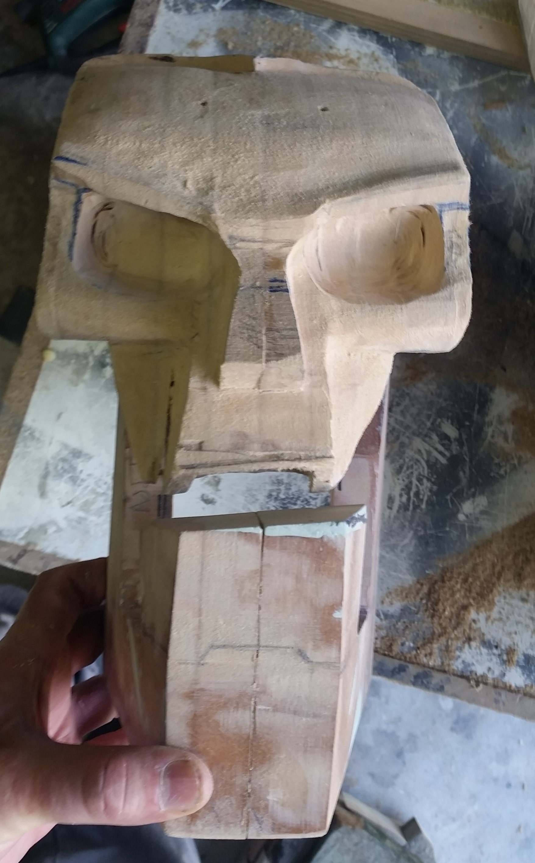

Here's a WIP of my ABC head still got a loooong way to go
Nice work! Looking forward to getting up your way to check it out!
Cool! I forgot to mention in my post that I am using (stealing) your method for building up the head: layers of 18mm mdf covered in polyester. The lines in the mdf are useful for keeping symmetry so nice one Blaxmyth cheers :)
I found that when I was in the carving phase, that sanding sealer was great for holding the fibres in place and stopping the MDF going all furry on the end grain. The sanding sealer was easier to cut back with some coarse sand paper, but the polyester was better for forming a really tough outer coat when the main shape was roughed out.
It's a nice technique the polyester does sand up very well. I've got a lot of bogging and sanding to do but I'm pretty happy with the overall shape of the head. I'm thinking about molding it at some stage so I'm going to leave the ears and the temple plates removeable. I like the idea of adding in some electronics (eventually)
