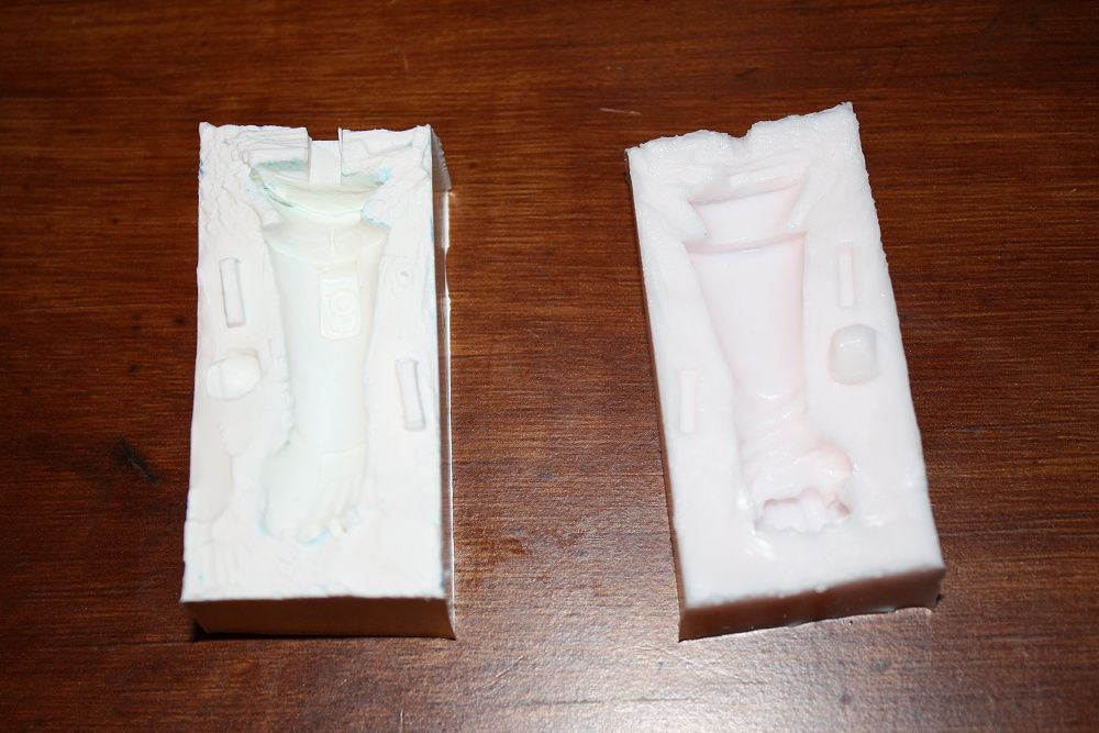

I've finally gotten somewhere with this. After messing around with the silicone and testing I finally cast my first part:
Bottom part of the mold done

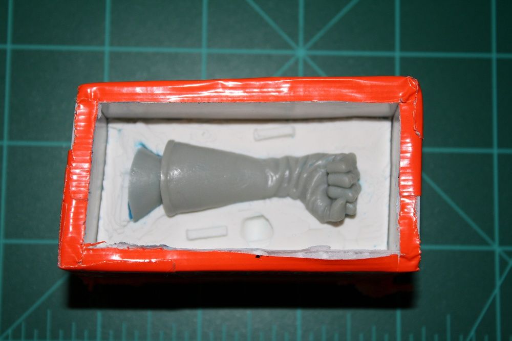

Removing the box from around the molds
I ended up using two different kinds of silicone to make the complete mold.

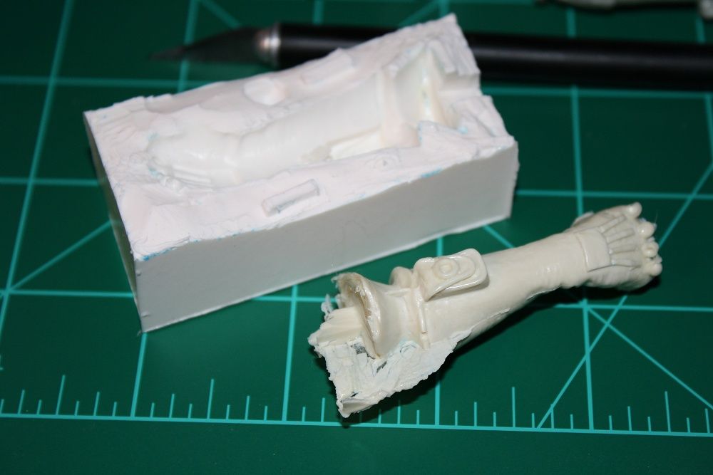

And the final product
It's far from perfect but its also a far cry better than trying to sculpt from scratch!
Huzzzah!!
Very nice, but everything above the main model where the vinyl pour sprout is, is basically wasted silicone and resin. Just have the mold stop at the original pour sprout - it also gives you a wider opening to pour the resin into and makes trapped air easier to escape. :thumbsup
