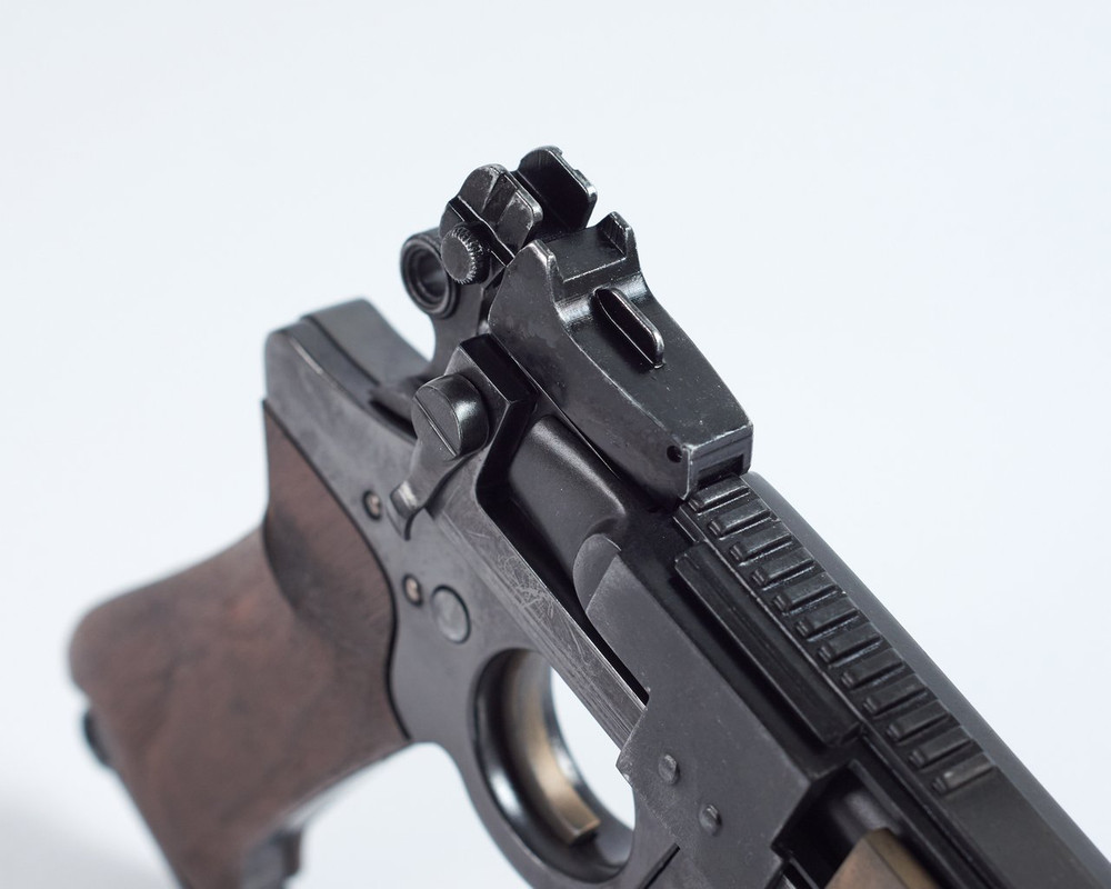

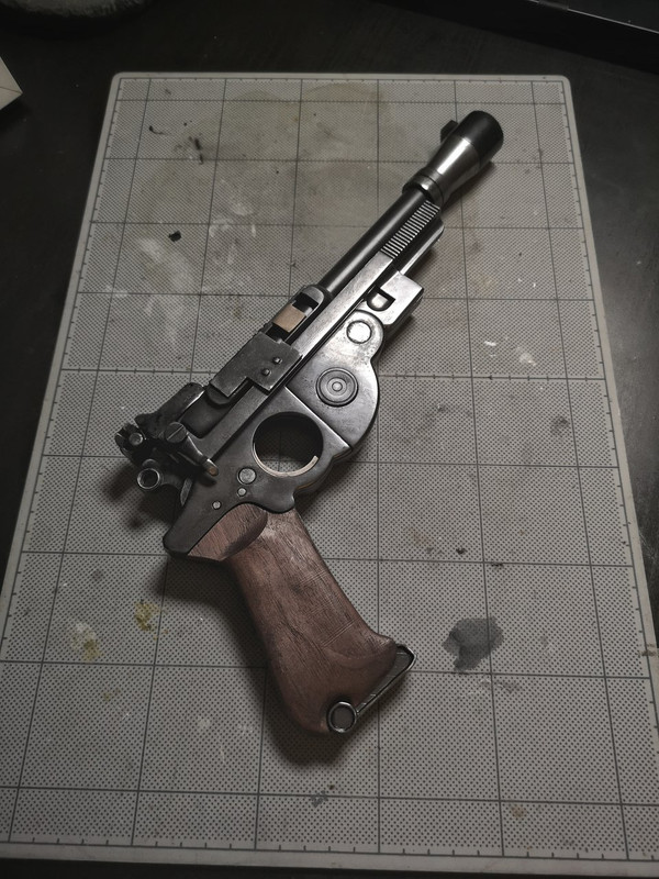

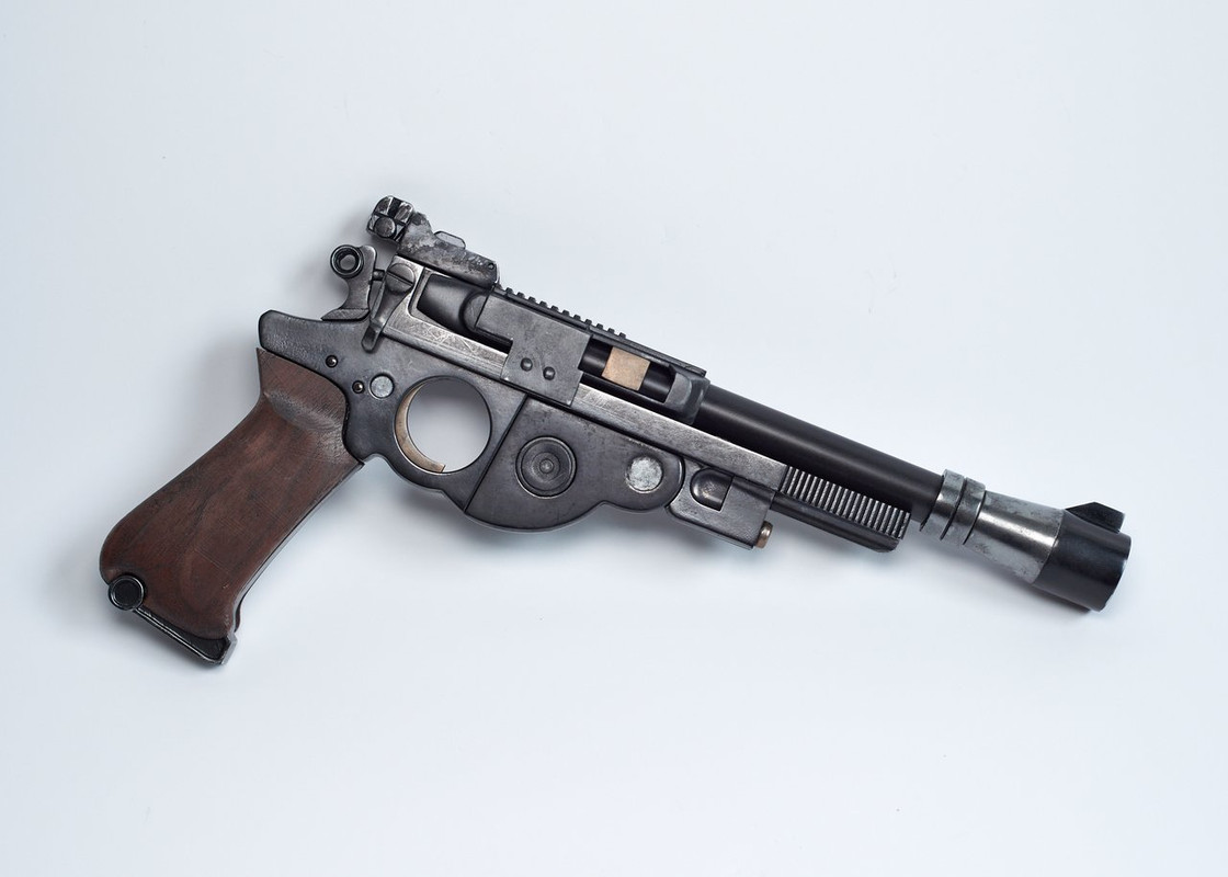

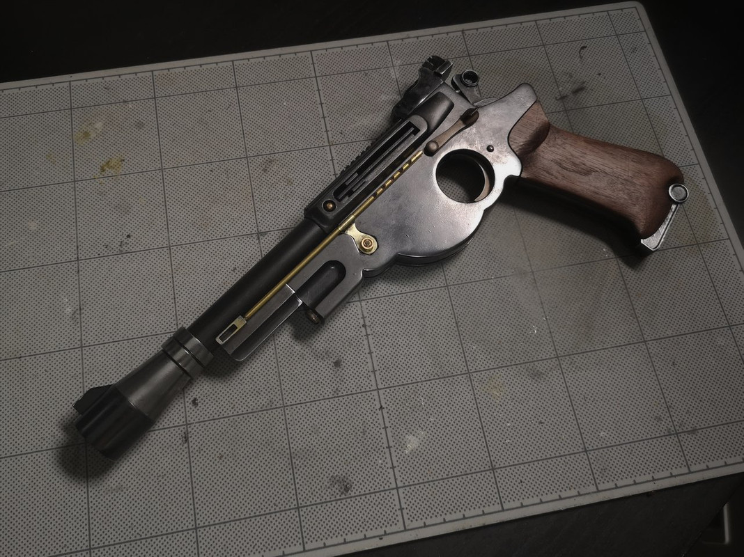

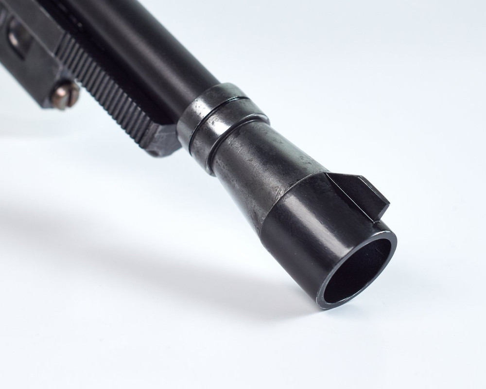

Ever since teaser photos and videos of The Mandalorian were released, I knew I had to build this blaster. Loads of 3D files and kits popped up even before the series premiered but I decided to wait for accurate kits/files to emerge. When JOATRASH FX announced he was working on his kit, I jumped in blindfolded and hands tied behind my back. His attention to accuracies and details is well known so I know this blaster is going to be kickass! And boy he sure didn't disappoint. Here's his run thread in case you're interested LINK

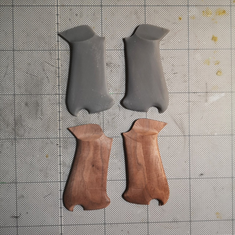

I got walnut grips from justinrowan that were crafted exclusively for this kit.

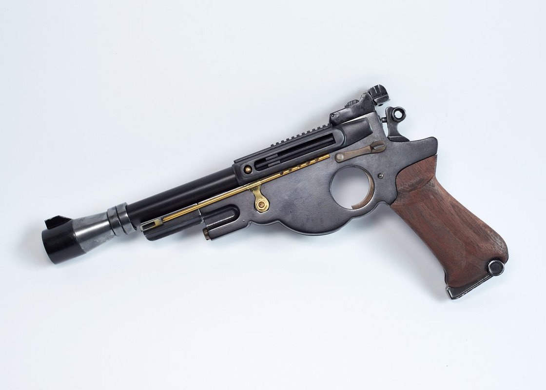

To replicate the patina on a well-used steel gun, I sanded the gun frames to a smooth finish, concluding by wetsanding with 2000 grit paper. They are spray painted gloss black and let dry for 24 hours. I rubbed graphite powder thoroughly onto them and dabbed heavily thinned flat black acrylic ( I used AK Interactive) over with a soaked cotton ball. The graphite powder somewhat repels the paint, resulting in a faux patina effect that I like. Again, I let this dry for at least 24 hours. No clear or top coat is required.

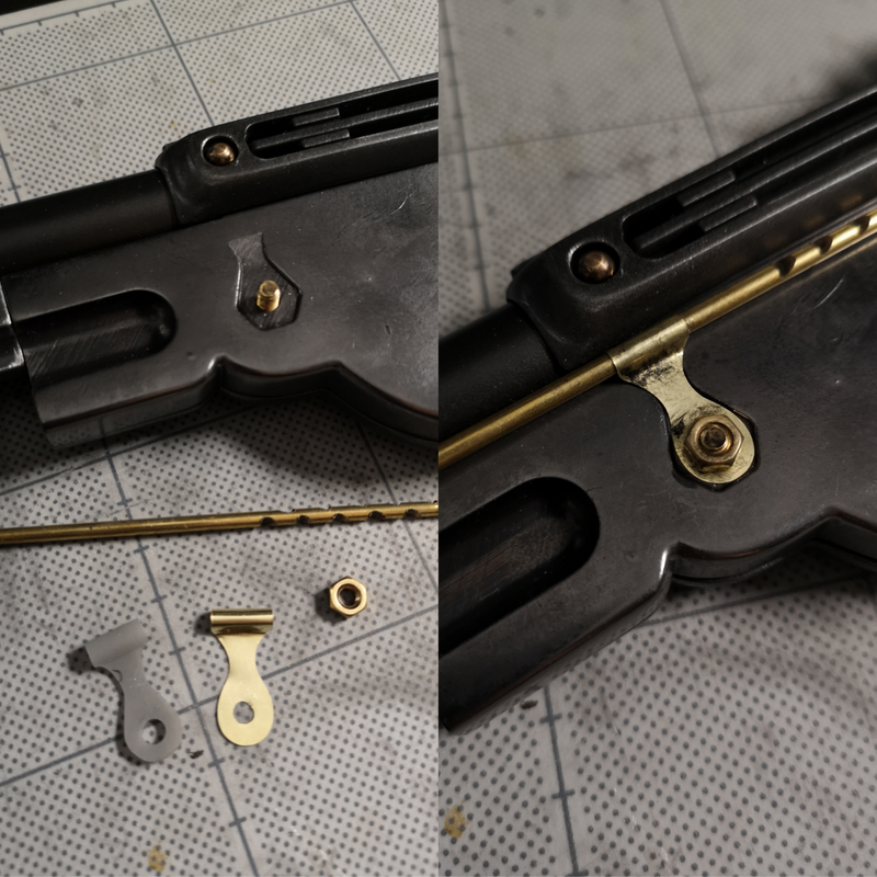

Other modifications I made to the kit; used leather craft rivets for the pins on the gun frame

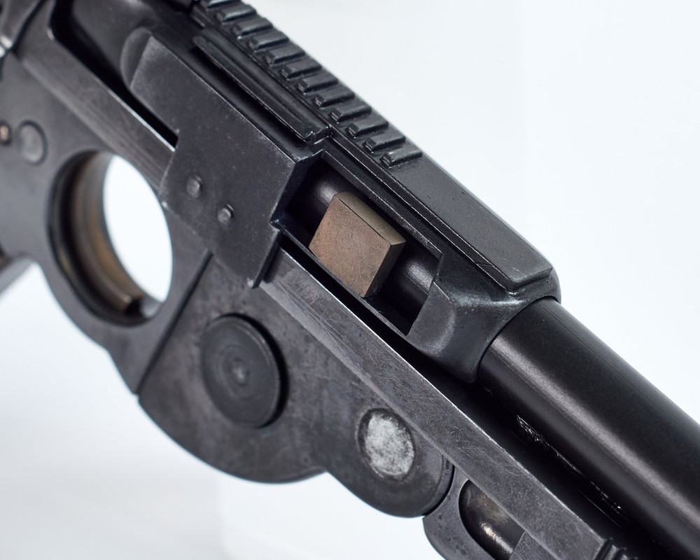

Real hex nut for the hammer strike

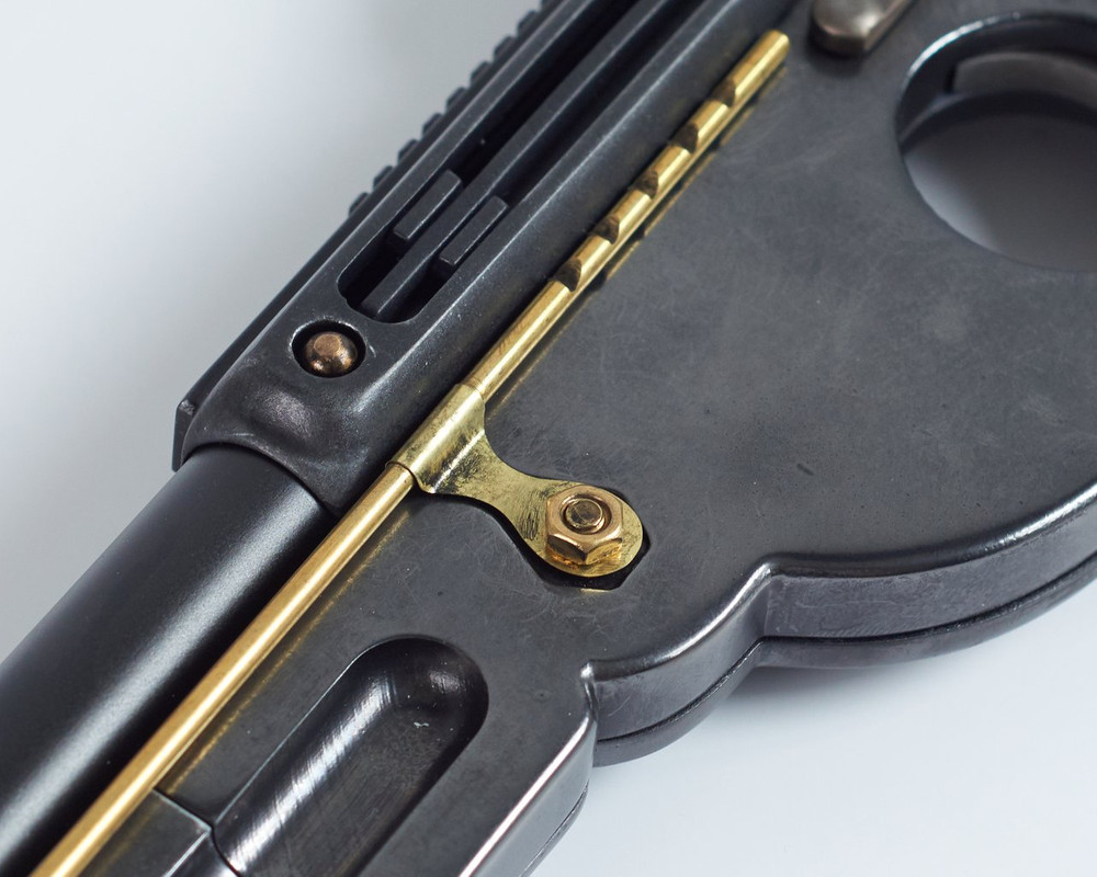

Fabricated the rod holder out of brass sheet.

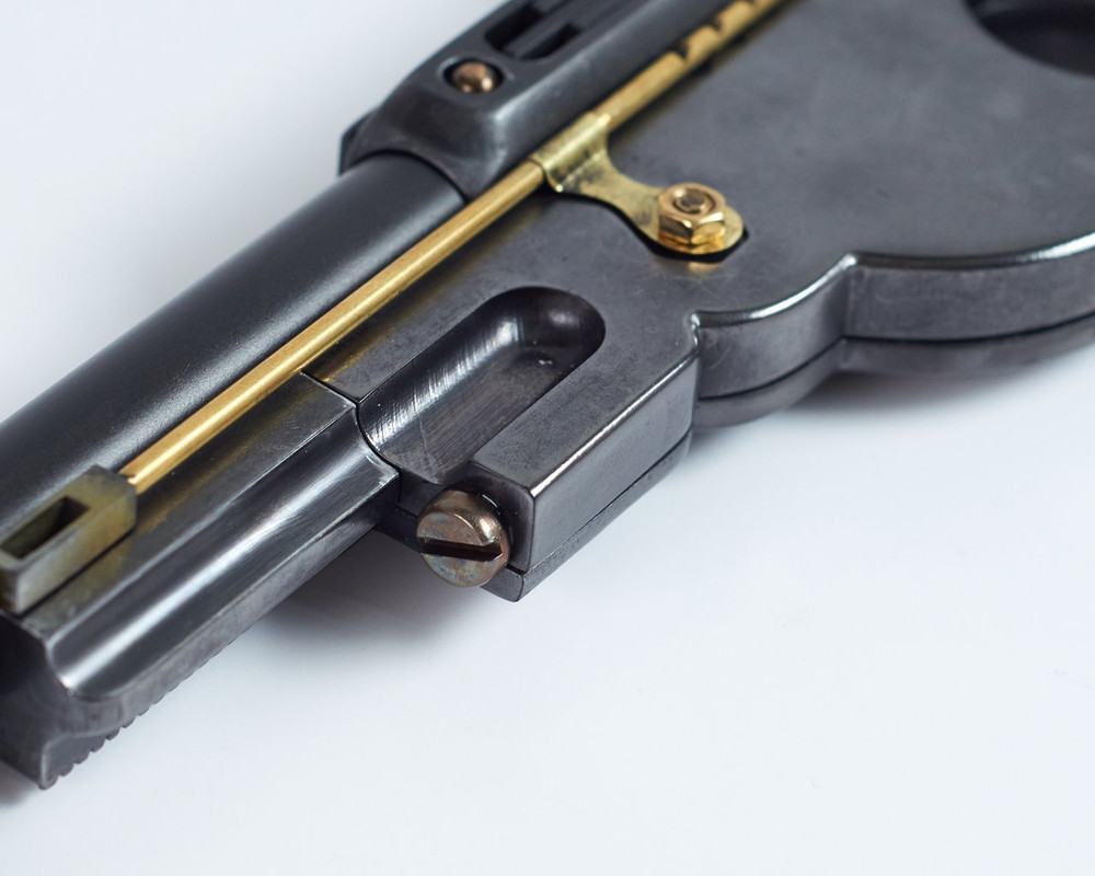

Flame-blued M6 slotted cheesehead screw for the plunger retainer
Thank you very much guys!

If you buff the graphite on while the paint is still not fully cured (less than 24 hours in my experience) you typically don't need to protect the graphite. When it stops rubbing off you're done buffing. :)
It's been two years and the graphite is still holding strong without any clear coat!
I am pretty sure that the graphite 'cuts' into the clear coat and embeds itself, and that's why it's so durable. I love graphite for these old-patina blasters. One thing I usually to is wet-buff the graphite after an initial dry-buff. Seems the water buffing gives it just a tad more shine.
