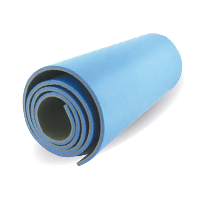

hi and thanks for the uploads. loads of my questions have been asked here and I am now going to try this. I have already done the pepakura predator mask but now I will try it in foam. only question I have is I am from the uk and wanted to know what foam do you use and could I use camping mats
specs: width:50cm height:180cm depth:0.08cm
would this be ok to use thanks mike

I use them for most of my builds.
I would suggest running a heatgun over it before you draw any templates on it and seal with pva before painting.
Other than that it's perfect for using.

hi at the moment it looks like I will be getting them from argos £4.99 unless you know anywere else cheeper
Argos is the place for constant supply.
Around this time of year ASDA do them as it's camping season. Last year they were £3.99 each.
Tesco do the same mats but with silver foil on one side, tempting for a Cylon or something like that.
