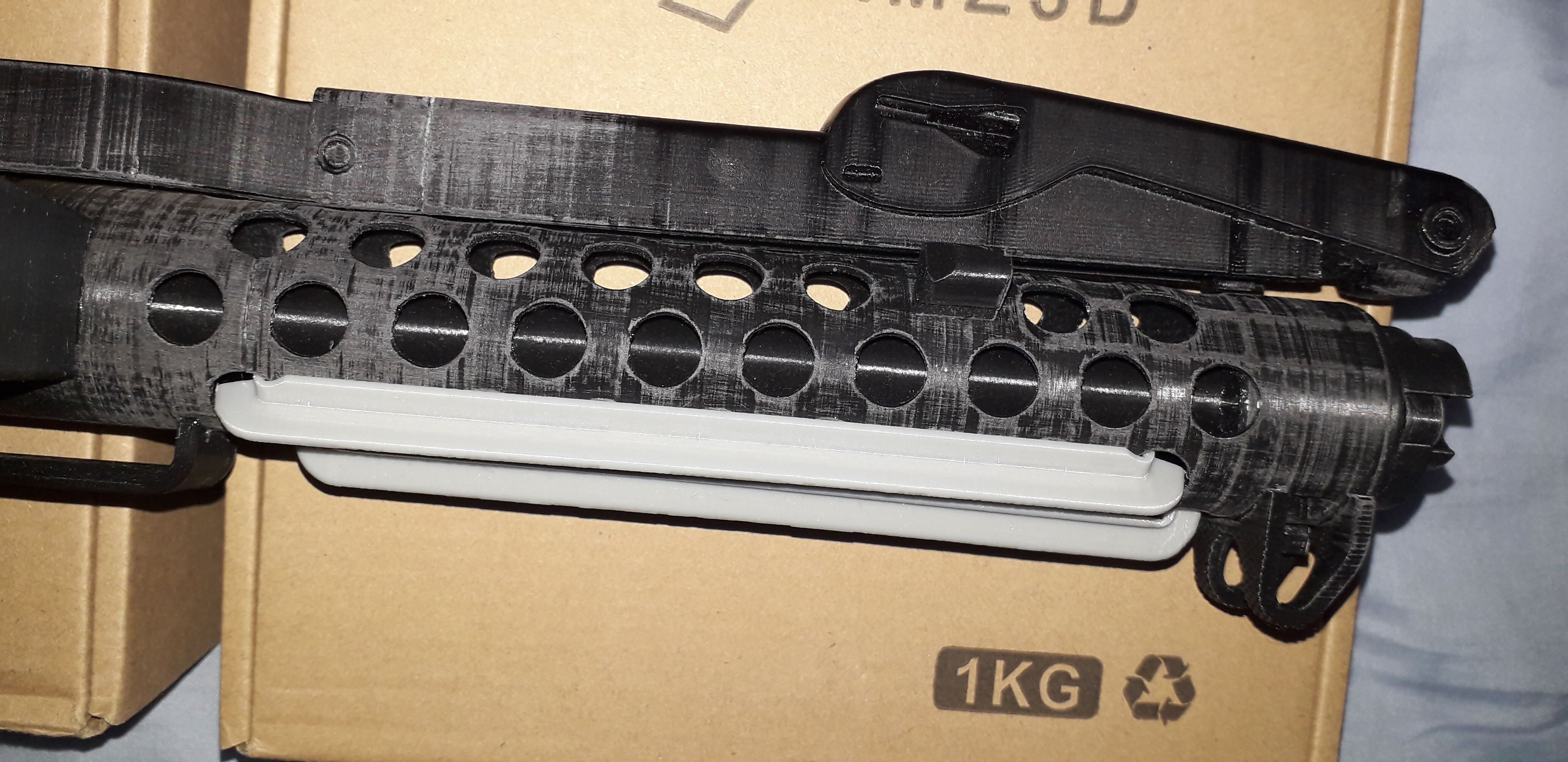

So I figured I needed a build to keep myself busy during the ongoing quarantine, and I settled on starting a 3D printed E-11. Not sure if I'm going to do a costume to go with it yet or not (especially since I don't know how the RS TK armour runs size-wise and stuff).
Either way, one quick run to Thingiverse later, and here I am running off the barrel shroud. Already know I'm going to have to true up the vent holes a little since Cura decided not to support them properly.
