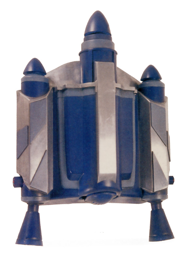

What is your budget in terms of money and working hours? I did a search for the inflatable jetpack and it seems to cost somewhere between 14-18 dollars. The materials that I'd use for such a project wouldn't fit perfectly in that budget but on the other hand I'm a perfectionist and this is by your own admission not meant to be perfect, just above lame.

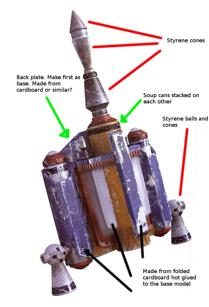

I'd say you can make a very nice jetpack for your son using cardboard, some styrene shapes, a hot glue gun, paper machier and some spray paint. Maybe some Velcro straps to keep it in place would be nice too.
My advice if you don't want to make it by exact blueprint is to create the back plate first, attaching the center cylinder after that and adding details in order of size after this. That way the big silhouette is going to be there even if you run out of time.
The rocket could be made from a stick with styrene cones stuck on. I've seen someone make the big cylinders with covered soup cans of the right size. The hexagonal and square covers can be made by scoring and folding cardboard and the rounded forms can be made by cutting styrene balls or using wood buttons found in craft stores.
Cover this with a pair of layers of paper machier to remove the big seams and to create a better surface to paint. After that you spray it and add any detailed work with a paintbrush if you want.
