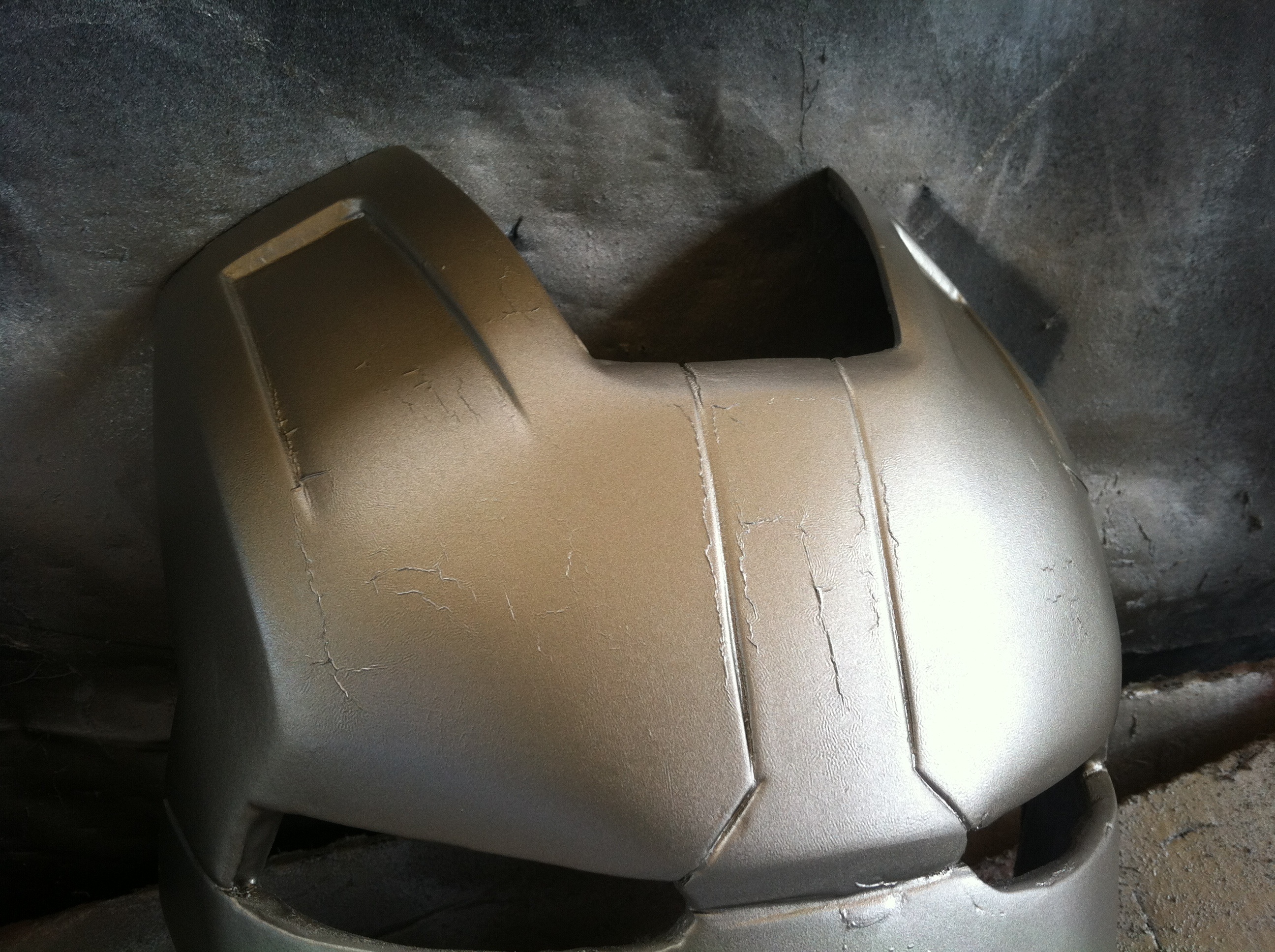

I just wanted to share how excited I get when the first spray of the day ORANGE PEELS!!! I'm so excited, I'm going back to bed. image.jpg

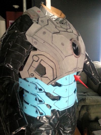

hmm ok. i see what you mean. ill take your advice and join the ab and cod and somehow velcro the spine. man your proportions on your suit are awesome. i think i made my chest/back too big... it means alot to get advice from the top guys...thanx man
http://i74.photobucket.com/albums/i...c-2230-4c14-8312-5ea43d57094c_zps8efde28a.jpg

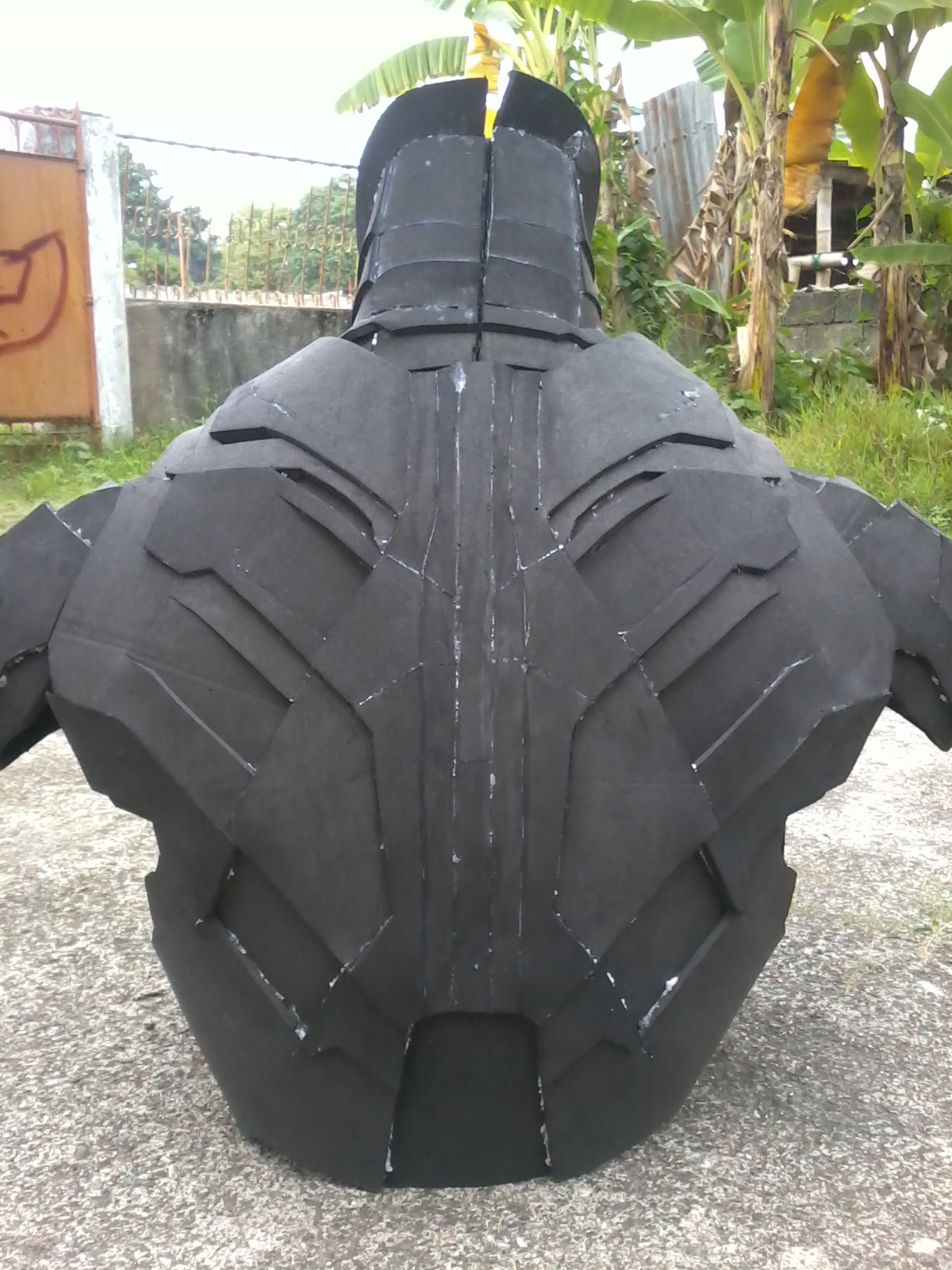

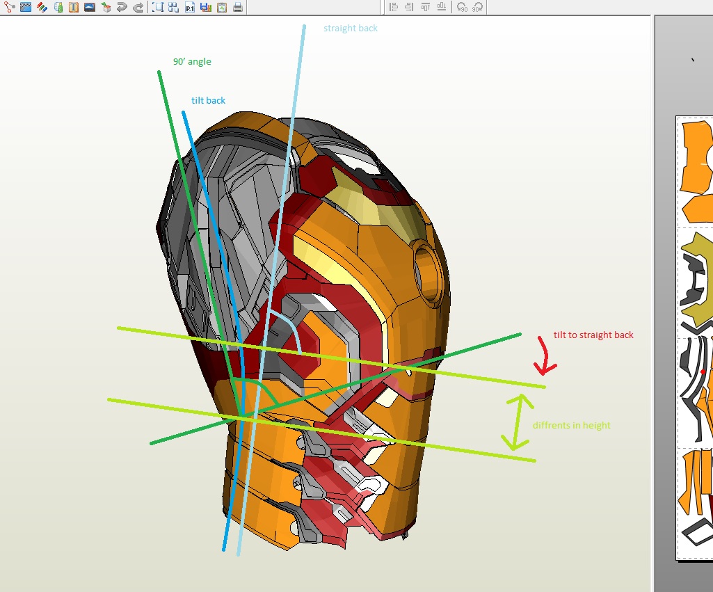

This is where it almost went wrong for me aswell.
I imported PDO's to find the right scale for diffrent parts.
I noticed the back was abit tilted, giving me a whole new height.
hope it helps ;)

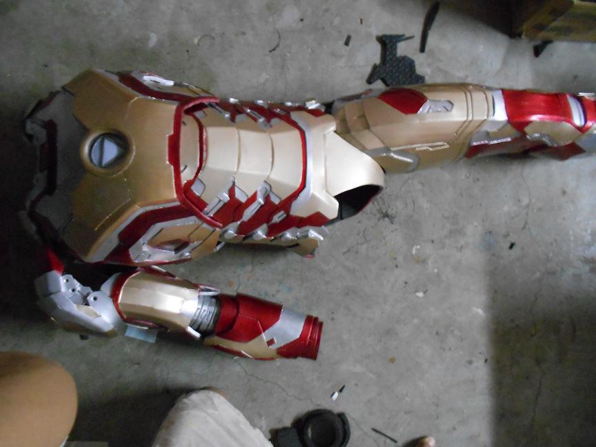

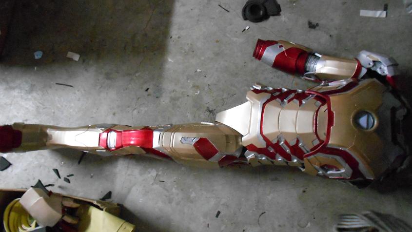

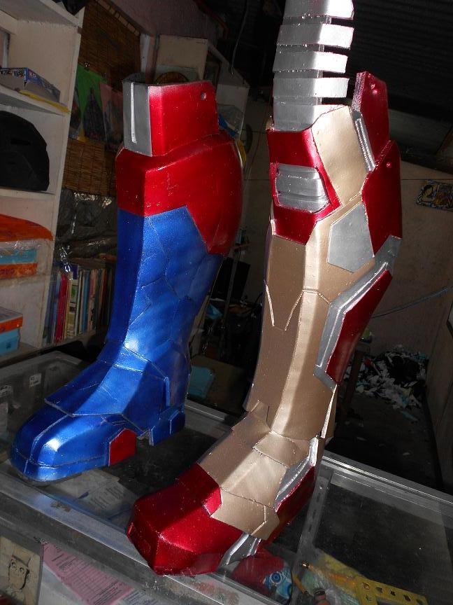

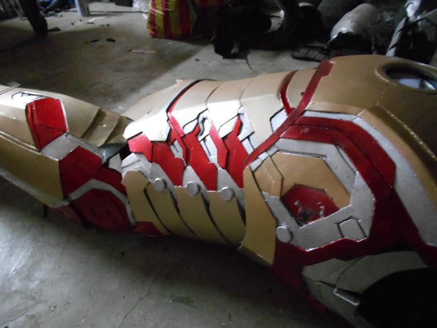

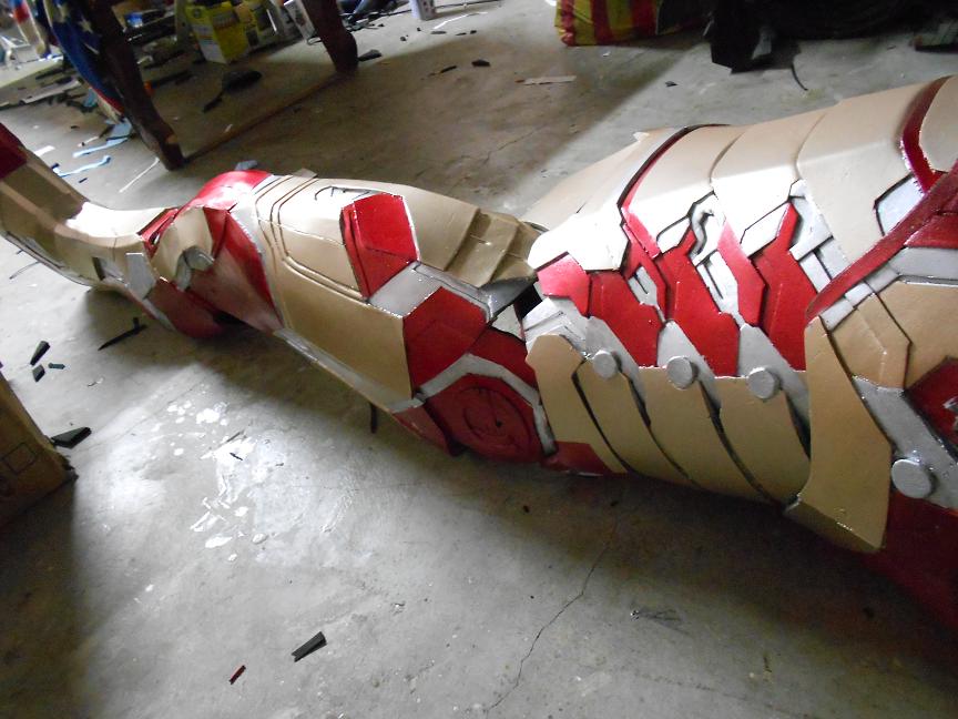

for my 1000th post* (thanks @SOUTHPAW lol) here's what i've got for now :)
View attachment 233831View attachment 233832View attachment 233833View attachment 233837View attachment 233838View attachment 233839
i haven't painted the left arm and right leg pieces. . .i also need to build a neck using jackie's IP neck file
:$ not rushing anything, since i have a commission suit building right now. . . .just to keep everything in proportion :D
