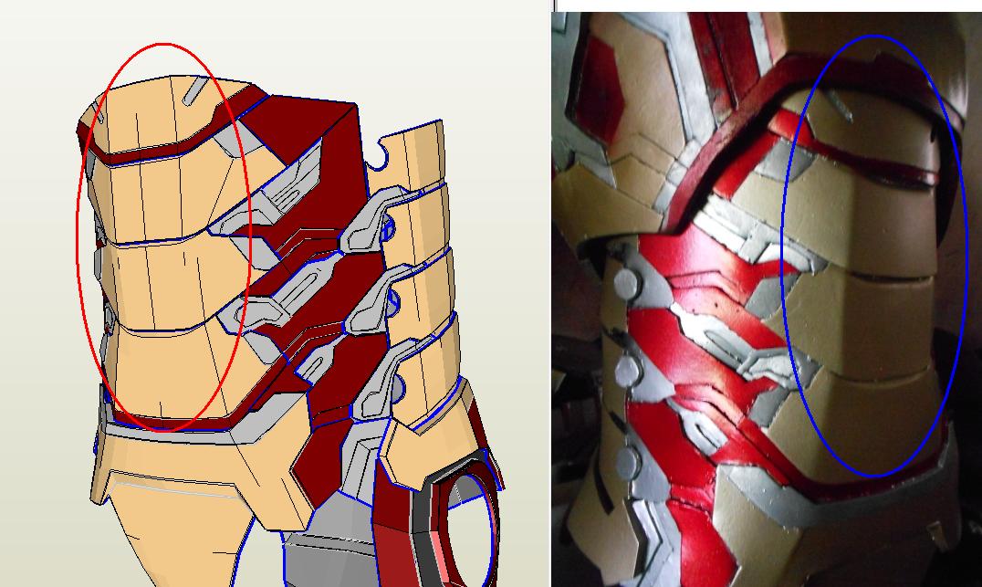

i think yours is just fine, that space between the upper part of the abs and the chest is i think natural if you didn't apply the ab details
the part with the red circle is the detail, which i applied on my build (see the blue circle), thus it fits right and well proportioned to the chest with the same scale as the abs (jackieisrockin's files)

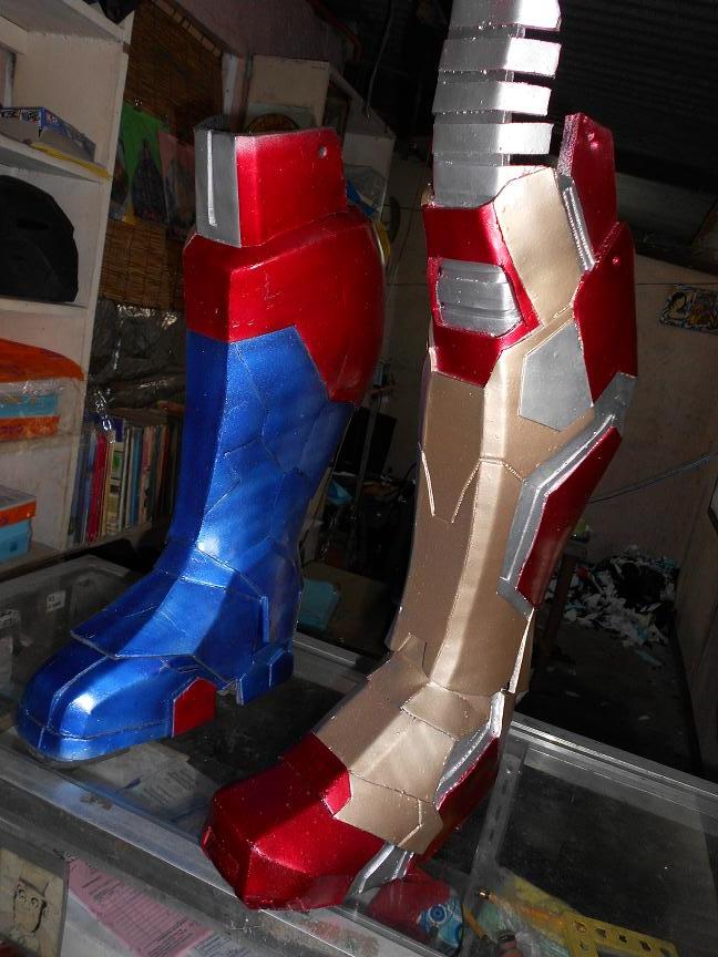

for my 1000th post* (thanks SOUTHPAW lol) here's what i've got for now :)
i haven't painted the left arm and right leg pieces. . .i also need to build a neck using jackie's IP neck file
:$ not rushing anything, since i have a commission suit building right now. . . .just to keep everything in proportion :D
